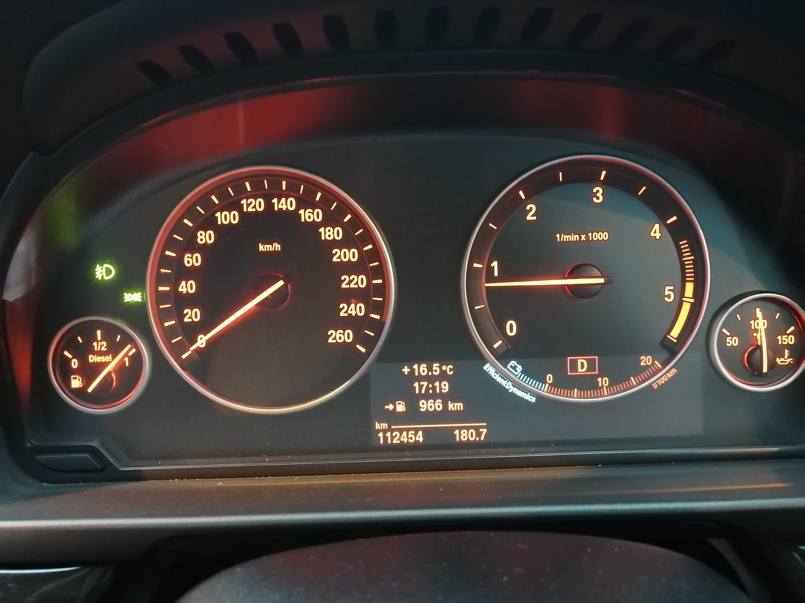

Was pleasantly surprised with the consumption.
Arrived at my destination about 180km later with plenty range still avail

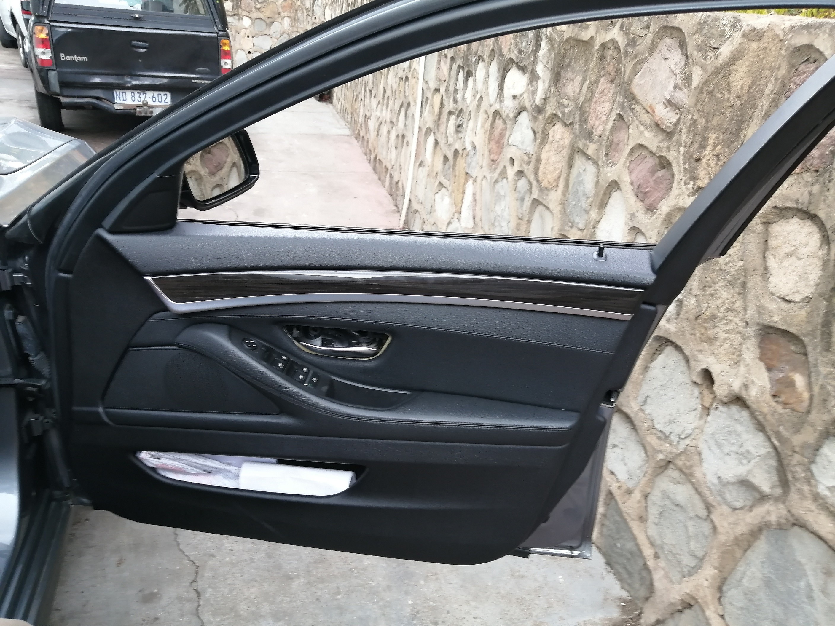

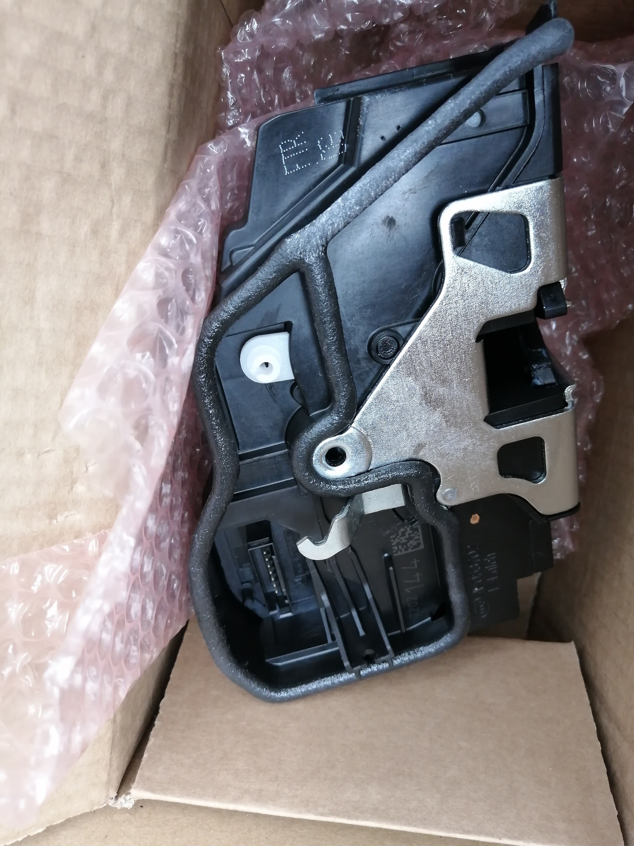

So my parts arrived late on Tuesday night and the car was serviced yesterday. Oil, oil filter, air filter and the fuel filter was changed out. I also got the drivers door lockset/actuator replaced.
Here's some pics of the process...
New part:

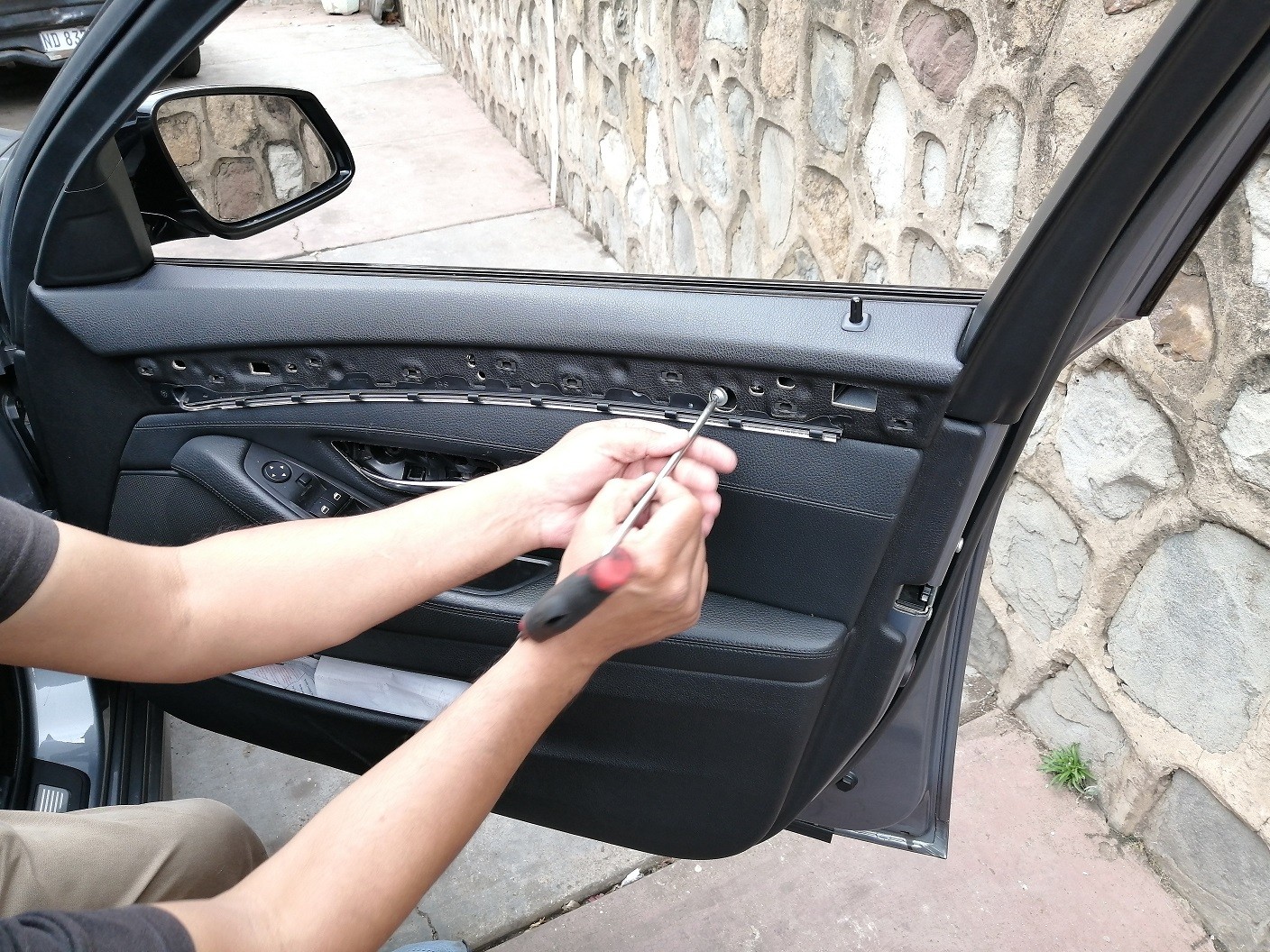

Pry tool used to remove the plastic cover by the door handle:
Those are two fines in the storage compartment :hammerhead: Need to put my number plates back on after receiving multiple fines, from the same officer, in my area. He's made it his life mission to lookout for me now, as he remembered fining me in the E92 for the same thing :biglol:

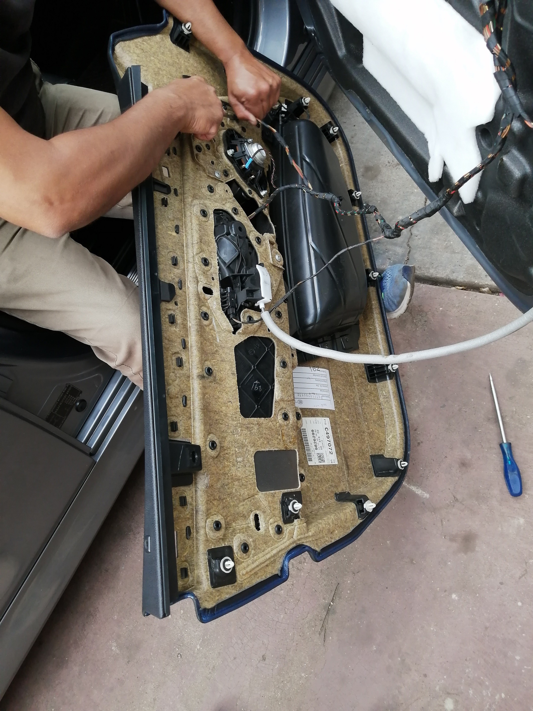

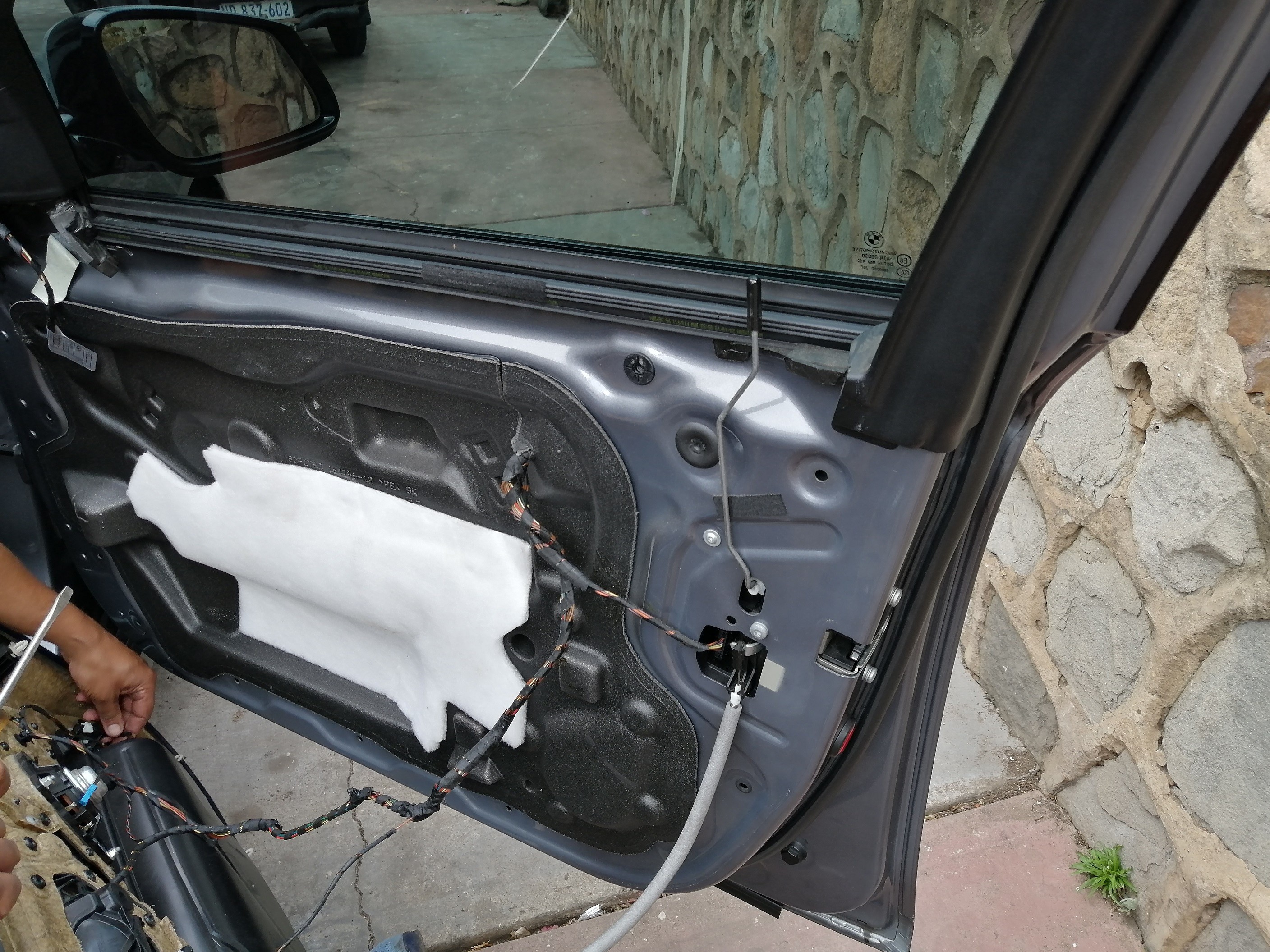

Wooden trim popped off then there were some torx screws to remove. Gotta be careful around the ambient lighting LED (?) strips. There will be 2 strips. 1 under the the wooden trim, which illuminates the door handles, and one by the storage compartment.
The entire panel then pops off. Can't remember if there were more screws on the side, and beneath, the door but its fairly simple. All the cabling will now be exposed (speakers, ambient lighting, power mirrors, windows etc). Remove each cable in order to get the panel off completely.

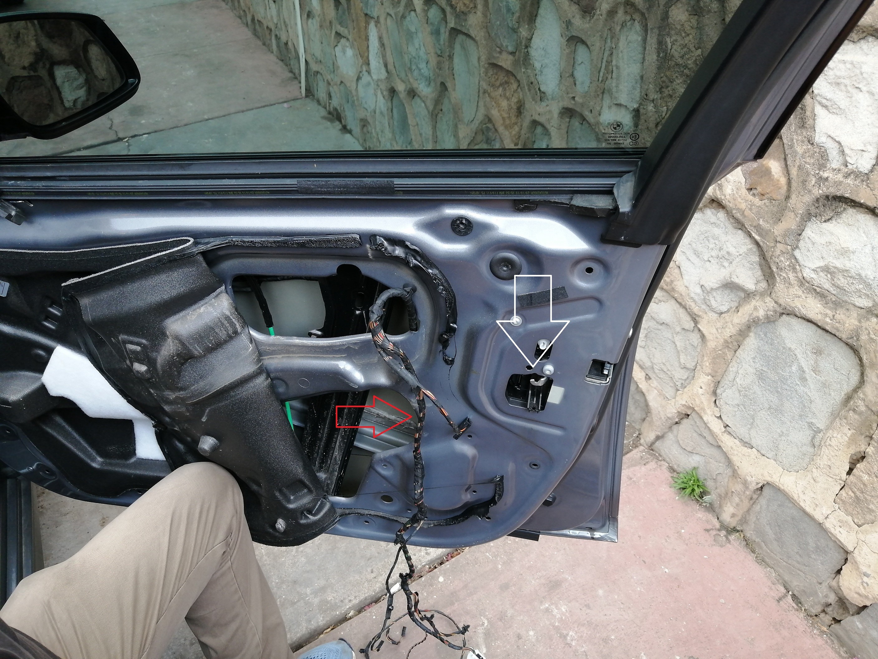

You now have access to the lockset (white arrow) that will need changing. You have access to this from the inner/centre portion of the door (red arrow).
There is a screw holding the actuator in place and a cable plugged in for the electronics. The locking pin, and key position, needs to be aligned correctly in order for the key (when using to turn the key manually) to actually work. The 'pin' inside needs to 'catch' the swing that, both, locks/unlocks the door.
After that, its just the process reversed in order to get everything closed up and neat again.
The door panels are much heavier than I expected and some crazy weight reduction can be achieved by removing all :roflol:
Now that I know how easy it is to remove this, I will probably attempt a proper sound upgrade in the near future :hammerhead:

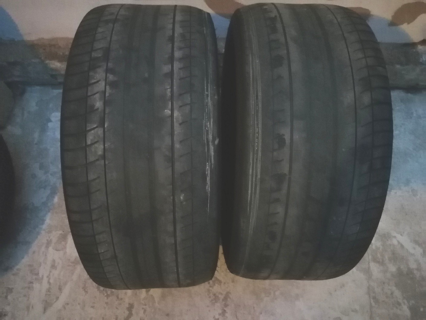

My tyres were way beyond their wear limits and needed to be swapped out quite badly. I took my time with this, not knowing how bad they really were, until I drove the car in the rain, that we've had, over the past week. I took a fair bit of time, as I did not want to get tyres for the style 350 and wanted to use the opportunity to do a wheel change in one-go. The tyre profile on the 18s (style 350) were weird and I could only seem to find (given stock and availability) runflat tyres for them. The few brands that had non rft - only manufacture the front tyre and do not make the rears...

Took the passengers home with me. Man, they were bad :hammerhead:
