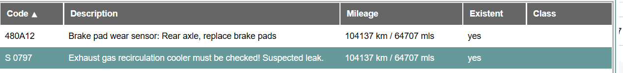

One thing to note, my ISTA threw a possible EGR coolant leak code after draining coolant.
It seems like this is standard when coolant level drops due to the historical recalls on EGR leaks.
This does not indicate that the leak does indeed come from the EGR, I would thoroughly inspect to determine where the leak is.
Code below, this is apparantly an internally code generated by ISTA and not from the car.
In my case the code was triggered by coolant drop due to draining it even though I have no leak or coolant loss anywhere.unnamed.png
