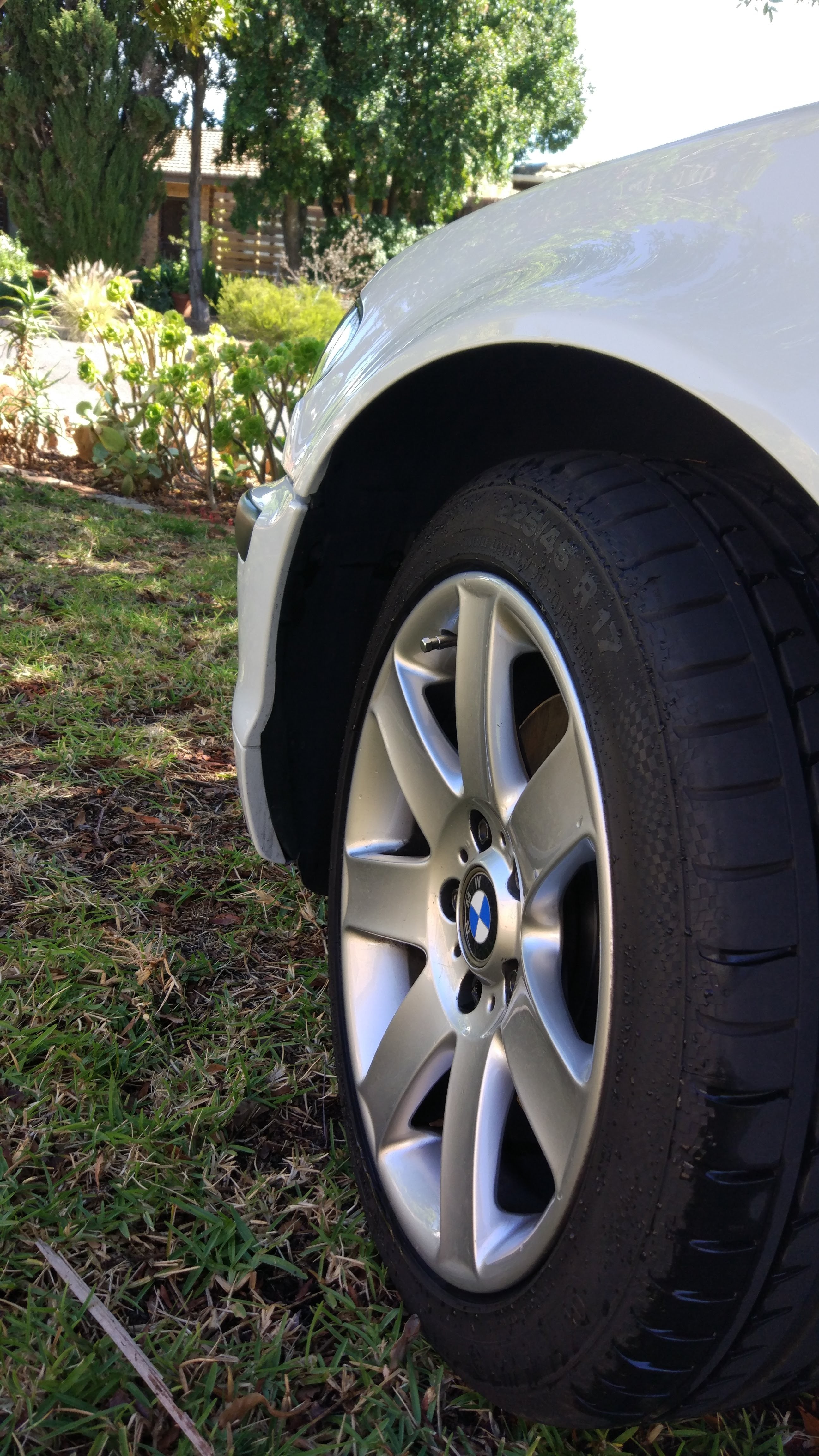

Yesterday I only did this:
Loosening the bolts on the wheels, jacking up the car and removing the wheels. That was it for the whole day  :fencelook:
Anyways next day, first one removed. Not sure I can see the difference but here it is:
Looking in on the side doesn't look too bad. Less dirty than I expected a daily to look.
Closer look to see the bushings.
First spring installed:
On to the other side:
Also installed:
Ok this is random. Looks how much space there are at the front wheels, while the back side sits on jack stands...
Time to get the wheels back on:
Did a quick run over some bumps to see if I can feel the difference on the back. Back at home, this is what it looks like on the new springs and me hoping the setting should start to happen.
Will have to go over my thoughts about all of this in a later post.

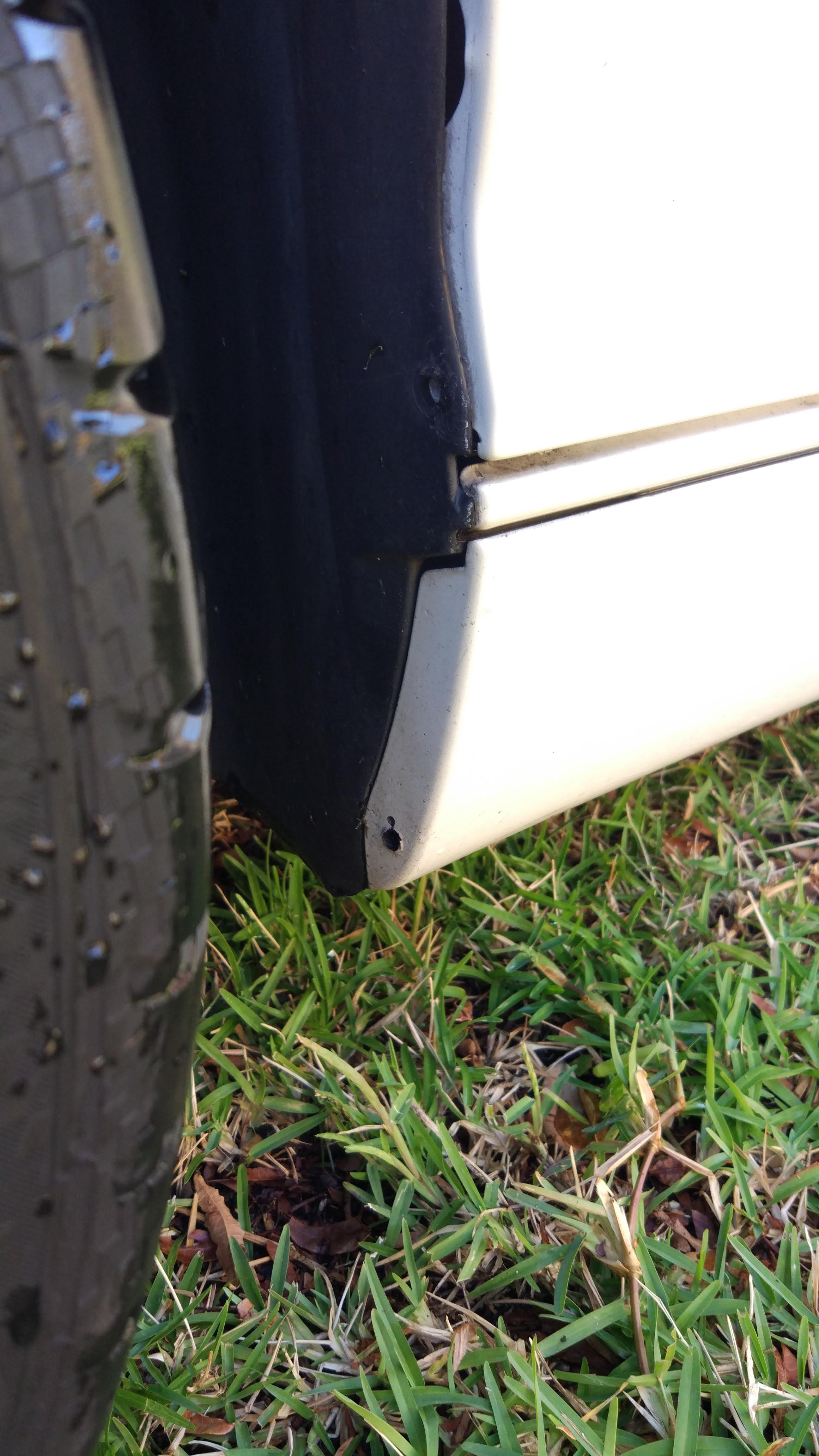

Last update for 2020. What a year...
I had a mini accident...
Only lost the right rear mudflap but in the process, one of the clips holding it on did cause damage to the tyre. After plugging it, the tyre will live on and I need to re-attach the mudflap.
Also received  Rogue Engineering gearbox mounts which I am very happy about. So the last of the rubber that needed a refresh on the car is now complete. I had it over at Garage808 to replace the engine mounts with oem rubber and the gearbox mounts with the ones I supplied. I didn't expect much of an improvement but I can actually feel it. The engine mounts has me feel less of the engine vibration at idle. The gearbox mounts, I expected to only feel when going fast around a corner and trying to shift mid corner. The oem mounts lets the gearbox move around (for comfort) but can cause you to initiate a money shift (I assume this means, going into the wrong gear and causing a lot of damage) where as the rogue mounts doesn't. It definitely feels more in place for me and it feels better shifting, I was surprised.
On this same day, the car also received an inspection 2 service minus the fuel filter which we couldn't get a bosch filter in stock in SA. Will do it in the new year.
Also adding some photos for eye candy.
The missing flap and the damage it caused:
The new gearbox mounts:
Some eye candy while and after receiving some love washing and cleaning:

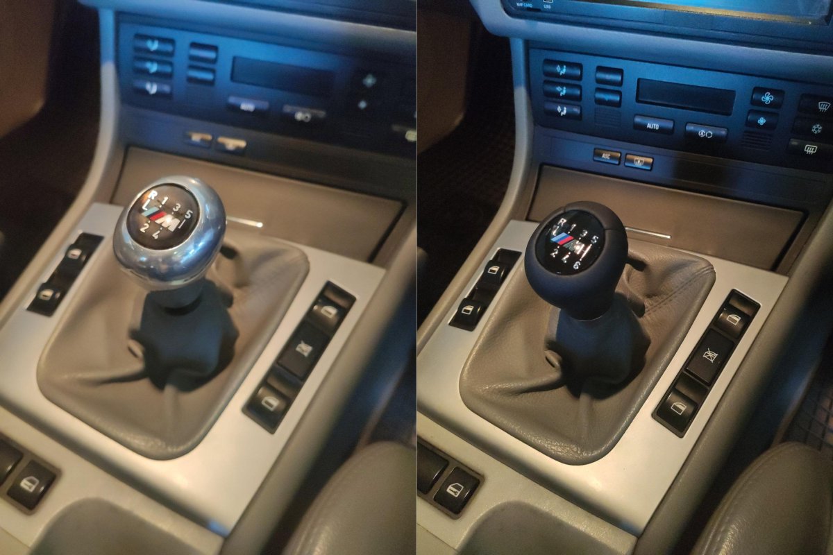

I haven't posted in a while.
This is my current indecision...
On the left side, is the gear knob that came with the car.
On the right side, is the gear knob that suits the current swapped in gearbox.
Both knows are weighted version, eg. a nice weight to it and lovely shift experience.
The right side is nice, but I think I am cheap and I like the feel of the left side, which is aluminium covered with a clear plastic layer. This plastic did start coming off in some tiny spots.
Anyways, out of interest sake, I asked reddit what they think, which looks like is an almost if not 100% vote for the right side. On the left side one user is willing to buy it if I go for right side.
Benji
I understand the dilemma, keep it OEM, or make it look nicer...I would say the right does look better. If the car has a 6 speed, then 100% go with the right
Tinuva
Staff & Webmaster
Left side was the oem on this car. I have swapped in a 6 speed gearbox though.
Sent from my Mi 9T using Tapatalk
Dewald Basson
If it really is aluminum you can have the paint removed and give it a natural anodising which will give the same shine. The knob will then outlive the car with the anodising protecting it. But it probably is not a solid aluminum piece and paint over plastic.
Have it repainted with some fresh 2k paint and then polished. It should shine properly again.
Also my 2c, your car do what makes you happy.
