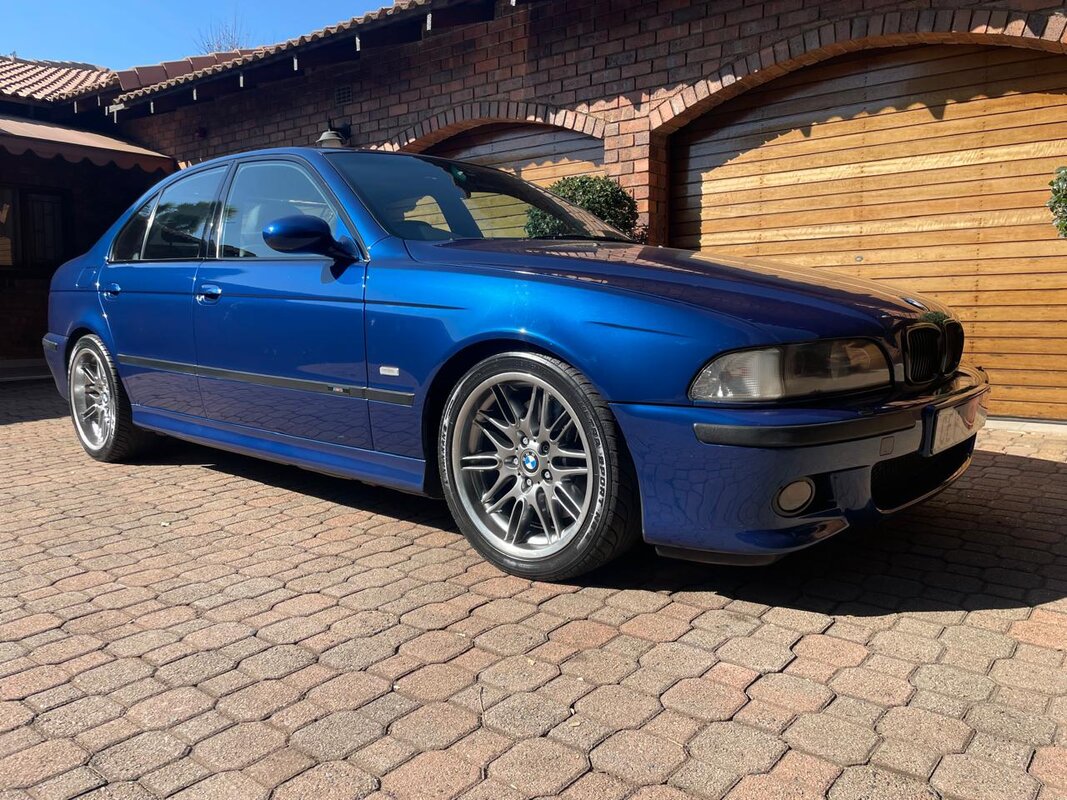

Sibonelo
thanks for the write up man.. proper detailed, I am tackling very similar things on my M5 and agreed the NLA on parts is an issue.. I was looking for the battery box at BMW and its NLA.. I am following your theory of changing it while parts are still available. what I did notice is that the shocks are actually cheaper/ similar priced to aftermarket Bilstein B8, for me it was no brainer to get OEM's and lucky front shock mounts are available. I have the same rattle on cold start even after replacing the timing chain tensioner. I did discs and pads as well, and from the 530i and discussion it the OEM discs are the way to go. I need to address the power steering lines as well. I did the diff and transmission oil. good to know engine mounts are available, I need those.
Bernard///M3
BMW Car Club Member
Congrats and Many Happy Miles
Loving your work, great stuff
When did u buy this car?
Guess what I also bought a car from down there on 24 April 2025, also had a CFM numberplate but it’s a 2000 Le Mans Blue E39 M5.
The previous owner did a lot of work on the car, most of the bushings were done. And lots of preventative maintenance. I’m sure u know the water bottles go yellow, mine is nice and new and white 😜
Since buying it, it’s had an oil service eventhough it was done recently by previous owner, oil was definitely not 10w60.
Gearbox oil also changed
Had to replace the shocks luckily my racecar technician had an almost new set he removed from M5 racecar build, fitted them (luckily he has parts from this racecar build lying around)
Replaced diff bushing
Front bumper undercarriage covers, centre one was missing and the passenger side was broken, both replaced with new ones
Passenger rear wheel arch cover also damaged from what seems to be a blowout. Apparently that’s NLA but he had one lying around. So lucky me
Currently the car is in the wheel shop, and staying there for a week, while I’m away, the wheels had a slight polished lip which looks crap. So they being restored back to original. And new rubber being fitted and yes also Bridgestone Potenza Sport. They the only matching tyres you can find in the M5 sizes. The Michelin Pilot Sport 3 is another option. But “old tech” and is my tyre guy pointed out these cars came out in the Bridgestone era, not sure if that’s correct though. But let’s try them!
the original idea was to buy a car for the V8 Thunder Tour, and I don’t want to use my V8 M3 because who knows what shit we going to get up to and secondly I don’t want put mileage on it (my choice)
Originally I bought a E39 540i but I just didn’t enjoy it and then decided to up the budget for a E39 M5, I didn’t realise how great of a car it is & it fits in to my little collection!
I looked at 3 options and this one was by luck and I managed to twist the owners arm and acquired the car.
So it’s definitely going to be my “Tour” car for years to come, it’s not perfect like some of my other cars but perfect for what I want it for!
It’s also got a stupidly loud exhaust and I’m actually enjoying it like that, brings out the inner child Hooligan 😜😂
One other item I changed was the radio it that small square screen with the tape player. I found a retro fit radio (looks almost exactly like the bigger screened originally radio) but it has Apple car play / Bluetooth etc. perfect for all the road trips I plan to do!
Only items I need to sort out now is the rear section of the roof lining has sagged a little and the side mirrors are stuffed they all hazy and not very clear. I quoted a new set, glass only and I had to sit down when I saw the price.
Anyway looking forward to doing the Tour which starts 3rd of August from Zwartkops and ends 10 August in Knysna
