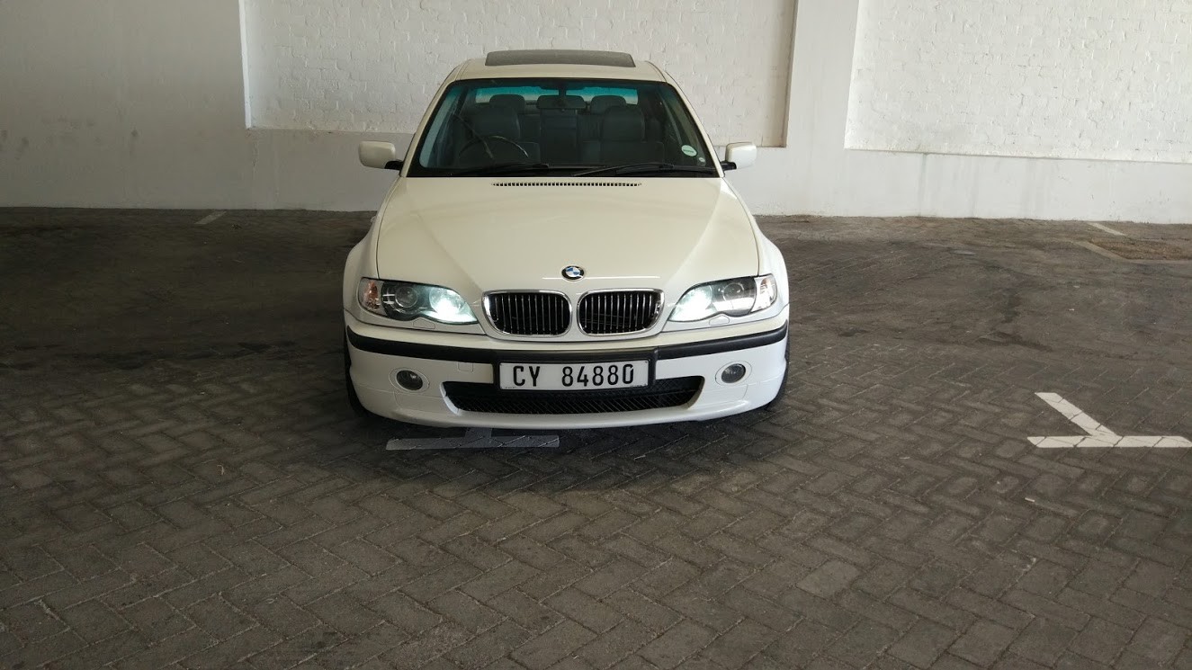

Car is looking good, glad to see it being finished up and I really like the facelift.. :smilebounce:
How are you enjoying the android unit? Put a unit in mine about 3 weeks ago and absolutely loving the functionality and features, even the reverse camera is quite cool.

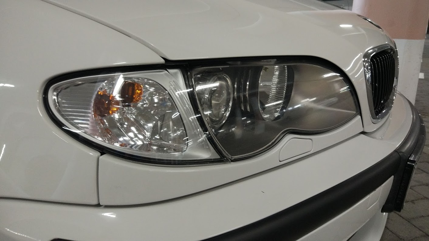

If your car headlight has black inners (which I think it does from pics), you'd need the corresponding indicators. The ones you have on, have the titanium surround to match the silver inners that came on pre-04 models.
Absolutely love the android unit. Really brings the radio/nav in to the current future.
Still have to add the reverse camera and dashcam.
For the lights, yes mentioned I want to put in the silver/titanium inserts to match the corners. They at home, just need to open the headlights.

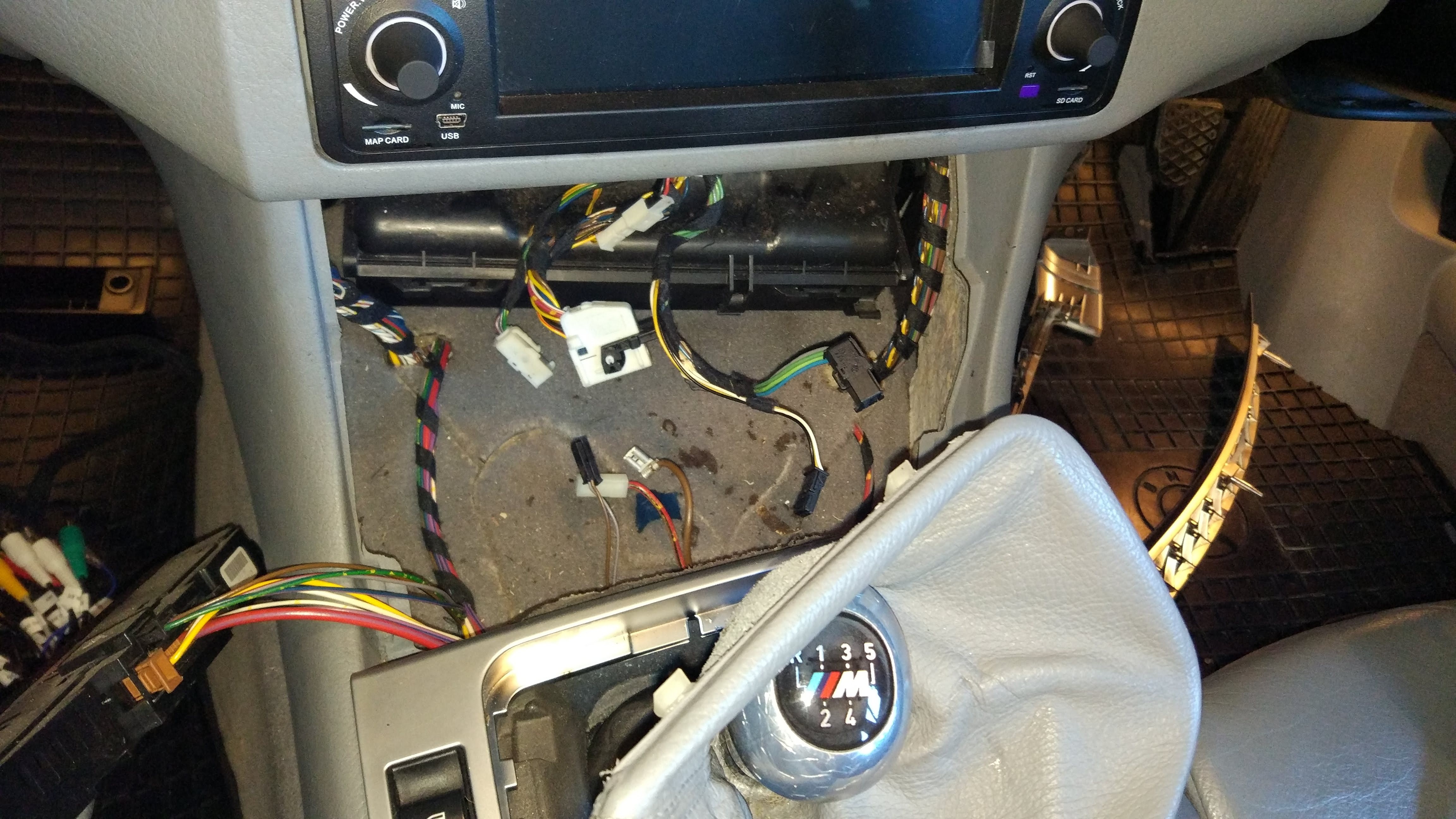

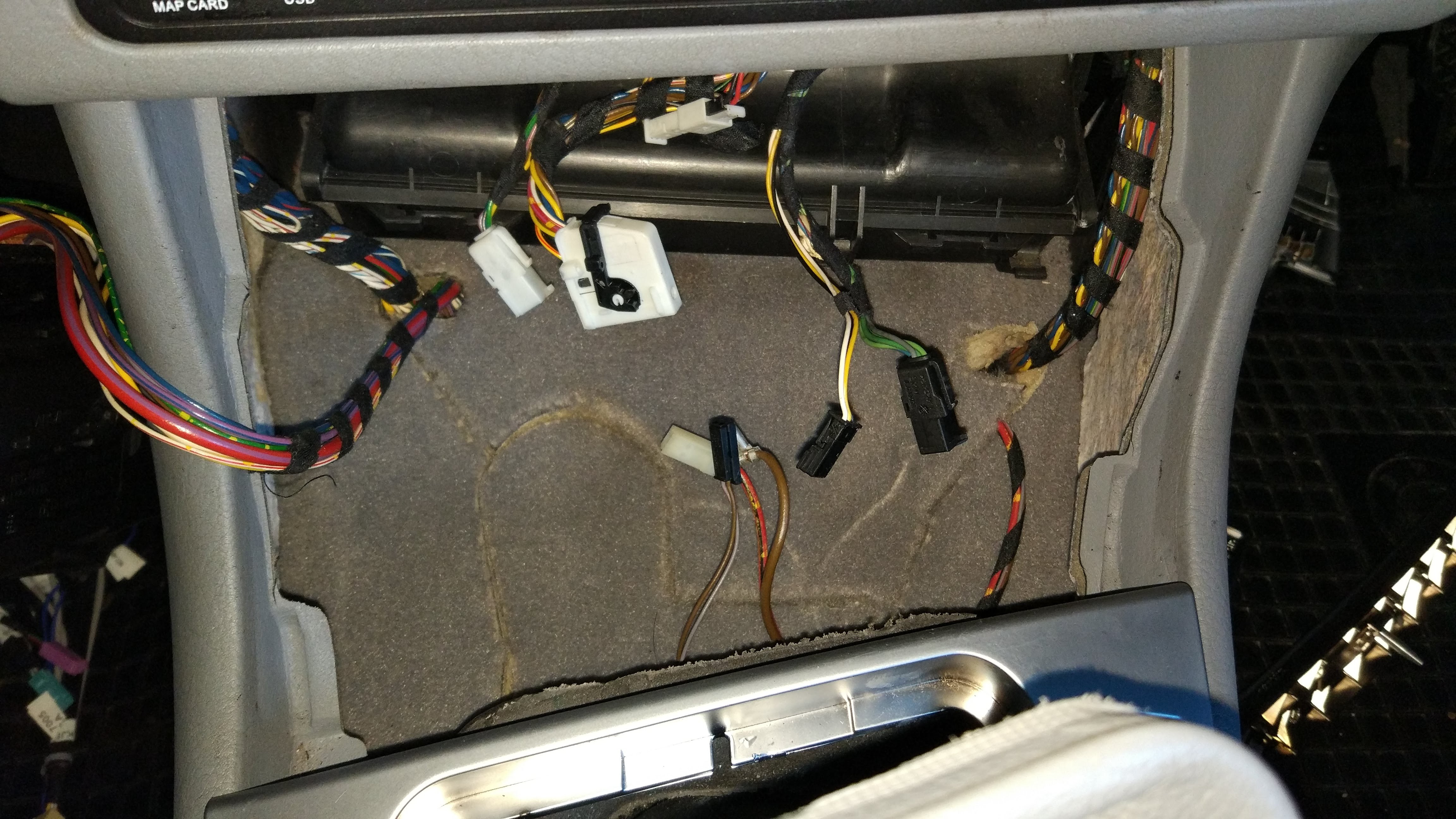

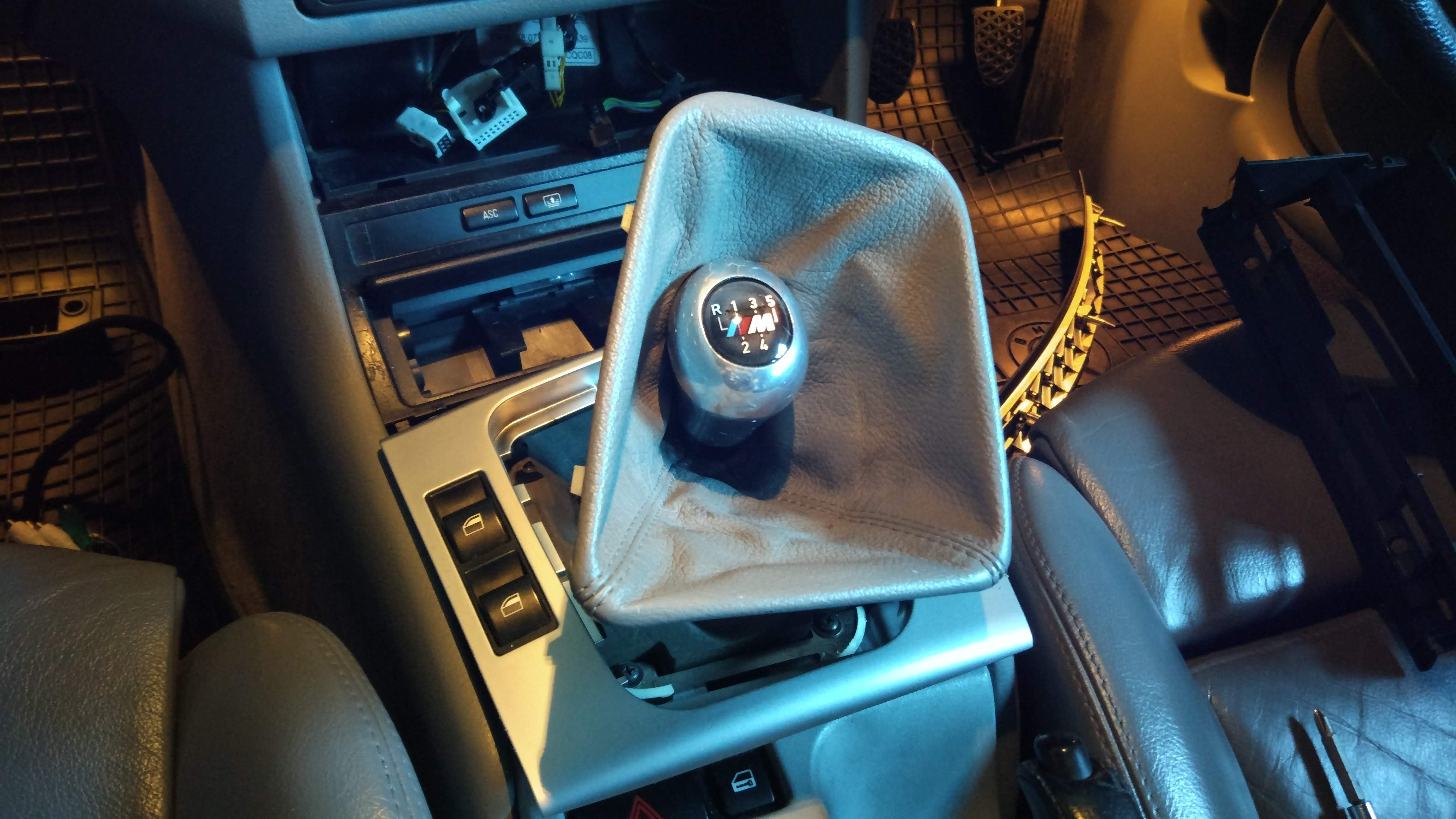

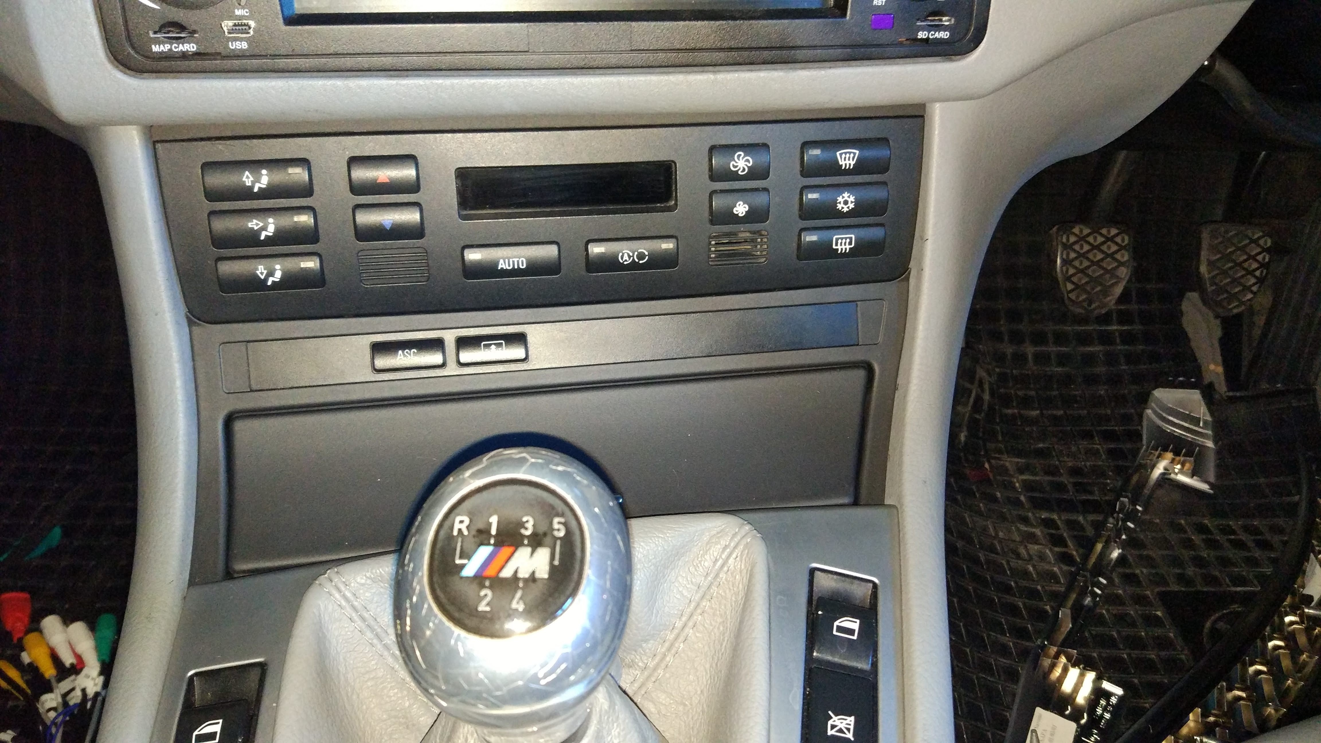

Received the AC relocation bracket from SMG last weekend. So it was time to install.
Unfortunately, this is the 1st time I am looking at the trim around the gear lever, and it came out too easy while trying to get the gear lever jacket off :blueCry:
In this pic you can see what had me furious. It may have been me, but I imagine you would have to try and break it open for this to happen.
Anyways, moving along for now.

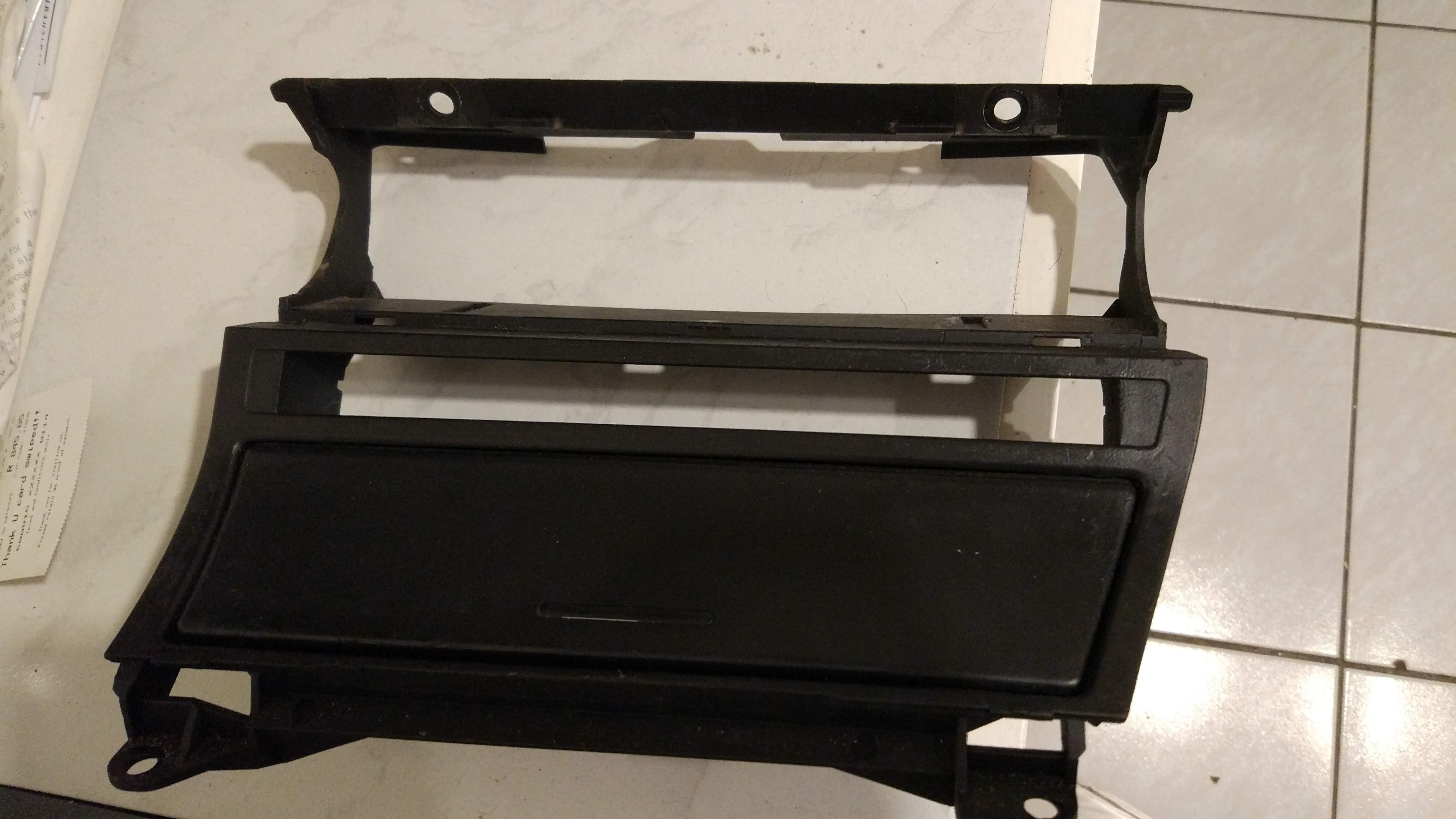

Old part:
New part:
Before adding in new part, this is what it looked like behind:
Quick cleaning up:
Looks much better now using the relocation bracket:

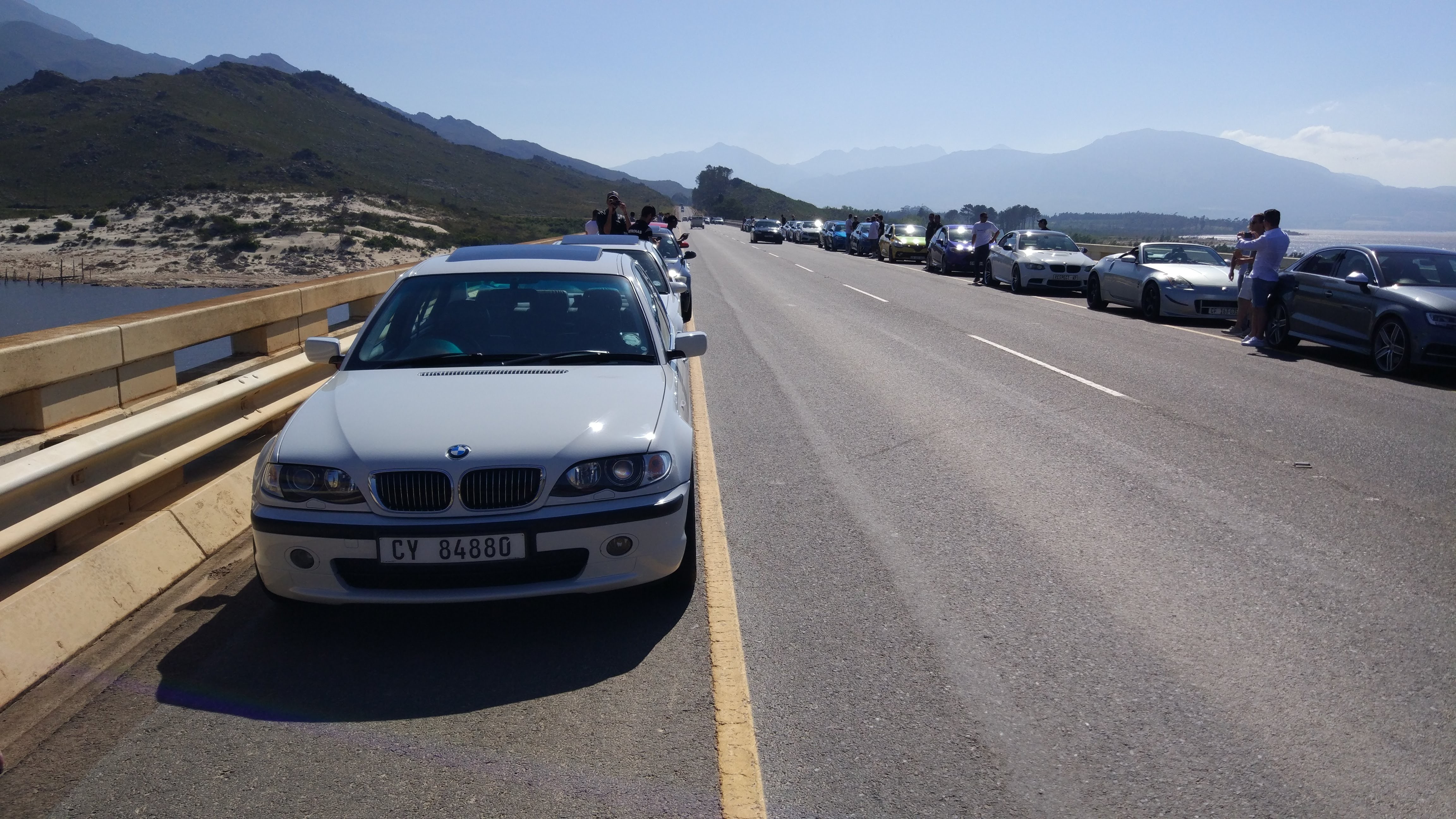

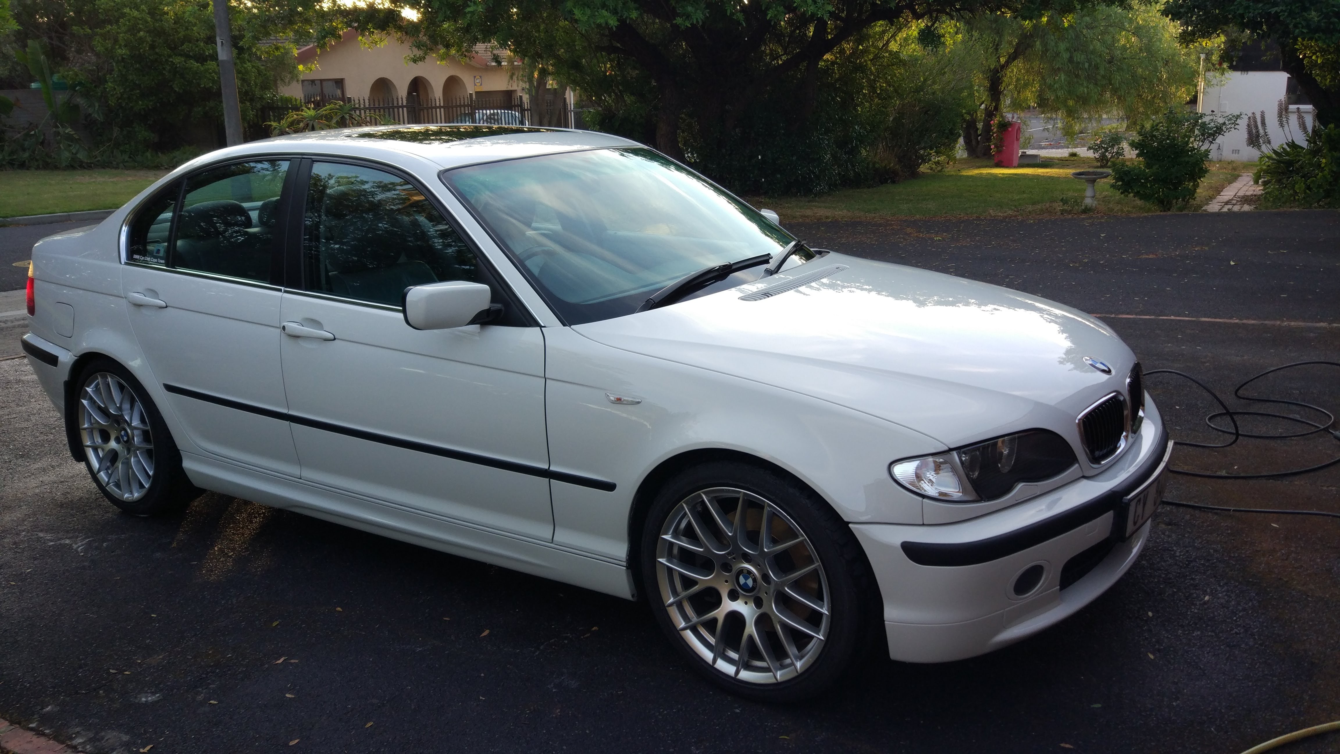

Quick wash before going on the SA Torque chapter 11 breakfast run:
(ps. I didn't do any spinning on the N2)
And 1 photo where we stopped on the bridge before reaching the final destination:

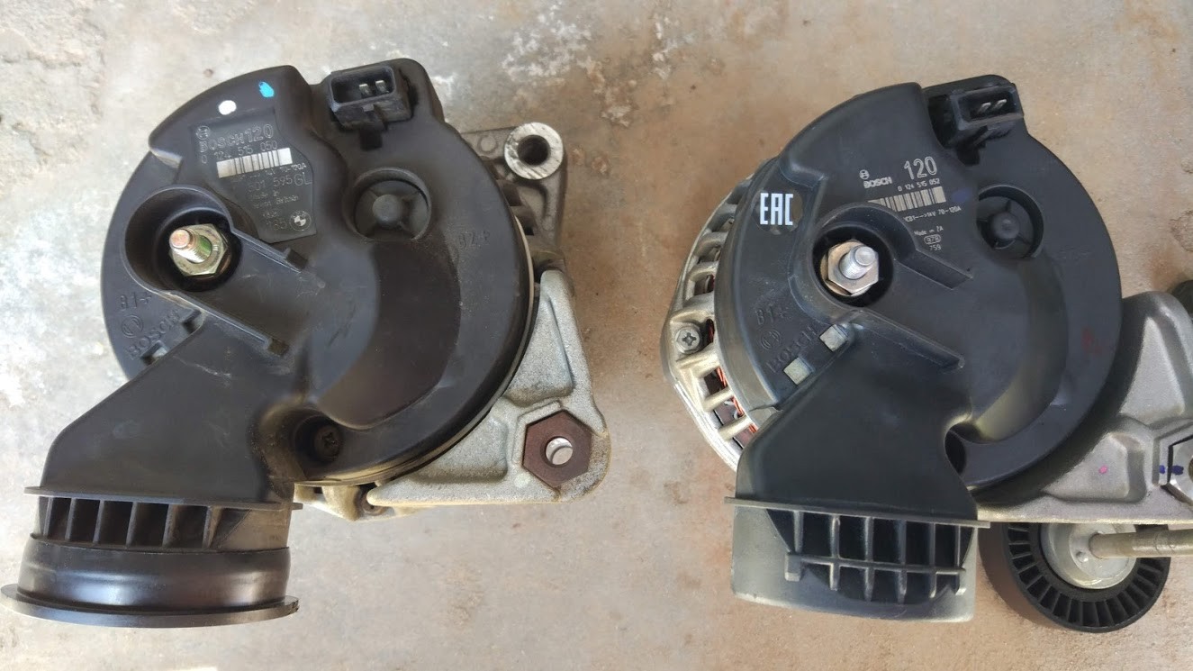

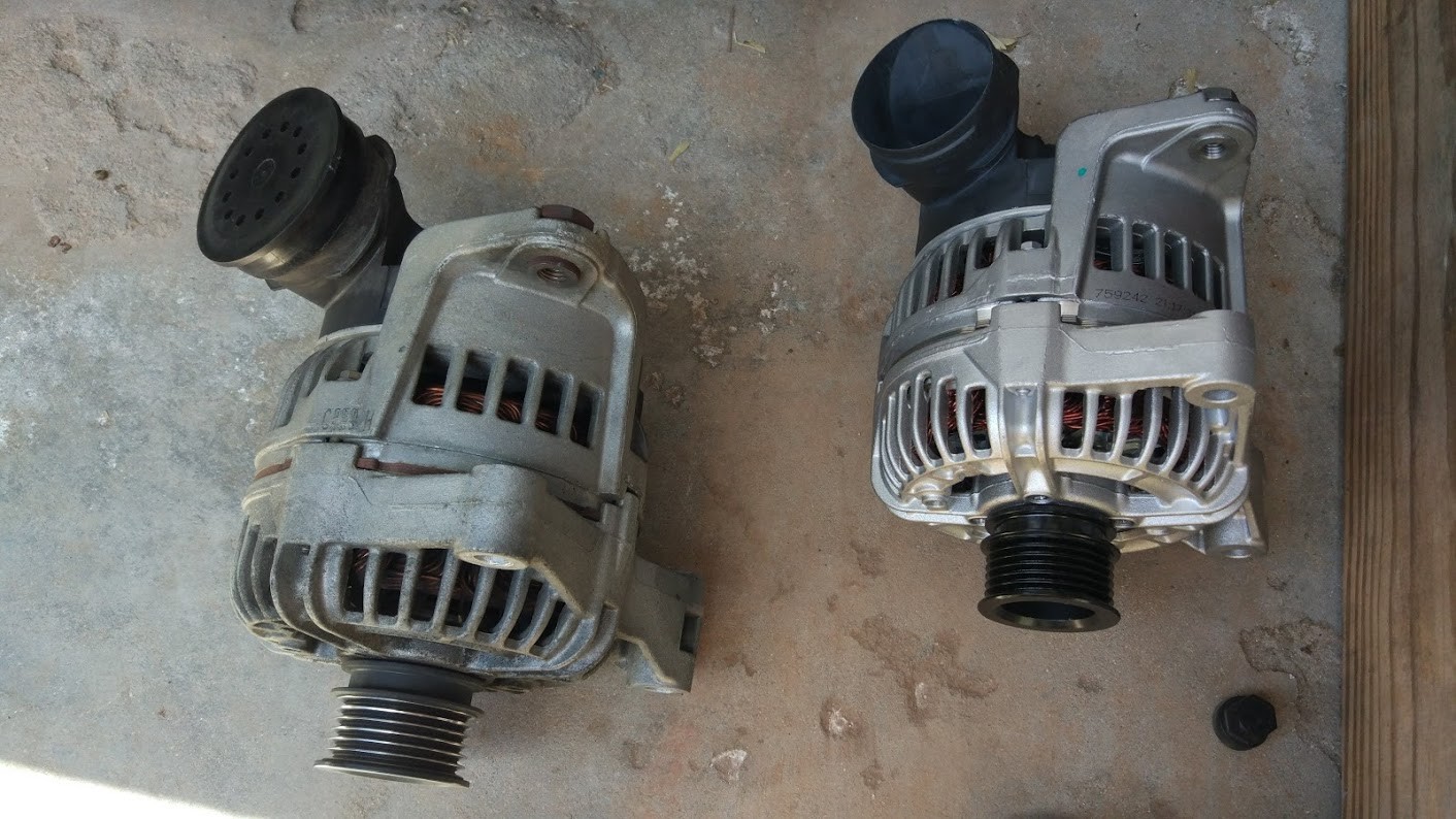

So first thing was to fix the "red battery light" issue.
First test was to make sure it is not the battery, because its the easiest to replace. even though its fairly new, I think 2 years at the time, the car was mostly standing for a year with me doing the work on fixing it myself. Test was a fail, because the battery light still came on with battery from other car, where the light wasn't coming on.
Went to Goldwagen and bought a new alternator. I lost out on a BMW logo, but saved +- R5000 over buying from dealer (even with discount).
After taking the old one out, I can now see what went wrong. Turning it over manually makes scratching sounds. Pretty certain its the brushes. Also now wish I paid more attention when I was a kid when my dad fixed alternators himself. So will be looking at reconditioning this one before selling it.
Old vs New:

At the same time, I also took out the headlights, removed the black inserts and replaced with the grey/silver inserts that goes with the corner indicators and cleaned up the cover inside and outside to give a clean shine. While cleaning the 1 cover, found its cracked at the top (not visible when on the car) and I believe that is where water goes in when washing, so swapped out with another cover I had lying around.

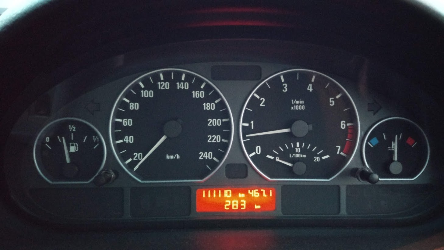

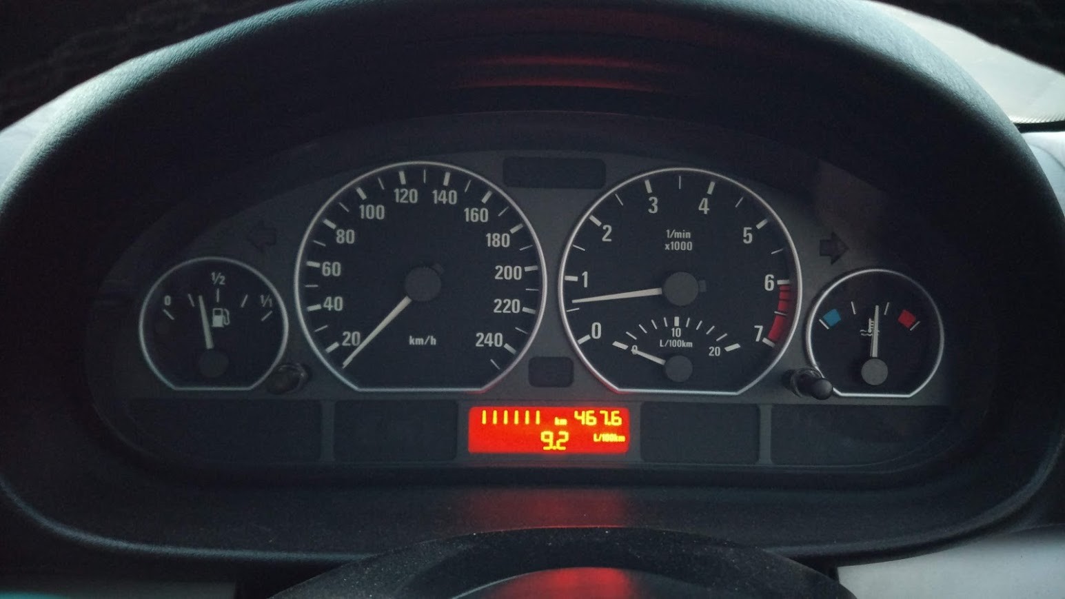

Car reached a small mileage milestone yesterday just before arriving back at home.

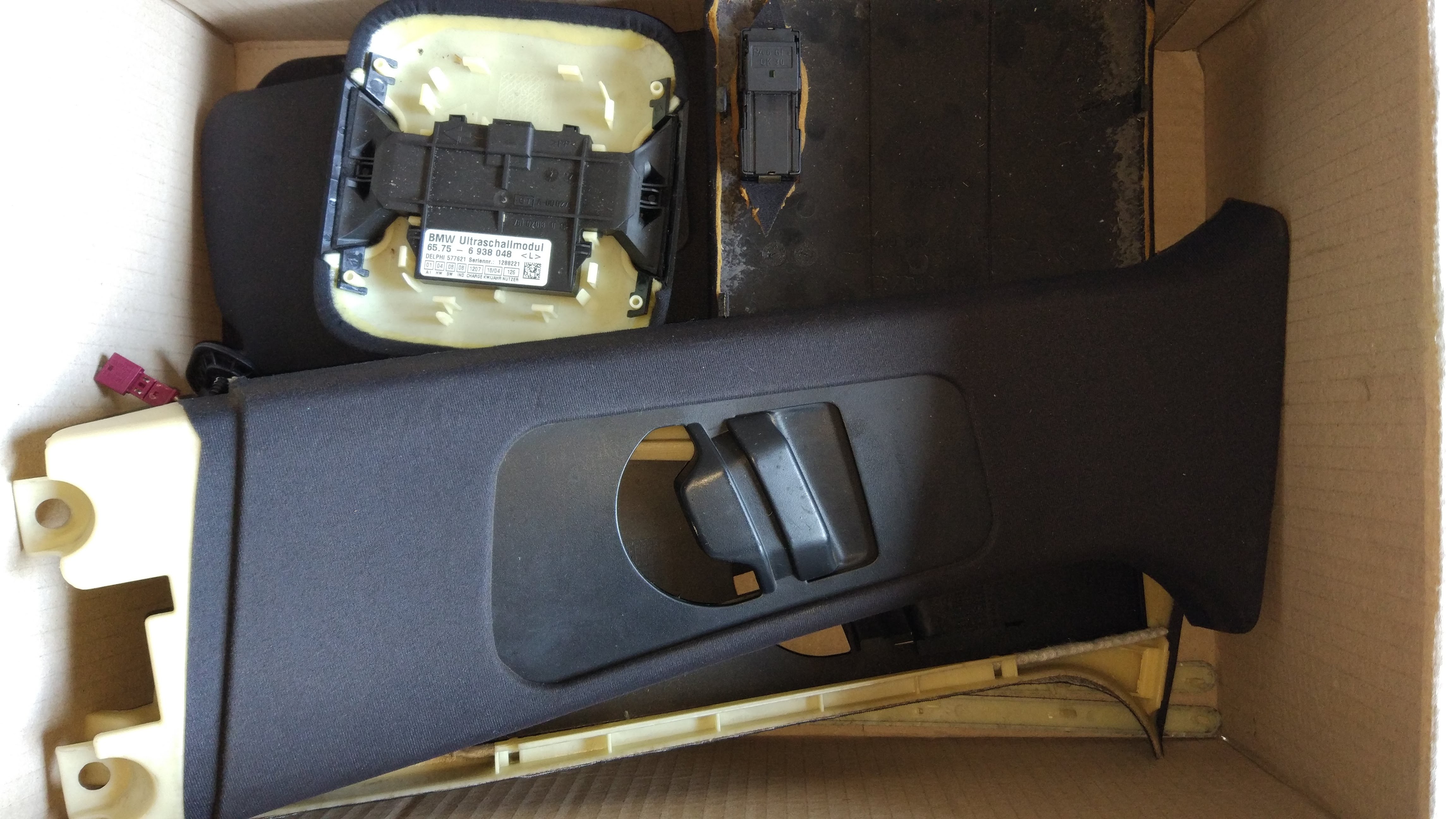

Small update.
July @evnmopwr visited.
Really excited as he was dropping off many goodies. Many thanks, this is a great guy and will anytime buy second hand parts from him again.

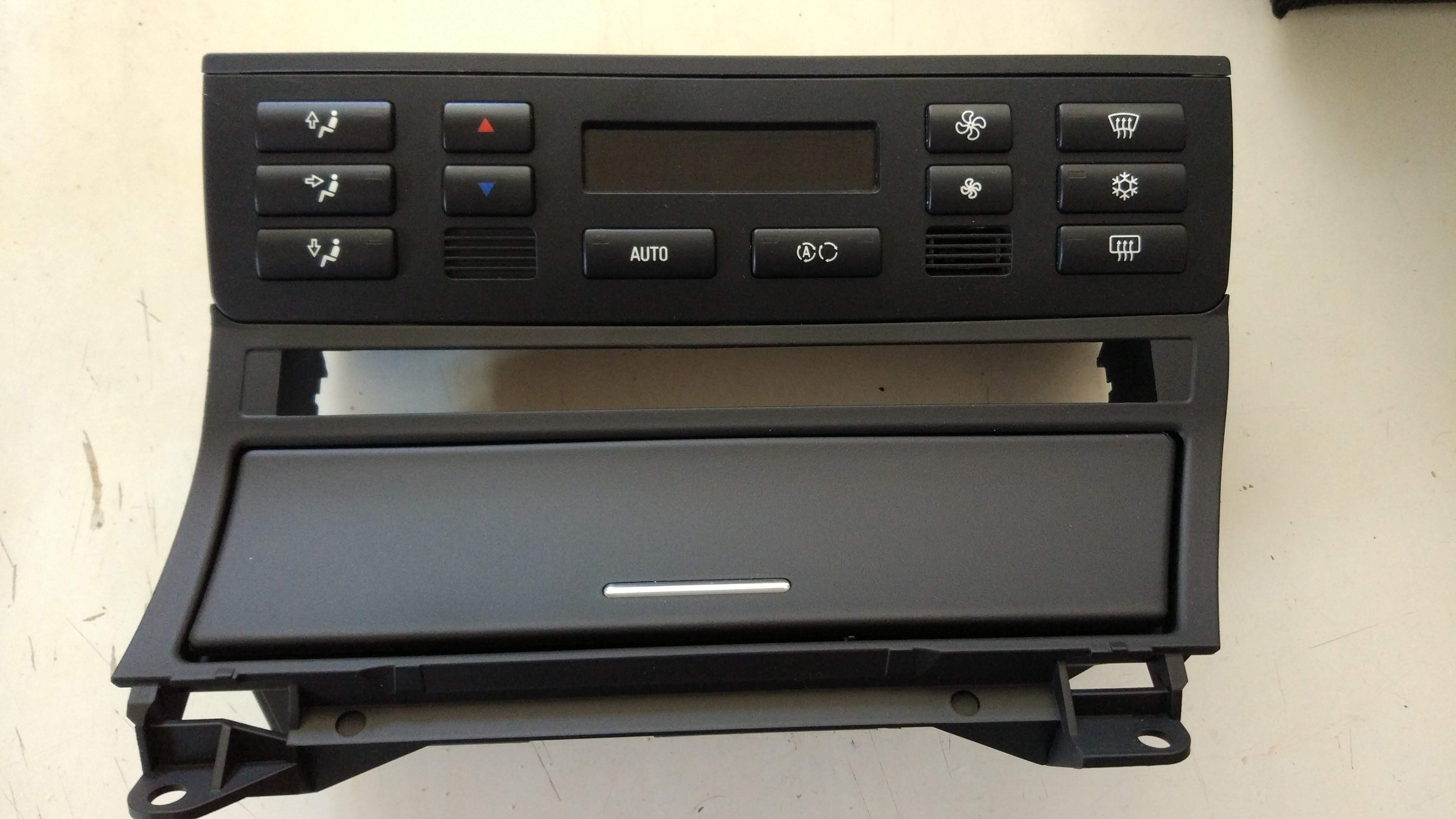

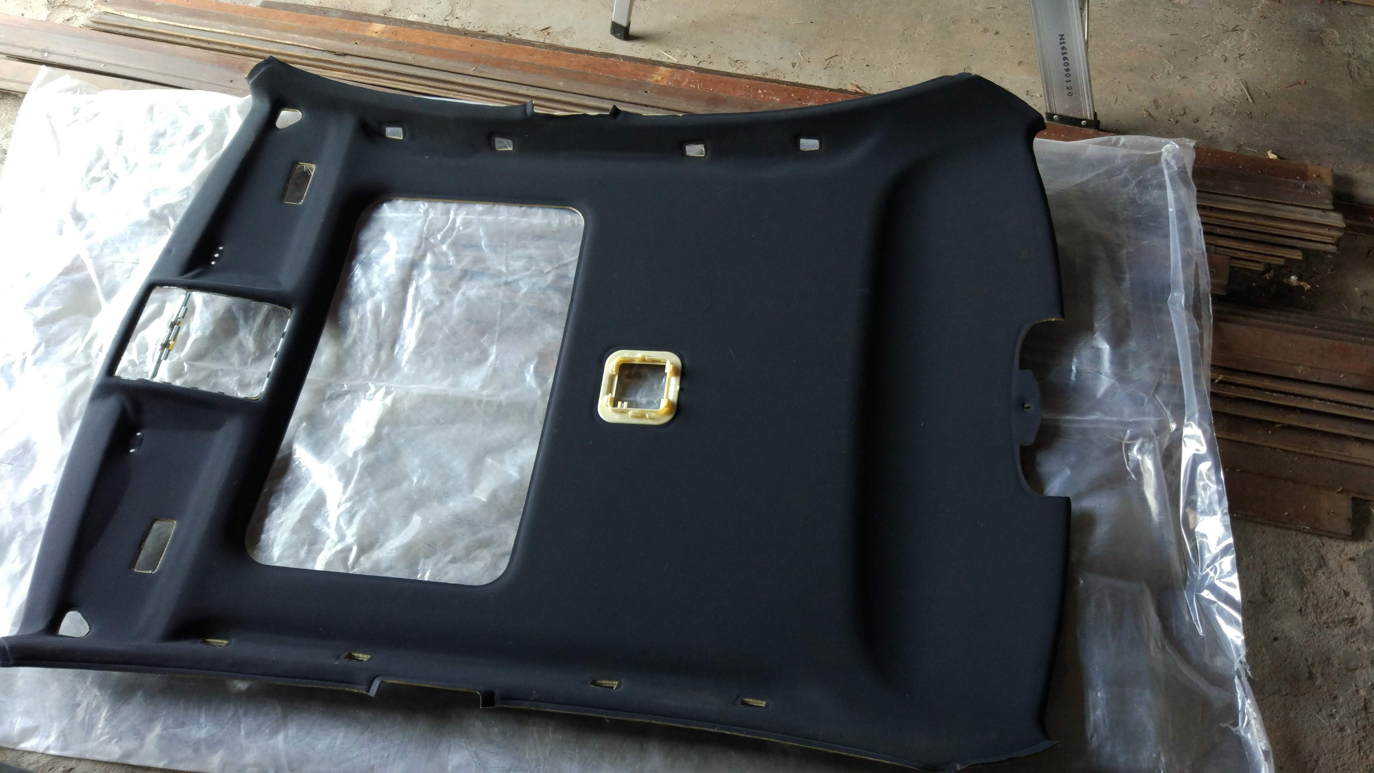

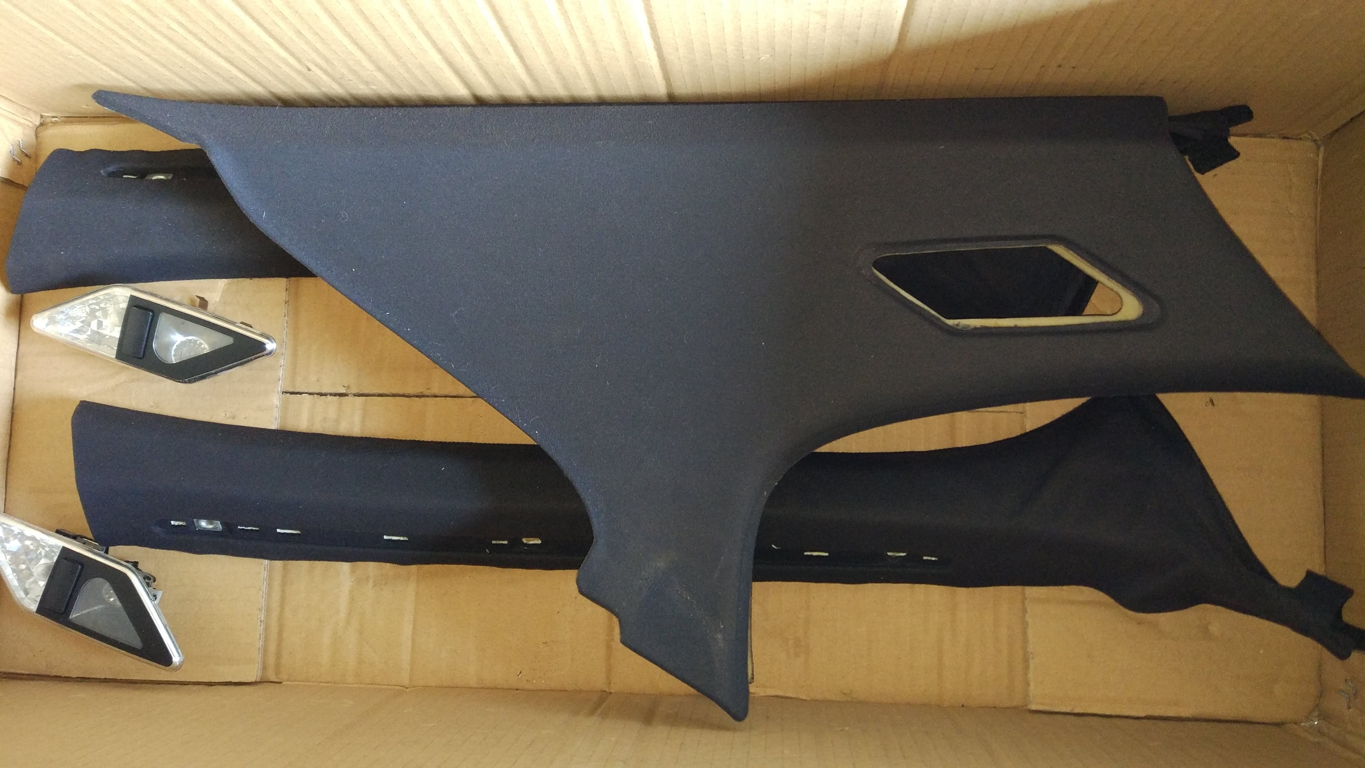

First, what I wanted the most:
They are not installed yet. I need to create new wiring if I want to do this properly. I tried my best to get my hands on BMW part# 61120140220 which is the conversion wiring harness, which would make this the easiest job in the world, but as it stands, I am going to have to figure this out myself. BMW doesn't sell it anymore. There is a guy in the US that has a set lying in his garage but not getting response from him at the moment.

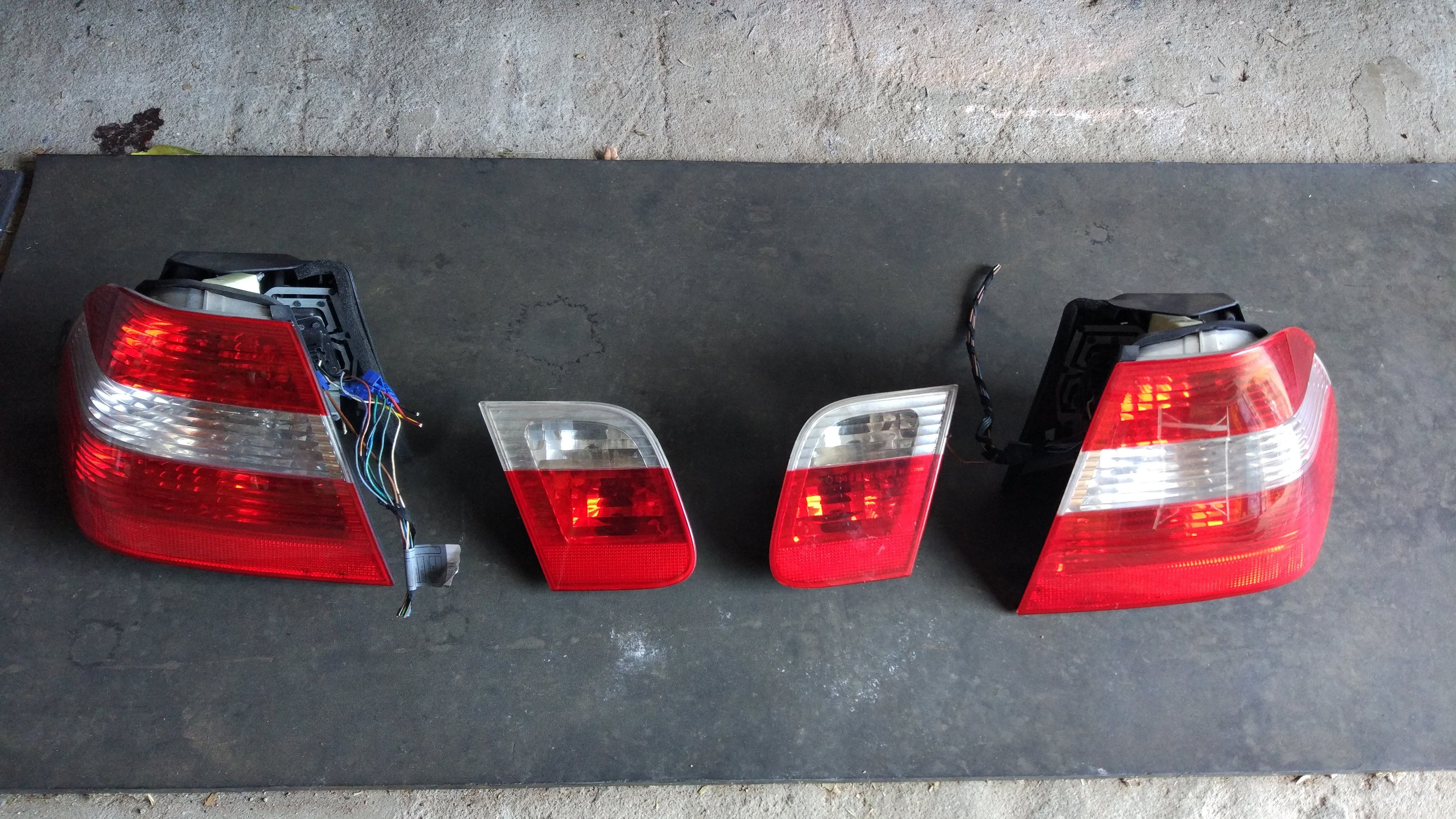

The other goodies:
All of the above in great condition, except for the a-pillars which I need to stick the material back on, but I am sure I will get that sorted out easy enough.
Now, I just need to find time to do all of this :fencelook:
