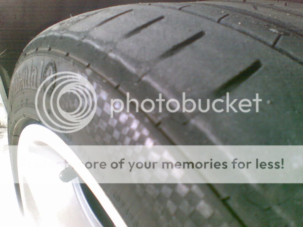

zero camber and tyre wear is quite evident from my last track day in the 320i when the front tyres got quite properly eaten on the sidewalls
calypso
Mine also looked exactly like that with 0 camber up front.
