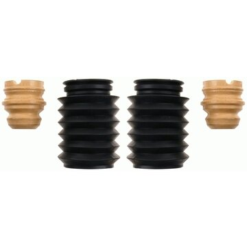

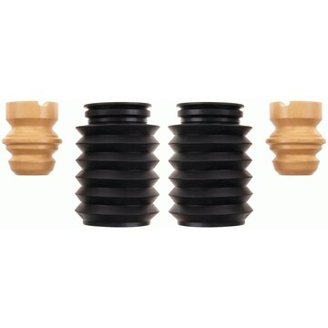

Try installing the M-sport bump stops if you have the normal suspension - this will give you more wheel travel and therefor more comfort.

Brilliant Tip - thanks for that Benji - I will definitely buy the M Sports Bump Stops - I see that they are shorter and that is PERFECT for me.

To be honest I don't know what parts I need - my front OEM shocks are finished after 200k - so I need new ones. My mechanic said DEFINATELY get new strut mounts and stabilizer links - but to be honest I don't know for 100% - I don't have the money to replace everything. I assume the dust cover are finished and they are cheap so that is why I wanted to replace. My mechanic said don't bother - he thinks dust covers are useless.
I have a new update - I called 3-4 people at ZF Aftermarket in South Africa - the distributor / importer for Sachs and Lemforder - after a few days a senior regional manager called me back and told me this - BMW OEM Sachs shocks parts from Germany are EXACTLY the same as the ZF Aftermarket parts - there is ZERO difference in grade or specification... just one goes in a blue box and one goes in a brown box - one is labelled BMW OEM one is labelled Sachs aftermarket.... so therefore I decided to rather buy Sachs Shocks, Mounts and Bump stops and Lemforder Stabilizer links Aftermarket for a 66% cheaper then BMW OEM for exactly the same parts except the Lemforder.
Once installed I will update again to say what the car drives like and if I am happy.
And thanks again Benji - I ordered the sports suspension shorter Bump Stops
