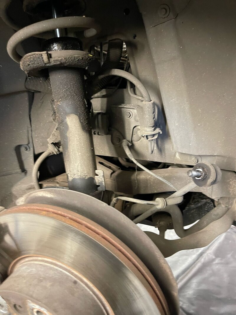

The vehicle came in for the following:

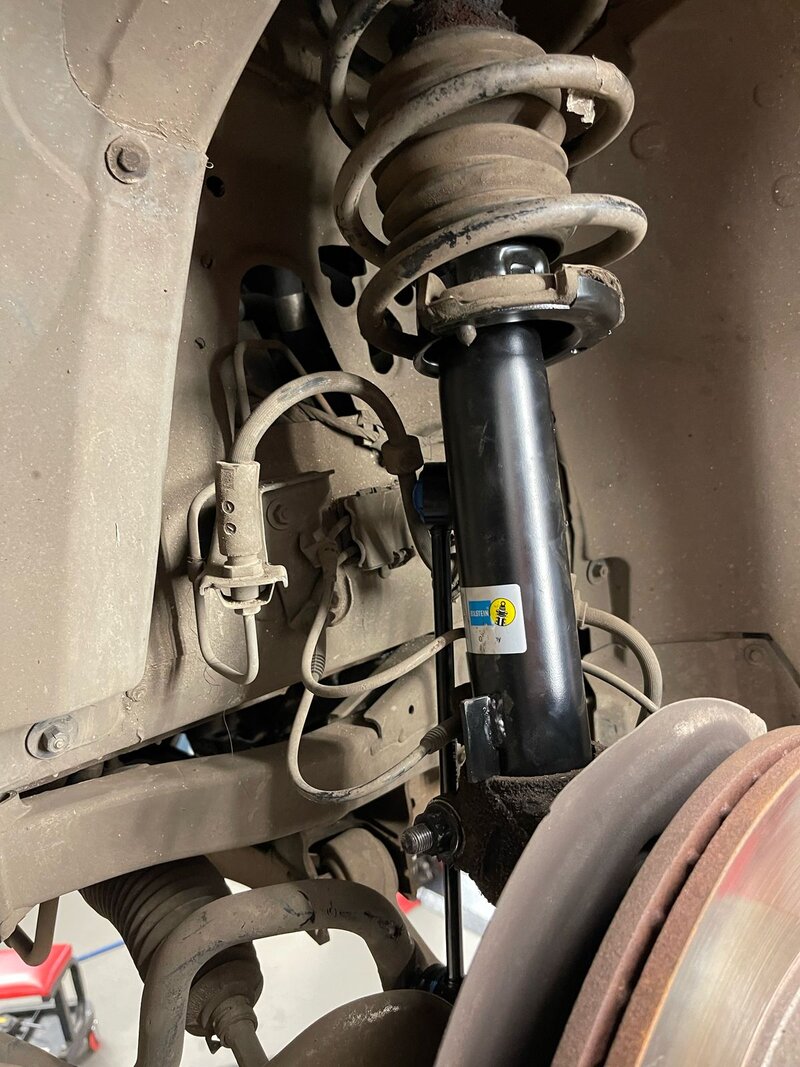

Front:

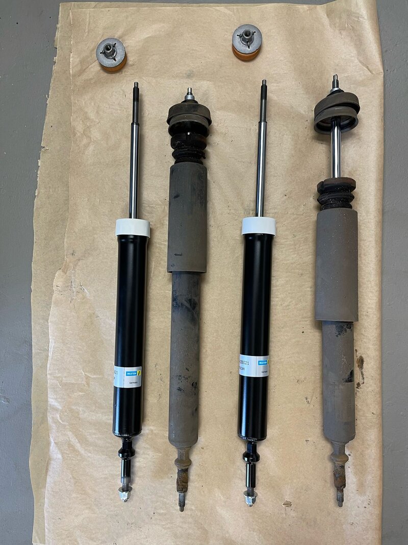

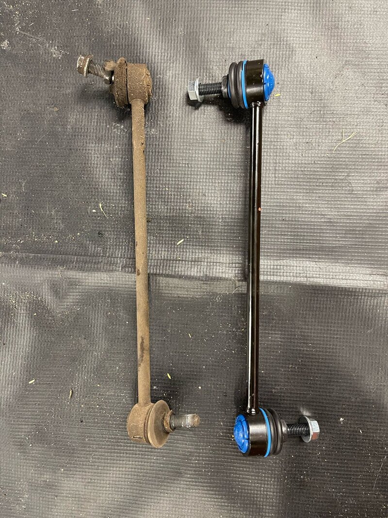

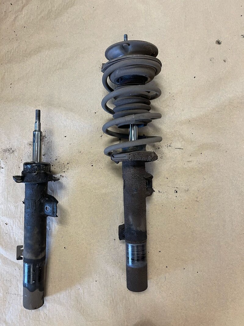

  • New Bilstein shocks
  • Shock mounts
  • Stabilizer (sway bar) end links

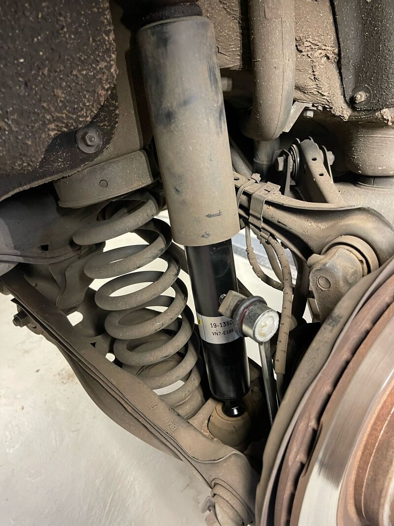

Rear:
  • Rear top mounts

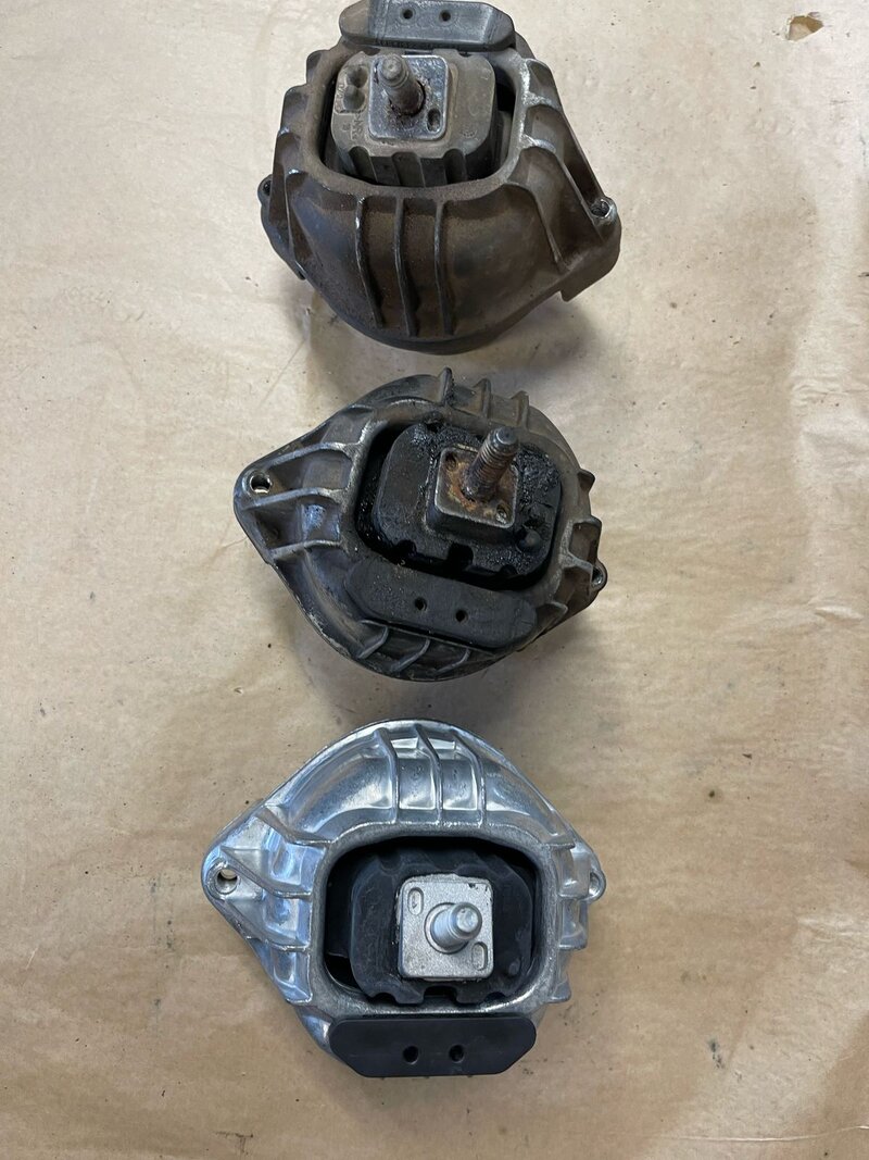

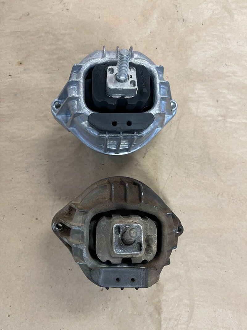

Engine Bay:
  • Replacement of both engine mounts
🛠️ Installation Process

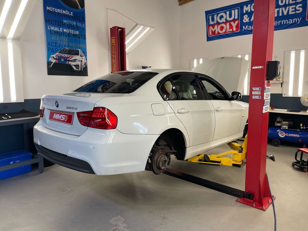

Once the vehicle was dropped off with all the parts, we got started:

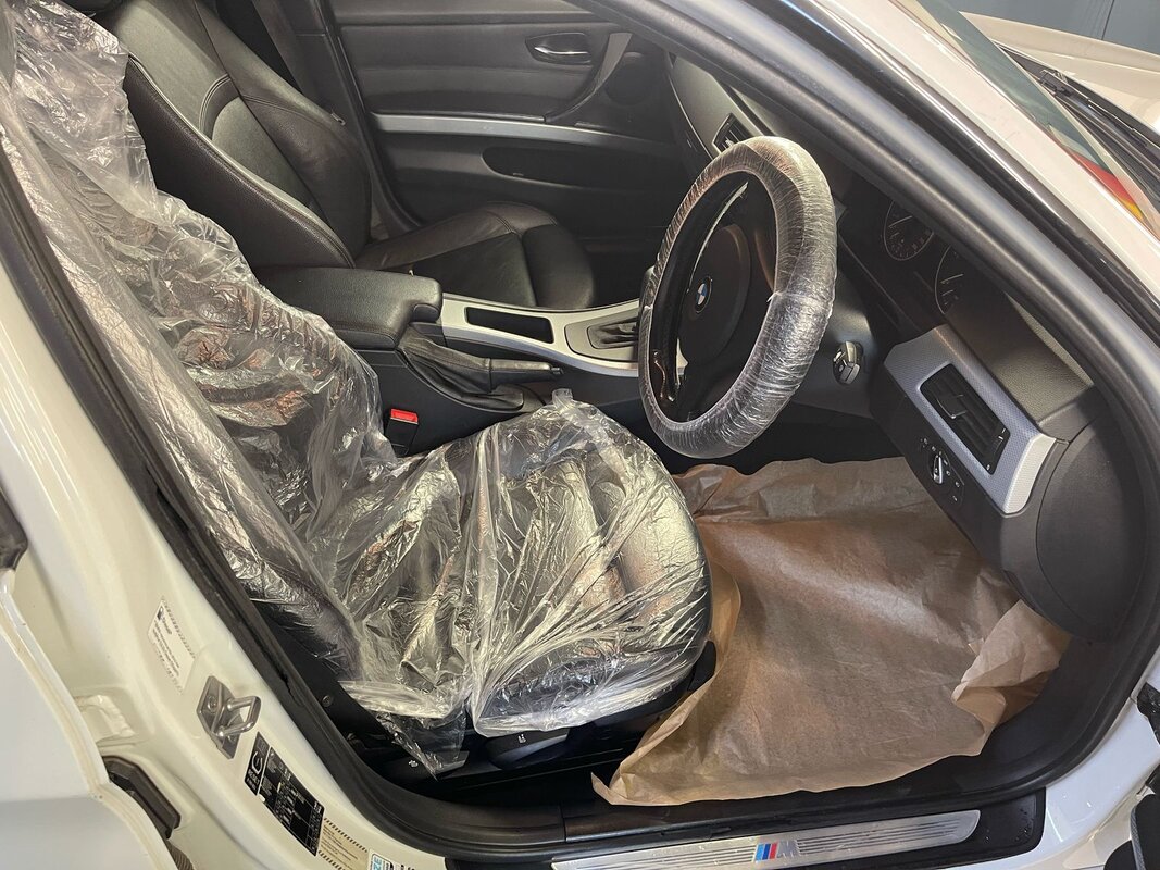

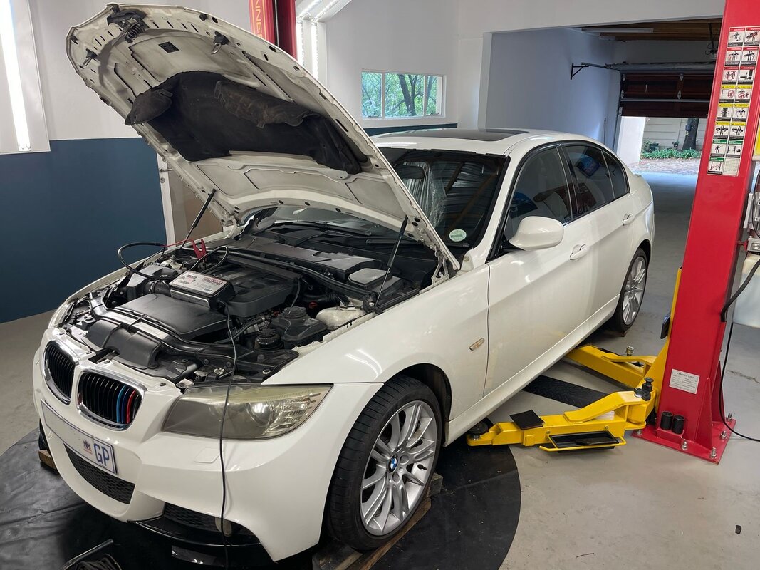

✅ Fitted interior protection (steering wheel + driver’s seat)
✅ Moved the car onto the lift and removed all four wheels

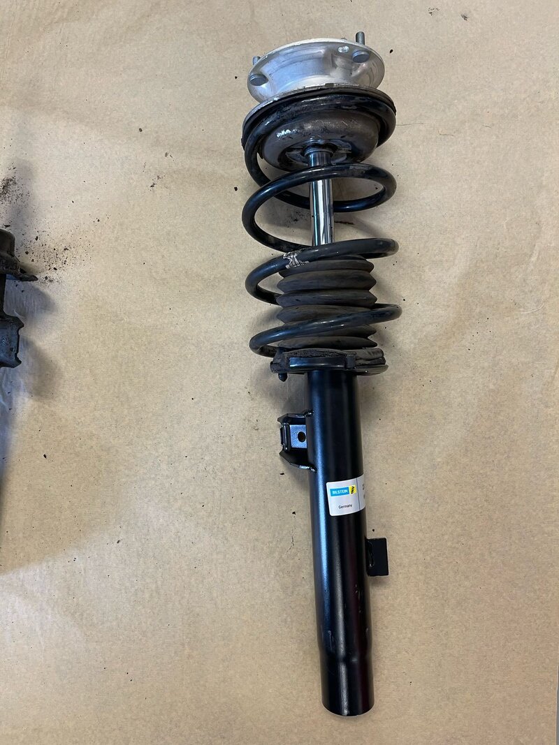

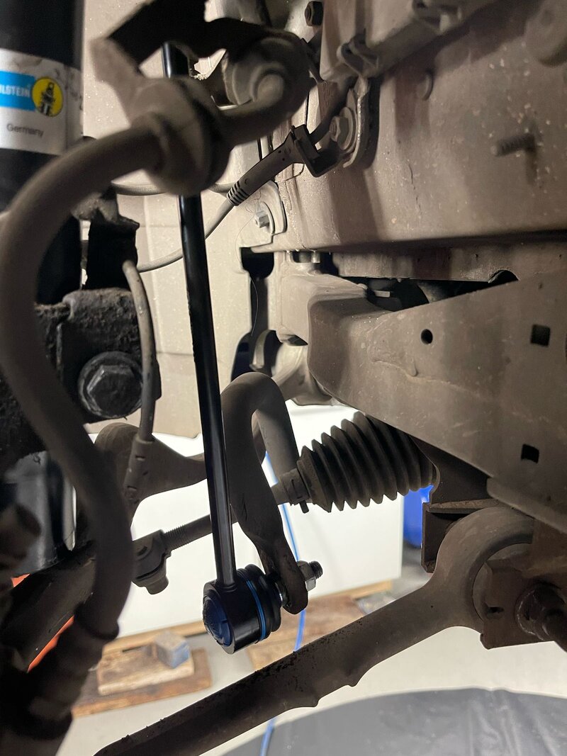

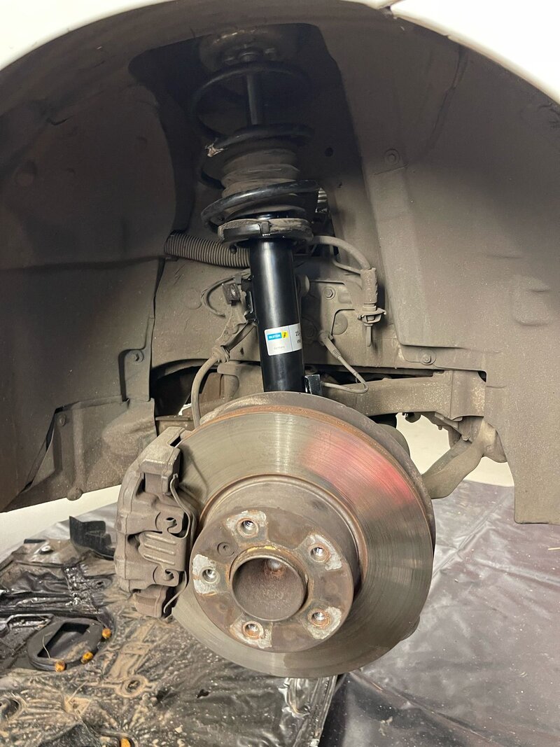

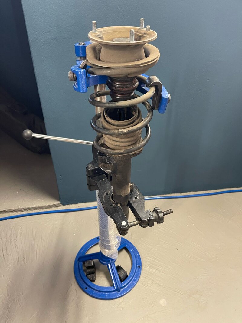

Front Suspension:

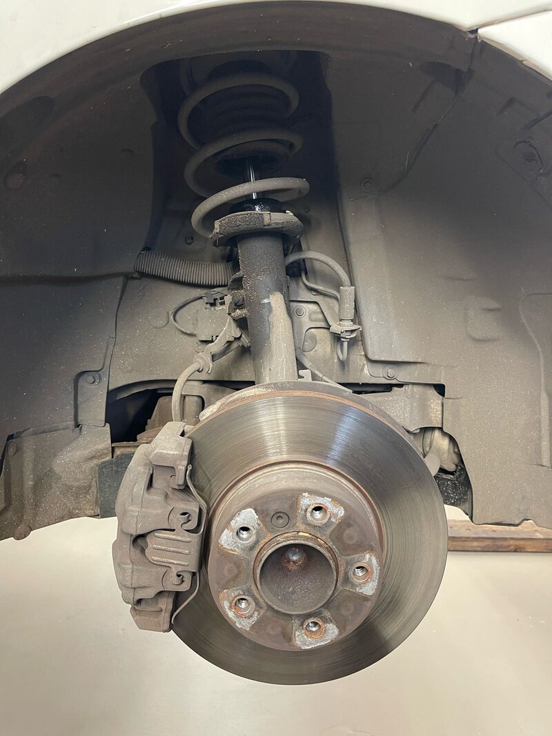

  • Removed both front struts

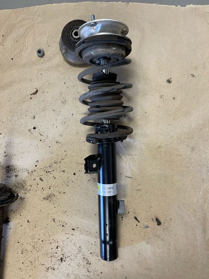

  • Swapped over coil springs, spring pads, dust boots, bump stops, and top plates
  • Installed everything onto the new Bilstein front shocks with fresh mounts
  • Fitted new stabilizer end links and reinstalled the struts

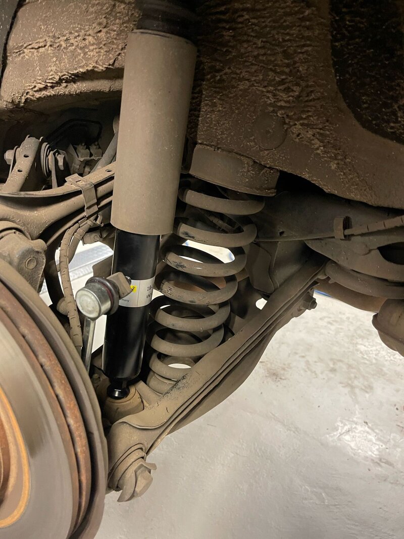

Rear Suspension:
  • Stripped the boot lining
  • Removed and replaced the rear shocks, top mounts, and stabilizer links

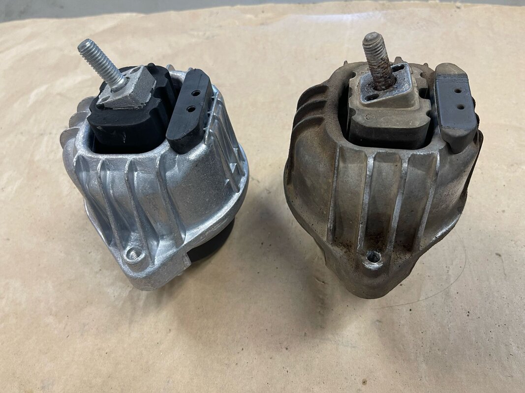

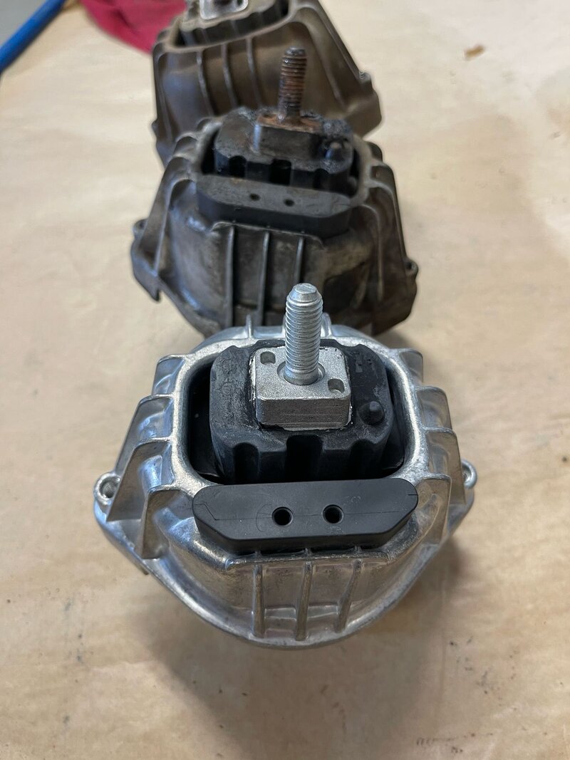

Engine Mounts:
  • Supported the engine
  • Removed both worn mounts and replaced them with the new units

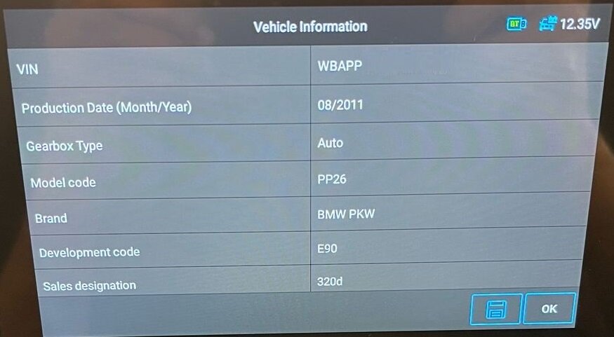

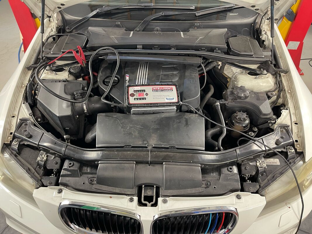

🔋 Diagnostics & Final Checks
  • Placed the vehicle on battery charge while wrapping up
  • Ran full diagnostics, cleared stored fault codes.

The old shocks were completely worn out and leaking, providing little to no damping.
After fitting the new Bilstein setup, the ride quality saw a massive improvement — tighter handling, better road feel, and overall more confidence behind the wheel.
The new engine mounts also made a noticeable difference, significantly reducing cabin vibration and engine harshness.
