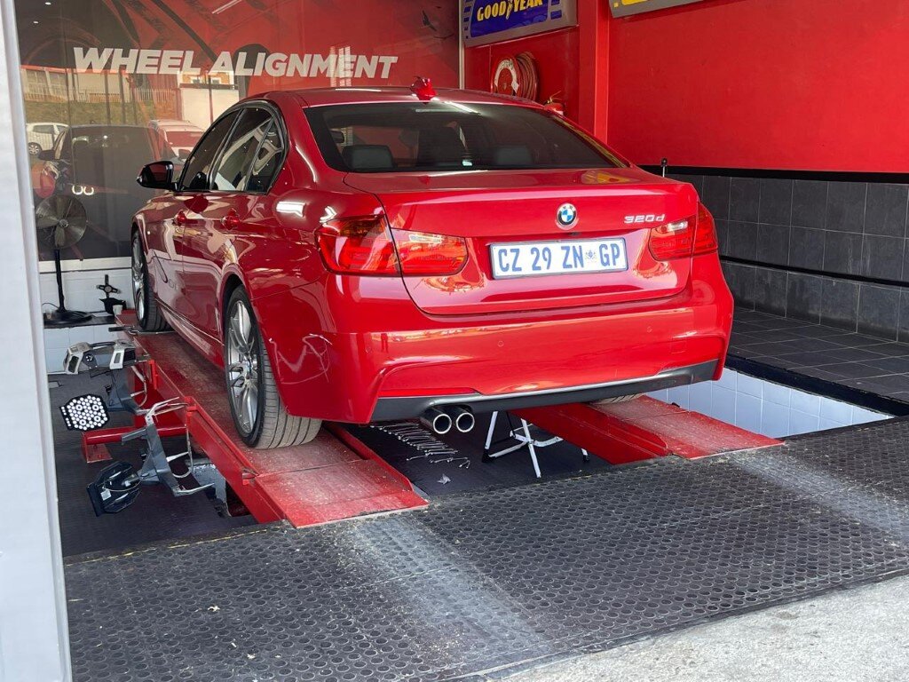

I forgot to mention in the previous update that, before dropping the car off at Apex for the detail, I took it in for its proper wheel alignment.
Happy to report that everything is going really well.
The new front suspension has completely transformed the way the car drives. Everything now feels solid and tight, the steering is much more direct, and the combination of the new ball joints, tie rods and steering rack thrust-bush repair has removed the play and looseness that was there before.
Going over bumps and uneven roads is probably where the difference is most noticeable. No more knocking or clunking from the front end — everything just feels properly damped and controlled now.
Honestly, it’s delightful to drive.

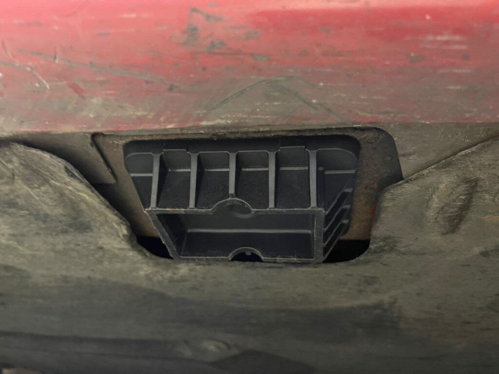

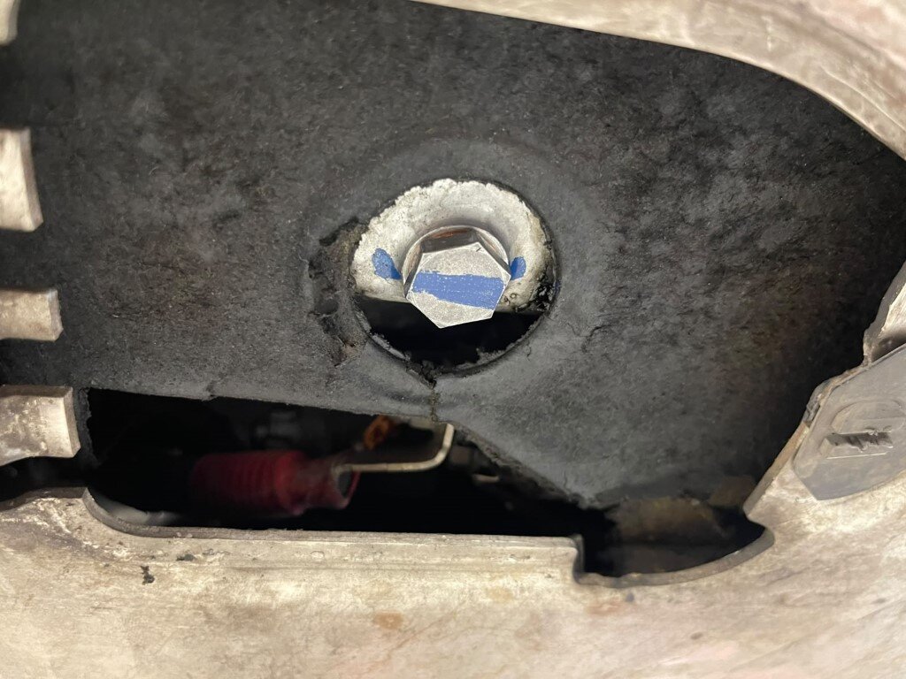

While I was underneath the car previously, I also noticed that the front driver-side jacking point was missing, so I sourced a new one and fitted that as well. Small thing, but another item off the list.

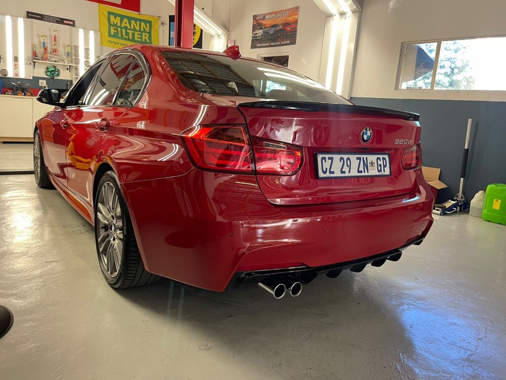

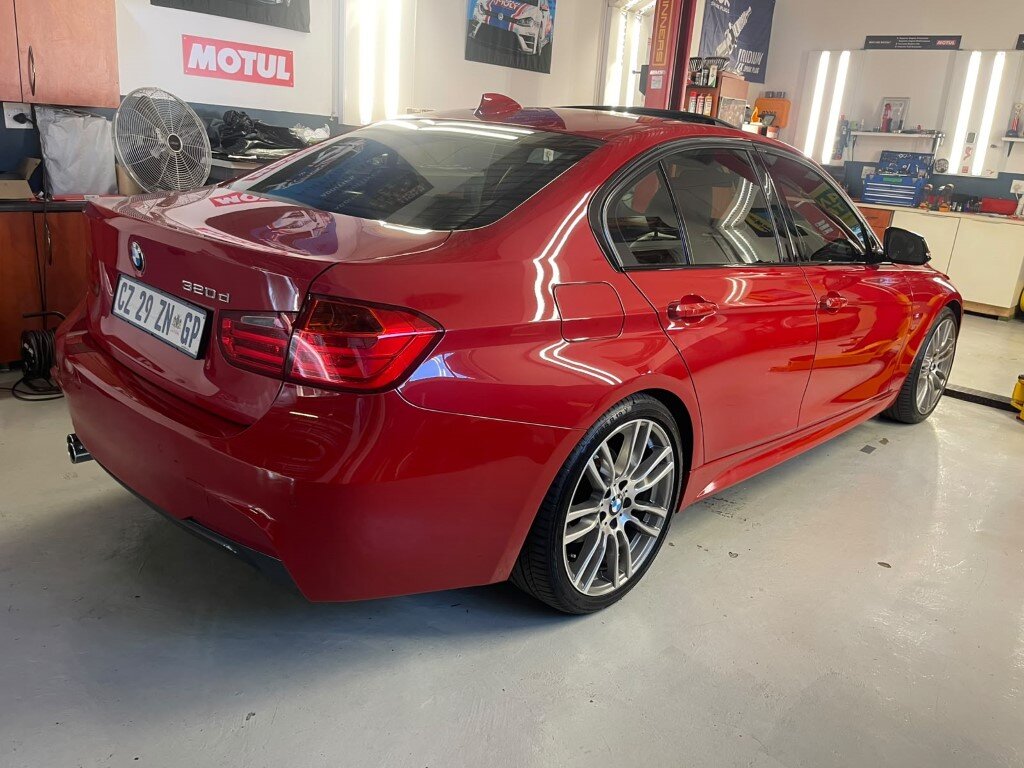

Now that Apex had finished detailing the car and the Melbourne Red was looking fresh again, I figured it was finally time to fit some of the gloss black cosmetic bits I had been collecting.

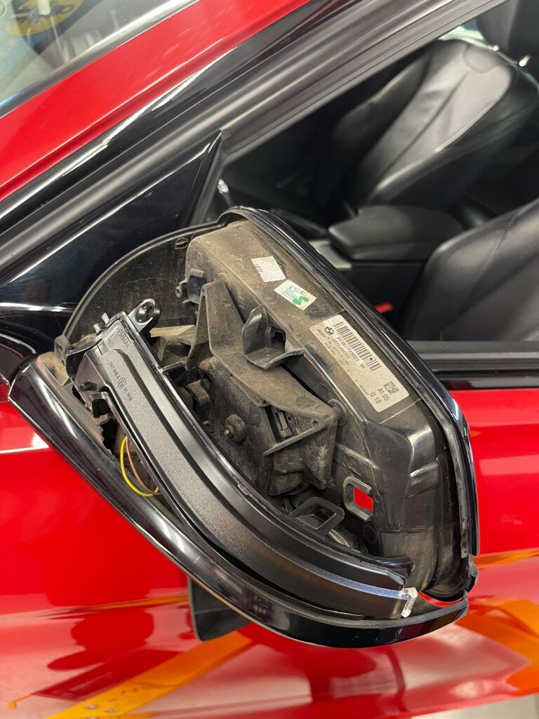

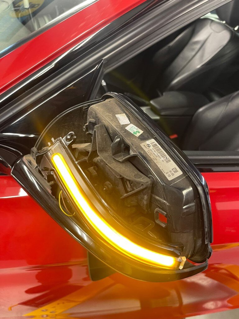

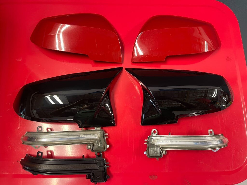

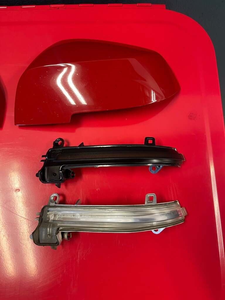

First up were the easiest ones — the mirror caps and smoked LED indicators.
The mirrors were stripped, the new indicators fitted, and everything reassembled with the gloss black mirror caps.
WhatsApp Image 2026-09-26 at 22.00.32 (2).jpegWhatsApp Image 2026-09-26 at 22.00.31 (3).jpeg
WhatsApp Image 2026-09-26 at 22.00.32.jpegWhatsApp Image 2026-09-26 at 22.00.32 (1).jpeg

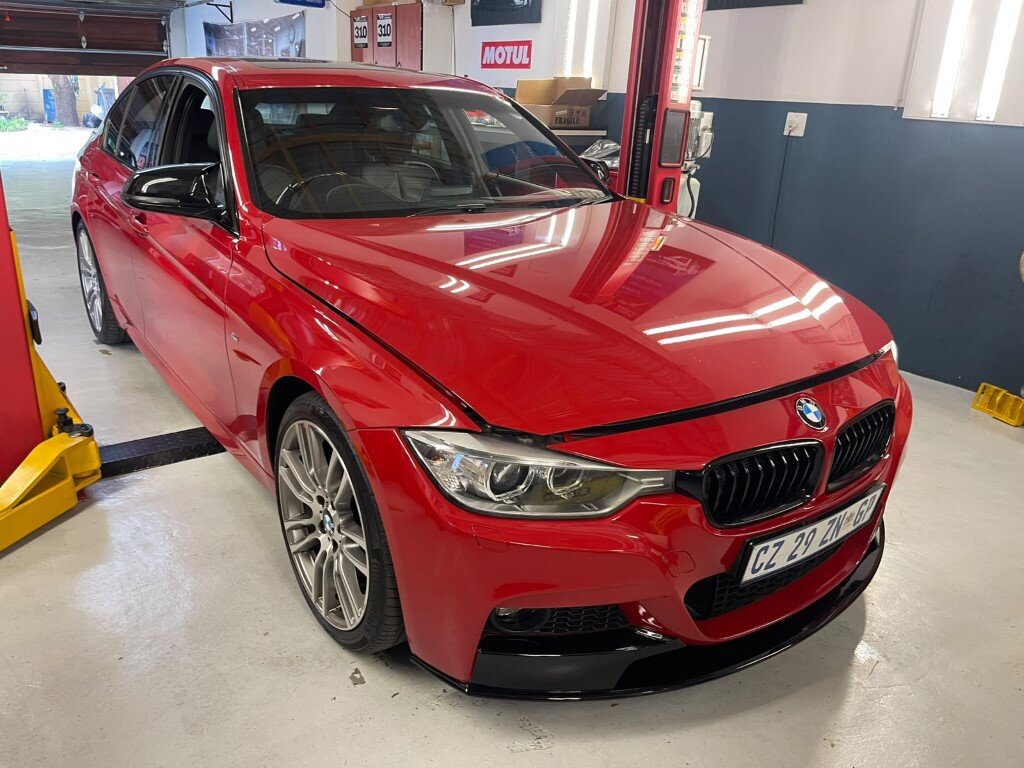

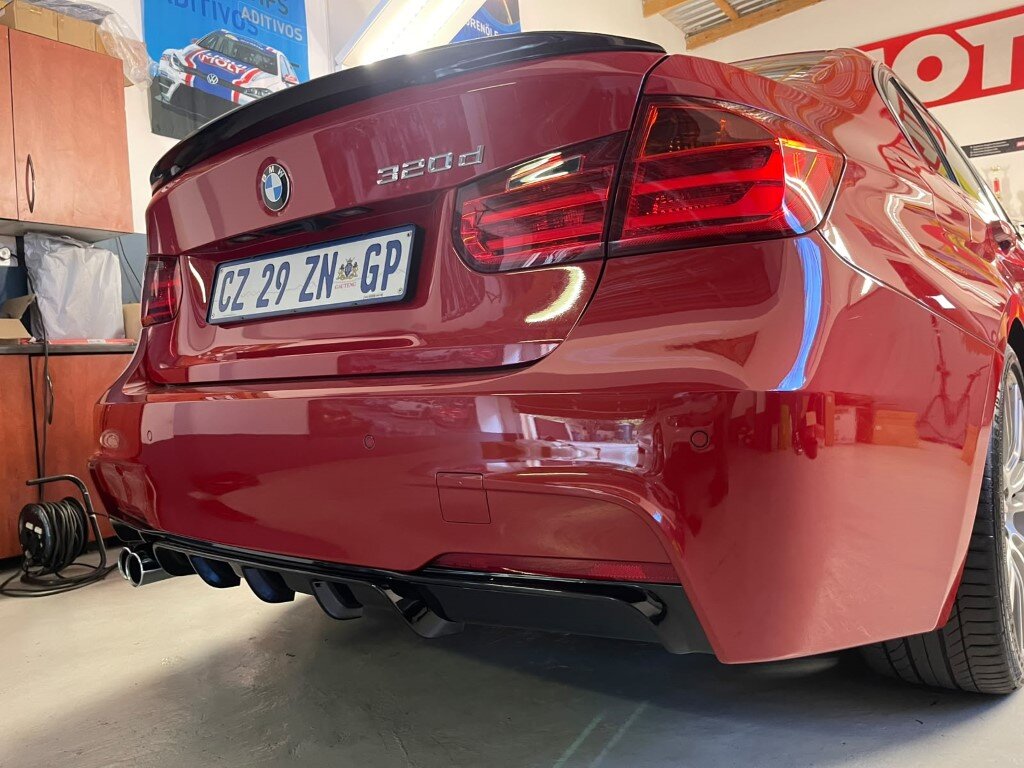

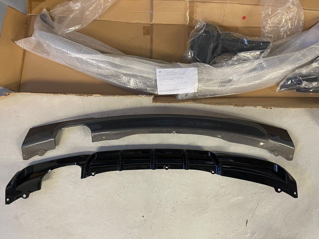

So I fitted:
  • Gloss black mirror caps
  • Smoked LED mirror indicators
  • M Performance-style boot spoiler
  • Gloss black rear diffuser
  • Gloss black front lip spoiler
I originally bought mud flaps and double-slat front grilles as well, but I’ve decided not to fit them for now.
I actually really like the way the car looks in its current form and don’t want to overdo it.
I may still add gloss black side-skirt extensions later, but for now I think the exterior is pretty much where I want it.

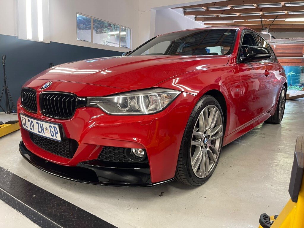

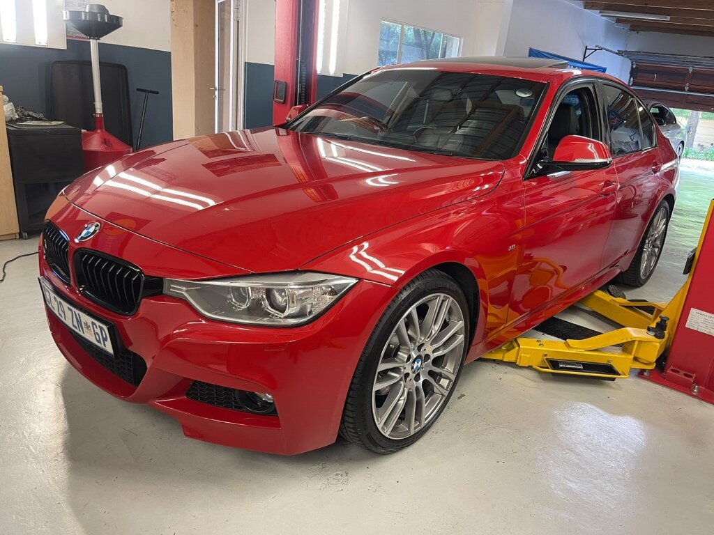

So we went from this:
To this:
It looks so good now.

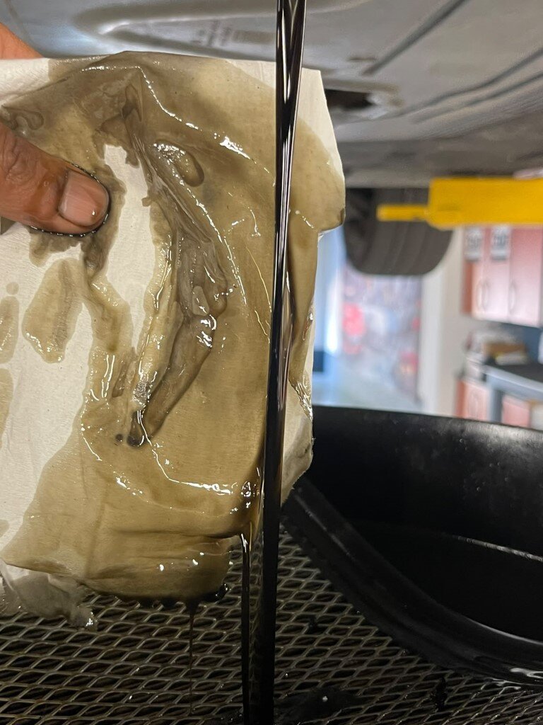

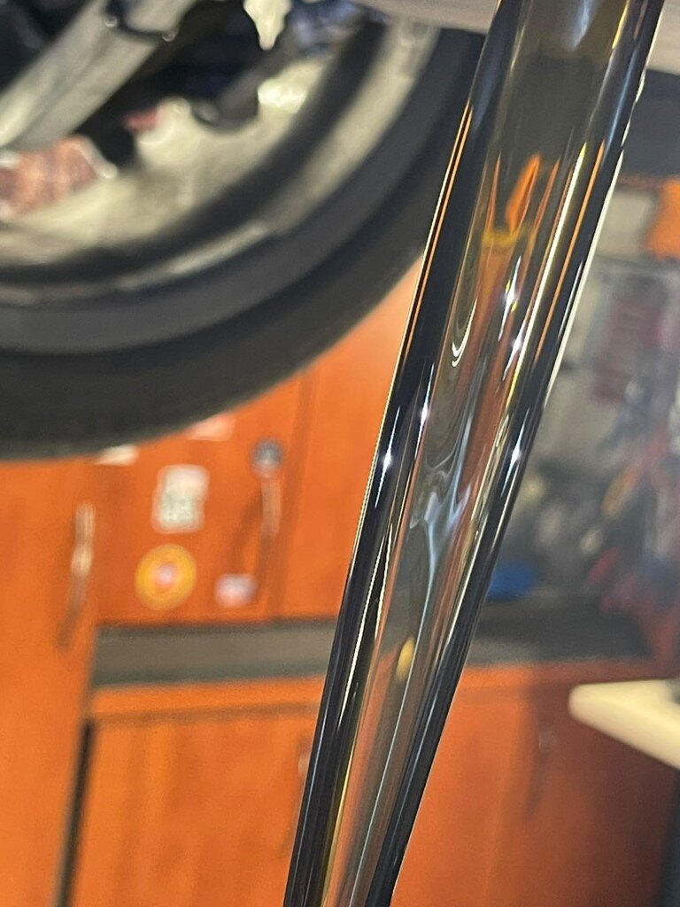

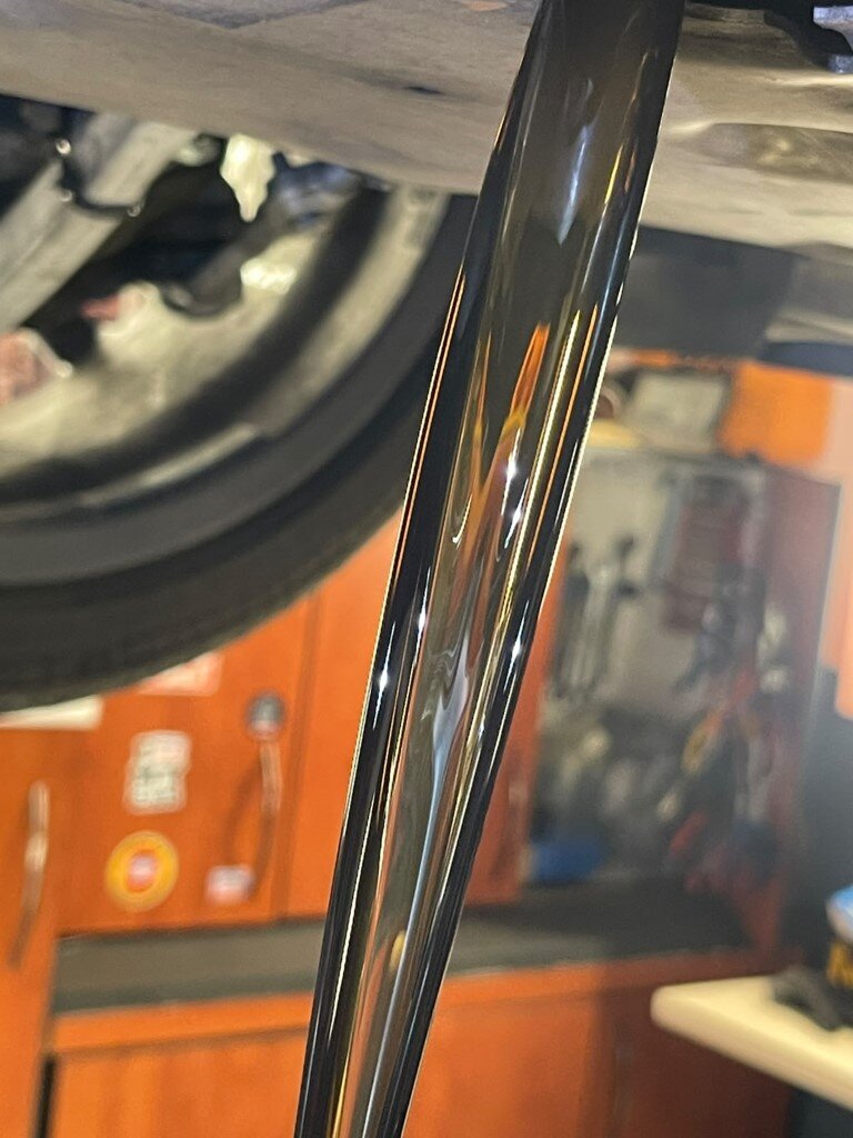

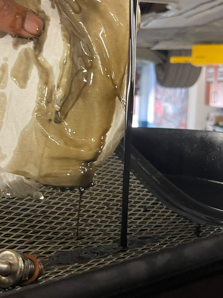

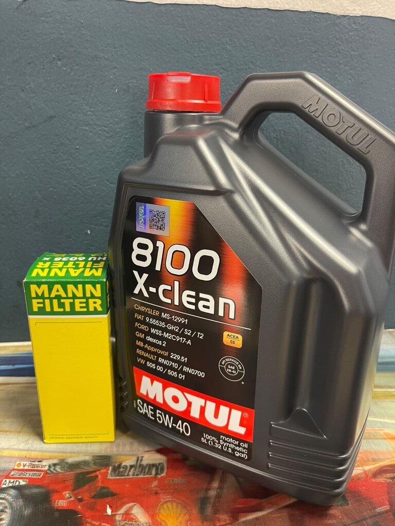

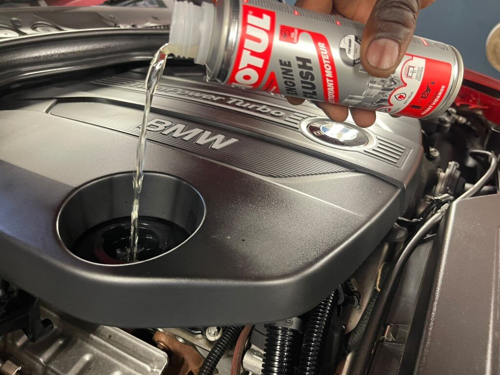

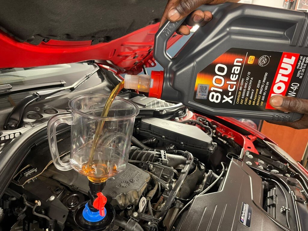

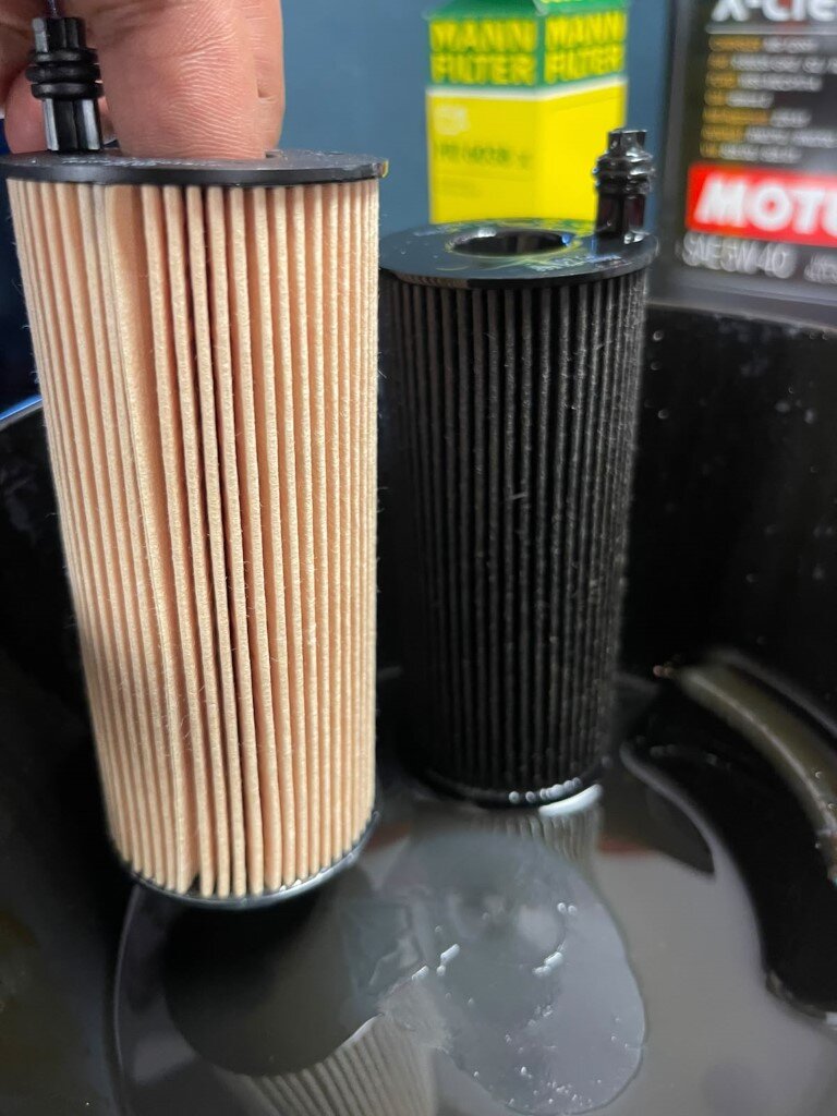

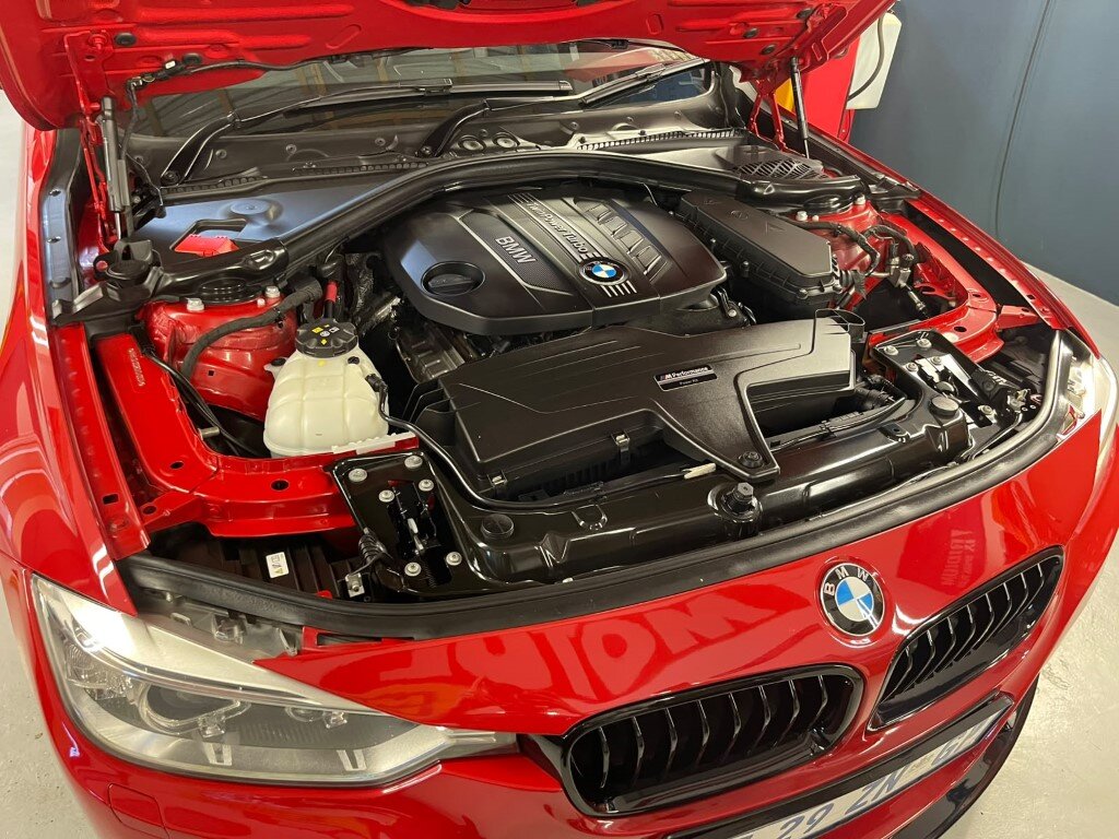

Next up was another engine oil service
I’ve done roughly 300 km on the oil since the previous change and wanted to see what it looked like after using that short interval as a bit of a clean-out.
When I previously looked inside the valve cover, the engine looked extremely clean with no visible sludge or nasty build-up, so I was expecting the oil to come out fairly clean.

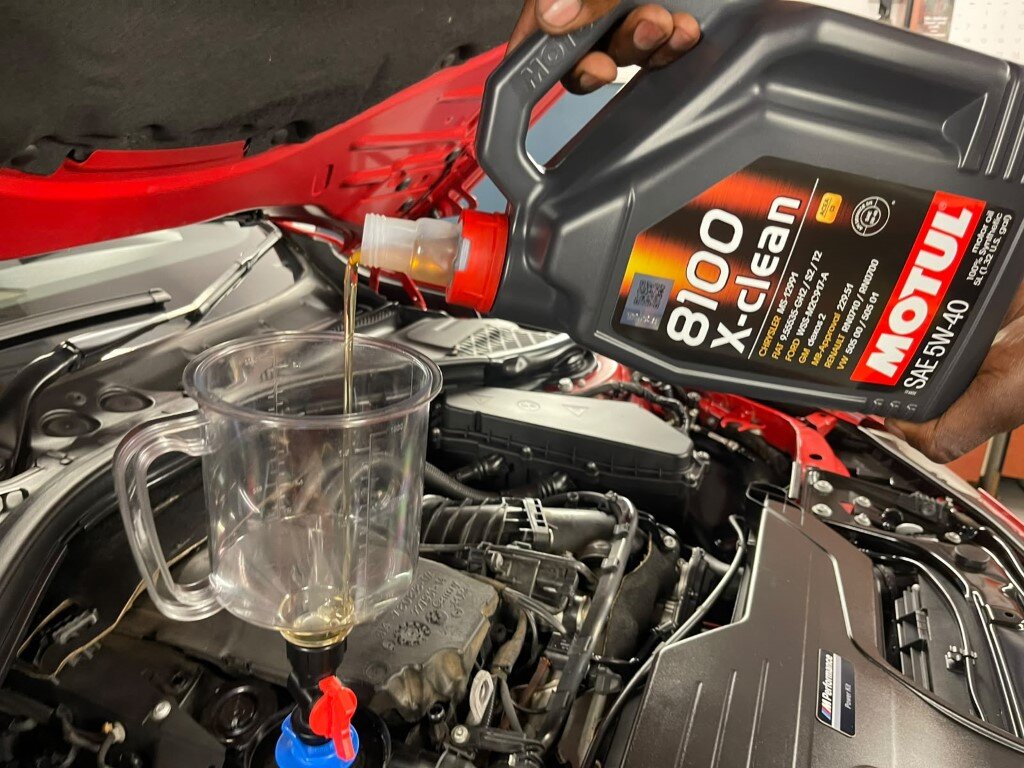

The car went back onto the lift and I ran another engine flush through it before draining the oil.
After Flushing the engine, the Oil Filter was removed
Once the drain plug came out, it was pretty much what I expected — the oil was still fairly clean with only some light discolouration.
I let it drain properly, fitted a new crush washer and closed everything up.
The engine then finally got the good stuff: 5.2 litres of Motul X-clean 5W-40.
So that completes the short-interval oil-cleaning phase for now.

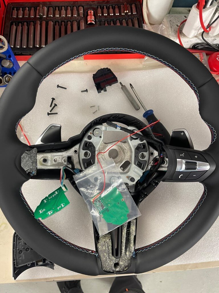

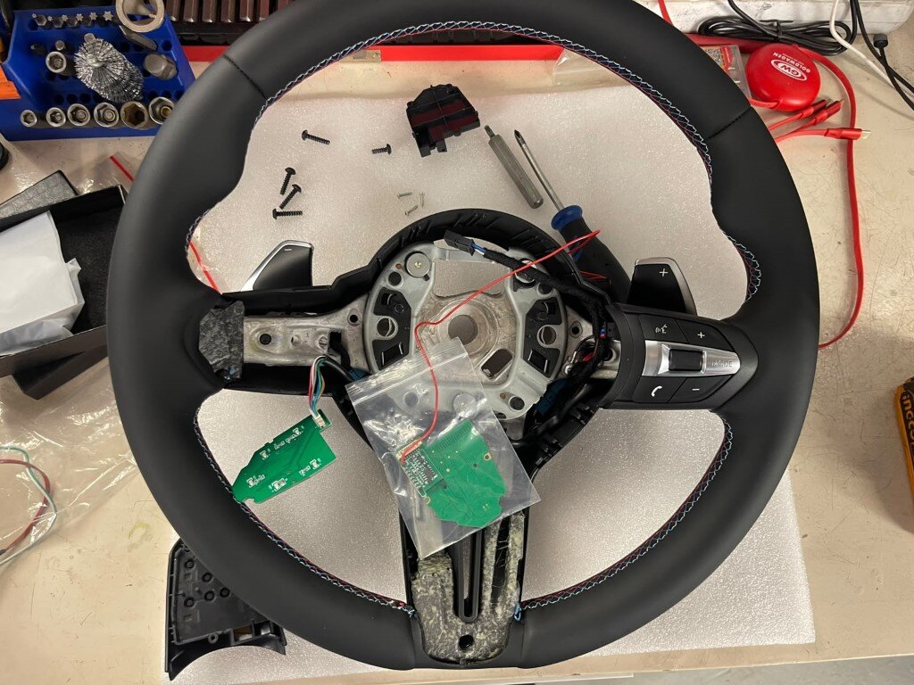

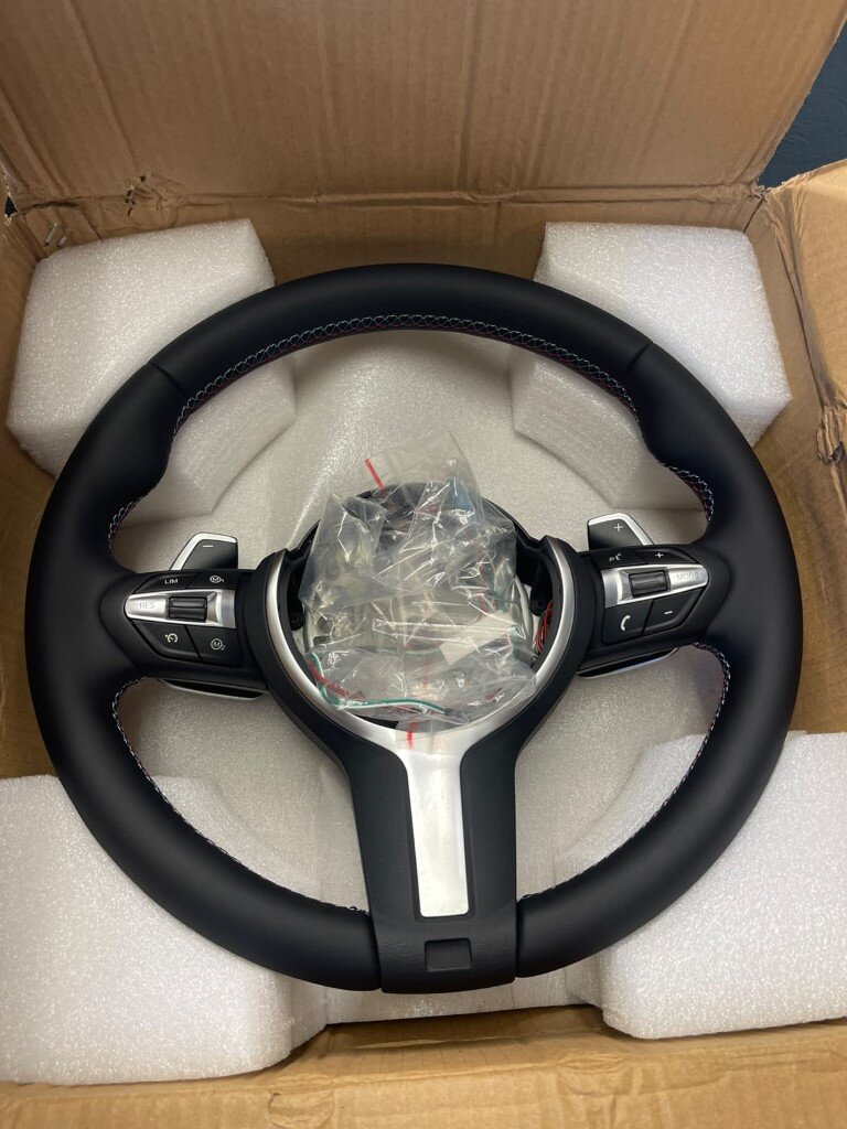

Then onto the next little project — paddle shifters.

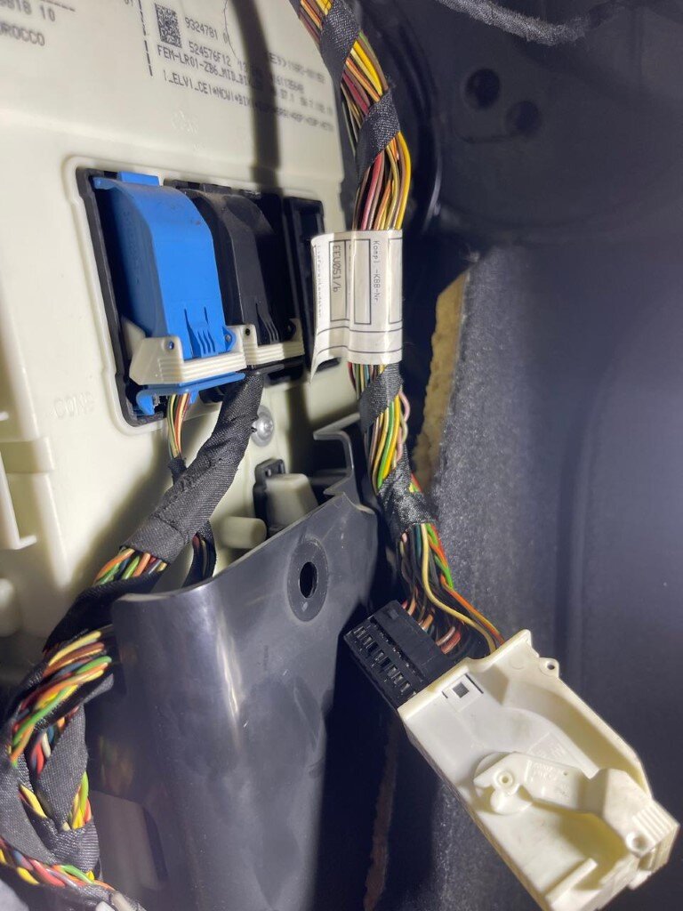

My car unfortunately isn’t wired from the factory with the paddle signal wire at FEM pin 5.
I’ve ordered the MQS terminals, wire and the other small bits I need to make the harness, but those seem to be taking forever to arrive.
In the meantime, I managed to source a new M Sport steering wheel fitted with paddle shifters, as well as M1 and M2 buttons.
I’ve also sourced and fitted the additional button module to the steering wheel that will allow the M1 and M2 buttons to cycle through the driving modes.
So most of the steering-wheel side is now ready.
All that remains is to make up the signal wire, run it between the steering column and FEM, and then swap the new steering wheel onto the car.
Once it’s fitted and wired, I’ll see what coding is still required to get everything working properly.
So another decent bit of progress.
Mechanically the car is now driving beautifully, the suspension and steering finally feel the way they should, the paintwork is looking fresh again, the gloss black bits have sharpened up the exterior nicely, and the paddle-shift conversion is slowly coming together. Theres also the Cooling system refresh which i have also been collecting parts for but will maybe get to that next month sometime.
More to follow.

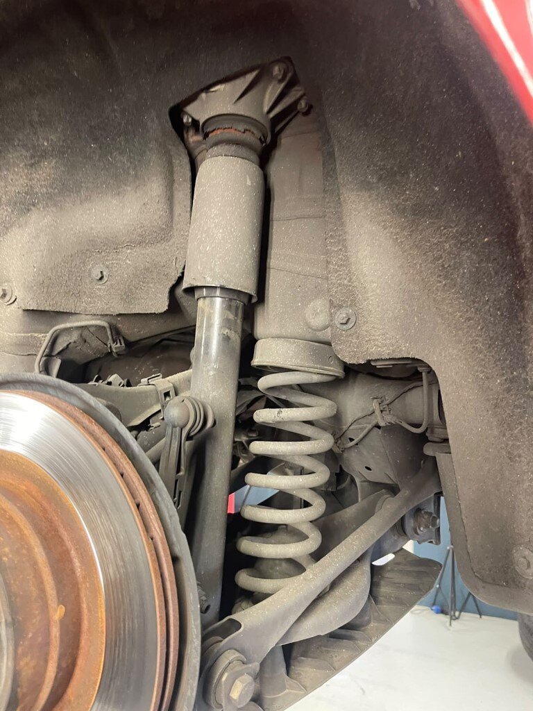

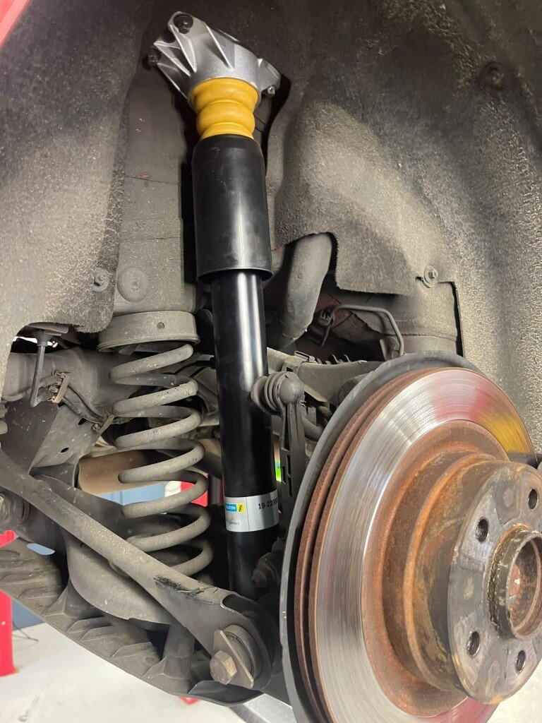

TODAY’S UPDATE - REAR SUSPENSION REFRESH

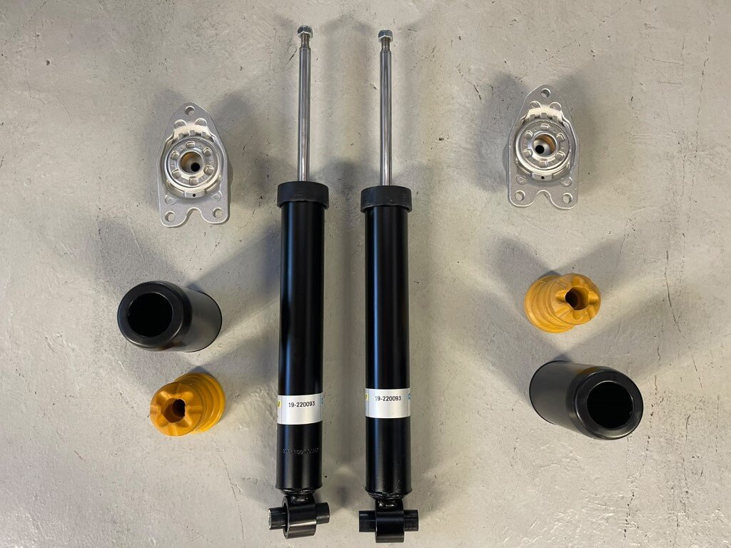

In my attempt to constantly make some kind of progress on the car whenever I get a bit of free time, it was finally time to attend to the rear suspension.
The front suspension now feels so good that it only made sense to sort out the rear as well.
The rear shocks were old and tired, and the bump stops had already started breaking apart. I’ve also got a fairly long trip coming up soon, so I want the car as close to 110% as possible before then.

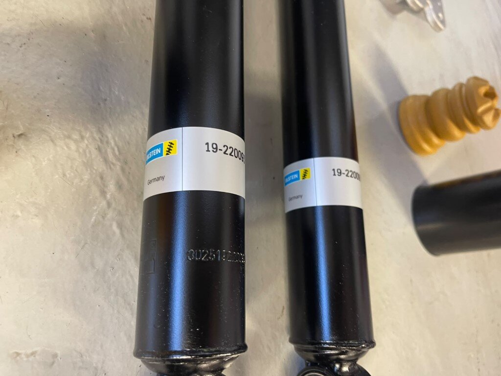

For the rear we sourced:
  • Bilstein rear shocks
  • New rear shock mounts
  • New bump stops
  • New dust covers

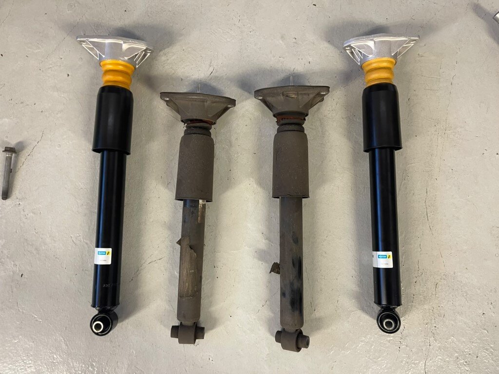

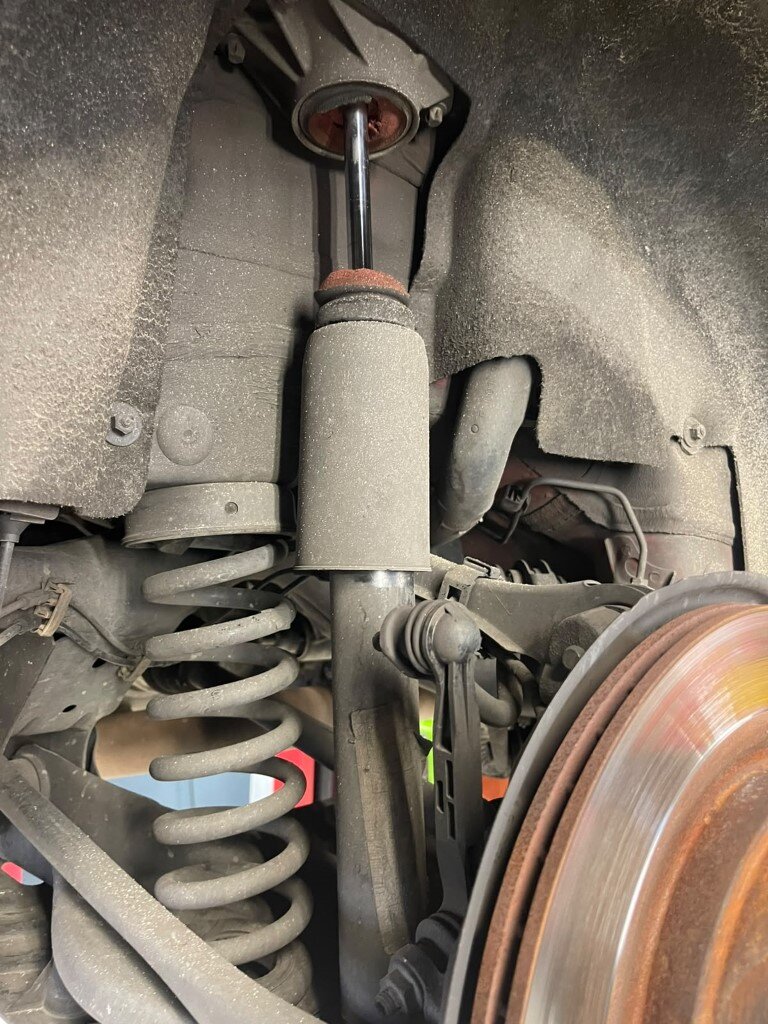

Once the wheels came off, you could immediately see how tired everything was. WhatsApp Image 2026-10-04 at 00.50.10 (2).jpeg
The old shocks and bump stops had definitely reached the end of their useful life.

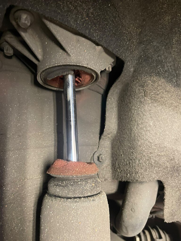

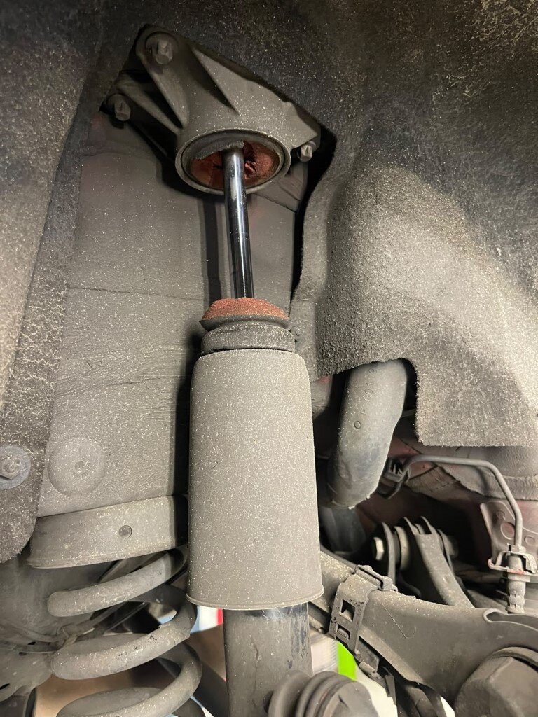

Once the shocks were removed, I pushed them in by hand and they basically stayed there instead of extending back out properly. When you compare them to the new Bilsteins, the difference is obvious.
At that point there was no question that they needed replacing.

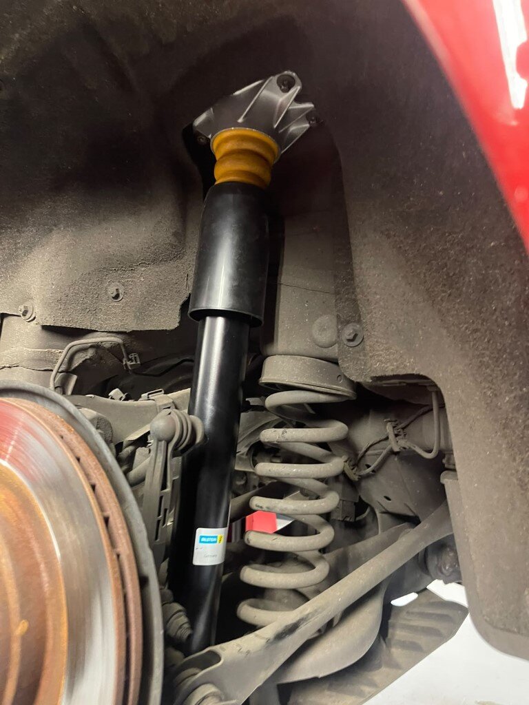

So in went the new Bilstein shocks, mounts, bump stops and dust covers.
Everything was refitted and I took the car out for a test drive afterwards.
The difference is immediately noticeable.
The old rear shocks really weren’t adding much value anymore. The rear of the car now feels far more controlled going over speed bumps, uneven roads and rough surfaces.
It also balances the car out nicely now that both the front and rear suspension have been refreshed.
Fresh shocks really do make a huge difference, especially on a car with this kind of mileage.
At 200,000 km and after years of dealing with Johannesburg roads, I think the originals have more than earned their retirement.
So consider this your reminder to actually check your shocks once in a while.
Still quite a bit more to do. I’m just waiting for the last few cooling-system components to arrive, and then the plan is to do a proper cooling-system refresh next.
More progress soon.
