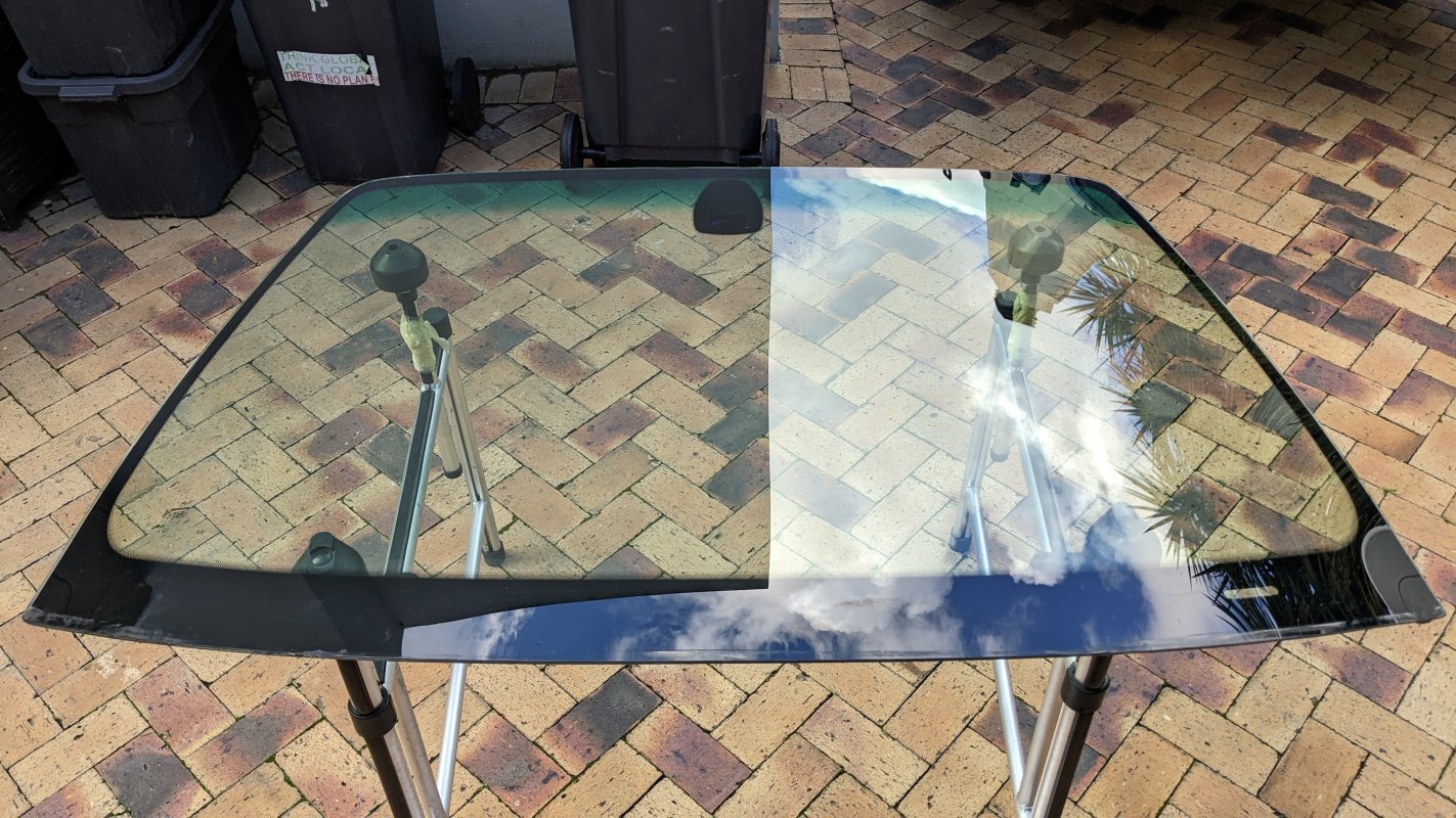

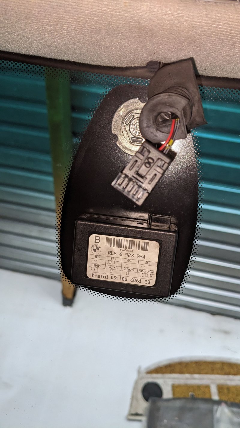

The windscreen. Was done with a mobile unit from PG Glass at home. I got outstanding service and a steal of a price so very happy with them. This isn't an OEM windscreen, but it came out of another car and the RLS worked on it.
The windscreen with the RLS installed. Here you can see, I only have the factory wires for the clown nose to blink when the alarm is armed.

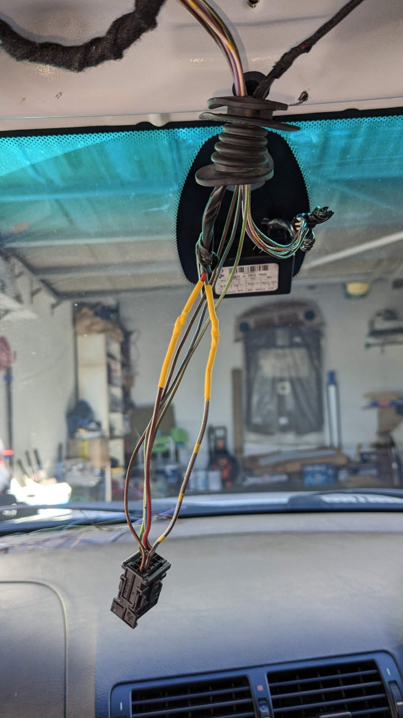

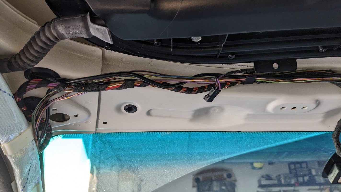

Next step was to add in wiring.
Plug with all the wires.
Fed in to the sensor. So unfortunately the wiring I got, from the original car it ran through the right A-pillar, down to behind the steering, behind the HVAC unit then to the right side where the fuses etc. are. Well, the wires were to short so I couldn't do them the OEM way and had to go to the left A-pillar.

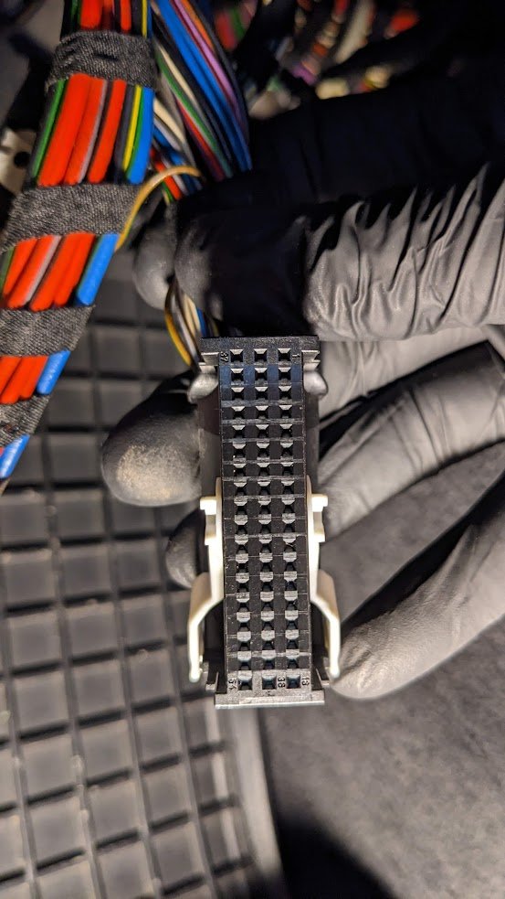

Now, I did t his as OEM as possible. Added 2x new fuses and got the correct connectors to put in behind and have them match up to the OEM locations of where to find a fuse for the auto dimming mirror power and the RLS sensor power. Only photo I took seems to be of me figuring out the pin numbers on one of the plugs on the GM5 module. You need to hook into the wiper return signal wire, which is the only wire I had to split down here, because my car didn't come with the splitter for this the way the OEM way is for cars that have RS or RLS from factory.

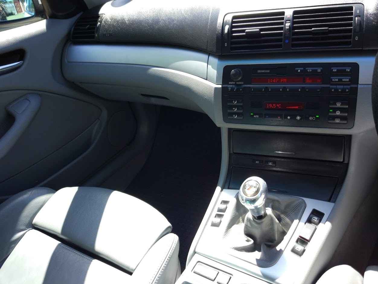

So I went and did my own two-tone interior, black and grey. After spending multiple nights on google image search and looking at what I have available, I made some choices.
Door cards, black surround with inner grey.
Dashboard, full black.
Center console and armrest, full black.
Front seats, black with grey leather.

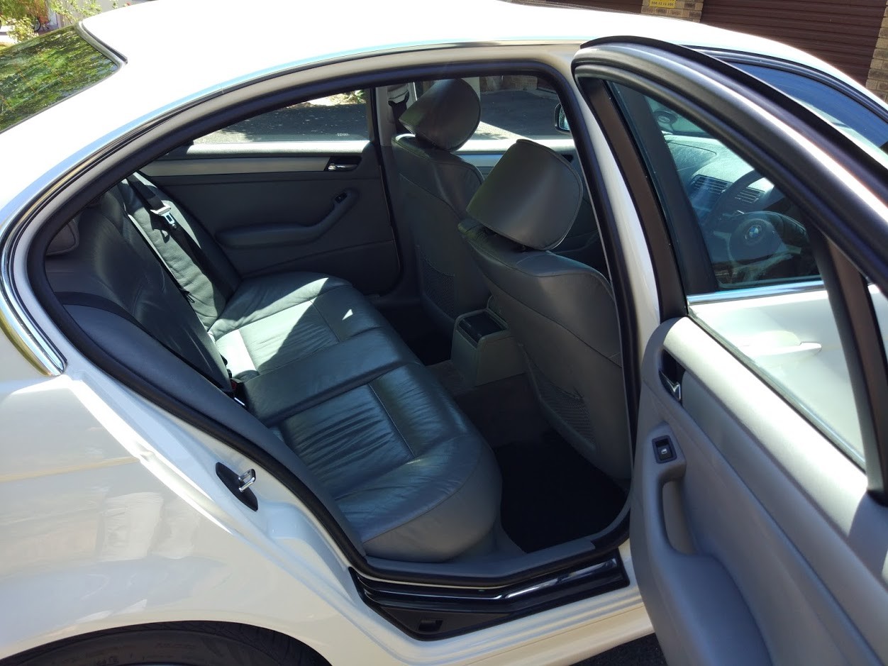

Rear seat, black. I would've picked the grey to keep it oem, but I also retrofitted isofix connectors and the grey seat didn't have the spacing to make use of them. If I do ever redo the leather on all of these, then I can have the rear match the front seats.
With all that said, I am very happy with how this turned out so far. Was joy driving the car over the summer holidays, through rain, sun, dark, night and day with all the new things retrofitted.

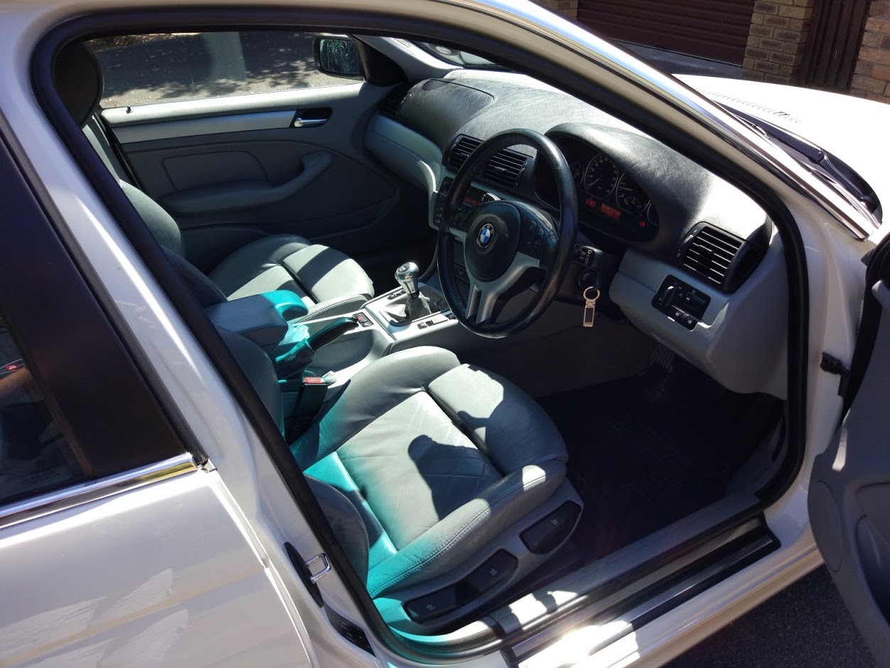

Here are the interior two-tone images. This is a daily, so scuse the stuff in the door and in the car.
Showing work on the seat:
