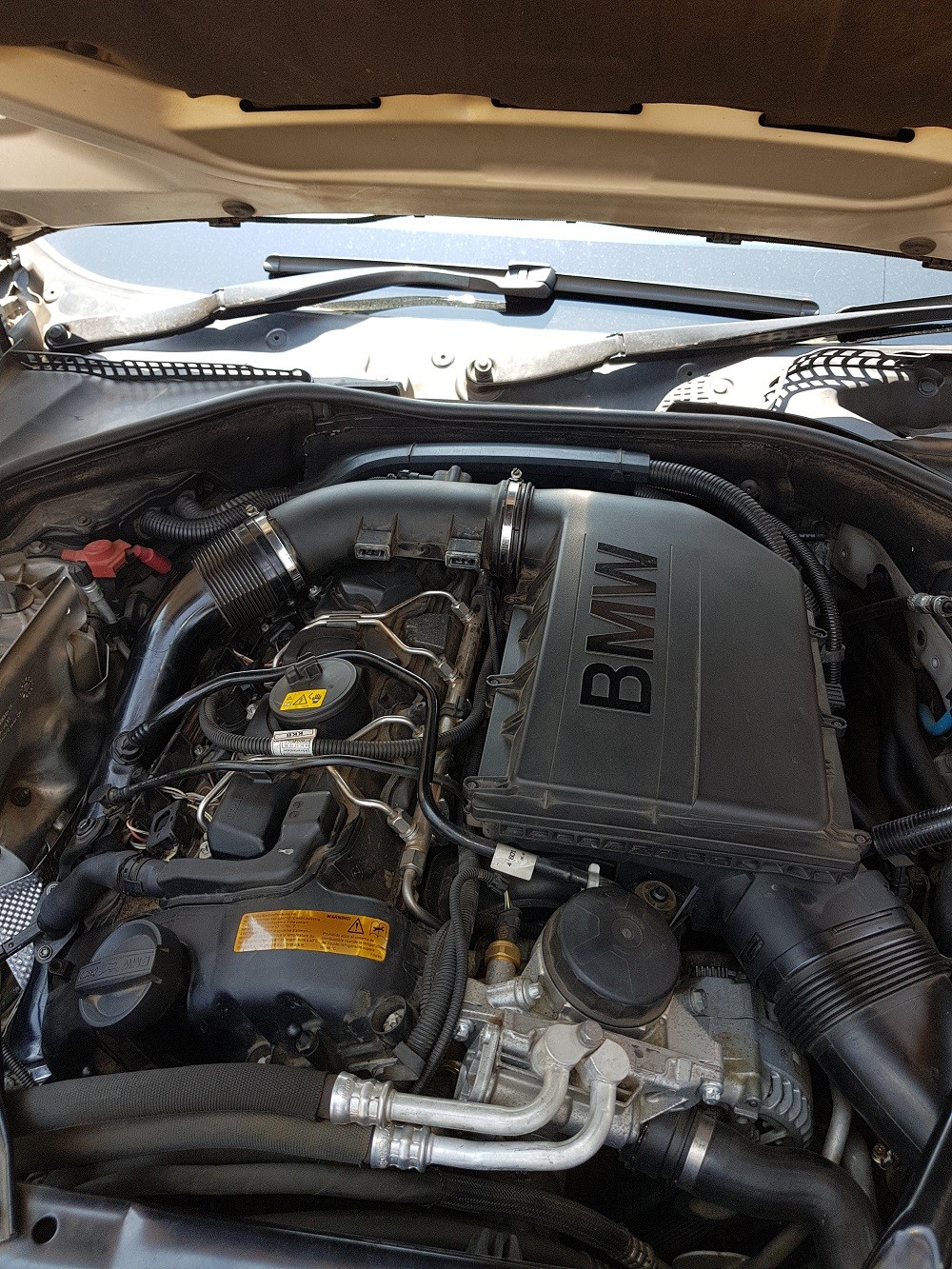

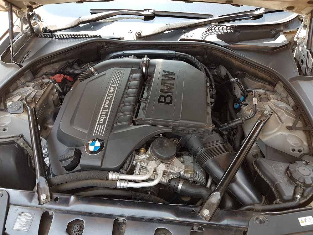

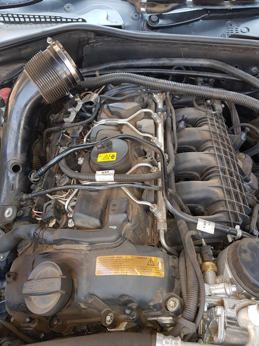

Just a small update, I had my spark plugs changed on the last service, but it seems that they were not holding up. I kept getting misfire errors, specifically on the 5th and 6th cylinders. Decided to upgrade them to NGK 1 step cooler, I have been running them on the wife's car and they been working well.
I must add the the f10 is a pain to work on to get to the plugs, the F30 design is so much better. I had to remove the entire intake and all pipes connecting to it. The replacement didnt take too long though. The worst was having my engine eat up a T30 key spanner. I searched everywhere for it but could not find it. I went as far as removing the under tray but to no avail. Guess its part of the car now :roflol:
Stripped down..
Small clean up and assembly..
Additional work I had to do to search for my T30.

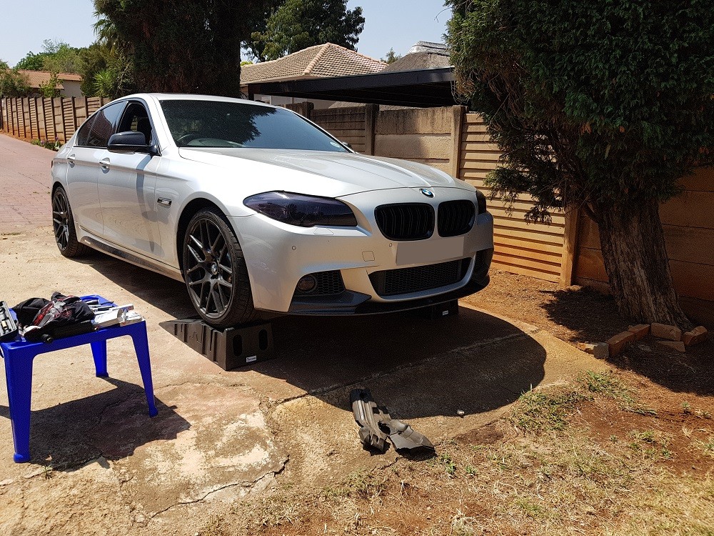

Huge thanks to @tr0jan for the ramps :ty:

Great stuff Ray, I always wonder whether my car will make it up a ramp like that. I am curious about those ramps?
Rayzor
You welcome to visit and test :smilebounce:
NBN said:
are those the ramps from Adendorff?
Yep they are the same ones :thumbs:
NBN
Rayzor said:
Thanks bud...on their website they didnt look like they raised a car by very much....
What was your experience with them in terms of ease of use etc..did they move or at any point did they lift up as the weight of the car shifted on them?
Rayzor
They worked great, I tried my best to tuck them under the wheels before driving up so they pretty much stayed in place with little to no movement. Working underneath was a little tight but not uncomfortable. Definitely way better than have the car on Jack stands
sash
Especially with quick jobs, like me where i have to strip boost pipes and replace seals....will check up with Aderndoff.

@sash let me know how they work please.
I have a different set at home, but my car can’t make it up them.

Yes, these can be permanently mounted as well :thumbs:
Alley-C said:
I need ramps in my life, but i also dont know if i would trust plastic with my 1.5 ton e90:fencelook:
They held up the f10, so e90 will be a breeze :tiptoe:
