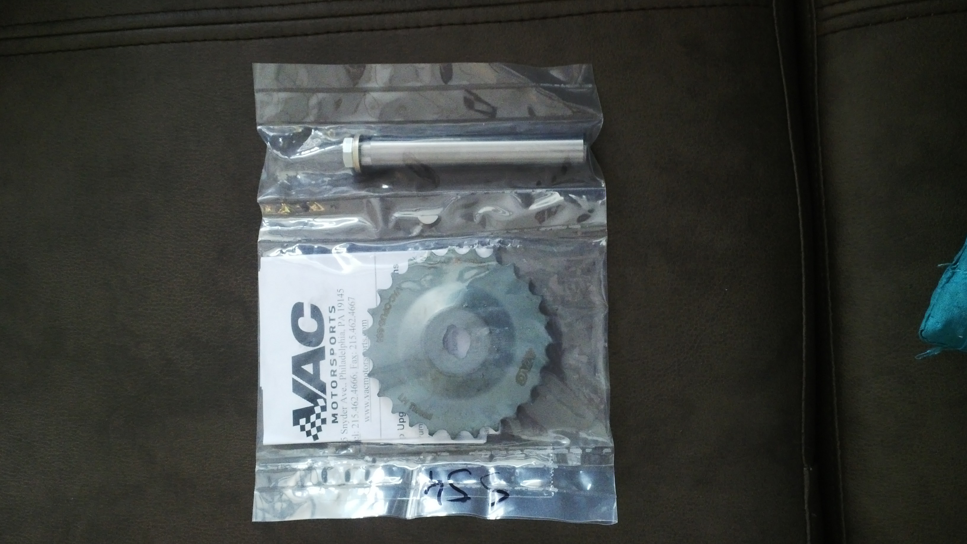

vac oil pump upgrade kit.

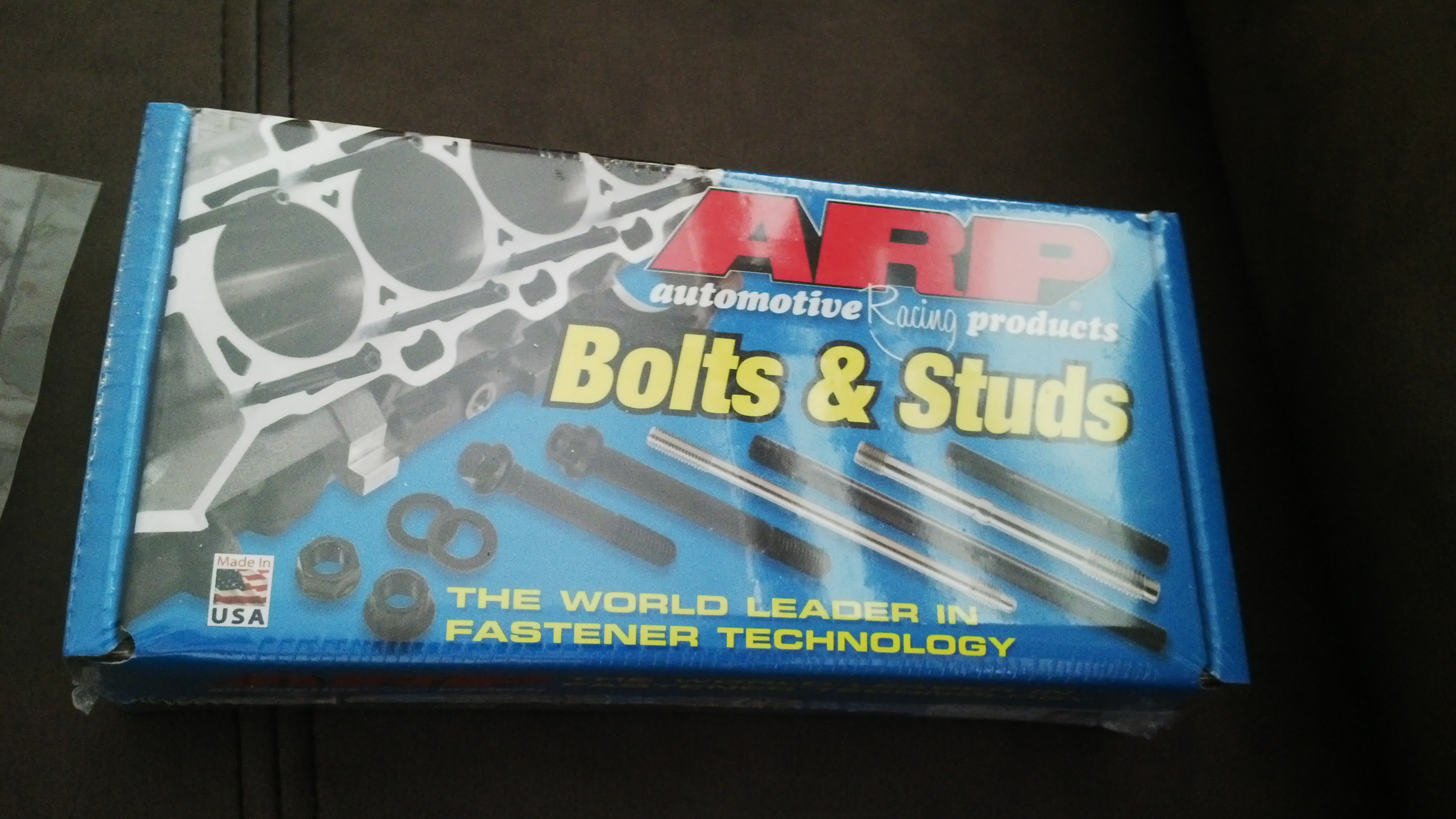

main stud kit. This is the s54 one hope it works.

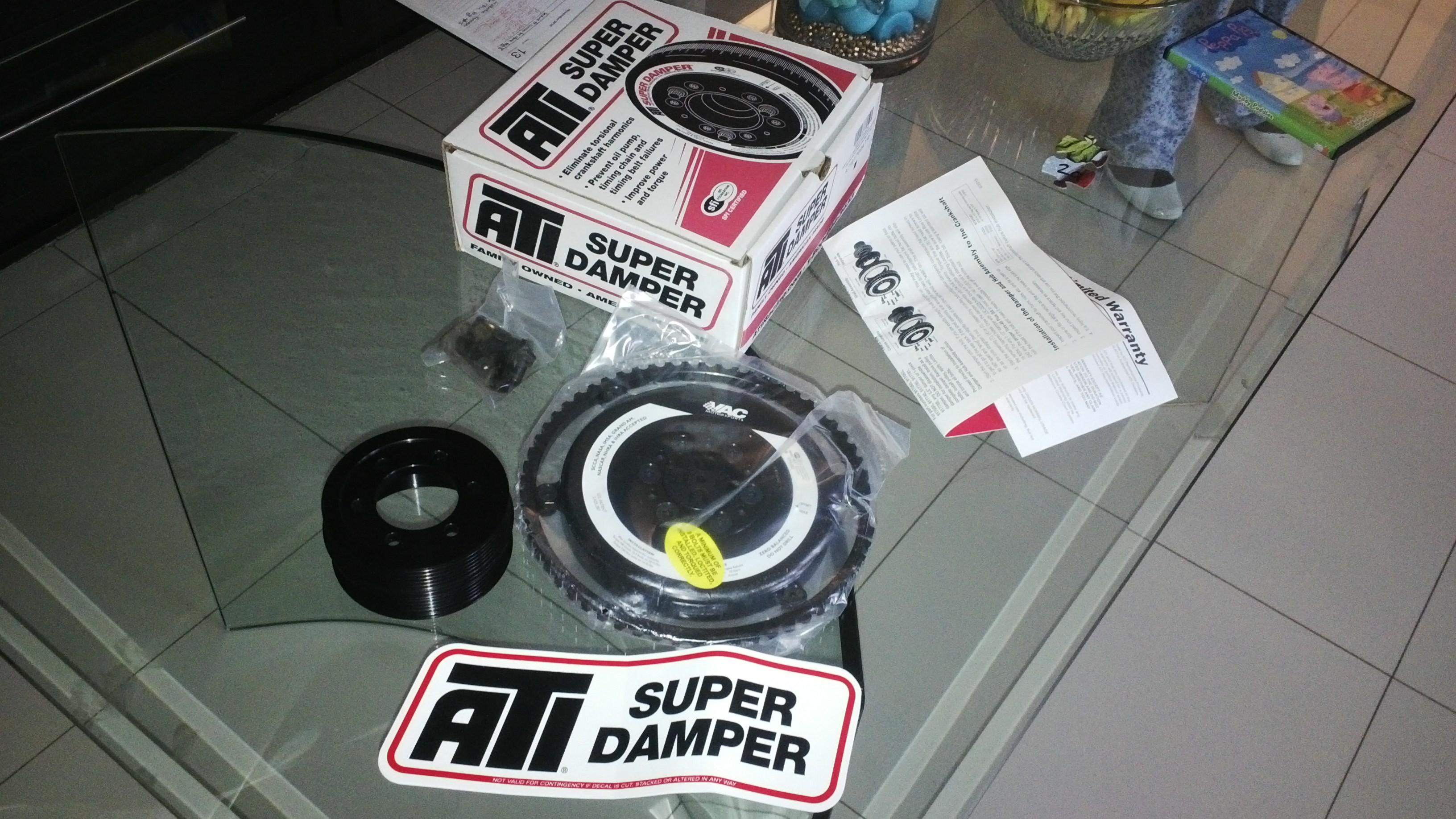

Parts update..i decided to bite the bullet and invest in this dampner just in case i want to rev over 9000rpm.
Nikhil
oooooh Nice! Also want an ATI Dampener when the exchange rate improves one day :hammerhead:
nait
I see it came down a bit this week..i bought it when the rand was 14.25 to the dollar..so r17800 and customs vat r4900..23k dam expensive piece of rubber:hammerhead:

Yep top notch..this dampner is as heavy as my flywheel..never expected it to be so heavy

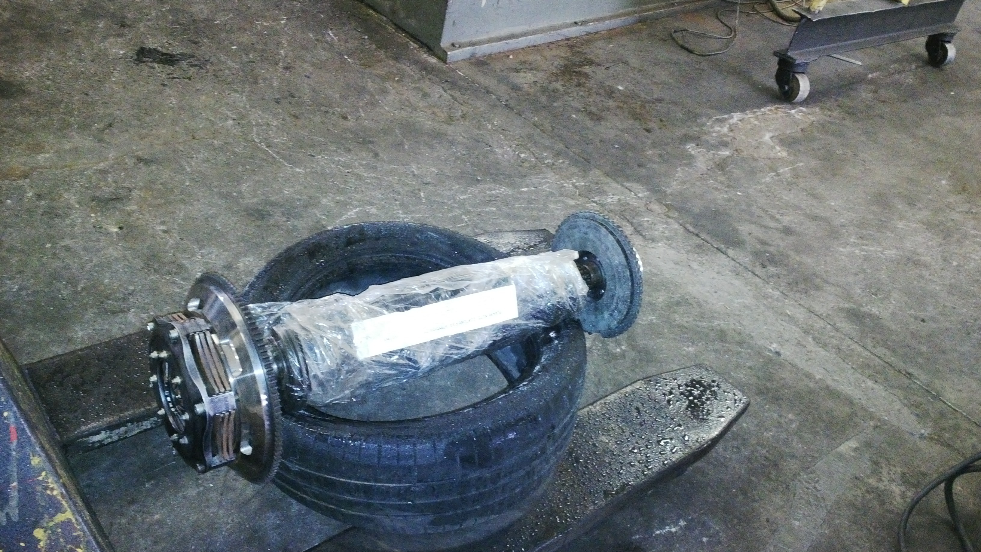

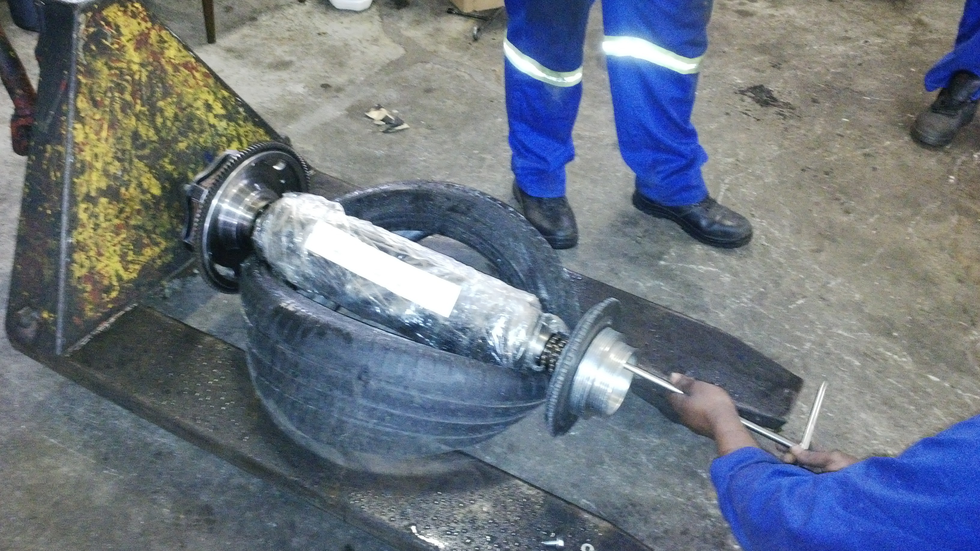

Assembly dropped off at dudleys this morning. I decided that im going to now turbo this car.
removing sc crank pulley before balancing.

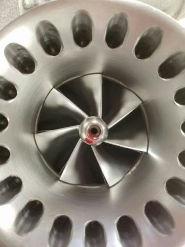

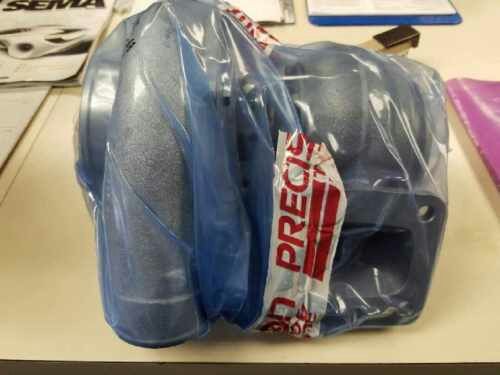

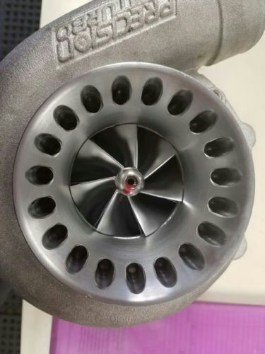

precision gen 2 6870.

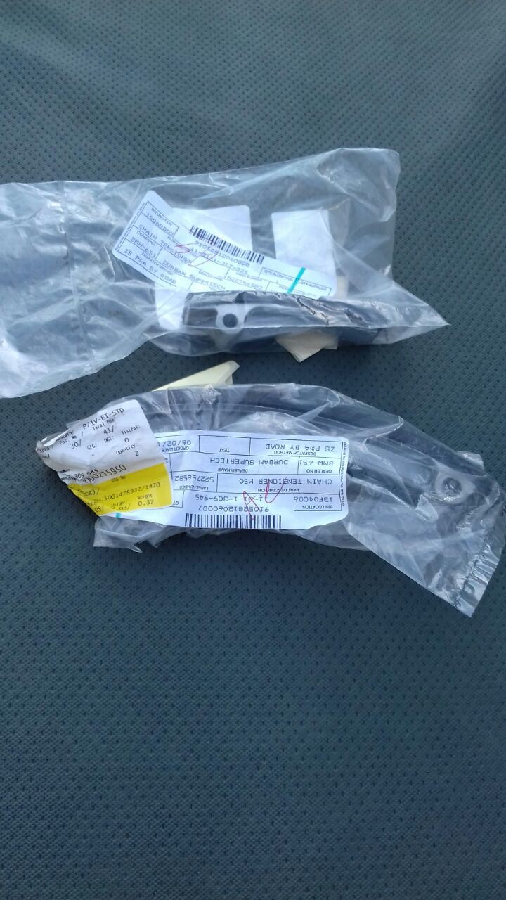

upper and lower timing chain rail guides.

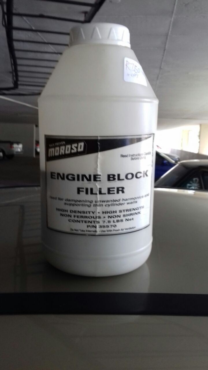

block filler.

Brilliant turbo!
Not so sure about the block filler though, bmw cooling isn't great as standard. Adding colesterol to the cooling channels will make it worse. If the car is purely a one-run drag car then it's fine, if still being driven on the street then that stuff is going to cause overheating.
Keep the updates coming. :)

I was also abit worried but after l researhed i see guys that do a half fill get away but this is with cooler conditions. So i decided to just do a light layer..the turbo was a choice between the bw efr9180 and this. But i feel i made the right choice as this is the fastest spooling 1100hp turbo to date.
