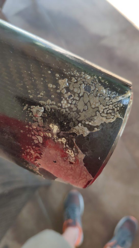

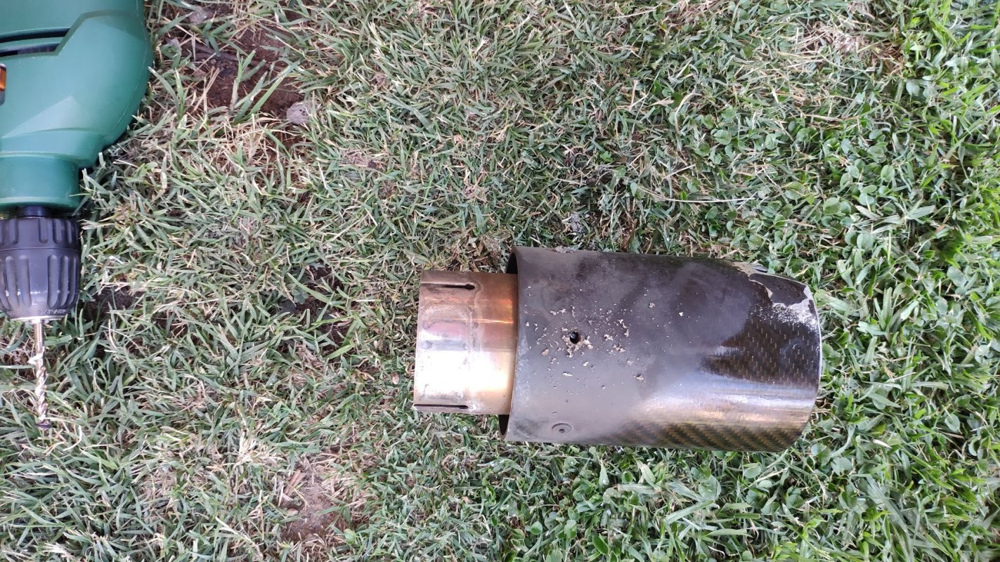

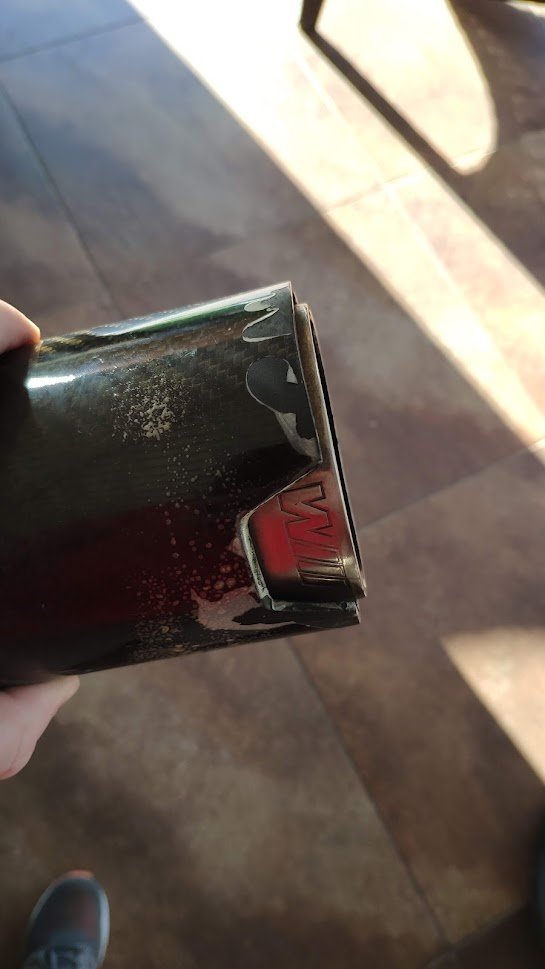

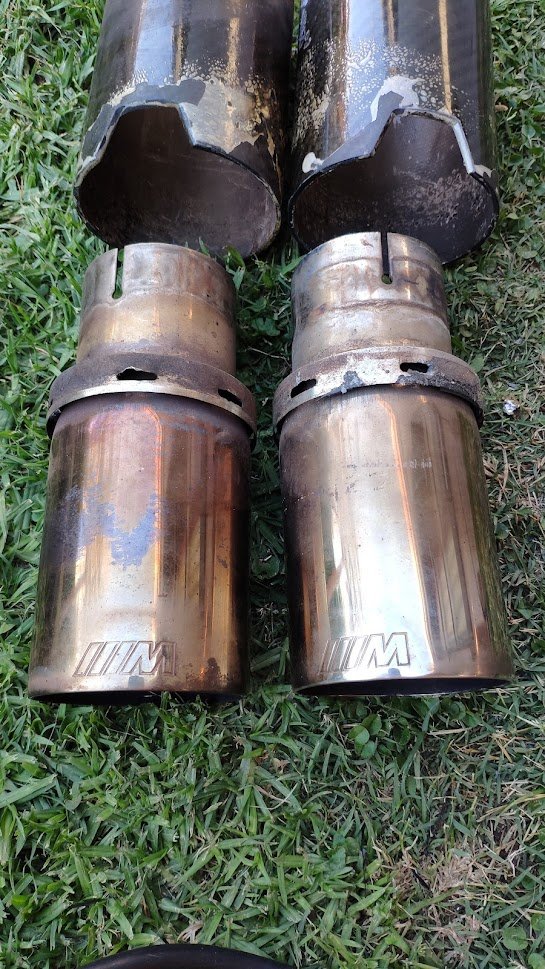

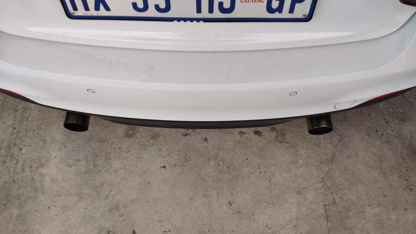

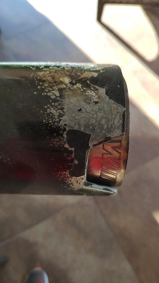

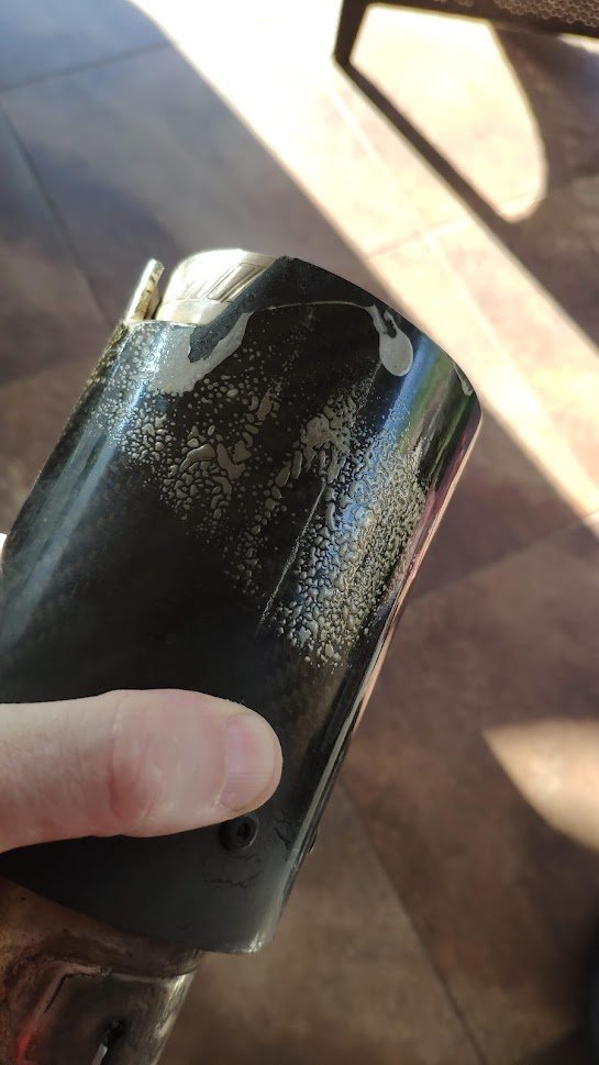

Other than that, the exhaust tips on the car are in a dreadful state of affairs...so I had to do something in the meantime.
It's not perfect. They stick out too far and I cannot adjust them inwards any further. They also need a good polish, but I cannot find my metal polish. Will go digging this weekend.
