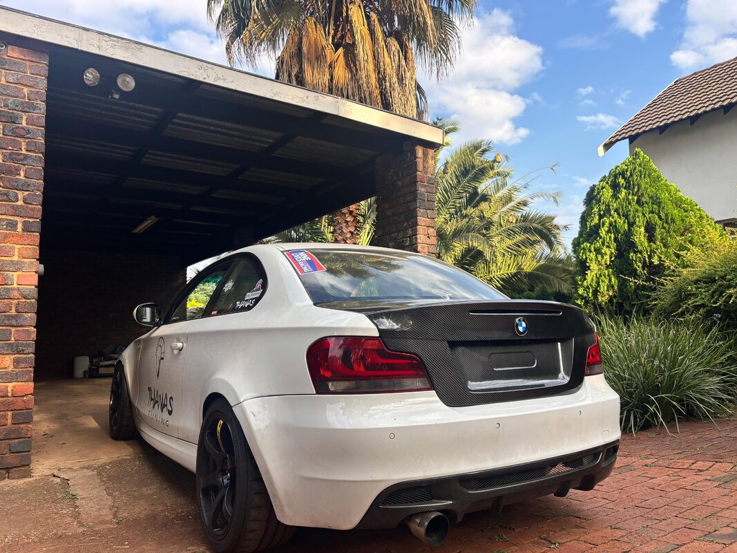

So after a couple of weeks of work I ended uo with this...
Stock one weighs 14.9kgs
Carbon 3.7kgs
Great work, can see one consistent weave and doesn't look like any waves etc... Very well done. I tried to do some skinning and it's not easy by any means!
Kudos to you for a job well done!
Vinnige Fanie
Thanks, It has been and still is alot of work and trail and error.
Also want to try skinning sometime soon but for actual Carbon parts it's a steep learning experience.

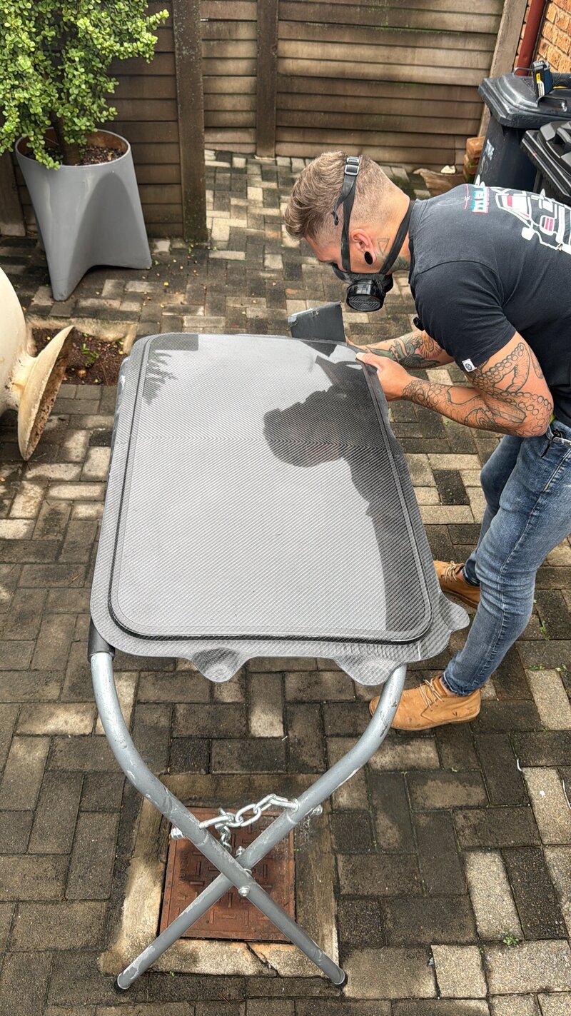

Decided to tackle the Sunroof next as it needs to be done before the roll cage can be completed. We make this and super happy with the results, Still need to polish it and silicone it on.
Stock weighs 13KGs
Carbon panel 623grams.
Huge savings right at the top of the car.
Stock weighs 13KGs
Need this for E36!
Vinnige Fanie
Impressive work! Do you know roughly what the car weighs now?
I'm guessing 1300s I have taken out roughly 230-250kgs.
Online claims 1470-1540kgs depending on dct and options.
But I need to actually try and get the car weighed. I think with Carbon doors, Bonnet , Fenders and Lexan glass I might be able to shave off another 50KG.
However the splitter and roll cage is gonna add quite some weight back.

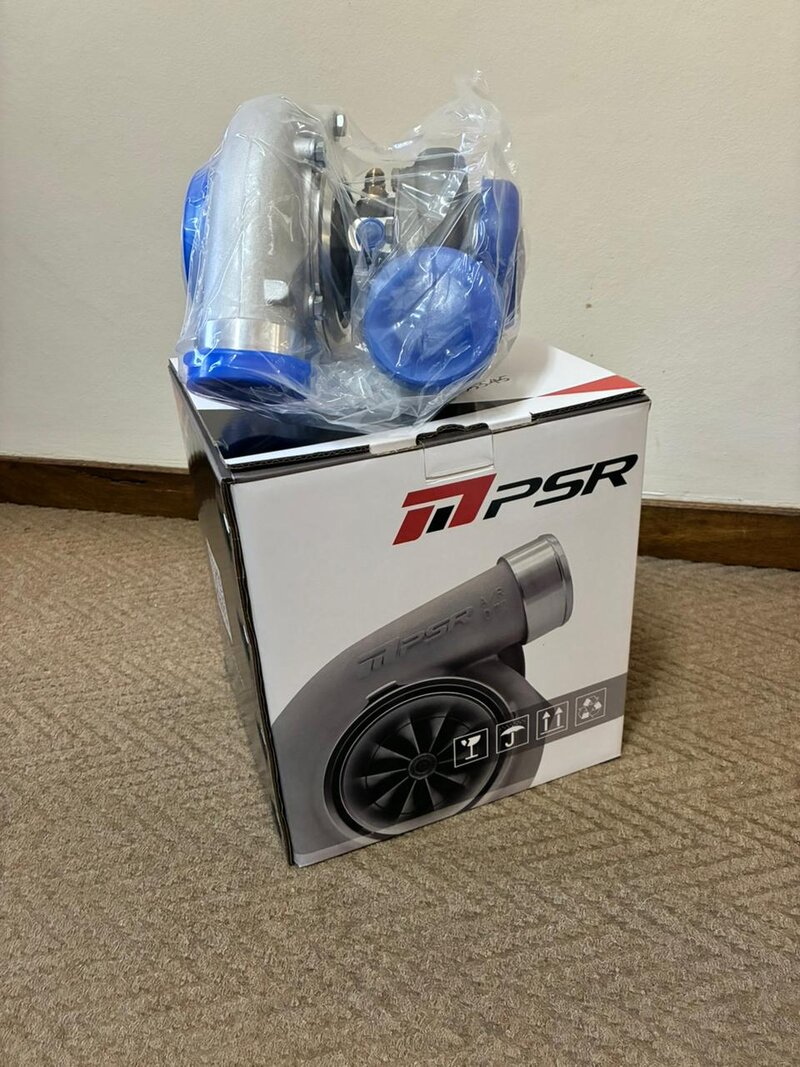

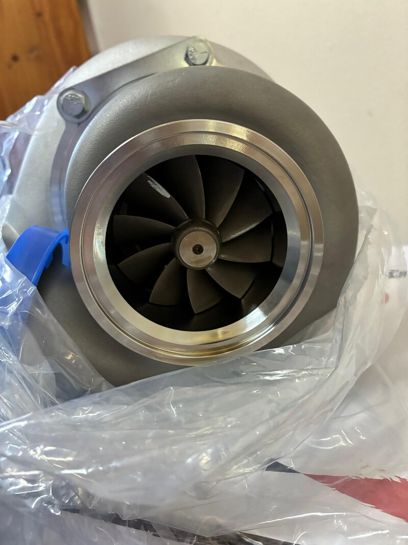

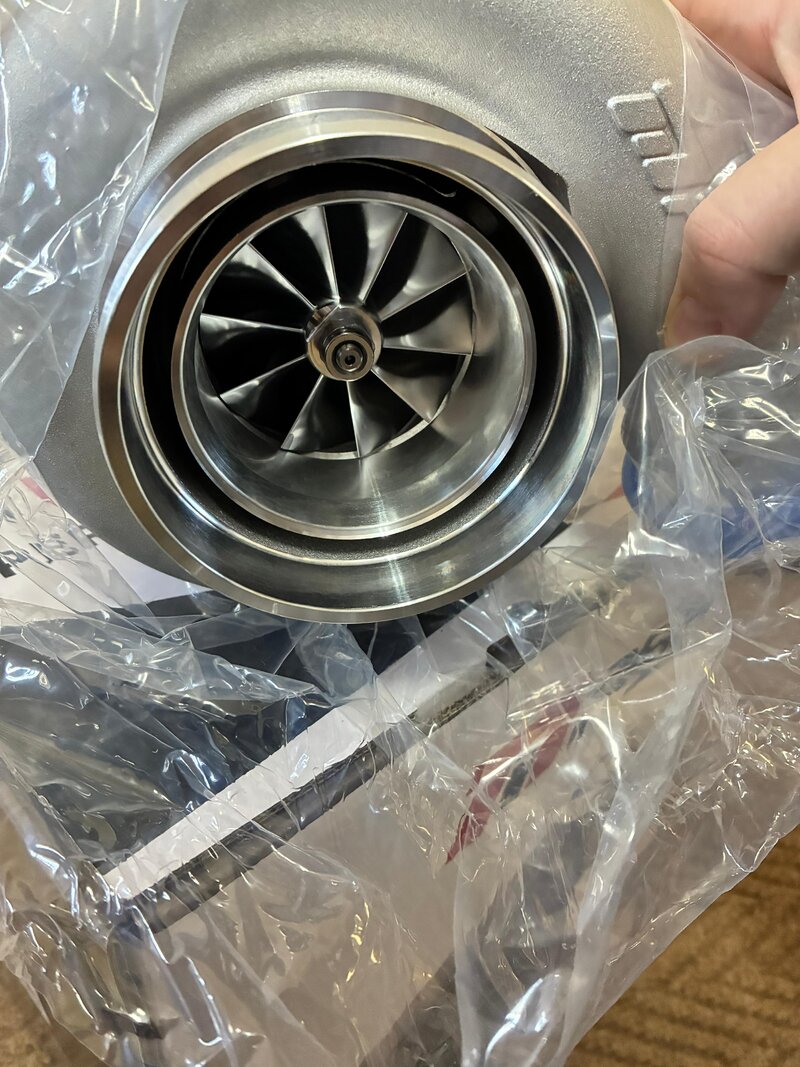

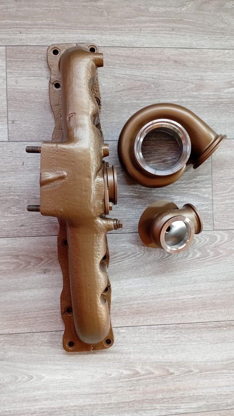

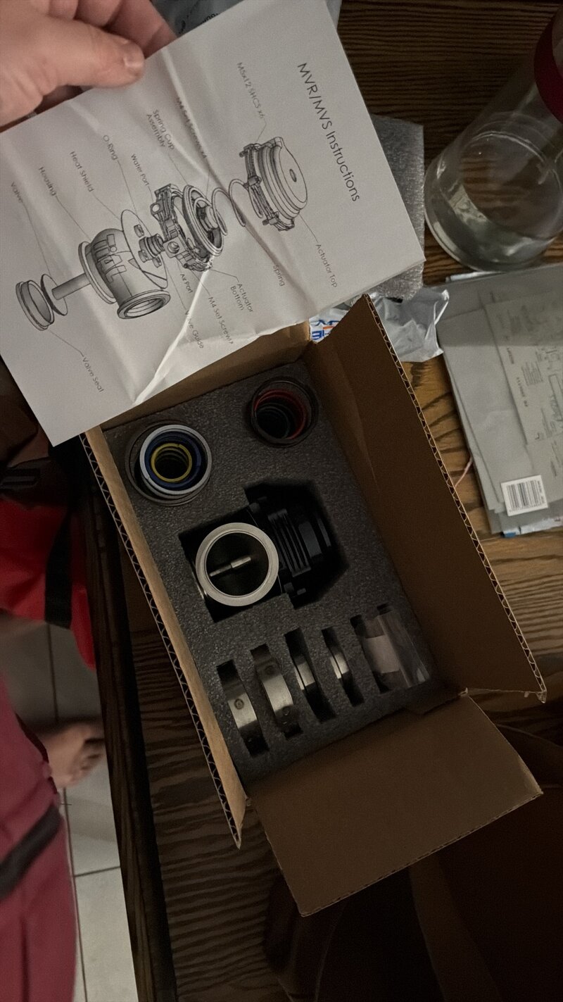

So my Turbo arrived and I got a Tial 44mm wastegate and BOV to pair with it. Hopefully the clutch keeps up till the single mass flywheel arrives.
