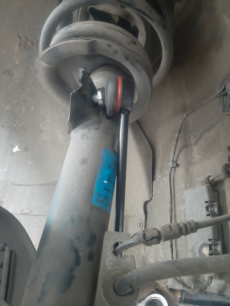

For the life of me I could not get the anti roll bar links to fit correctly20260618_104301.jpg
There was extreme interference between the Link and the Strut.
After looking at it for a while the penny dropped. At some stage the car had new shocks fitted and they fitted left strut to right side and right side to left.

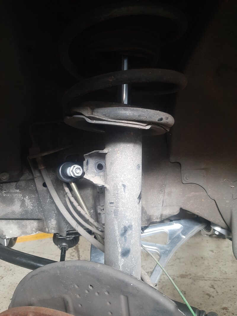

This is the LHS of the car fitted with the right strut on the left shock mounting with coil springs mis aligned.
You can actually see the coil spring hanging over the spring perch.
