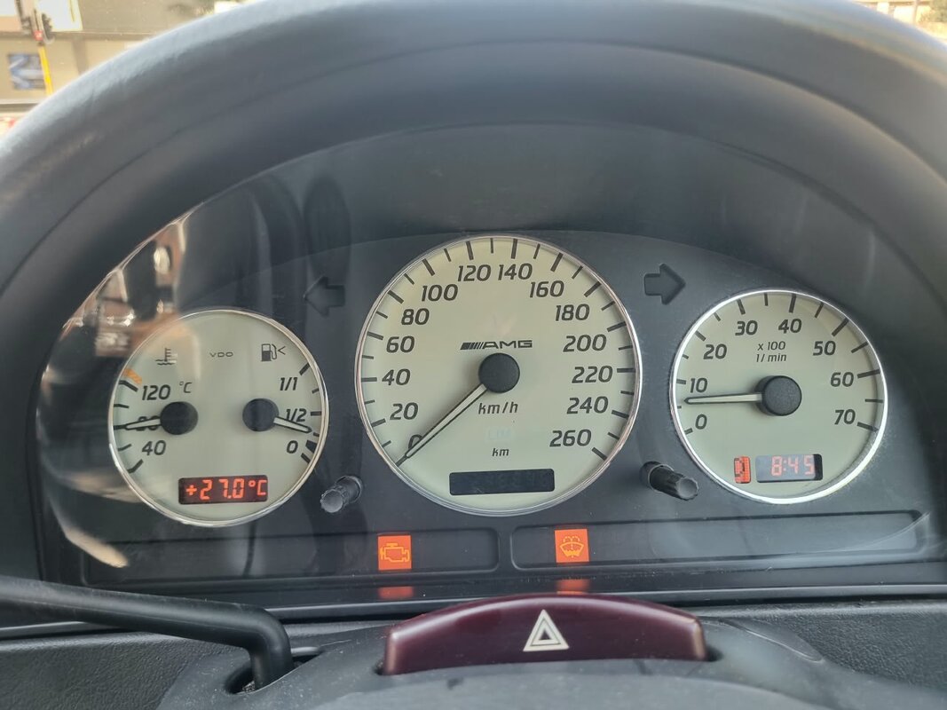

Replaced the offending O2 sensor - hopefully no more lights on the dash

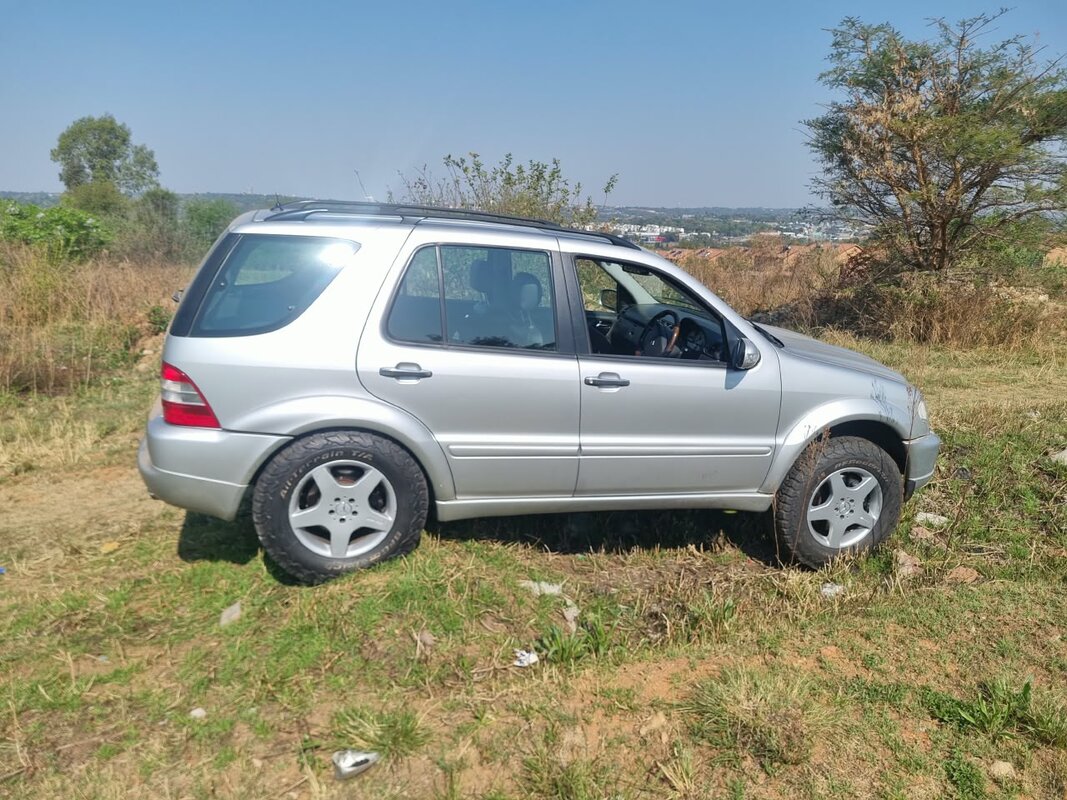

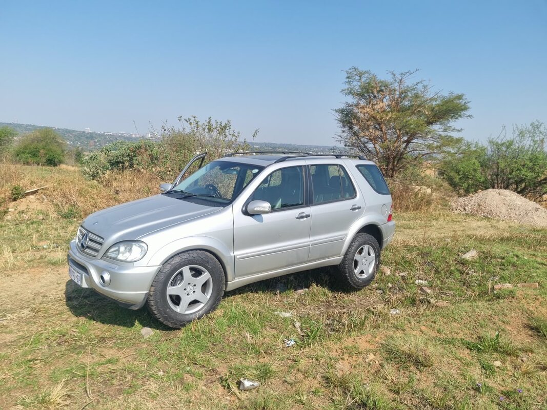

Replaced those and indexed the torsion arms by one tooth to raise the front a bit more. 30mm rear wheel spacers and 20mm front wheel spacers to fix the anorexic stance. The W163 suspension is so weirdly designed - if you lift it, you get negative camber and much smaller track width. Conversely, when you lower/load it, you get positive camber and a wider track width. Exactly the opposite of what you want from suspension.
Had to test if there was any rubbage
Thankfully none due to the ridiculously tiny wheel travel
Im loving the ML, it straddles the fence between comical and obnoxious. It makes the L322 look small when they are parked side by side
