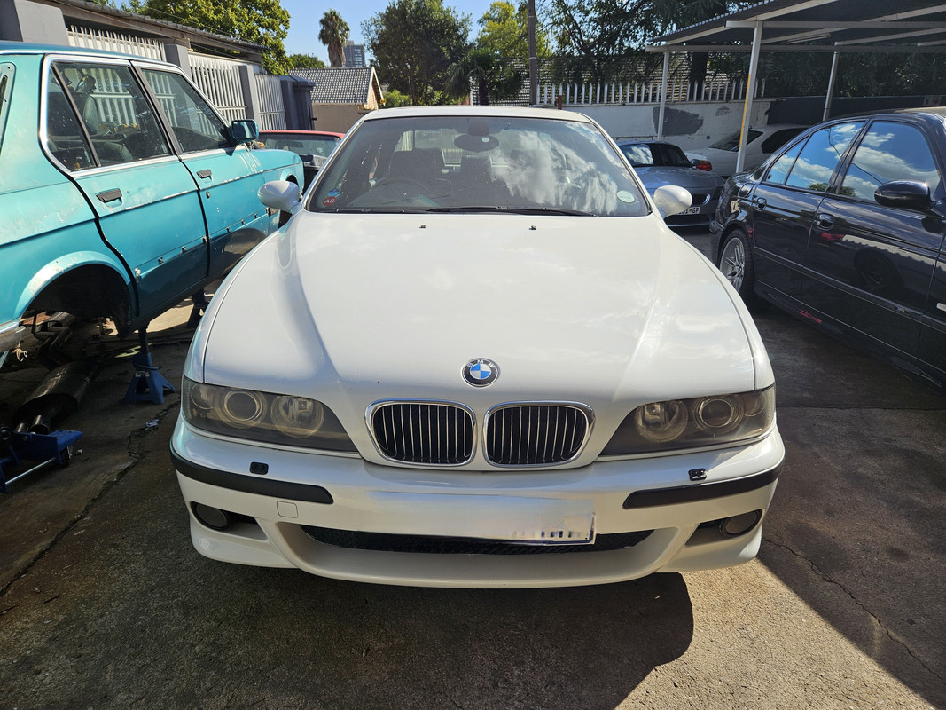

Well, technically not my driveway. While the car was loved, it certainly wasn't maintained beyond semi-regular oil changes. This almost certainly meant that I was going to need to do some major surgery and I'm not sure my neighbours would appreciate seeing another BMW leaking oil onto the driveway, let alone one in pieces, so the car was taken straight to my father's workshop.
With north of 250 000km on the odometer it was a given that the suspension and engine would need a refresh, but neither the mileage nor the required repairs put me off the car. She came with a fat stack of invoices for maintenance and repairs, a straight chasis, honest paintwork and the interior still smelled like I remember them smelling when they were new. Couple that with only 2 previous owners, a distinct lack of alternatives for sale, and a bargain price and I think I made a good decision.
After a thorough inspection the major items needing attention were:

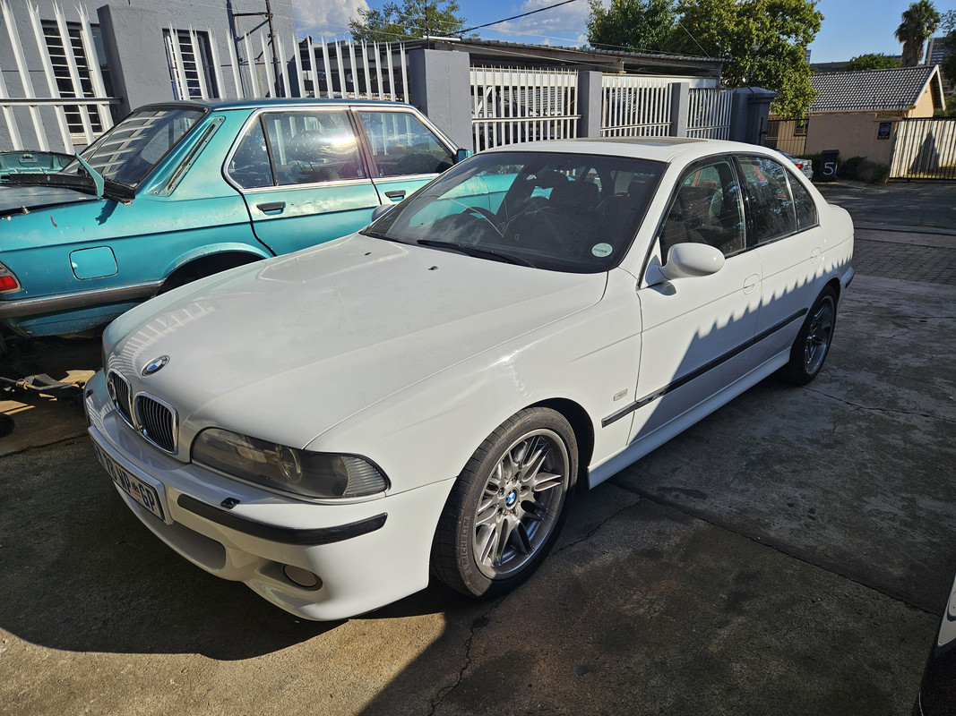

Unfortunately the e28 in the background is a parts car and in a sorry state after having served its purpose so I wouldn't call it photoworthy. Here's a better looking substitute to ease the disappointment:

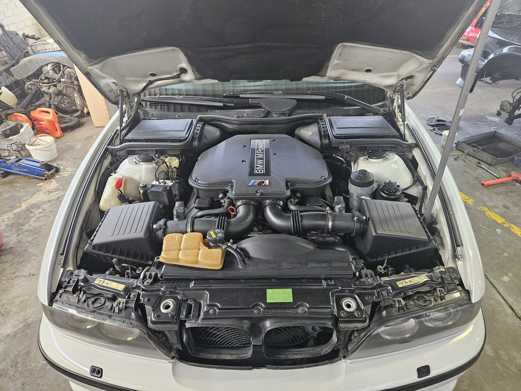

The first sign that this was going to be a labour of love was the protracted waiting times for parts to be shipped. I had planned to start working on the car before winter arrived, but parts on back-order meant that I was about to learn about the effect of cold concrete floors on a spine molded by office furniture. Fortunately I wouldn't be sharing this burden alone, a dear friend wanted to atone for the sin of owning a Focus RS and offered to lend a helping hand. Thus it was that one early morning (9:30am), as the frost was just beginning to melt off the grass (or maybe it was wet because the garden service had watered it) we cracked open the boot of the M5 to disconnect the battery.
This was an important first step as it allowed me to enjoy my take-away cappuccino while impressing upon my friend the importance of an understanding SO before filling the boot of an ///M car with so many parts. Next we decided to see if the bonnet shocks had stood the test of time.

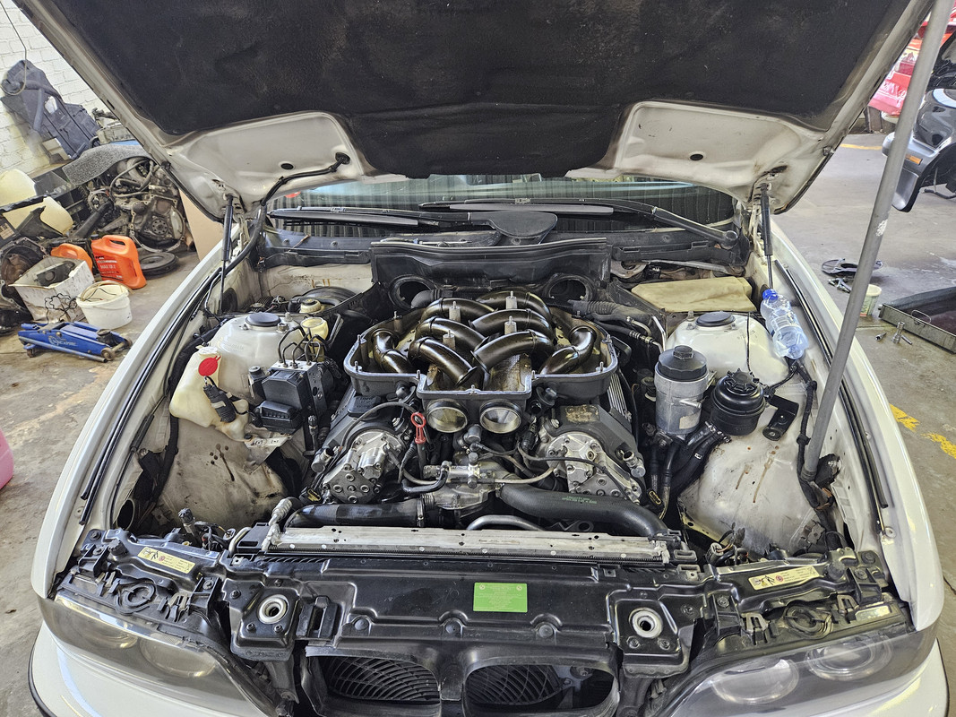

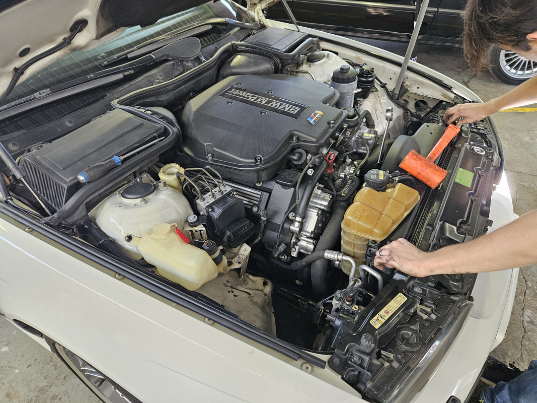

Those of you with sharp eyes will not need me to explain that they had not. For the rest of you, note the broomstick on the right side of the engine bay. Since I still had my coffee in hand at this point I decided it would be best to test my mate's wrenching skills and I instructed him to remove the viscous fan.
He did ok with taking the air filter boxes and MAFs off, but not even marriage prepared him for the patience required to liberate the viscous fan using only a spanner and hammer. I've been told there's a special tool to help with this process and I've always shrugged off this advice as lacking an element of character building. Coffee finished and lessons in stoic perseverance delivered, I reached for the ratchet and 8mm socket to assist in removing the cover for the plenum...

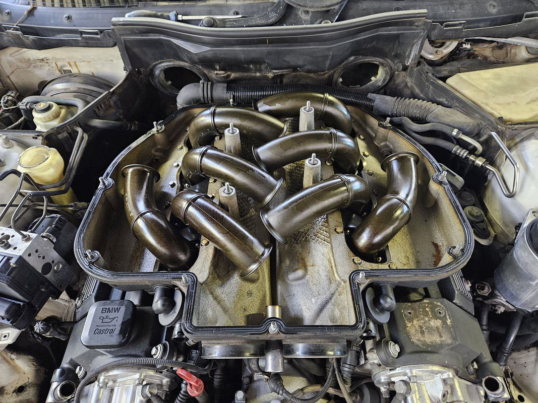

... to reveal the beautiful mess of intake trumpets underneath. Just take a moment to appreciate the design, a work of art in my opinion.

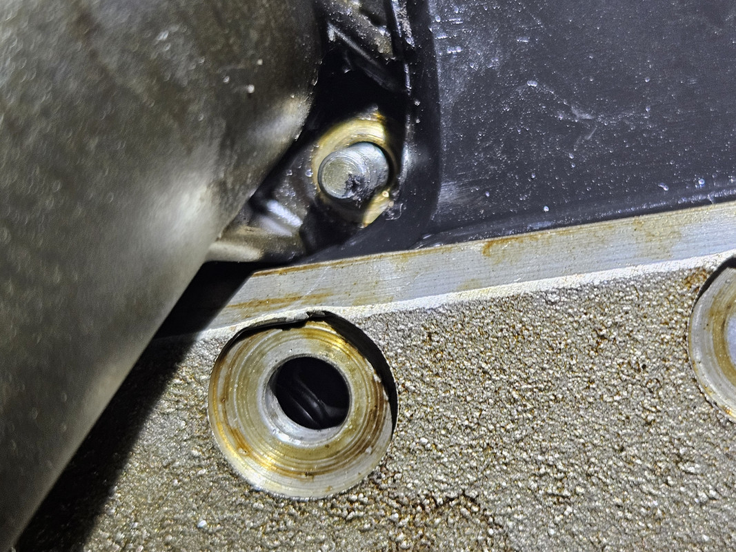

We split our efforts across each cylinder bank, I took the driver's side and my friend took the passenger's side to remove the trumpets. Shortly into the wrenching I ran into difficulties. The cylinder 2 trumpet nuts were not coming off easily and the socket was struggling to properly seat itself over the nut. The cause of this turned out to be that the rubber gasket which seats the plenum around the trumpets was incorrectly installed and has flapped itself over the lip of the trumpet thereby trapping it and the nut holding it on.

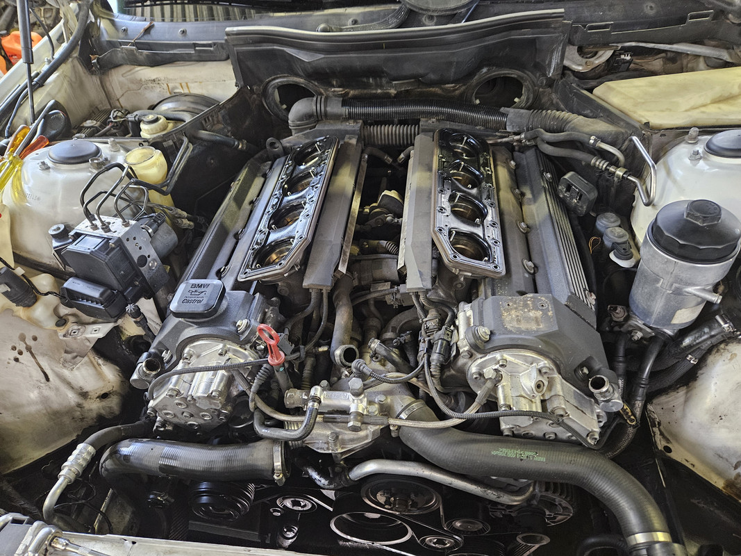

Curses were cast at whichever hurried sod had last installed the intake and the trumpet was freed. Here you can see the gaskets on each bank which sit between the throttle bodies and the plenum to create an air -and intake trumpet- tight seal.

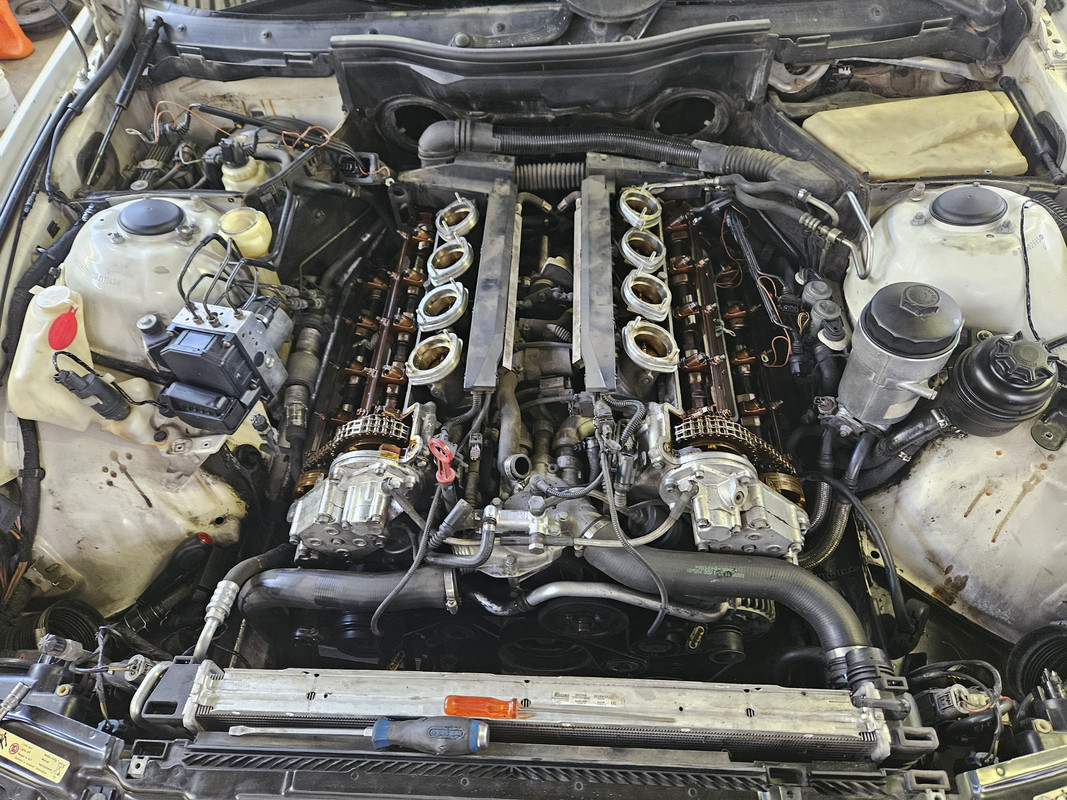

At this point we'd gotten into a good groove and parts were coming off quickly. Say goodbye to the valve covers, the coil packs and the associated wiring harness.
Right now Postimage isn't playing ball with the rest of my photos, so I'm going to end this one prematurely. In the next update I'll continue with the teardown. The immediate goal here is to get to the timing chain to replace the guiderails.

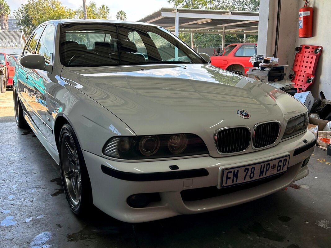

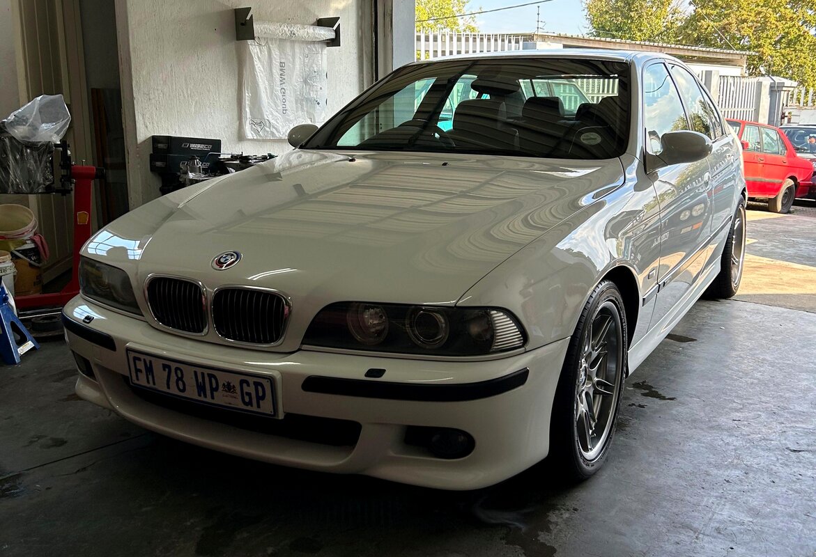

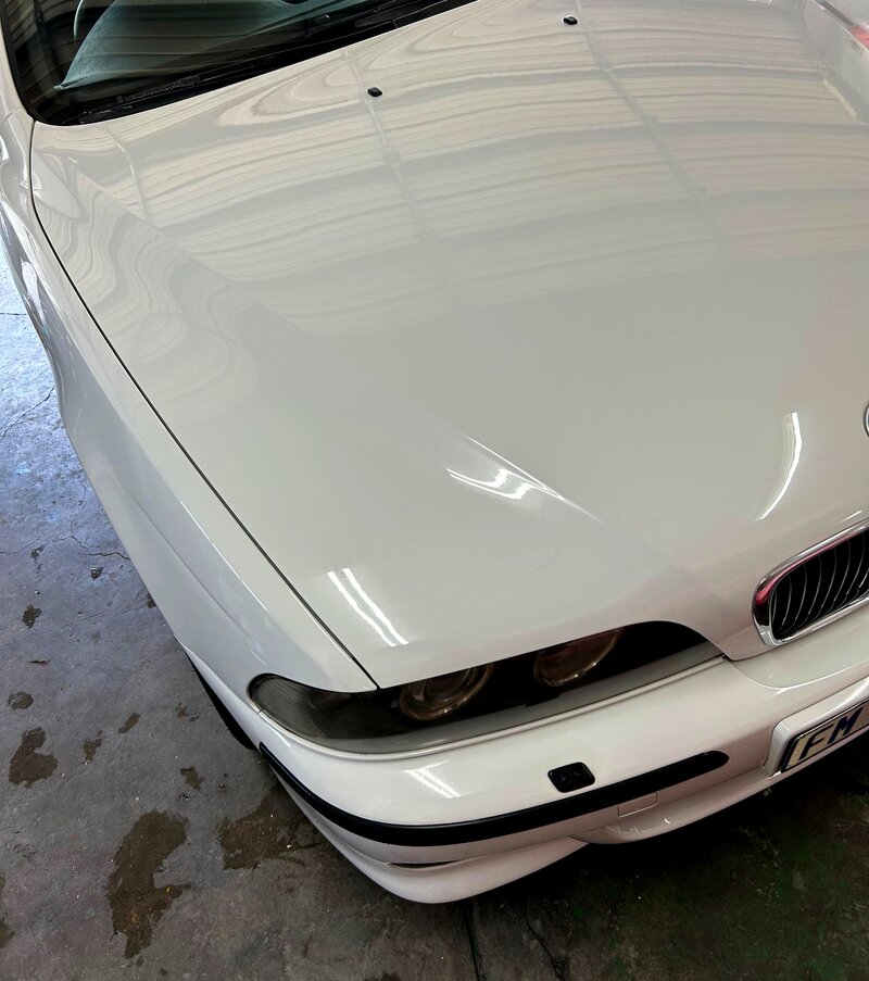

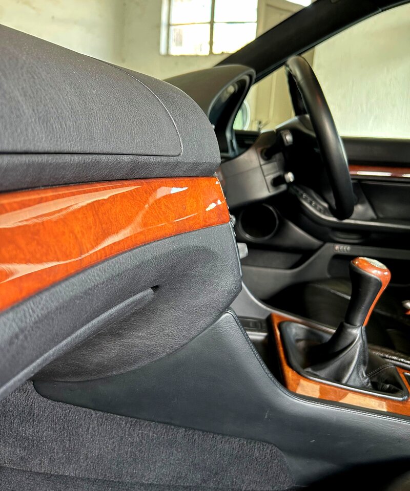

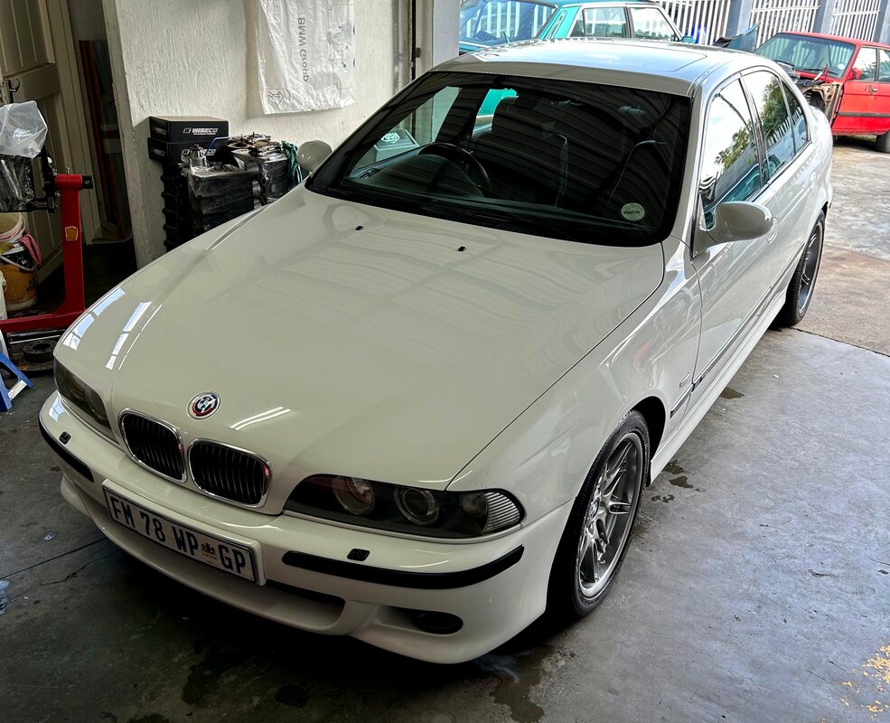

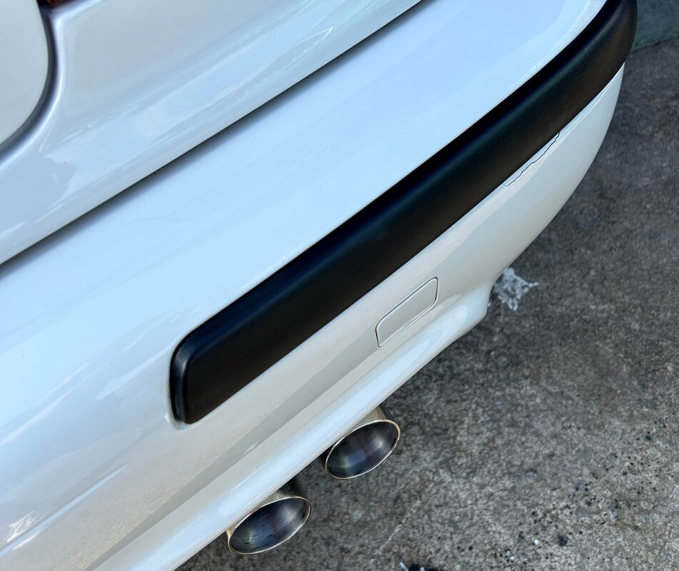

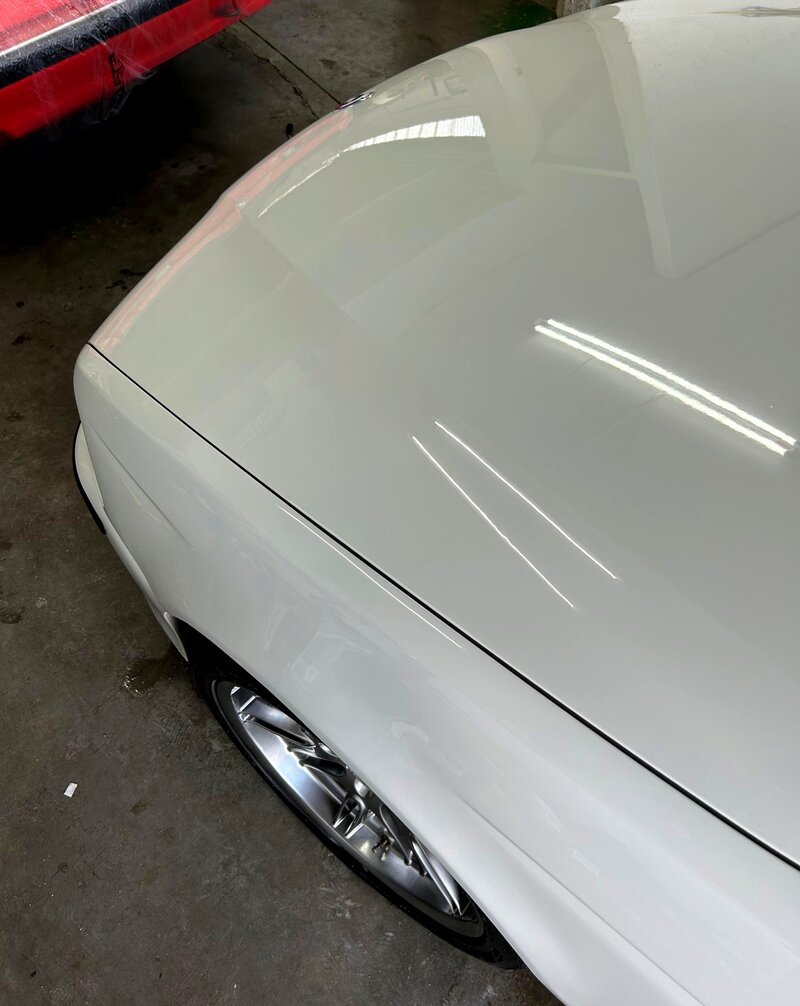

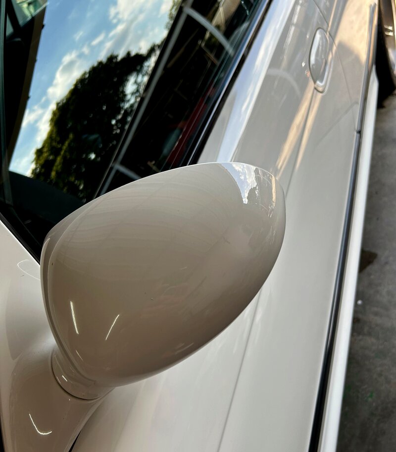

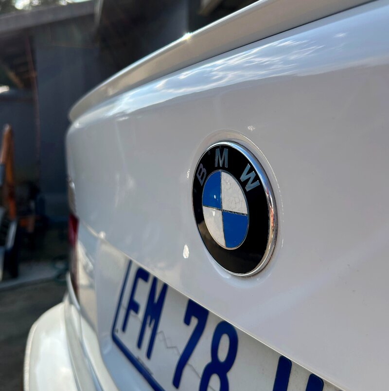

Hey Everyone,
Thank you Peter and Alex for letting me work on the car - I absolutely adore an E39 M5 and this car was such a treat.
I started with a decent cut (on a soft pad) with around 2-3 passes per panel to get the paintwork soft and to restore the colour which had turned a little bit brown over time. This initial pass of course also gets rid of the big and nasty scratches and swirls.
Thereafter it was two seperate runs of refining with Menzerna and other products to get the paint micro-marring and swirl free. I opted for Angel Wax Redemption to bring out the deep shine of the Alpine White Paint and then a layer of Autogym High Gloss Protectant to really make it look wet and glossy with the usual quick detailers and glass cleaners - The exhaust tips had to look good so they took some effort to get clean. The wheels were given a hand polish and some ceramic sealer to really pop the smokey anthracite finish.
Tyres, arches, rubbers and seals were all dressed and the interior was cleaned (along with the leather) and DROWNED (hence there is notable shine to the leather) in conditioner to really soften up the interior and bring out a lovely fresh smell. The conditioner does absorb to a lovely matte finish but in the pictures it was freshly applied.
Lots of effort went into cleaning up the sils and rubbers as well as giving the headlights a nice polish to freshen the nose up - Overall a really nice finish and a big difference for a days work.
