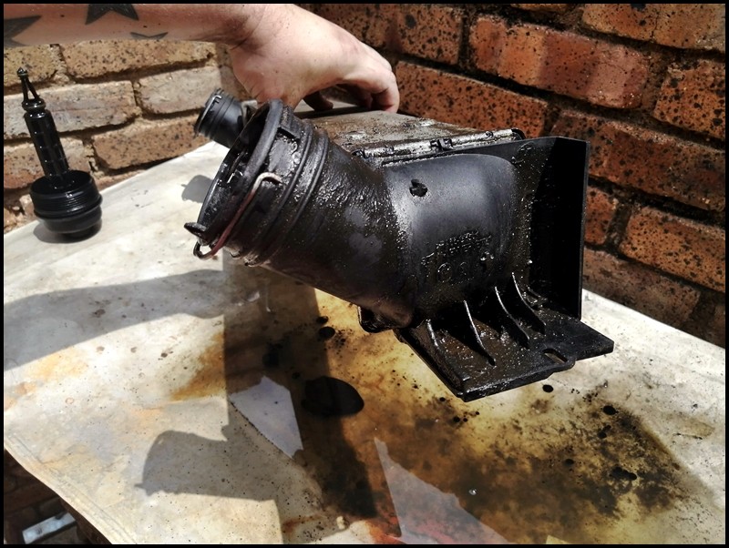

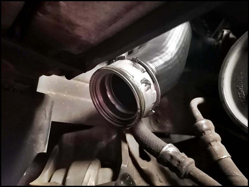

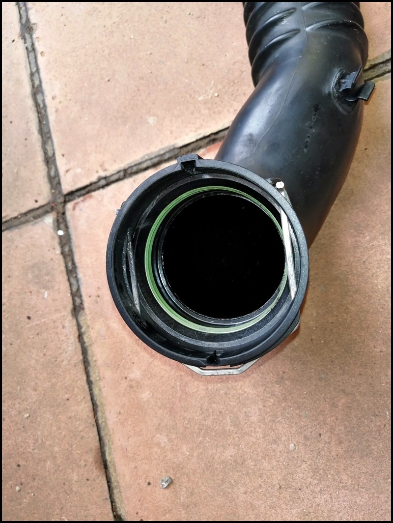

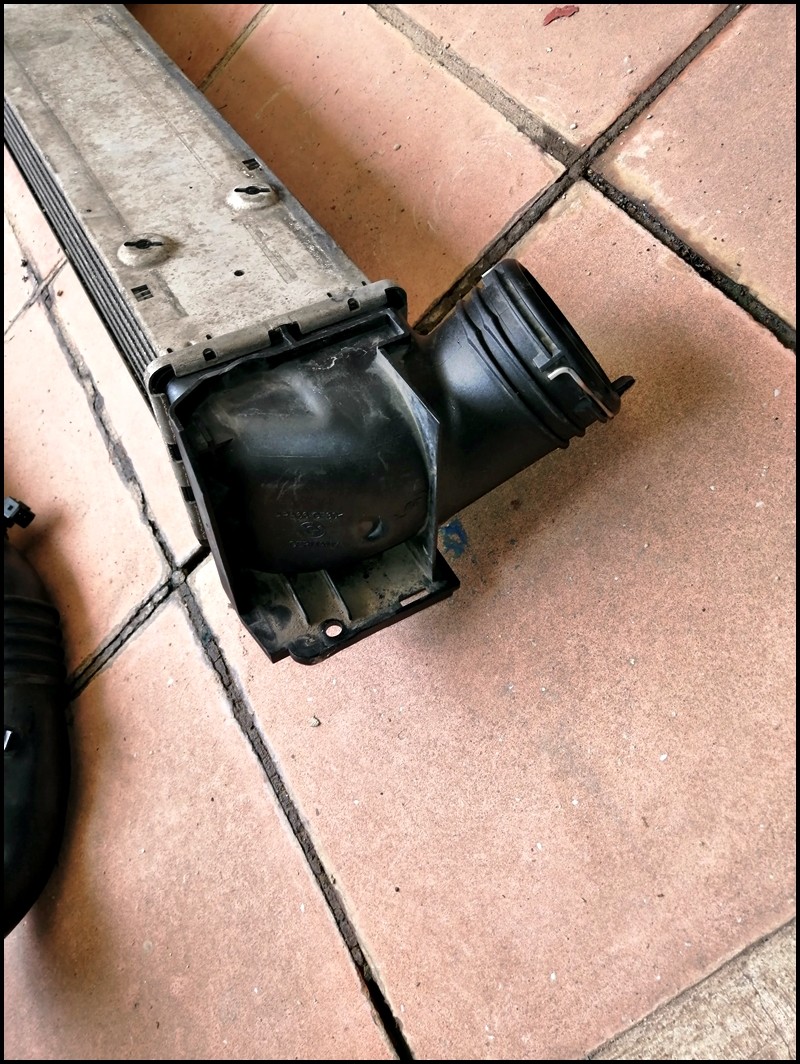

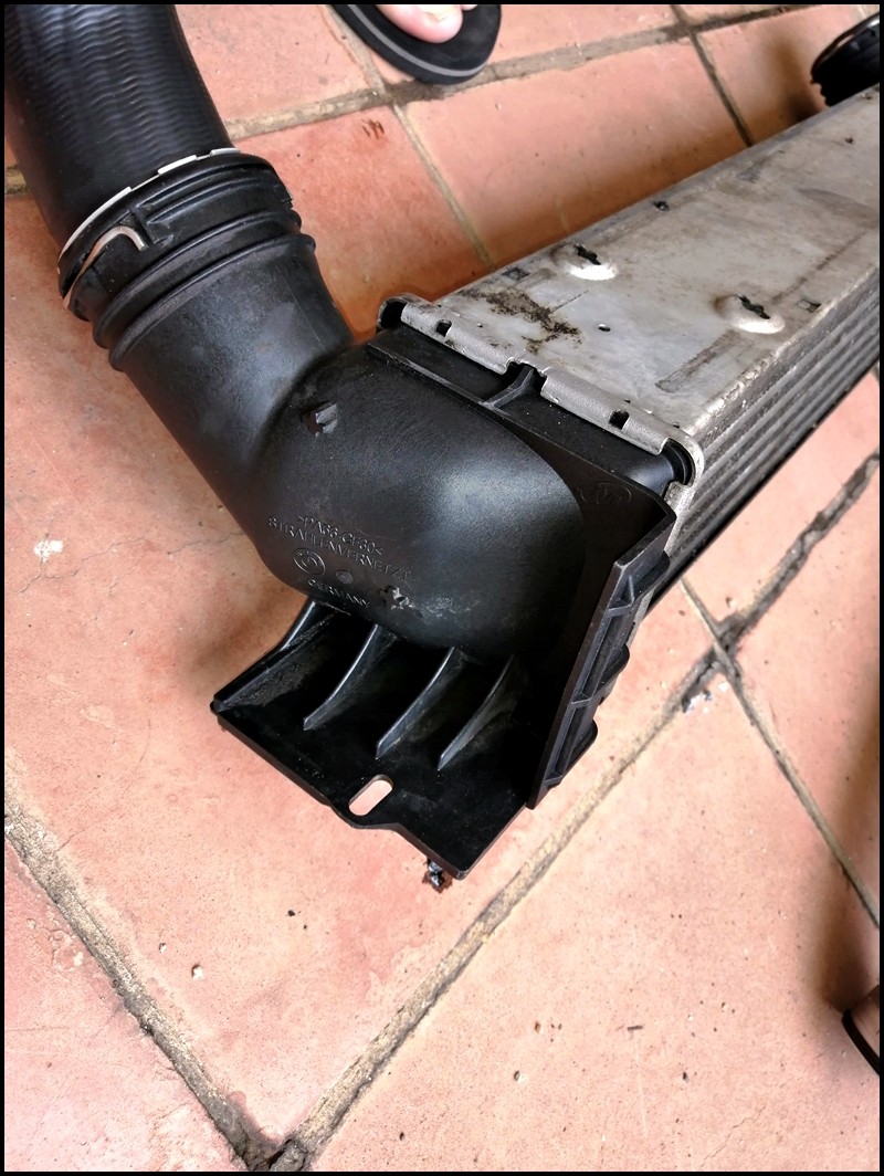

So are pics of the oil service i did and then Saturday i removed the intercooler, charge pipe, boost pipes and gave everything a proper clean as i suspect the one pipe is leaking. Recently it seemed as if i can hear a blowing noise and almost like the spooling was louder but after cleaning everything it all seems way better, car is boosting properly again with much more torque it seems.

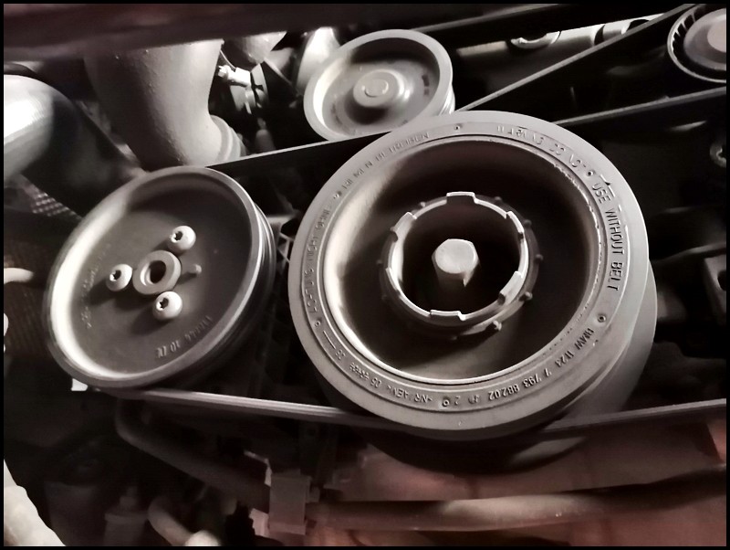

The Dampener pulley also still looks good it seems and there is no vibration ect.

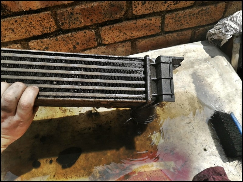

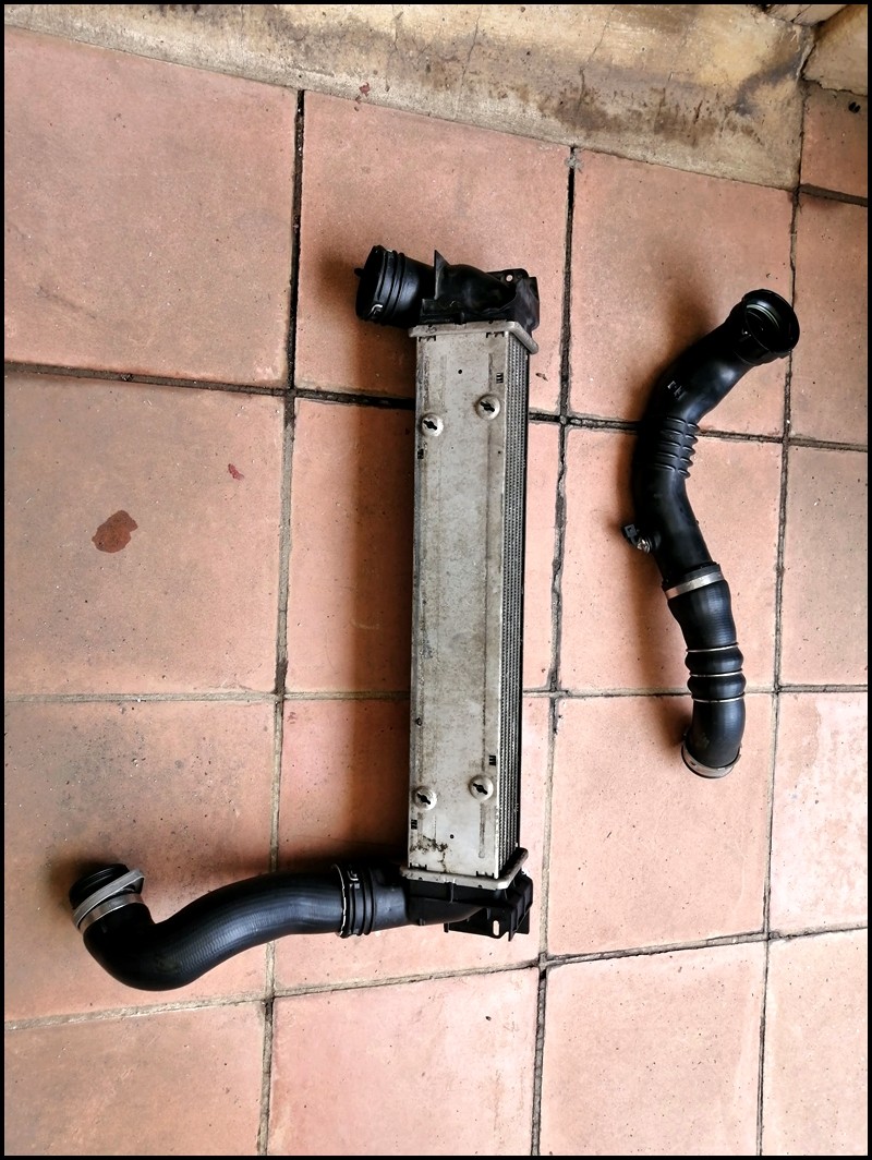

Removed intercooler, filthy animal!

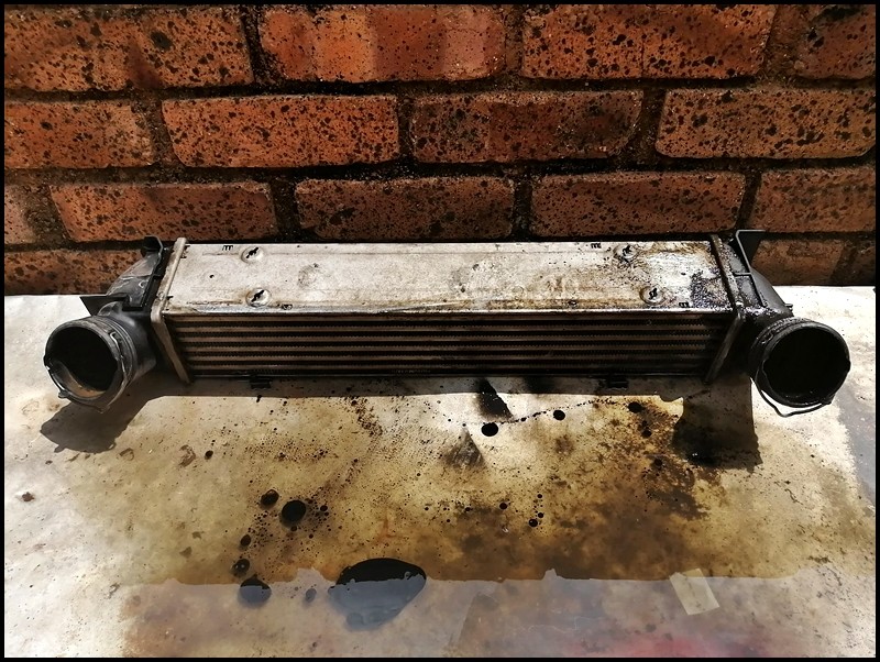

All cleaned with some clean green and pressure washer. Could probably be much cleaner but its gonna get dirty again but all the oil is gone which is what i wanted to do.
Now i will drive the car for a month and then inspect to see if the cooler is leaking or if its the seal on the boost pipe and replace if required.

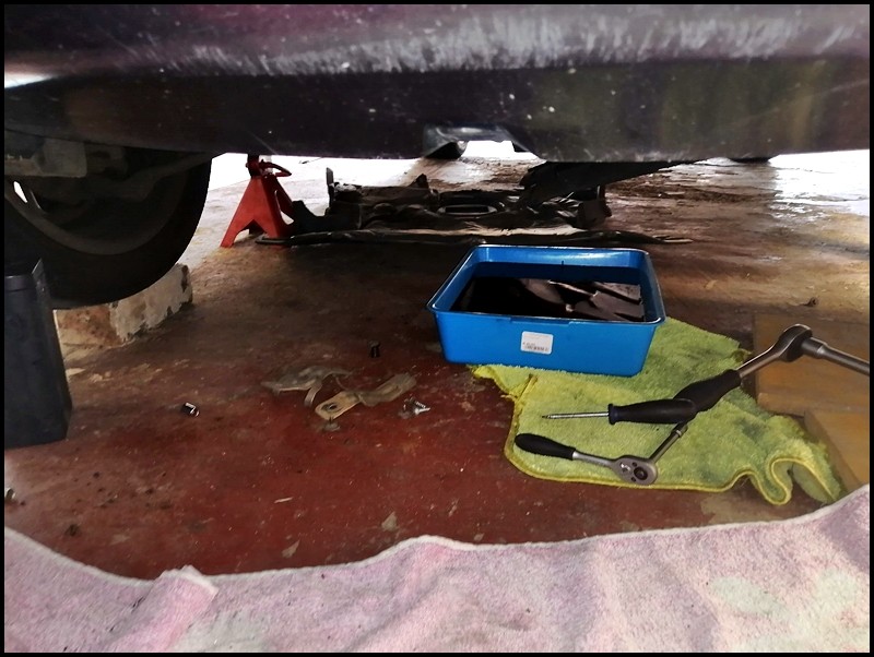

For some time i have also had this slight metallic rattle when revving the car and it was driving me insane. While fitting back the bottom splash plate, i saw that it has a heat shield for the exhaust and this was literally hanging on by one rivet so i fixed it by pop riveting it in place so no more rattle.
forgot to take a pic but its this part:
Its a thin aluminum shield with holes ect. It was all bent and i think it was touching the exhaust so that is all sorted now.
