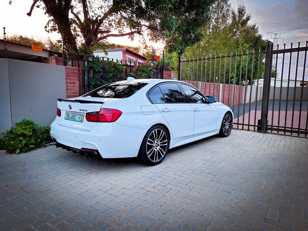

My F30 330d M-Sport
I love the black badges. Been considering it for my car as well since its totally white and gloss black including the side Msport badges and 320i badge. Just need to do the roundels
