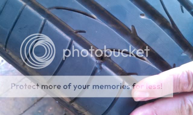

Today was a nice eventful RFT day.
Just as I pulled out at Stormvoël Toll gate I hear something that sounds like a tap - left rear. There after silence. Drove about 100km/h and as I approached the N4 / N1 interchange , I heard it again...almost instantanously the BIG red RFT indicator (!) came on. I stopped and noticed the left rear tyre is deflated. I carried on driving on BMW's RFT @ +/- 50-60km/h, up to John Vorster (otherwise I would be late for an important meeting) and pulled over at the HighVeld TechnoPark Engen. Tried to inflate the bugger, without success.
So I parked the car at my place of work. After the meeting I did some chores and left for the Centurion HQ.
This is what was found:
I was advised not to plug it, but to replace the tire. :argh:
