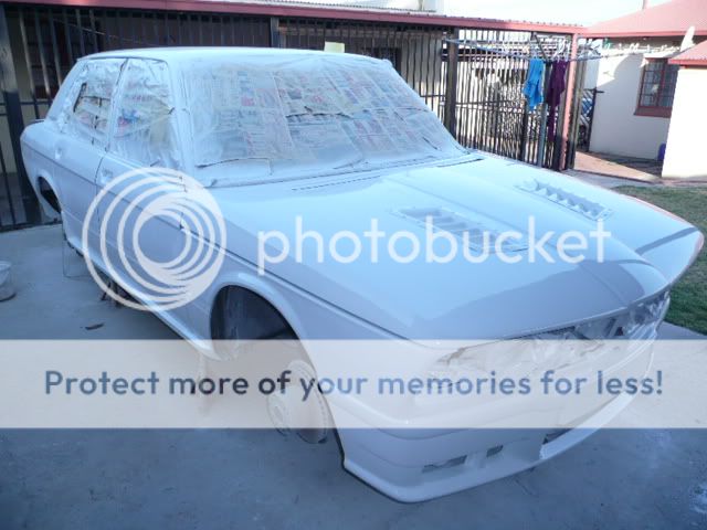

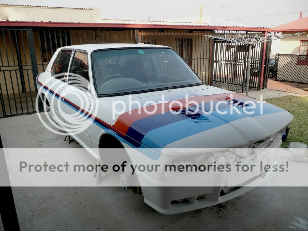

Fitting the bonnet ducts and the E36 spoiler

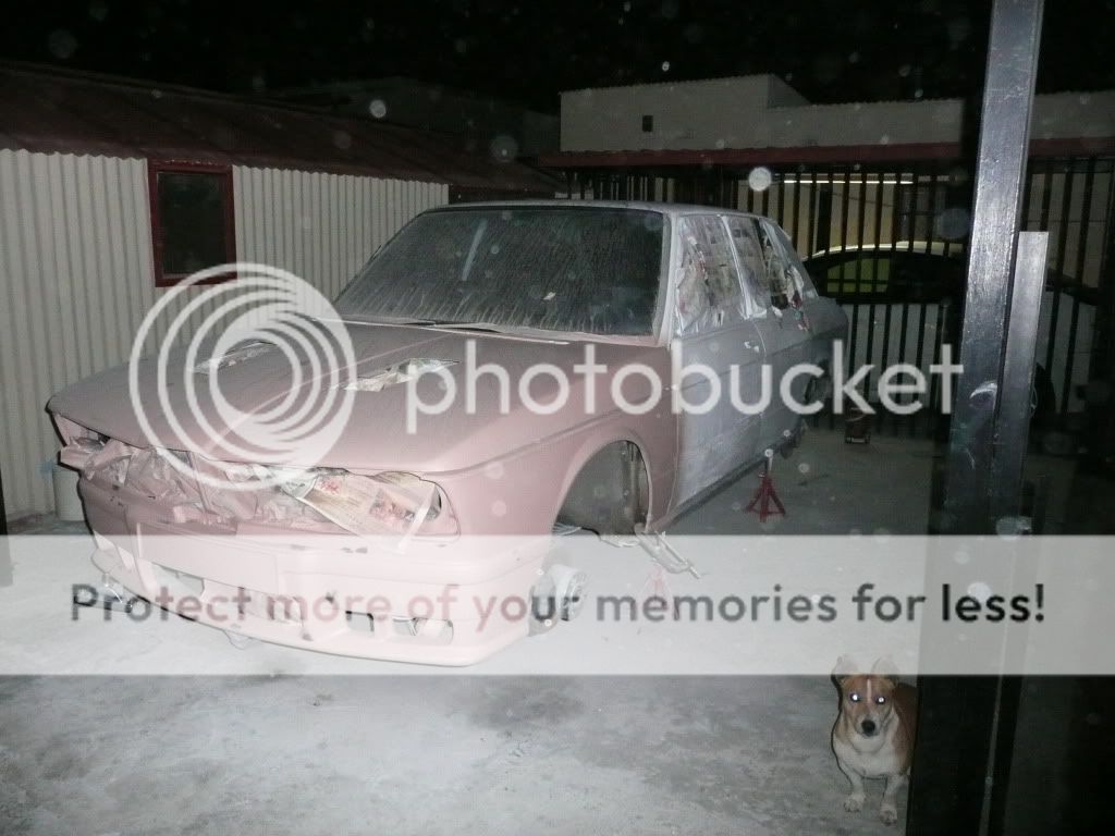

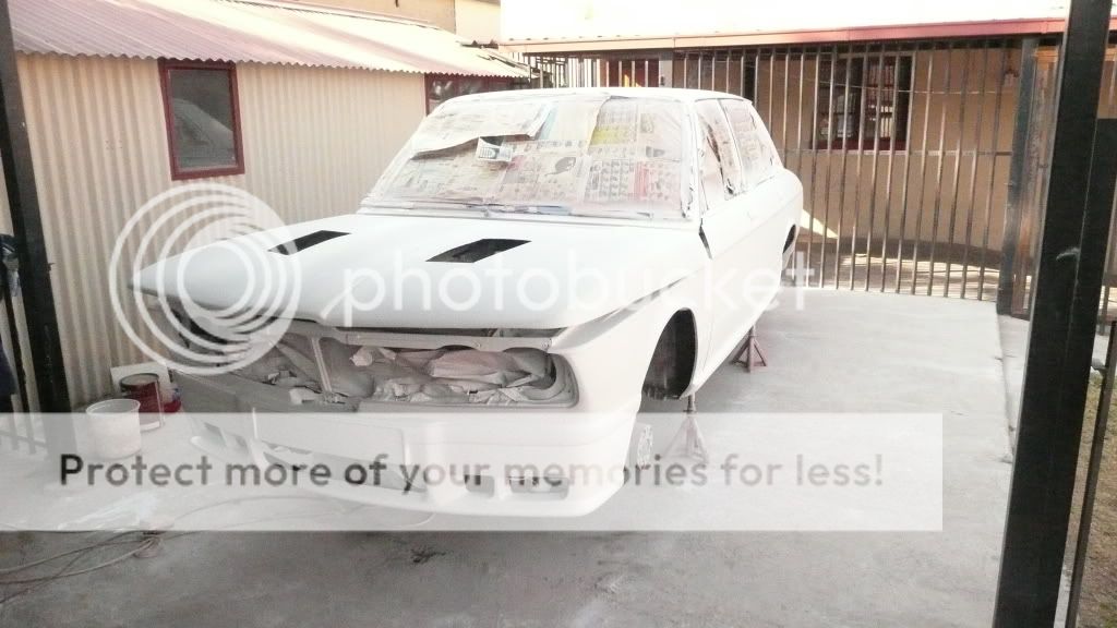

Just after the primer coat
After the base coat

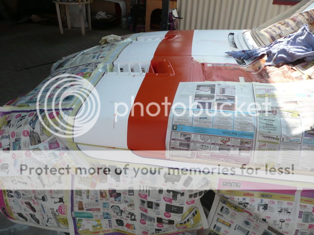

Putting on the M stripes (Mistake)
Finishing the stripes and putting on the clear coat

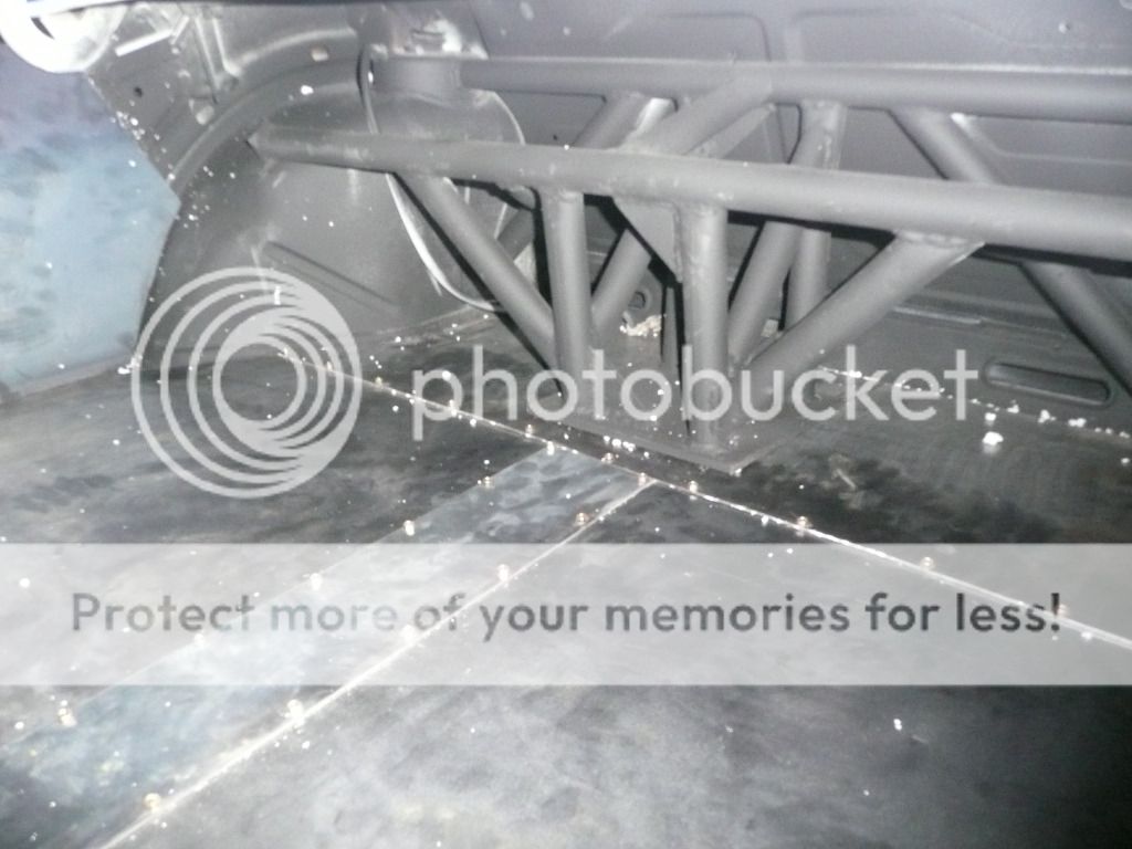

Stiffening the rear chassis and tightning the rear axle

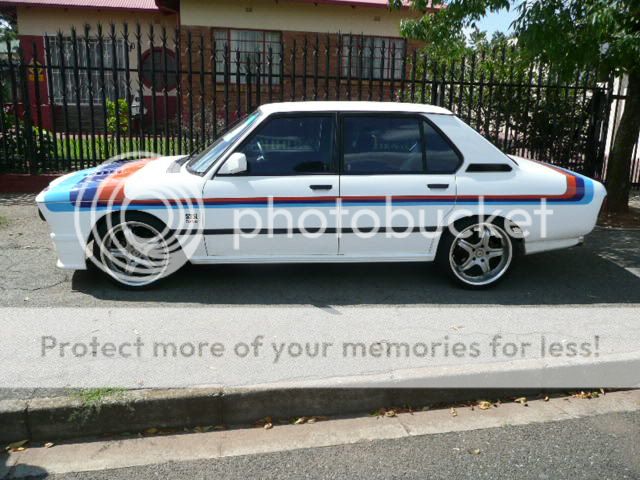

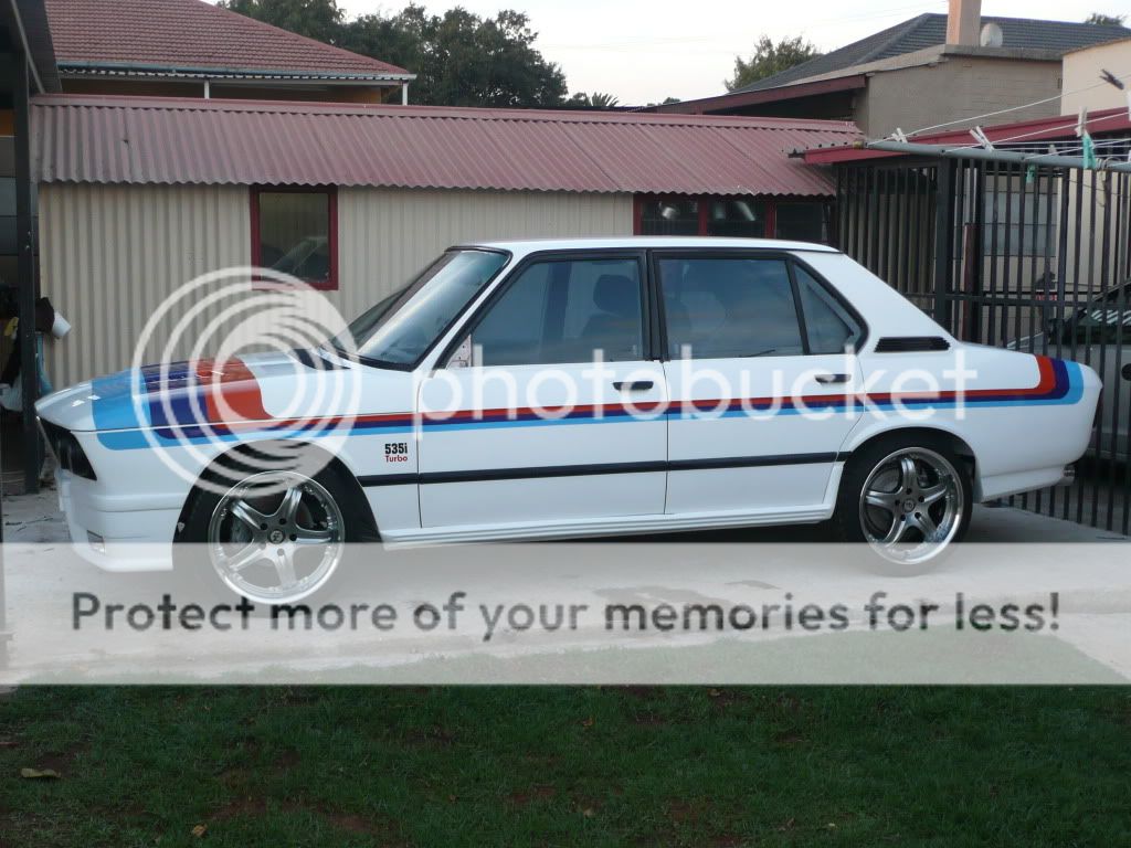

Almost there
Nearly there

Car looks awesome though, good job! I do agree the M stripes kinda kill it,also don't like the 535i turbo stickers..

I am with Julz...keep stripes on side AND sticker...what an amazing project. Yes, you sitting with the rarest of gems...Well done to you and son:thumbsup: In last picture the car appears lowered? Great! :thumbsup: If the car was designed for the track and you intend to track it make it stand out...love the white and stripes and rims...and the whole damn car:thumbsup::thumbsup:
