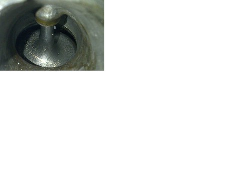

Swirled Valves in the new turbo motors head looking damn cool!!

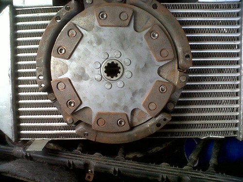

Hows that copper button clutch? Its sexy!
You must come down and see the engine, the engineering and tricks are mad impressive.:bravo:
