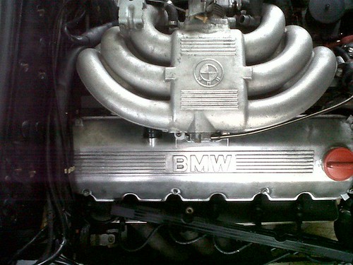

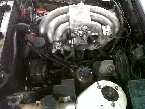

BAD news with this car, had the car at "Racing Snake" an E30 specialist for the oil pump replacement, bought the car under the impression that the oil pump was poked.
On closer inspection the car had a finger tight crankbolt, 6 bolts missing from the gearbox, almost double its capacity of oil, STUFFED bearings, mismatched injectors (3 unknown bosch injectors and 3 stock ones), engine mounts were missing nuts, motor was sitting on the mounts free of any tethering and that was just at a casual inspection.
Turns out that the oilpump itself was in fine condition and was doing its job, it was loose crankbolts et al that had failed the car.
For all intents and purposes the motor will need a rebuild.
I was informed that the motor was rebuilt with new rings, bearinge etc etc but on what has been found I am not comfortable that anything in that motor will be done correctly and as such will need to strip totally and redo all the work.

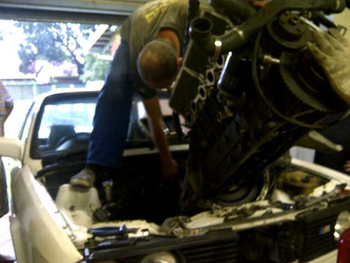

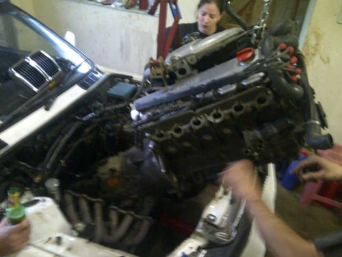

Soo gents decided that I would lose too much money selling this ride so I have decided that I am going to do a restoration and build an M20 turbo motor for it.
Yesterday with the help of Kassie, oom Hennie, dazza and the ever popular Racing Snake we pulled the motor out the car, she fought us every inch of the way and we were forced to pull the motor, gearbox and prop all at once. When the motor was free we found that it had a 318is gearbox and an incorrectly matched diff, meaning that the car would rev limit in 5th at around 160ish. Also found more finger tight bolts on the gearbox and a repaired shifter linkage. We wait patiently to see what fresh horrors the inside of the motor bears!

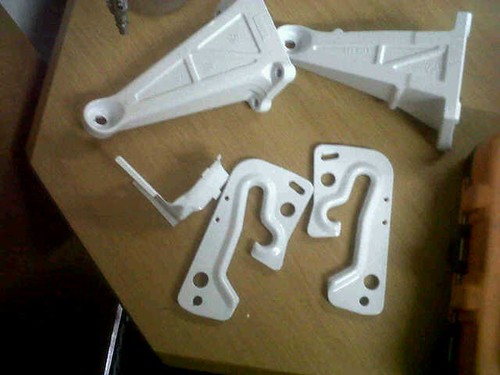

And then had some odd pieces powdercoated white, they look very good, going to do some SERIOUS powdercoating on this old lady!
Shell will be towed home this week sometime to have rust issues sorted suspension stripped and reconditioned and some big rotors fitted.

Shaun is THE only guy I would let stand on my car like that too! ha! ha!
Good work there guys, lets hope this all comes right shortly.
