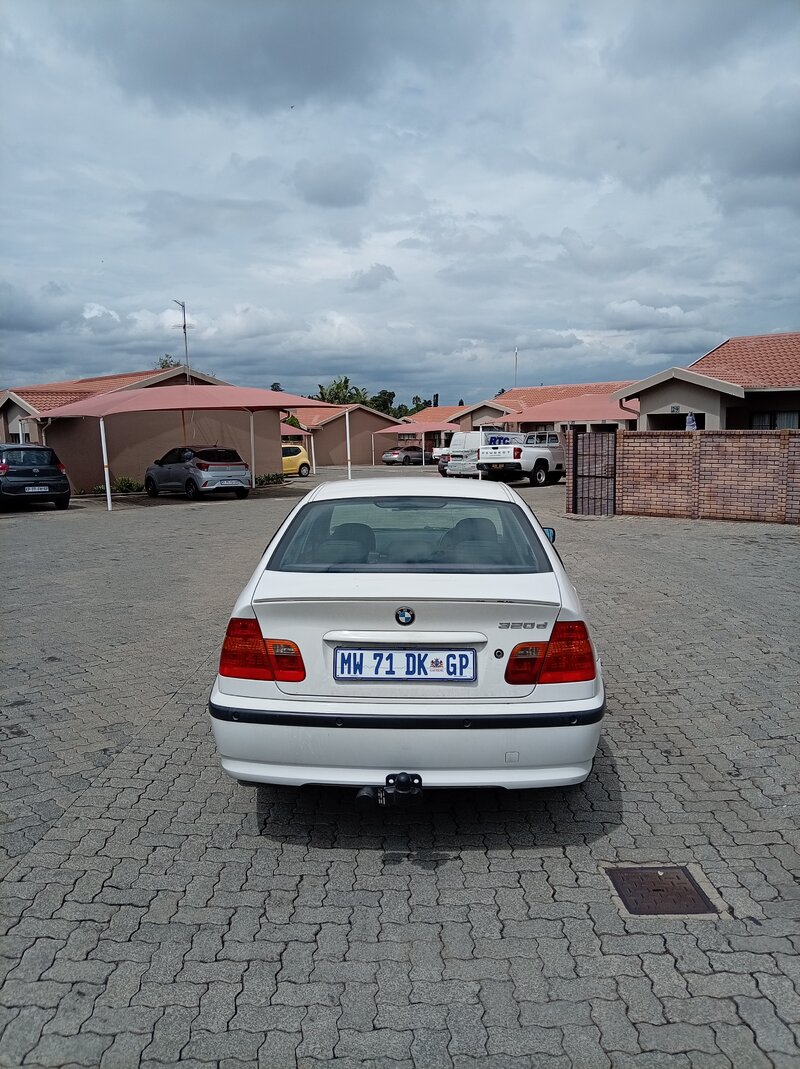

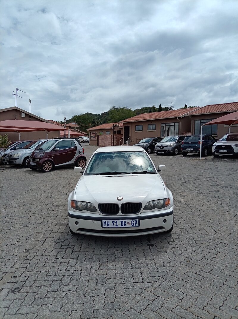

Sho! Last post December 2024. Wow.
I suppose that just sort of lets you know how good this car has treated me - In other words - None of the above took place and the car continues to soldier on. Almost nothing to say....
I gave the car to my mom in September 2023 - It remains with her - We had considered buying her a Fiat 500, or another Smart Forfour but coupled with the JHB freeway anxiety (spurred on by our near death experience last year April when a truck pushed us through 24 other cars in our Alfa Romeo) my Mom's perspective is simple - She loves the power, she loves the build quality, she loves the drive, the tank stays, end of discussion.
Of course, the last time it saw a detail or any TLC besides the car wash was about 2 years ago so I really must steal it back and just give it some proper TLC - The state it is in.... Anyways, some pics I took 3 weeks ago when she officially lost her CAA Cape Town plates and joined the rat race.
Been daily driving the little maroon Smart in the background and its quite funny to consider that while there is only 2 years of age and about 600kg worth of car seperating them..... The BMW, with 260k on the clock somehow gets almost identical consumption to the smart.
