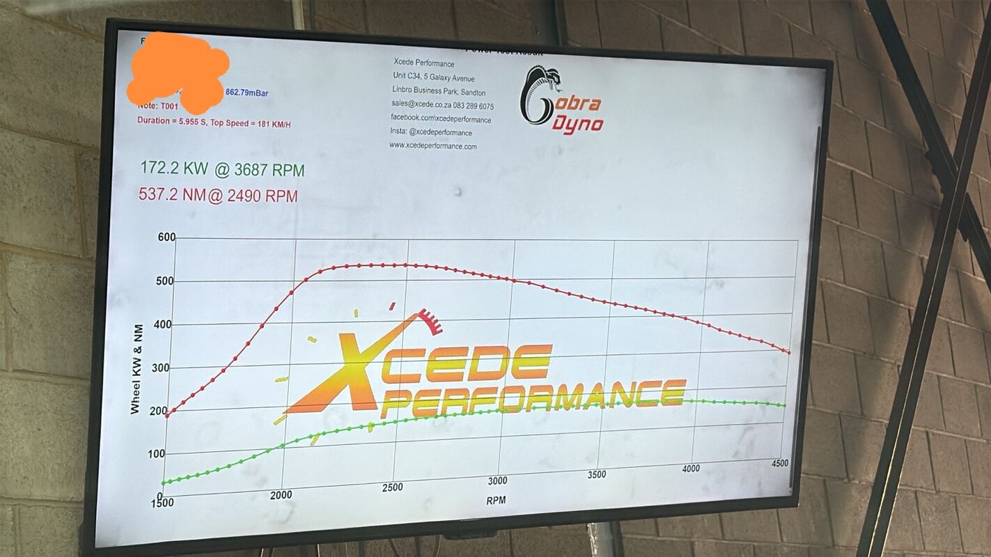

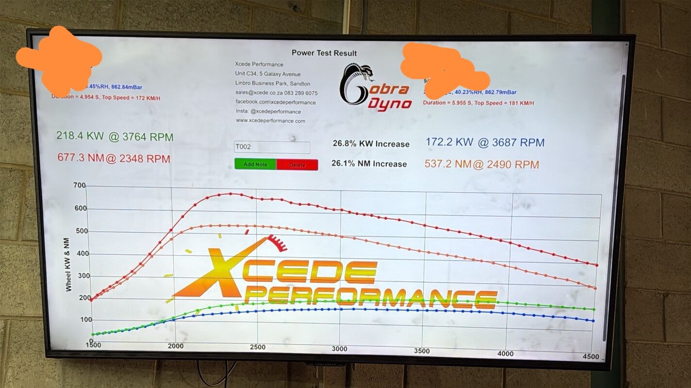

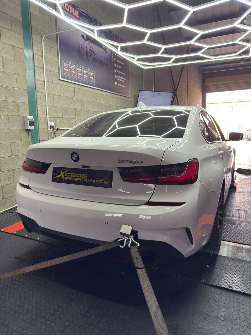

Jobs done. Had a conference in Sandton today so seemed like a good opportunity. Only opted for egr delete and tune. Will monitor afr and egt for interest sake and post some graphs.

Xcede Performance
Thanks for trusting us with your car buddy, it's nice and healthy for a Mild Stage 1 remap.

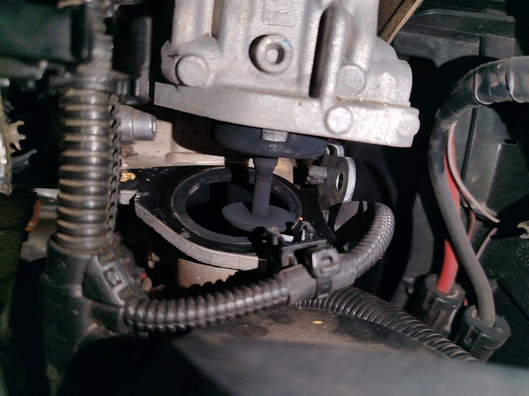

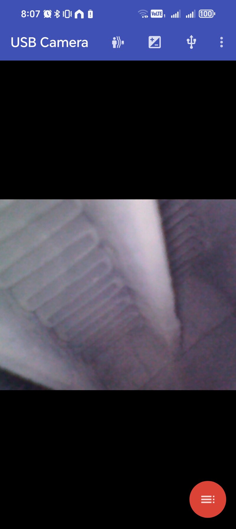

Egr looks rather clean for 100000km.

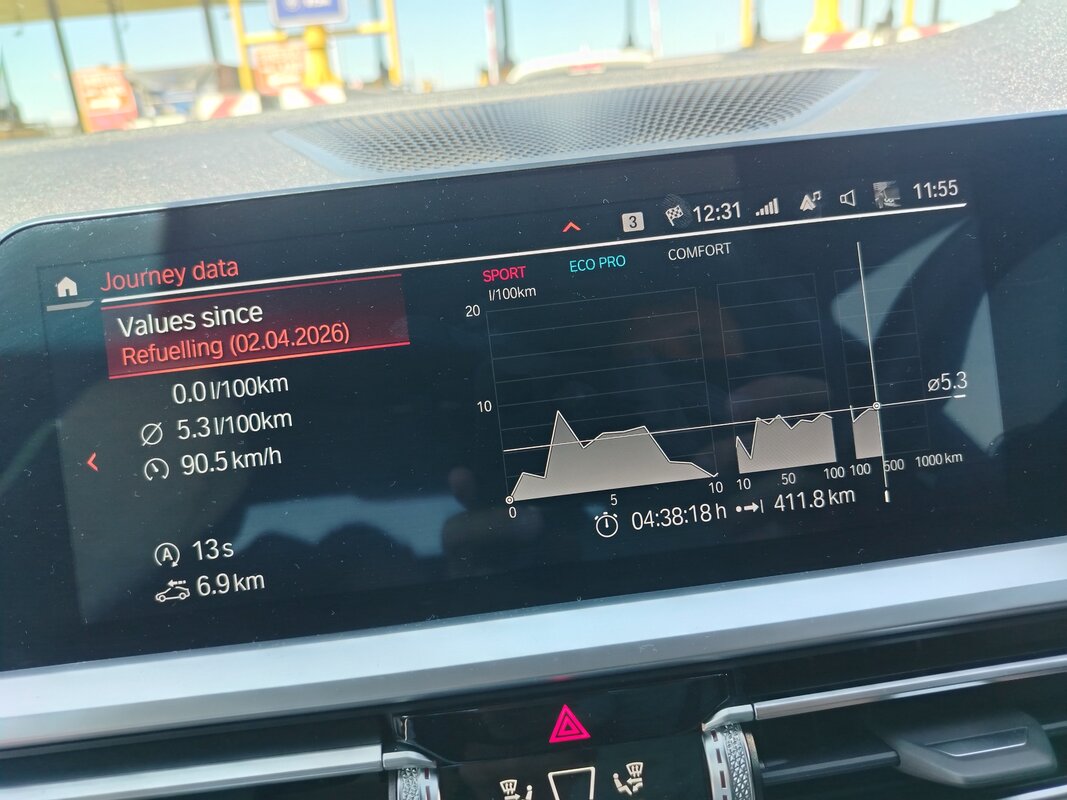

Out to Drakensberge for the week, took the B57. Such a pleasure on the open road. 5.3l/100km average cruising +-130km/h
