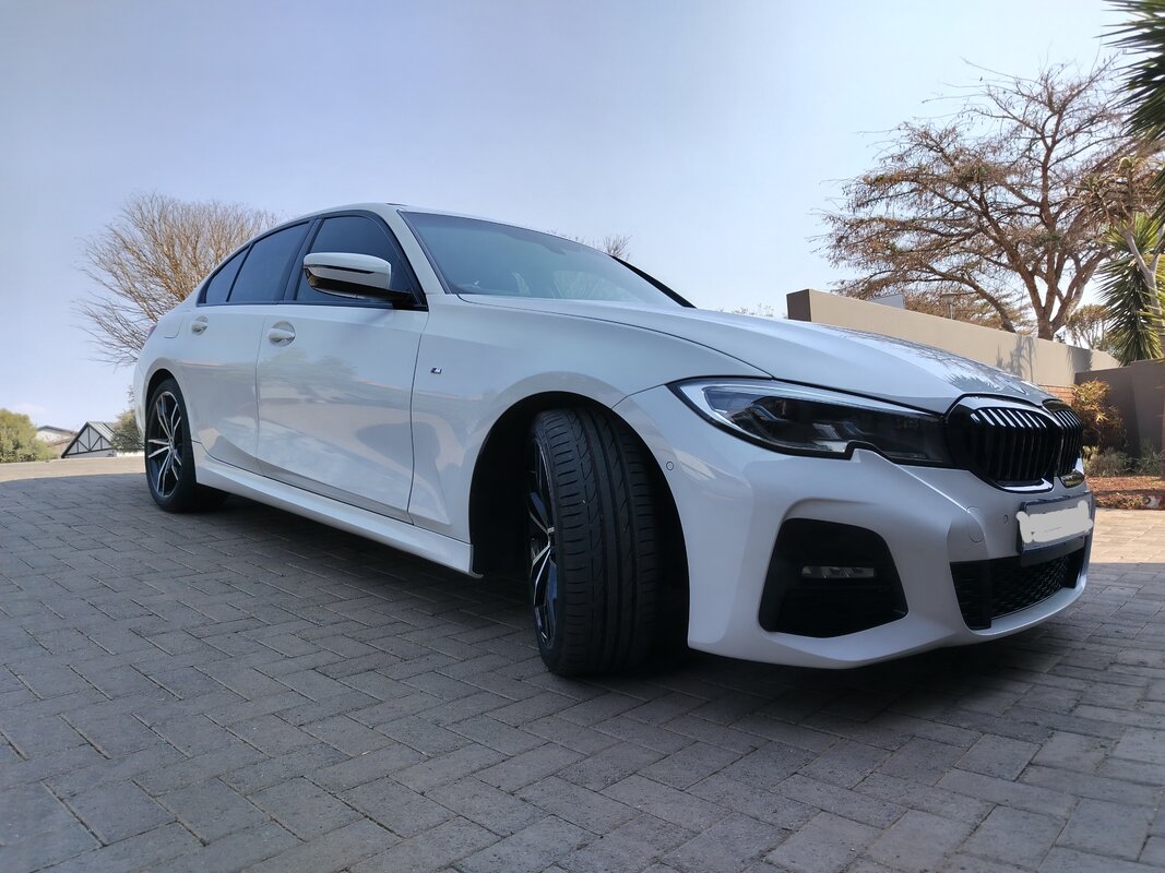

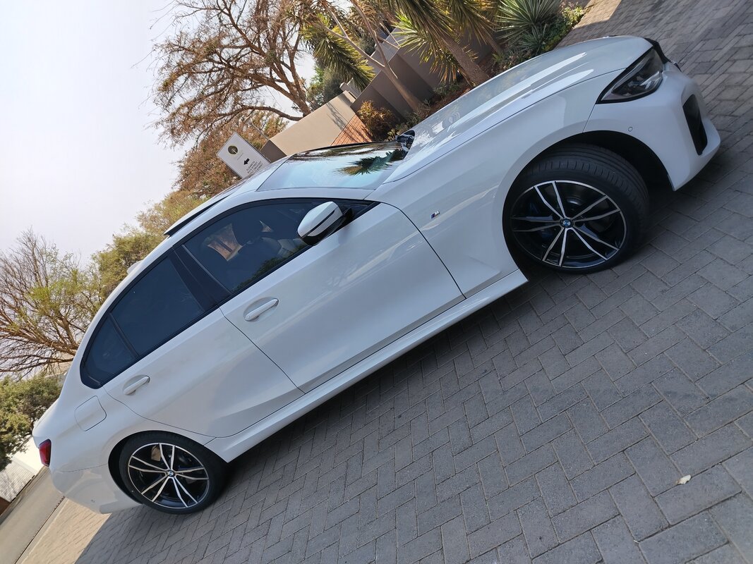

So having owned 4 x 3 series diesel BMW's in the past I've always wanted to own a 6 cylinder petrol at some stage. Seems like that time has still not come since I stumbled uppon an immaculate G20 330d 2020 M Sport. Car is white with black interior. I might have overpaid but who knows since there are so few of them in te market its very hard to determine a fair price.
Currently has 99 000km on the clock and MP still active.
The plan is to use it as an occasional daily and for client visits. Roughly about 6000km per annum so not a lot, thus the higher mileage does not concern me as I will average it down over the vehicles lifetime.
I will probably drive the car from 100 000km - 150 000km
Any recommendations on extraordinary maintenance over this period appart from oils, filters and brakes?
Gearbox Service?
Timing Chain (probably not)
Anything else?

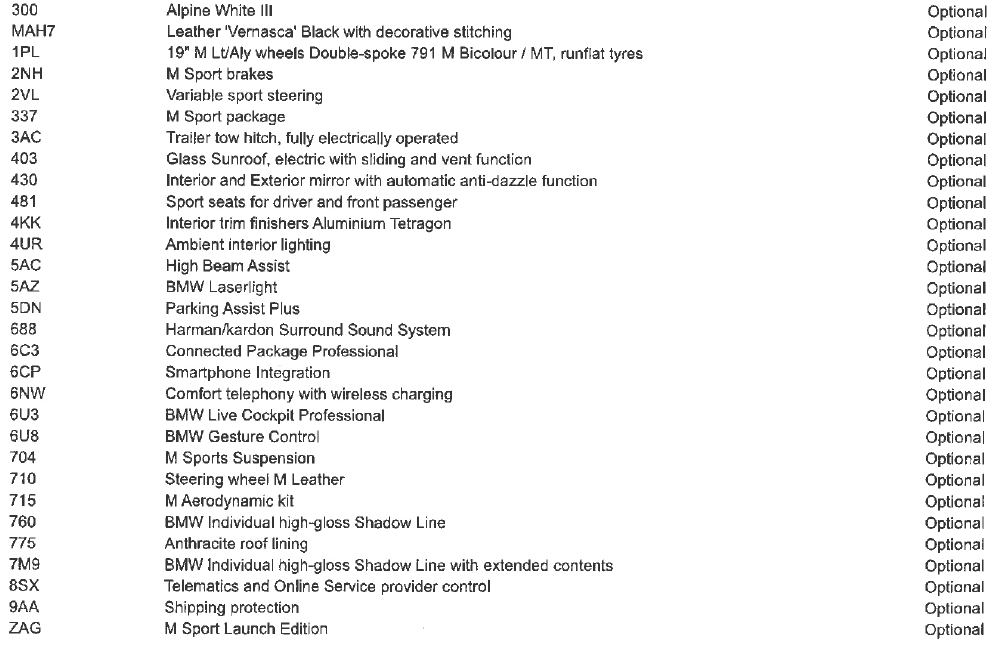

Got the detailed specsheet with optional extras, must say I am very glad for most of them.

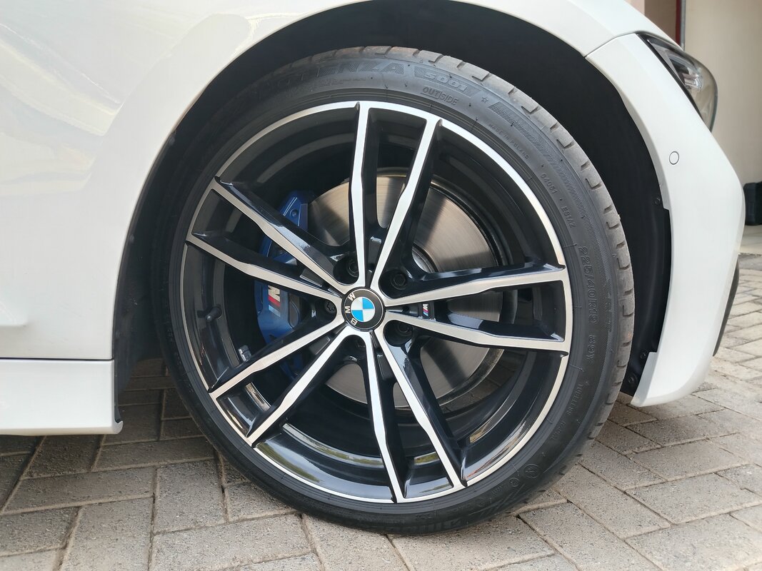

Replaced 2 rears with the same set of Bridgestone Potenza's. Picked up a few slightly buckled rims, typical for SA roads and had them straightened.
TyreMart and the Dealer did however note that one front shock is slightly bent, cant feel it whilst driving so not sure if I should attend to this immediatly or just leave untill I replace both later on. Was only picked up when doing wheel alignment.Screenshot 2024-09-18 100411.png

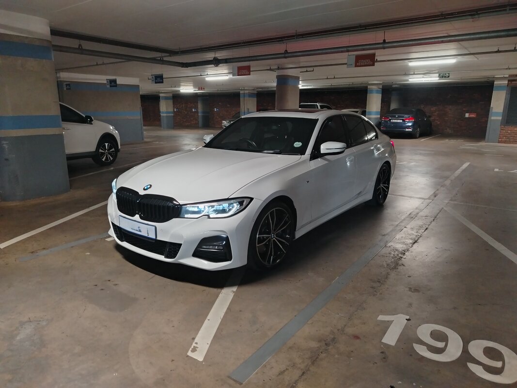

Not too much going on with the 330d.
Had the gearbox replaced by dealers just before end of MP, complained about jerky movements when shifting between P,D and R, not that serious and they offered to replace it. Had the diff oil changed as well just before 100 000km.
Other than that the B57 is a super nice daily and perfect in traffic, never a robot that cant be caught and lane changes are super efficient.
I do from time to time smell slight exhaust fumes around the drivers area (mid section outside) of the car, dont know if im just overly sensitive or what it could be.

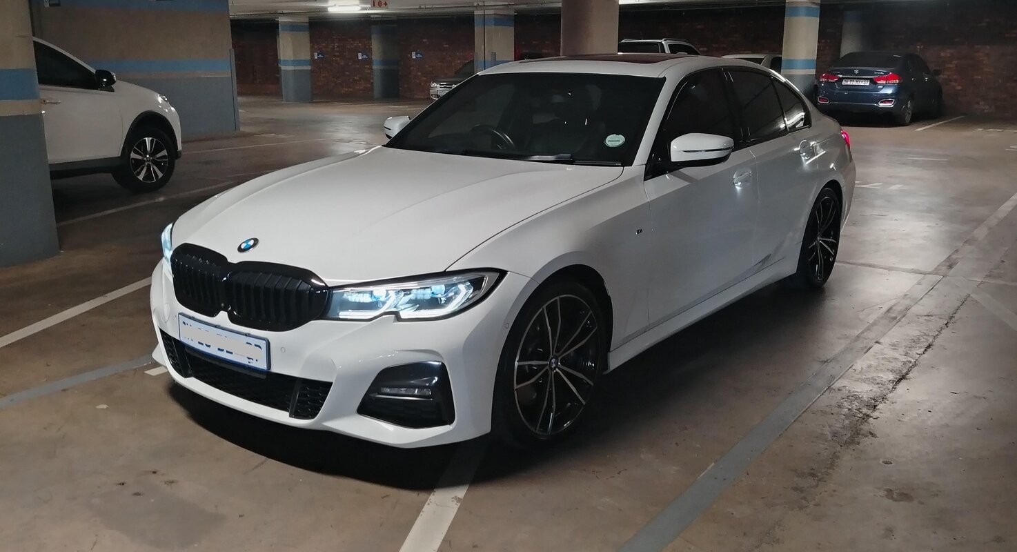

A little basement shot:

Those fumes could possibly be the car saying to you: "Time to get rid of these CATs bro, I need some Stage 2 tuning as well!"
///M Individual
Yoh new gearbox on a G series!
Sure they found something major wrong to get a large cost like that approved by MP.
Big win for you though well done!

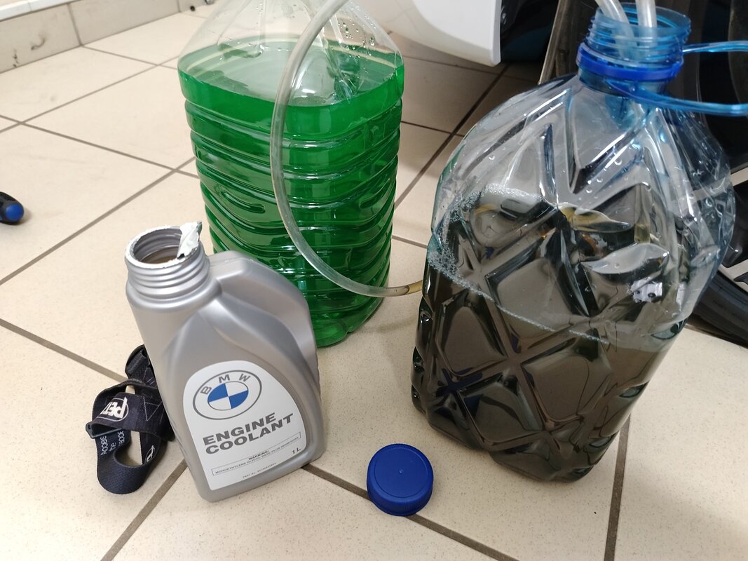

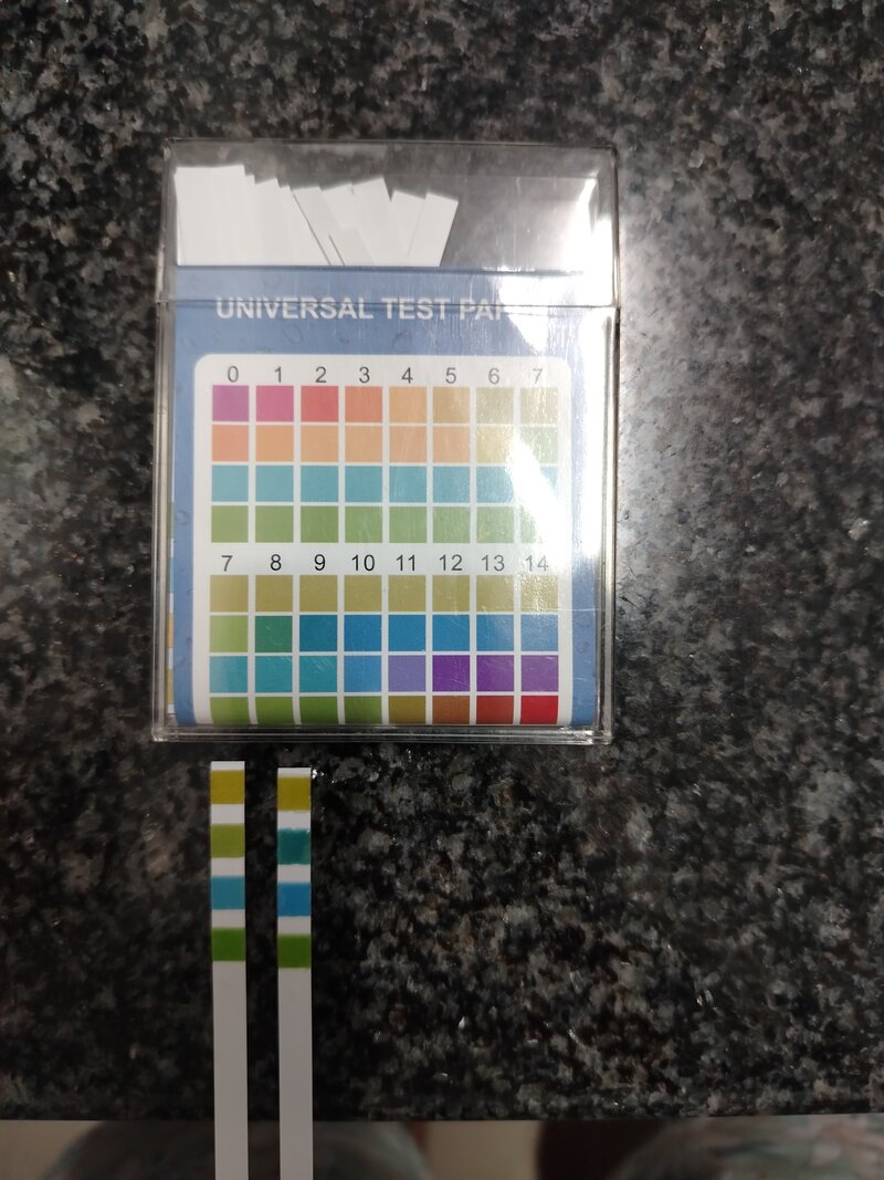

Wanted to flush coolant, these cars certainly are not designed for an easy flush. Opted to drain the coolant reservoir 3x times and refill with OEM between driving periods. Must say the coolant does mix quite well and you can almost drain 5L which is quite a lot. The PH of the coolant in the car has risen back to above 8. This process maybe uses a bit more coolant than normal but labour wise its much easier. Will just do it again in 12 months time. I get that you will not drain residue in the bottom but the lower pipes does not sit right at the bottom of the radiator anyway.

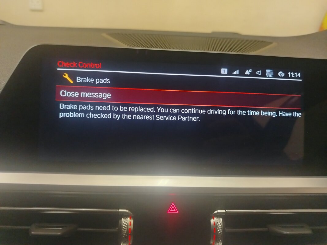

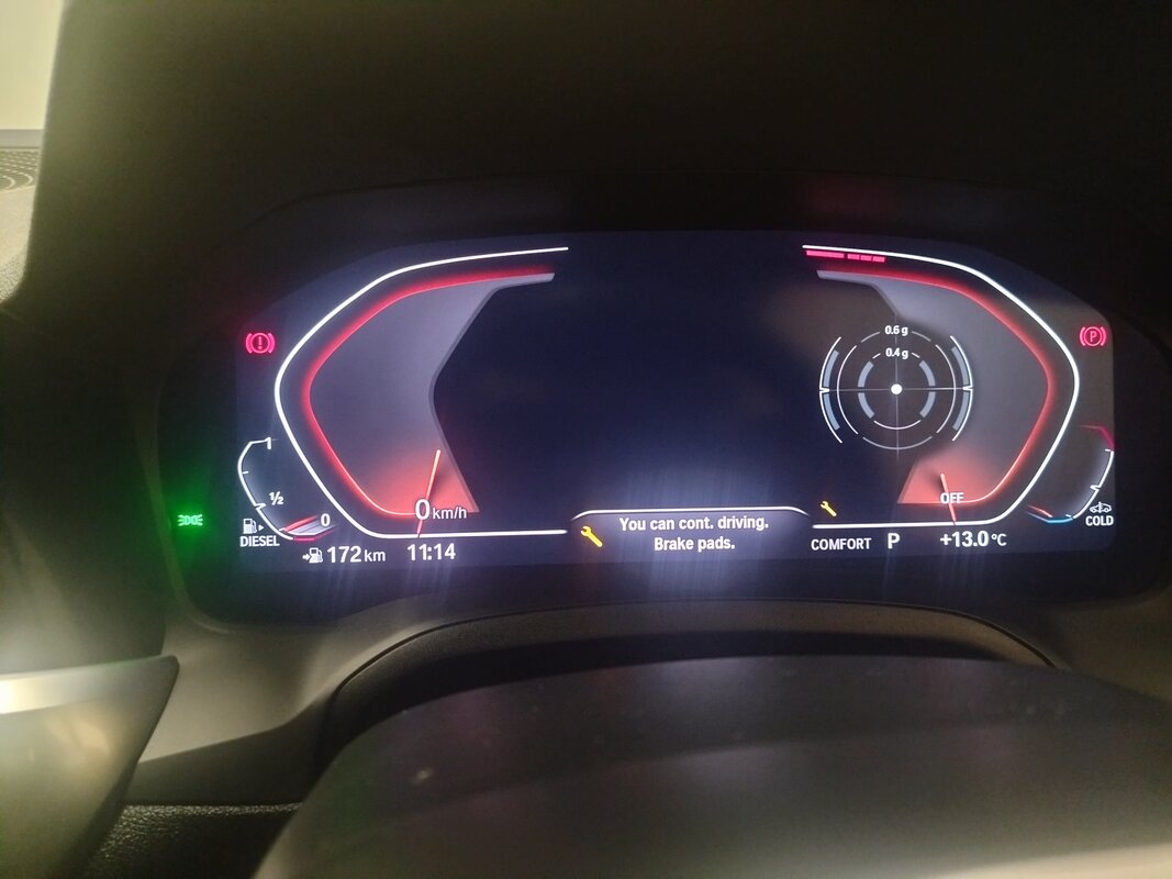

Had a rear brake pad warning, checked them to still have lots of meat on and no need for change. Only changed the sensor and reset on ISTA and problem solved.

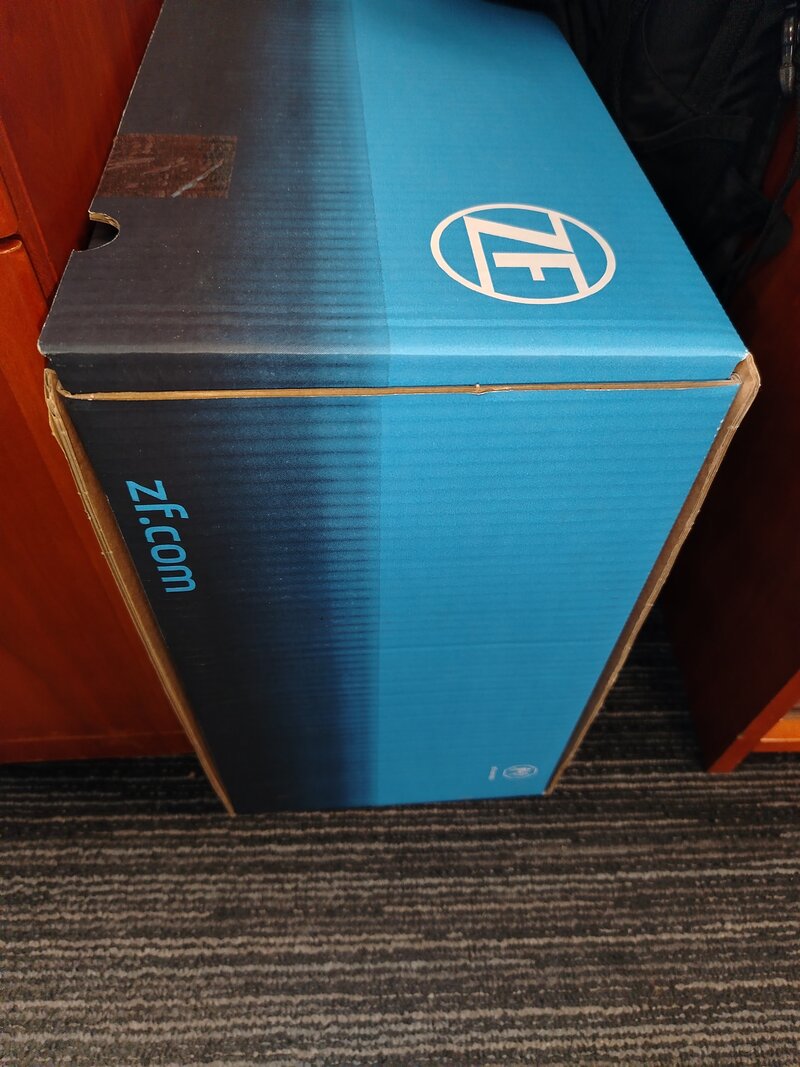

On a side note my Discovery has the same gearbox, ZF 8 HP. I ordered an oil change kit from ZF for only R4700, comes with new bolts, gasket, oils, pan and filter. Assume you can do the same for the BMW's. They DIY on the gearbox service is rather easy and straight forward. Only setback on the BMW would be the low ground clearance so a lift would make your life a lot easier.
