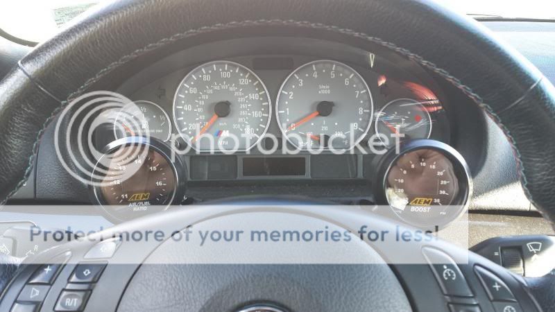

I have AEM boost and AFR gauges in the car, sitting inside Mickey Mouse pods atop the steering. HPF use them in all their turbo cars. This was in the car since I bought her from MATTQ.
Above pic is NOT my car, but looks pretty much identical"
After the charger installation and software was loaded, we did some AFR readings to get the correct air fuel ratio tune done, but kept noticing that the boost gauge was not registering any boost above 0psi. At idle, it sits at -20 or so, which is vacuum and what it should be sitting at. As soon as we start driving, it starts moving up to -10, then -8, -6, -4, -2 and just stops at 0psi around 4000rpm.
