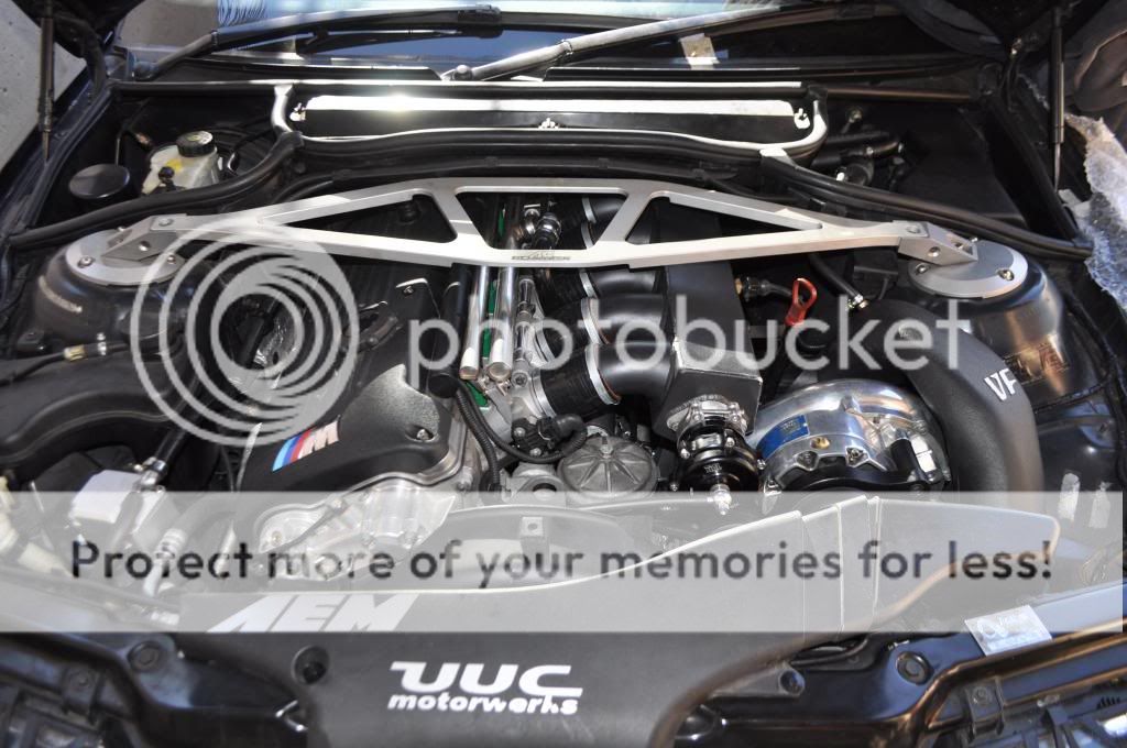

Jezebel should be arriving soon for her Alpha N Supercharger tune. There is currently a base file on the car so that Chris can get around.
I will use this thread to show everyone the attention and detail that goes into a custom Project Shift file.

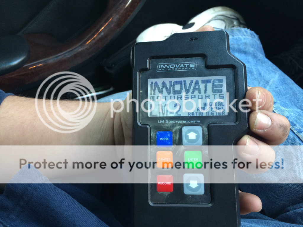

My weapon of choice to test AFR's (Air fuel ratio) is an Innovate LM2

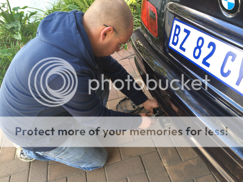

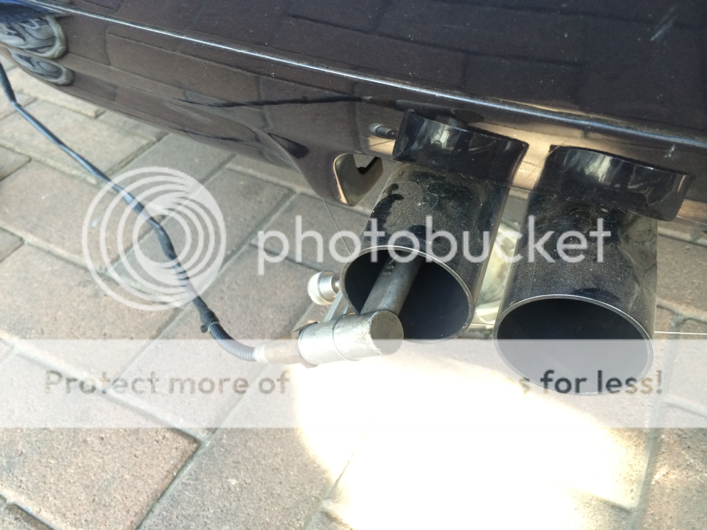

Attaching the 02 sensor. I always add some metal wire from each exhaust hanger to the 02 sensor mount, this will make sure the sensor doesnt move or fall out.

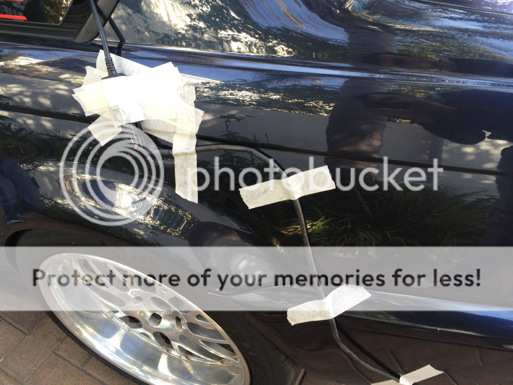

I always use more tape than needed to secure the line and make sure the connector doesnt scratch the paint. I used to run it through the boot, but after a while, the cable started giving issues.

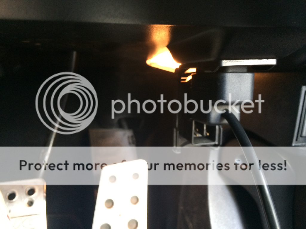

Plug Innovate into OBD so I can measure accurate AFR vs RPM

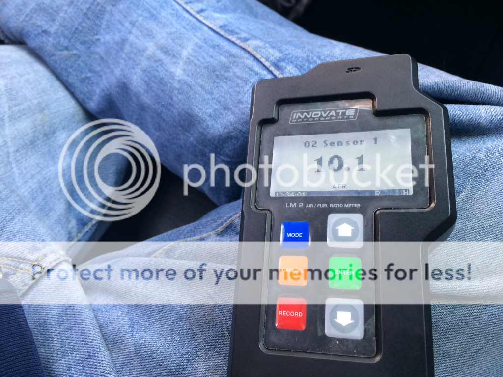

Idle AFR:

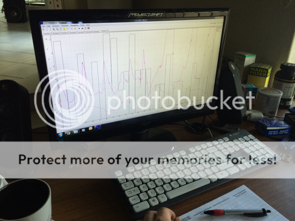

AFR's all done! Below in graph form. Red for RPM, Pink for AFR. Youll notice the AFR sky rocket into the 20's. That happens when changing gears or lifting off the throttle.
Afr's ranged from 10.2 to in the high 13's, this is FAR from perfect as with a supercharger file, we target AFR's between 11.5:1 to 12:1

You are collecting data from one of the exhaust pipes.
Why not both exhaust pipes (one from each side of the car)? (or are you?)

dont think that matters there is a chamber where all exhaust gasses will mix in the back box of the M3
Burgy
Moranor is correct, there are 2 points where the gasses mix, so afr would be the same on either bank or tailpipe.
Yes, I will compare my logs with inpa logs. Generally they are the same.
In principle you may have a point in reality though the inside pipes are perforated and packed in glass fiber therefore the mix of gasses may well happen but not as thoroughly as they might had there been no glass fiber around the perforated steel pipes.
moranor@axis
flow rate could differ on this car between pipes but all exhaust gasses are mixed before they exit the chamber? see the camber in the center before it is split into 4
Burgy
The backbox isnt the main source of the 'mix'. M3's have an H pipe right after the cats and a center box.
All tailpipes will yield the same afr unless something catastrophic happens to the exhaust
