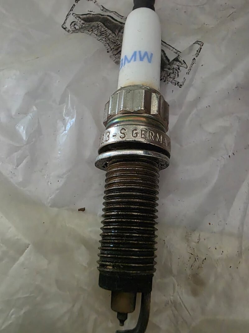

I wanted to post this in the F30 or 335i forum but i saw that i could not insert pictures.
Yesterday I went for a drive, and decided to push the car a bit. I did a pull in third gear, and just as the car got into boost, the car started to cut out and I got the drive train error and the car went into limb mode. I immediately stopped and found a code for cylinder 1 misfire, injection switched off. I cleared the codes and carefully home. The car idles fine and does fine when driving calmly. Decided to switch Coils but the issue stayed the same on cyl1. I then switched the spark plug to cyl2 and the misfire followed to cyl 2 with the same code. I'm guessing its time for new spark plugs?
I might go with NGK 1 step colder as im on an MHD stage 1 tune
2012 F30 335i N55 PWG
