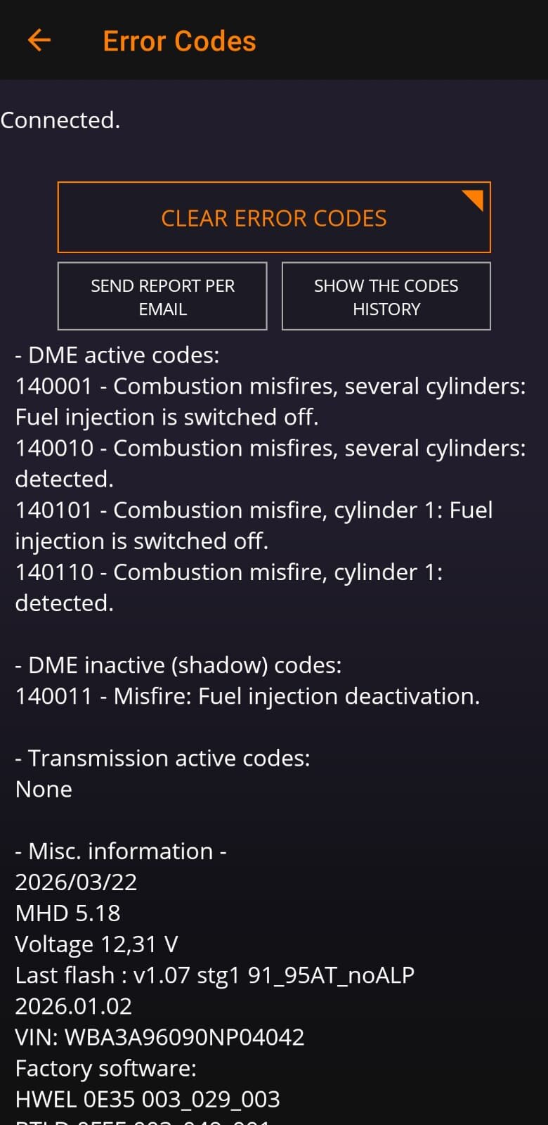

Yesterday I went for a drive, and decided to push the car a bit. I did a pull in third gear, and just as the car got into boost, the car started to cut out and I got the drive train error and the car went into limb mode. I immediately stopped and found a code for cylinder 1 misfire, injection switched off. I cleared the codes and carefully home. The car idles fine and does fine when driving calmly. Decided to switch Coils but the issue stayed the same on cyl1. I then switched the spark plug to cyl2 and the misfire followed to cyl 2 with the same code. I'm guessing its time for new spark plugs?

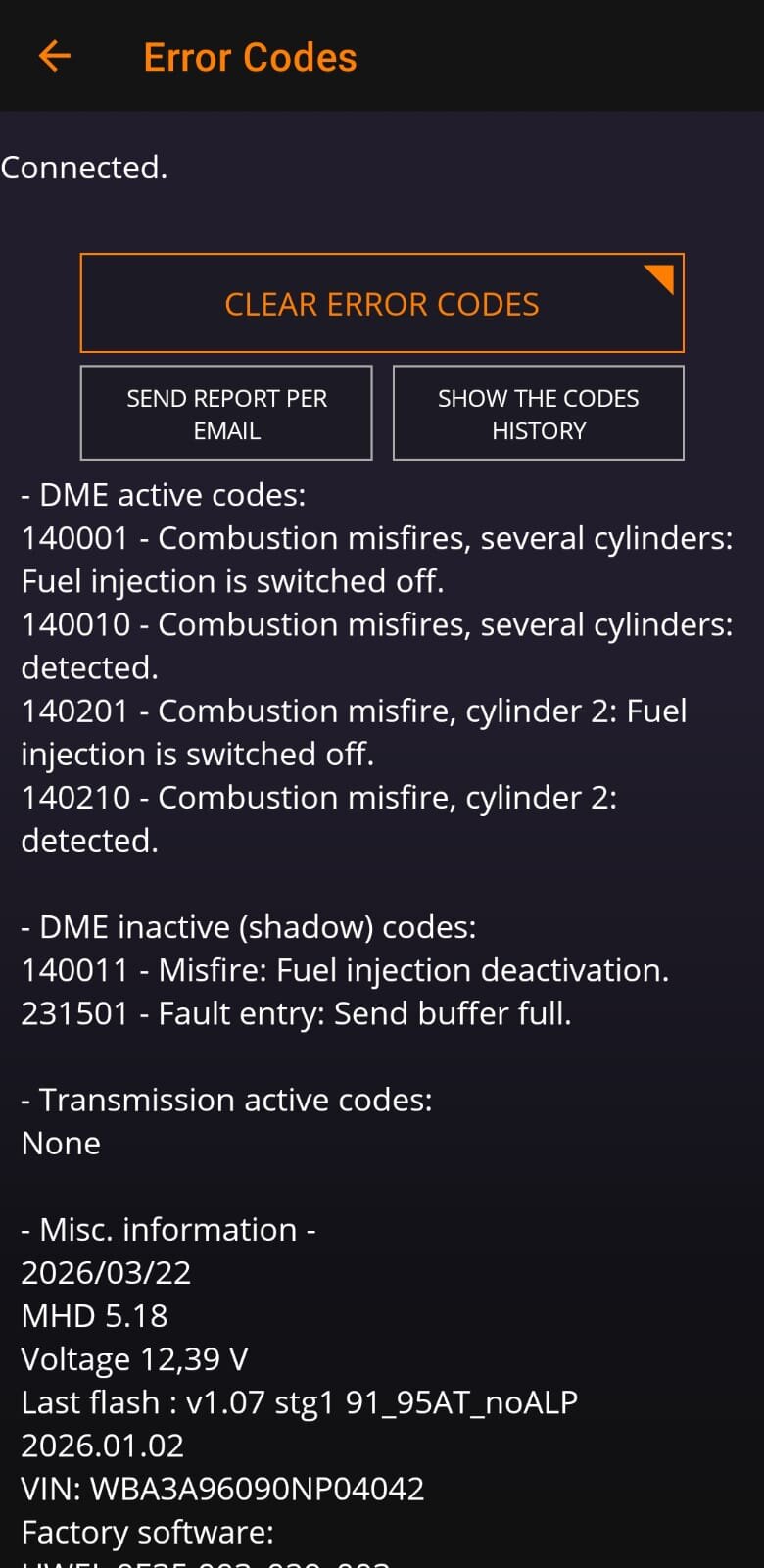

I was super scared at first because before the misfire codes I had a Super-knocking code on cyl 6, but when i removed all the spark plugs, i probably put cyl 6 plug into number 1. When i logged the car yesterday wyen the misfire codes came, i had no timing cor on 6 or any other cyls expect for 1. And then i switched the plug to cyl 2 and the miss followed. At first i thought i had a bad injector, but from what i heard, the n55 has quite decent injectors and they last a while?
