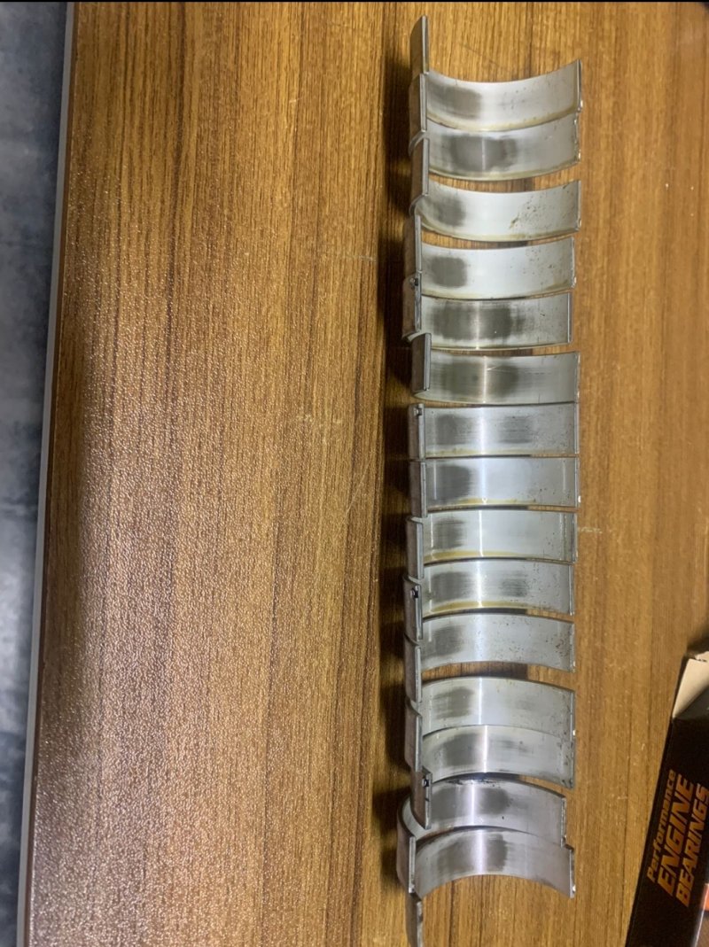

So, first thing I had done on the car is swop out the bearings again with Sav and give the car a full inspection.
These had 23k km on them, about half of that supercharged.
922-ZN
Those are some rough looking bearings for only 23 000km!
Agreed, seems like alot of pitting also.
@Peter@AEW Could something else be up?
It's also worth checking the main bearings(while it's open) on Supercharged cars(specifically the front of the motor), these have been known to fail. Not on the scale that rod bearings go, but they do fail.

Main reason I also wanted to change them was that the car was only driving 10km a day round trip from the previous owners house to work.
That's no time for oil warm up and noone is going to consistently warm up their car before starting the trip to work. Hence I thought there would be excessive wear on this, +supercharged
Detonation in abundance!
I hope you are not fitting ACL bearings.
Eust
Sav is putting in ACL Race bearings as far as I understand.
Is the detonation due to the excessive heat generated and should I be using OB in this car?
922-ZN
You HAVE TO run proper fuel in this thing. If the cars detonate in n/a form and even in stock form under our fuel conditions, what do you think it's doing considering its charged now?
In my n/a car, I have gone up to 35% Ethanol and all was well, the car loved it.
Supercharged cars have been happy up to 20% on the stock fueling system, but I would suggest you have the tune looked at as well as running some logs to monitor timing pull/advance, short and long term fuel trims under pump fuel and ethanol mix and compare the 2.
+1 on what Peter said, DO NOT use ACL, if you are dead set on an aftermarket bearing, I would rather go with BE bearings.
That being said, rather put the OEM bearings as the jury is still out on all aftermarket bearings. The bearings themselves were never the issue of premature wear so why change a part that isn't the cause?
