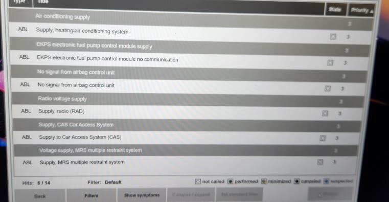

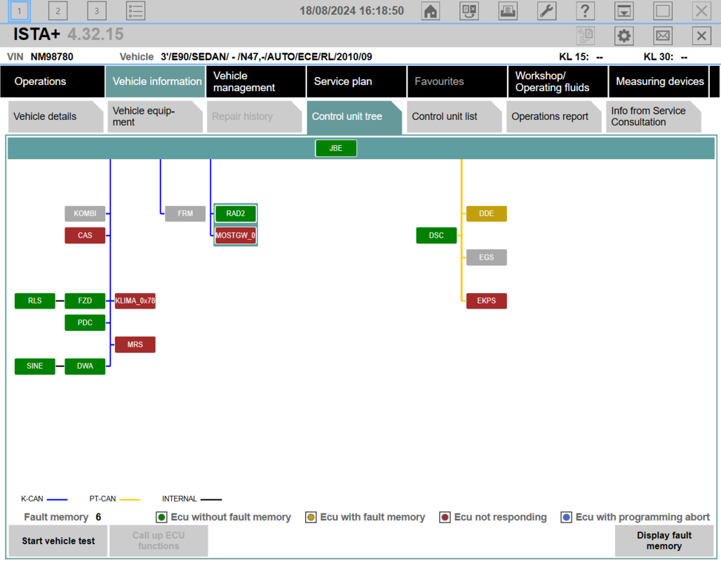

When I connect to Ista, I cannot get communication to multiple modules. I've checked Relay 30G, and it seems to be fine.
Anyone have an idea on what to look out for?
Could the EKPS module be causing some comms issues?

I was thinking FRM, but all my electrics work just fine. Also suspected alternator or battery, but that also tested fine. I suspect EKP module as it's the only one on the PT CAN line that's not responding. The one thing that's also common is JBE.
Really stumped on this one!!!
