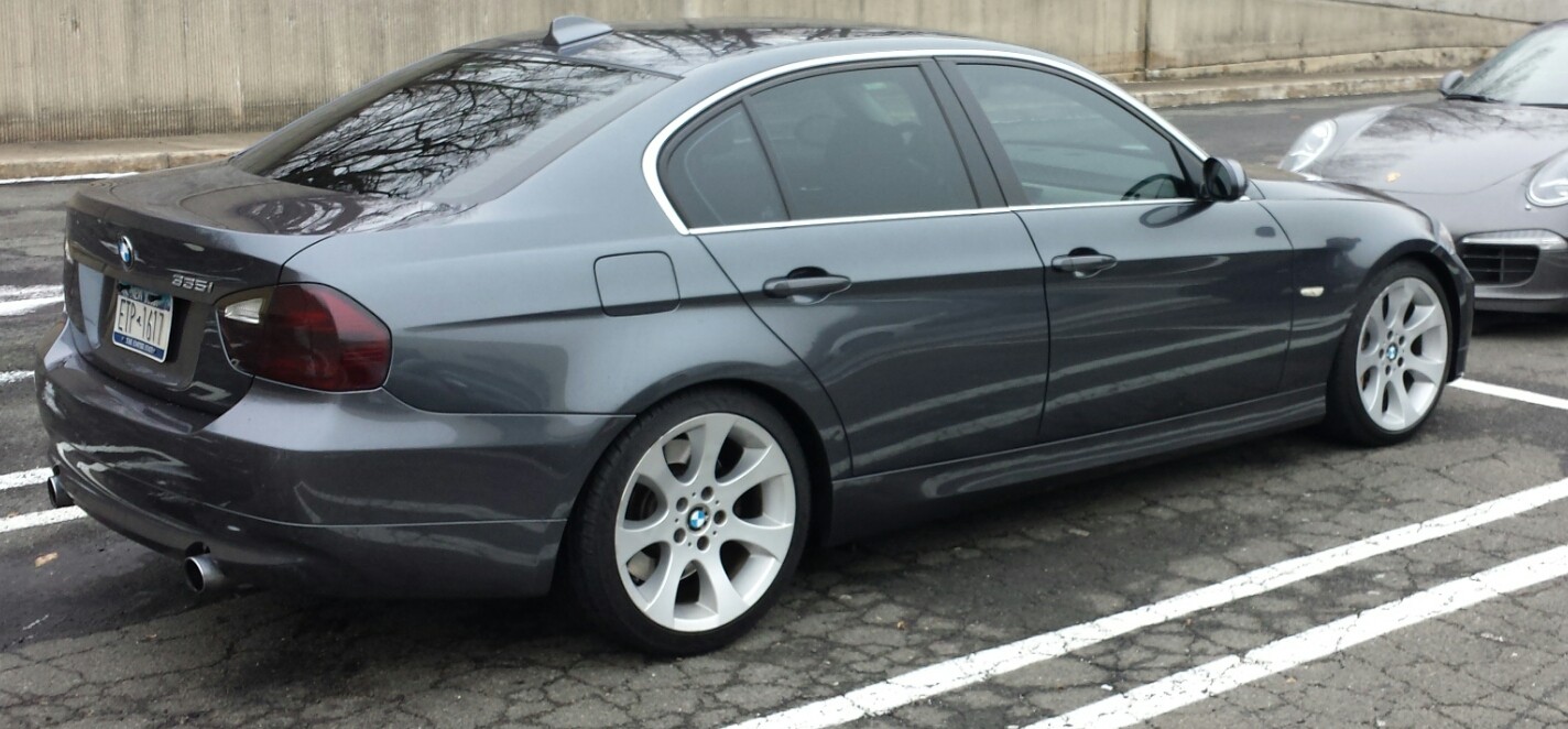

The N54’s career spanned a decade and became BMW’s go-to engine for every x35i variant of the 1,3,5 and x6 series among others. Reviewers at the time noted that, despite being significantly smaller than the 4.2L naturally aspirated 550i, the N54 E60 535i was only “marginally slower” and benefitted from an incredible amount of handling compared to the hulky V8. The quality of the turbocharger was described as “in feel and sound the twin-turbo could pass for naturally aspirated". Building on its direct-injection Double-Vanos variable valve timing system and BMW’s utilization of a twin-scroll low-pressure turbocharger had reduced the dreaded turbo-lag remarkably and is still well regarded for its linear power delivery.
While BMW had formally ended production in 2016, the N54 hasn’t retired to bask in the glory of its five-time International Engine Of The Year trophies and hung-up its gloves just yet. The N54 is still in high demand, and despite being replaced by the N55, many drivers who upgraded have gone back to the N54’s. But even prized fighters have their weaknesses. The N54’s golden record has some black marks with some issues ranging from the superficial to the mechanical defect-kind. Some problems seemed to be shared by multiple drivers and others being strangely localized.

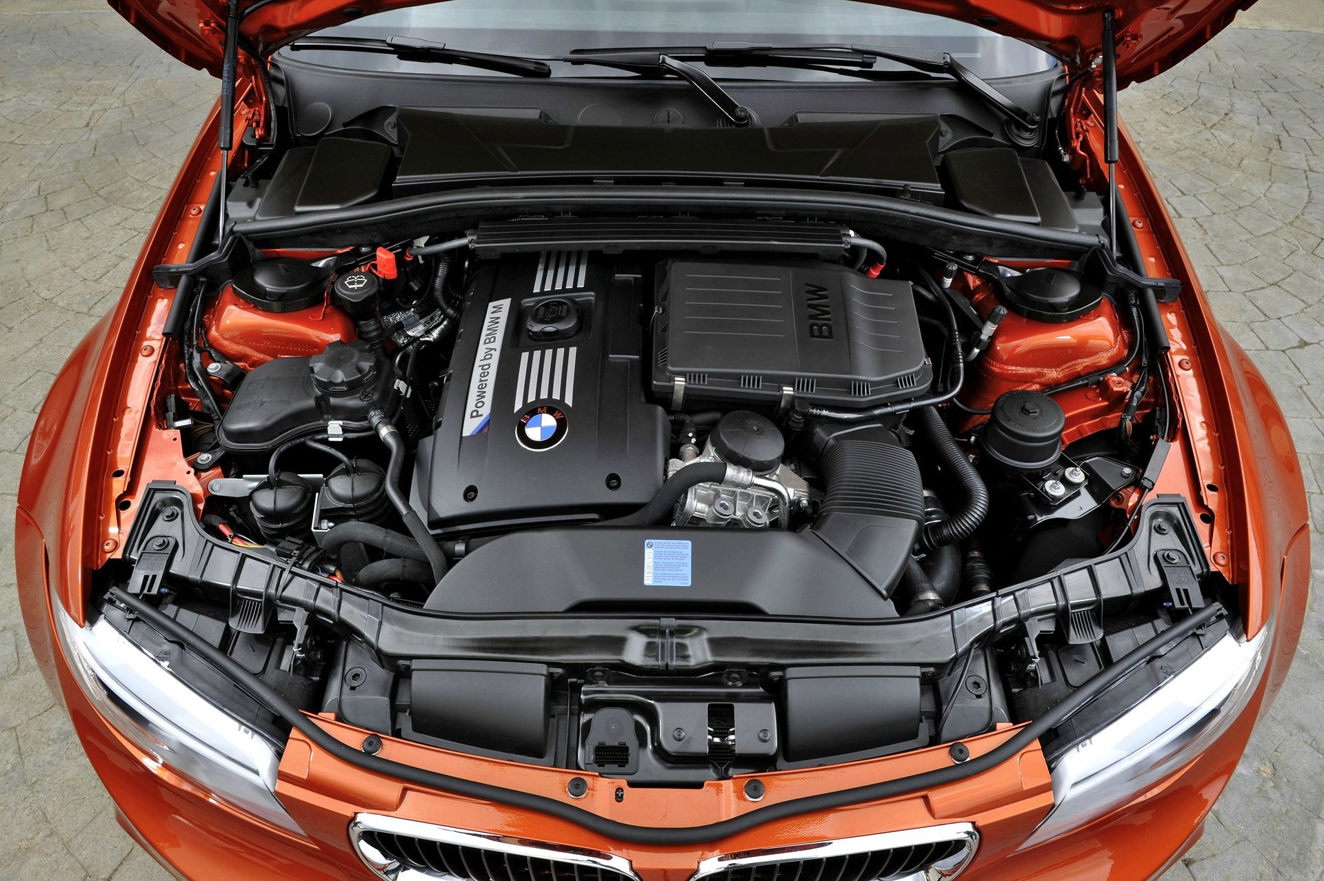

Technical Specifications:
Here’s a brief breakdown of the engine, technical specifications and the models that the N54 engine runs. If you’re unsure whether your BMW has the N54 engine, the most reliable and accurate way is to do a VIN check.
Production: 2006 - 2016
Engine Name: N54B30 (N54)
Configuration: Straight-6
Displacement: 3.0L, 2,979 cc (181.8 cu in)
Valvetrain: DOHC, with VVT, 4 Valves Per Cylinder
Piston Stroke: 89.6mm (3.53 inches)
Cylinder Bore: 84mm (3.3 inches)
Compression Ratio: 10.2
Turbocharger: Twin-turbo (single twin-scroll), 2 x Mitsubishi TD03-10TK3
ECU: Siemens MSD80
Fuel Type: Petrol
Recommended Oil Change Interval: 7,000 to 10, 000km
Recommended Engine Oil: 5W -30, 5W-40
Engine Versions:
225 kW (302 bhp), 400 N⋅m (295 lb⋅ft) at 1,300-5,000 rpm
240 kW (322 bhp), 450 N⋅m (332 lb⋅ft) at 1,500-4,500 rpm
250 kW (335 bhp), 450 N⋅m (332 lb⋅ft) at 1,500-4,500 rpm

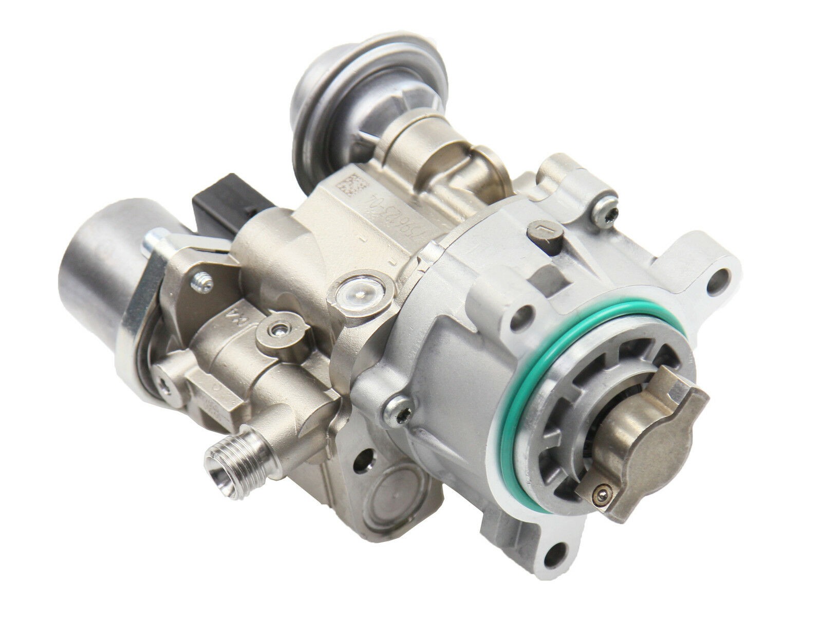

1) High-Pressure Fuel Pump (HPFP) Failure:
Signs of failure:
Long crank time (slow engine start)
Check engine light illuminated
The car enters limp mode and runs poorly with decreased power
Probably the most severe and prevalent issue that crops up with the N54 is HPFP failure. Numerous reports back in 2010 caused a scandal for BMW in the U.S. and resulted in a class-action lawsuit. BMW announced a voluntary recall for 2007-2010 models mated with the N54 engine and even provided a ten year, 190,000km extended warranty for the HPFP. The recall affected 130,000 cars with nearly 40,000 BMW’s having their fuel-pump replaced. This only applies to the U.S unfortunately, but the upside is that BMW also introduced an updated design of its fuel injectors.
Why are the N54’s fuel-pumps failing and what’s the chance of you experiencing HFPF failure? No-one knows why some N54 engines are experiencing fuel-pump failures, and BMW has remained tightlipped. What we do know for sure is that BMW only issued recalls with models that had specific manufacturing codes, which would imply a “bad batch” from individual plants. Do a VIN check which will give you an accurate breakdown of your engine information - including the manufacturing plant. If you have a high mileage N54 or are looking to buy one, likely, the fuel pump has already been replaced at some point-in-time. Additionally, the chances of an HFPF failure is decreased further if you own or buy a post-2010 N54. If you find yourself hobbling along the highway, you’ve been dealt a bad hand, as the problem is entirely random and unavoidable.
Note: As mentioned earlier, the HFPF problem isn’t specific. Issues have been experienced by stock and tuned N54 engines and automatic and manual transmissions. Any performance part or tuning shouldn’t increase the chances of HFPF failure.
Repair/Replacement:
Unfortunately, it doesn’t get better after that. An HFPF failure would require a potentially costly replacement and can potentially lead to damage to other parts in the engine if left unchecked. The extended warranty is only applied in the U.S., so your options for recourse are limited. It's recommended to have a professional mechanic that's experienced with your car and can install the OEM HFPF for you, despite the additional cost it carries.
OEM Replacement Cost: Est. R8,000 (including labour)

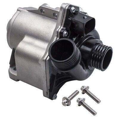

3) Water Pump Failure:
Symptoms:
Engine overheating, abnormal running temperatures
Water pump and fan running noise is very loud
Engine coolant draining abnormally fast
CEL Code 2E84
An issue that seems to extend to non-N54 engine BMW’s as well is water pump failure. Unfortunately, there isn’t a cheap and quick DIY fix you can do to the water pump as a failure would require a replacement.
Repair/Replacement:
The N54 water pump has been seen to last on average around 70,000km to 80,000km before needing a replacement. If you have high mileage or looking to buy a high mileage N54, the chances of the water pump being replaced already are quite high.

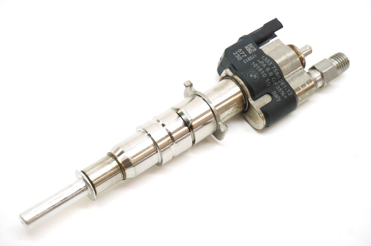

5) Fuel Injector Issues:
Symptoms:
Difficulty cold-starting.
Misfiring on start.
Excess oil on spark plugs
Rough engine idling.
Fuel injector issues are usually associated with the HFPF problems mentioned above. Since BMW uses direct-injection as opposed to port-injection, there is a higher chance of carbon buildup which clogs the injectors.
Repair/Replacement:
As a consequence of carbon buildup, this results in a bad-spray pattern which results in the ignition plug getting too much or too little spray which causes rough idling and misfires. Thankfully, a clogged fuel injector is a quick job, but replacements are not cheap at a cost of R3,600 per/injector.

On the waterpump problem which will happen.... its perhaps worth mentioning that the latest iteration of the pump is more reliable and that one should replace the thermostat with the pump.
You mention in the article that the fuelinjector replacement is relatively cheap...unfortunately they still very costly...approximately R3,600 for one

@Twinz I agree, that is not cheap. We will rectify it and the cost you stated - thanks.
