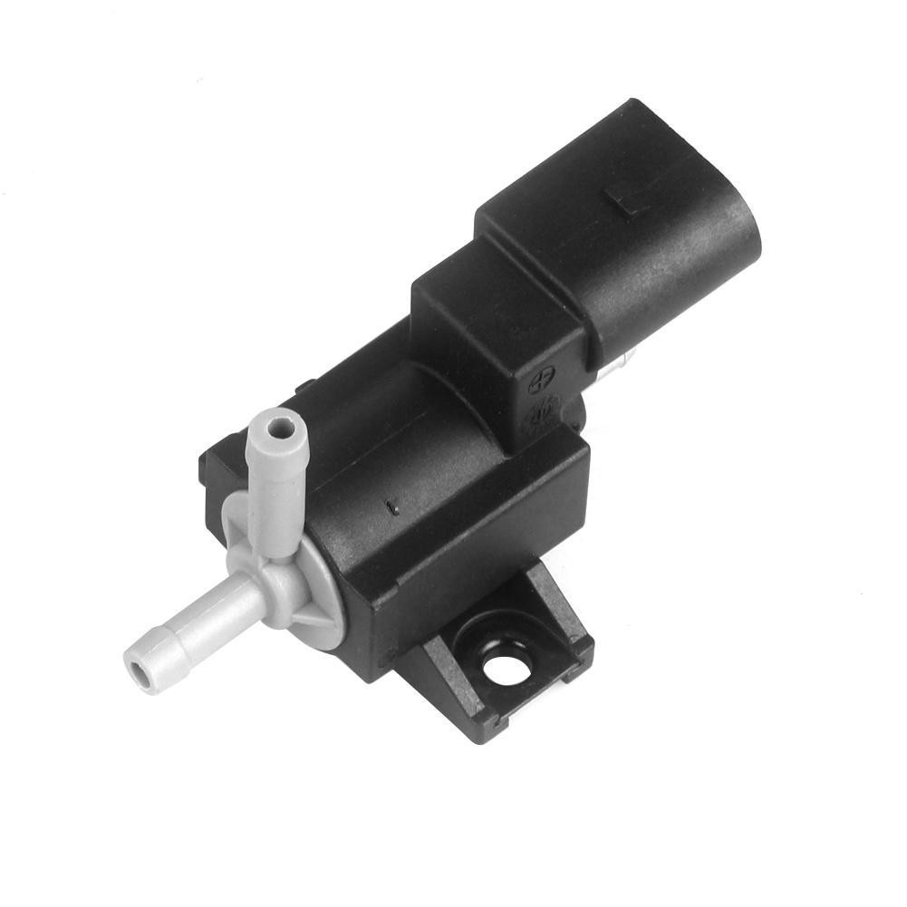

#2 Charge Pressure Change Over Valve:
If the reduced power isn't a symptom of an engine piston ring fault, it's very likely that its due to a valve within the boost system. Unfortunately, there isn't anything you can do as the driver to prevent this, but the upside is that the problem isn't catastrophic, nor is it expensive to repair. VW will be able to diagnose the problem quickly as the onboard system will have a direct error code indicating the problem, so you won't completely strip the assembly to diagnose the issue. The only thing you can do as a driver is to be aware of an obvious sign of diminishing power.
The reports on forums regarding the issue with charge pressure change over the valve with the VW Polo 6R GTI 1.4tsi DSG indicate that the actual valve itself gets "stuck" and mechanically jams rather than a wastegate problem.
Function: The boost valve allows the turbo to spool, in a linear fashion and then releases pressure quickly once you've hit the boost threshold. The wastegate controls the exhaust flow around the turbo, and the boost valve, to control boost levels. By opening the wastegate, increasing the flow of exhaust, the boost is decreased and vice-versa. The wastegate doesn't operate as "open" and "closed" but modulated by varying degrees to create a desired level of boost.
Symptoms of Charge Pressure Change Over Valve:
- Decreased power, especially under load.
Cost Of Repair? Depending on where you go, you're looking at around two hours of labour excluding the cost of parts.

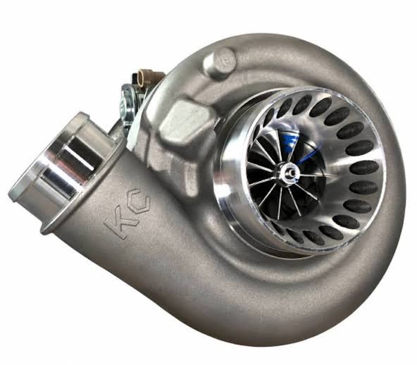

#4 Turbo Failure
Another problem reported with the VW Polo 6R GTI 1.4tsi DSG is a complete turbo failure due to the retaining nut on the compressor actually breaking off and lodging itself into the internal components creating immense damage. A loose impeller lock nut or turbo compressor wheel nut coming loose is usually as a result of worn bearings due to oil contamination, allowing the impeller wheel to rub and stall against the housing which loosens the locknut. But usually, it's attributed to foreign object damage to the compressor or turbine wheel, thus putting it out of balance.
Function: Turbochargers are usually manufactured with shafts that rotate clockwise, and shaft/impeller lock nuts that have a left-hand thread. Locknuts with left-hand threads have a self-tightening effect on the shaft, and that's how it's secured as opposed to right-hand threads. The two modes of turbo operation are acceleration and deceleration of the rotating assembly. When accelerating, there's a high degree of torque loading between the turbine (driving) and compressor wheel (driven). During acceleration, the torque loadings are much lower as the turbo slows down. Right-hand threaded lock nuts are fine, but they have the added risk of being improperly tightened upon installation.
Symptoms Of Failure:
- Loss of power.
- Slower, but louder acceleration (as your engine attempts to bridge the gap in power loss)]Slower, but louder acceleration (as your engine attempts to bridge the gap in power loss)
- Difficulty maintaining higher speeds.
- Error Code P0299 (Check Engine Light)
- Grey/Blueish smoke]Grey/Blueish smoke
Cost Of Replacement? You have a few options when it comes to replacement, and that will ultimately affect the cost. You can go with the costlier OEM part or the direct installation, plug-in-and-play non-OEM. The labour required is quite intensive, usually taking up to 6-hours.

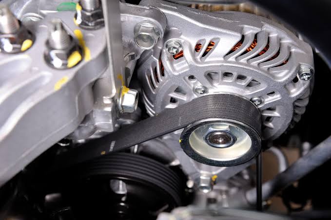

- Grinding or squealing noise from the belts or tensioner.
- Unusual belt wear.
- Belt-driven accessories fail (alternator, water pump, AC compressor)

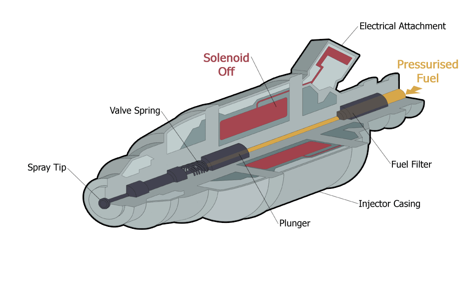

#7 Fuel Injector Failures
The fuel injectors on the VW Polo 6R GTI 1.4tsi DSG commonly fail due to leaks or electronic failure. Thankfully, VW will be able to pick up fairly quickly if the fault is due to an electronic however, you’ll still need to replace the fuel injectors. The trick is to be aware of the symptoms and resolve the problem as quickly as possible. A proper fuel injector cleaning can restore your injectors at a fraction of the cost of replacing them new. A leaking fuel injector is a fire hazard and has the potential to cause severe engine damage if left unchecked. Unfortunately, the fuel injectors remain a common problem with the VW Polo 6R GTI 1.4tsi DSG, but preventative maintenance will help avoid costly replacements in the future.
Function: A direct petrol fuel injector acts like an electrically operated gate that delivers fuel into the combustion chamber. The Engine Control Unit (ECU) manages when the fuel injector should inject its fuel into the engine cylinder, but a leaking fuel injector will require replacement. It's recommended that cleaning the fuel injectors should be done every 20,000km to 30,000km. Usually, fuel injectors fail as a result of clogging or general wear and tear over time.
Symptoms Of Fuel Injector Failure:
- Rough idle or engine stalls
- Engine misfiring
- Noticeable fuel odour and leak
- Decreased fuel economy
Cost Of Replacement? Again, the cost will be dependent on where you go, but as far as components go fuel injectors are relatively cheap.

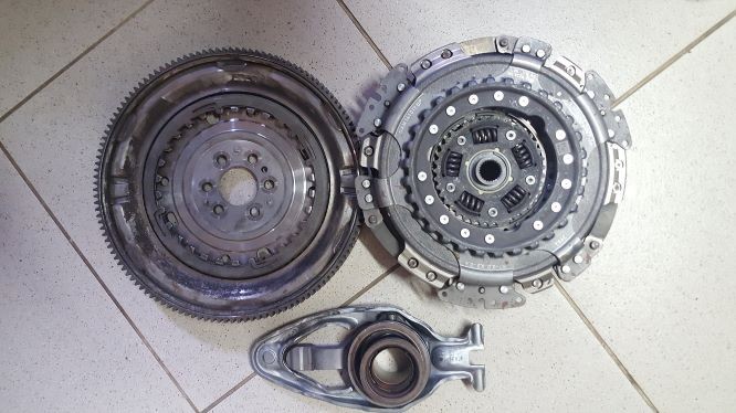

#8 DSG Clutch Failure
Probably the most disappointing problem that's commonly reported is the premature wear of the Polo GTI's DSG clutch system. The Polo utilizes the 7-speed DSG gearbox, and it also utilizes a dry-clutch system.
From what we've seen in the forums, VW seems confident that the problem rests solely with the control module that isn't adapting or compensating for the "slip" as you push your car. This usually results in the car going into a failsafe mode or "limp" mode, which will limit the transmission to a single gear only. Bear in mind, clutches are not immune to general wear and tear, and VW recommends replacing the DSG clutch at 100,000km. But it's the premature failure one should look out for, and to spot the problem as early as possible. Before buying your used VW Polo 6R GTI 1.4tsi DSG, always to a VIN number check and reference the service book to see if the DSG clutch has been replaced and adopt preventive maintenance from there.
Function: VW's DSG dual-clutch gearbox combines the best of both worlds, the ease of a conventional automatic transmission (CVT) and the power of a manual transmission. It consists of two independent gearbox units, through the dual-clutch, both gearboxes are connected alternately and positively to the engine via two drive shafts depending on the odd/even gear. The dual clutch's hydraulic actuators allow gear changes to be executed without any reduction in traction.
Symptoms Of DSG Clutch Failure:
- Squeaky sound when pulling away coming from the transmission tunnel.
- Shuddering or notchy changes through gears (especially 1st and 2nd gear).
Cost Of Replacement? Incredibly expensive and labour intensive, expect costs rising up to R20,000.

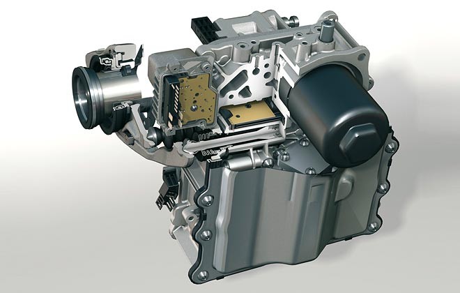

#9 DSG Mechatronic Unit Failure
Last but not least, the final commonly reported problem with VW Polo 6R GTI 1.4tsi DSG is issues relating to the mechatronic unit within the DSG assembly. Unfortunately for you as the driver, there isn't anything you can do to prevent a mechatronic unit failure but only to keep a lookout for the symptoms while you drive the car or before you buy the car. Failure can occur due to a faulty oil pump or just an electronic failure within the unit. If you're testing a used VW Polo 6R GTI 1.4tsi DSG, drive it in multiple conditions (traffic, open road, low speed, high speed) and go through all the gears.
Function: The mechatronics module in the DSG assembly is the computerized control part of the dual-clutch system. Which means its complex and hard to troubleshoot if things go wrong.
Symptoms Of DSG Mechatronic Module Failure:
- Gearbox Failure Warning Error.
- Gears "popping" out.
- Jerky or notchy gear changes.
Cost Of Replacement? Incredibly expensive to replace due to its complexity and labour intensity. Costs can reach up to R15,000.
