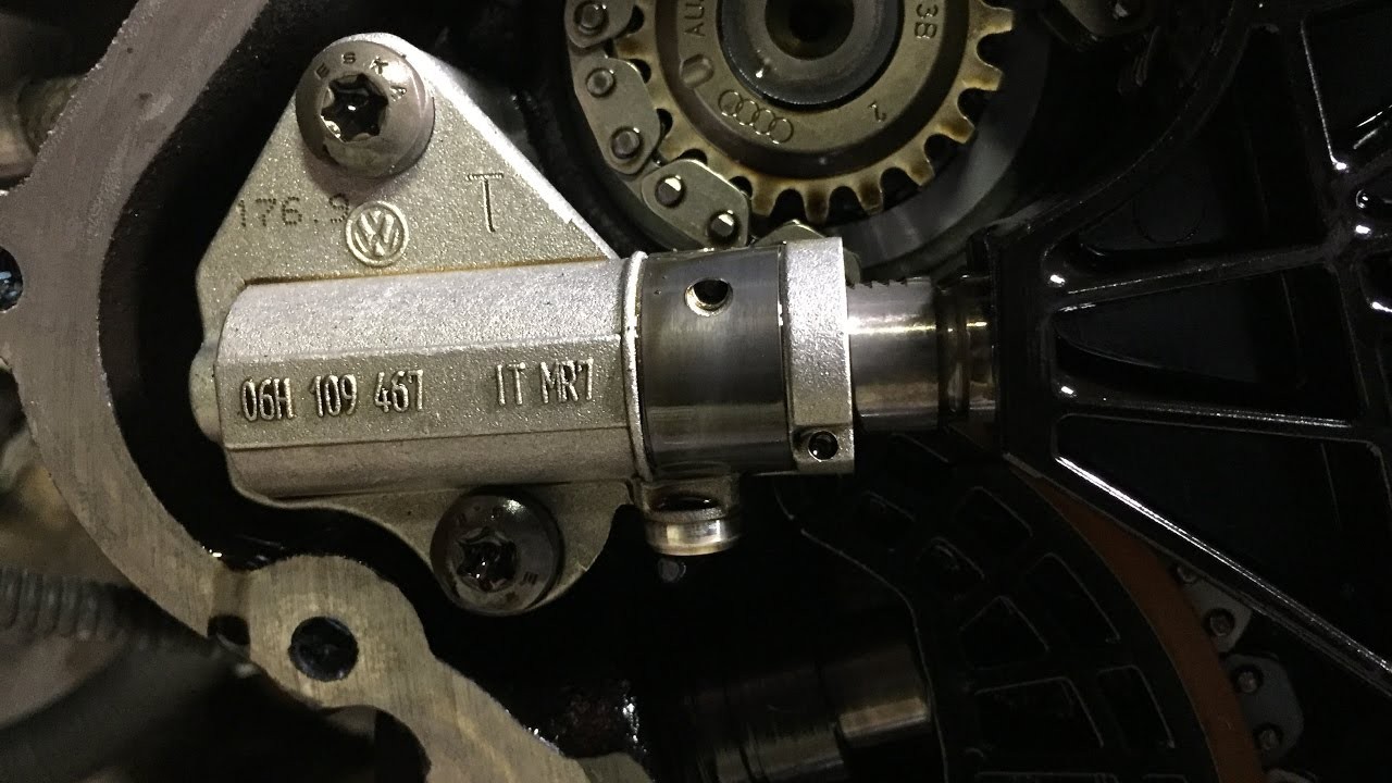

#1 Timing chain tensioner failure
Function:
The timing chain synchronizes the rotation of the camshaft(s) and crankshaft inside the engine, with the timing chain tensioner responsible for adding the correct amount tension to the chain and along with the guides prevents chains from vibrating.
The timing chain tensioner plays a critical role - if it’s too lose the chain rotates too fast and can skip a tooth on the chain - thus damaging the engine severely (bent valves, damaged camshaft, damaged cylinder head), too tight and it whines, placing excess strain and wear on the timing chain causing it to stretch.
Symptoms of failure:
  • Very rowdy engine idle.
  • Engine rattle when idling.
  • Car struggling to start or doesn’t start at all.
  • “Check engine” light on instrument cluster with error codes P0016 (Crank/ Cam position sensor correlation) or P0328 (Knock Sensor 1 Circuit High Input).
  • When timing jump occurs, the valves can hit the pistons very hard and crushed the conrod big end bearings and lead to the replacement of the entire engine.
Bear in mind that these are not specific symptoms of the timing chain tensioner failing. Unfortunately, the timing chain tensioner on the Mk6 GTI can fail without warning! Even owners with the revised tensioner have experiences failures. A high rate of failures has been experienced with the 2009 and 2010 models, these were the first released Mk6 GTI’s, so you get yourself a later model if possible.
Low mileage Golf 6 GTI’s are not immune to this problem and are also affected by the timing chain tensioner failure, we’ve seen failures on vehicles with only 60 000km driven. So don’t think because you’re buying a low mileage car that it excludes you from this common problem with the Golf 6 GTI.
Preventative maintenance is essential here! Failure of the timing tensioner is a big-ticket expensive. As a new prospective Golf Mk6 GTI owner, if there’s any uncertainty on whether the tensioner has was replaced, get it replaced yourself after taking ownership, use the latest timing chain tensioner revision (get more details from your local VW dealership regarding the revised parts available). The old tensioner used a ratchet type construction, and the newly revised tensioners use the standard type construction.
The peace of mind to in replacing the tensioner is worth it, overall the Mk6 GTI is an excellent car, but this is it’s Hercules heel.
Maintaining the correct oil level in your car is also very important and can also contribute to the failure of the timing chain tensioner. GTI’s are known for drinking oil at a higher rate than usual (500ml top-up every 1,000km), so always keep your eye on the levels and top-up if you’re running low on oil.
How much does it cost to fixing the timing chain tensioner?
R10 000 - R25 000 (includes the cost to replace the timing chain - recommended, but not needed).

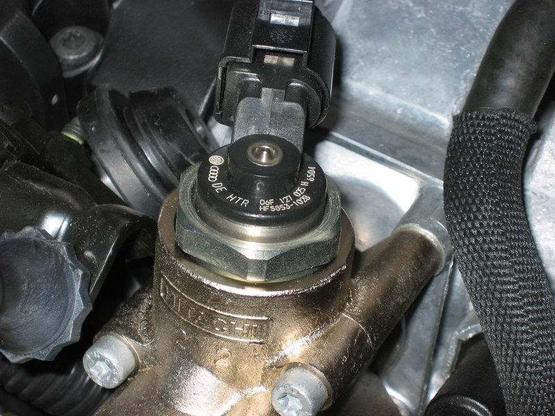

#5 High-Pressure Fuel Pump (HPFP)
Function:
The HPFP, is a camshaft-driven pump that pressurizes fuel from the tank and then sprays the fuel directly into the combustion chamber.
The fuel supply to the engine cuts out, especially under wide open throttle (WOT). The car may also go into a hard-limp mode with no boost if the failure of the HPFP is extreme. Causes of failure can also be the piston inside the pump seizing, as this pump works hard and pressurizes fuel up to 130bar!
Repair cost:
+- R5,000 (part only)

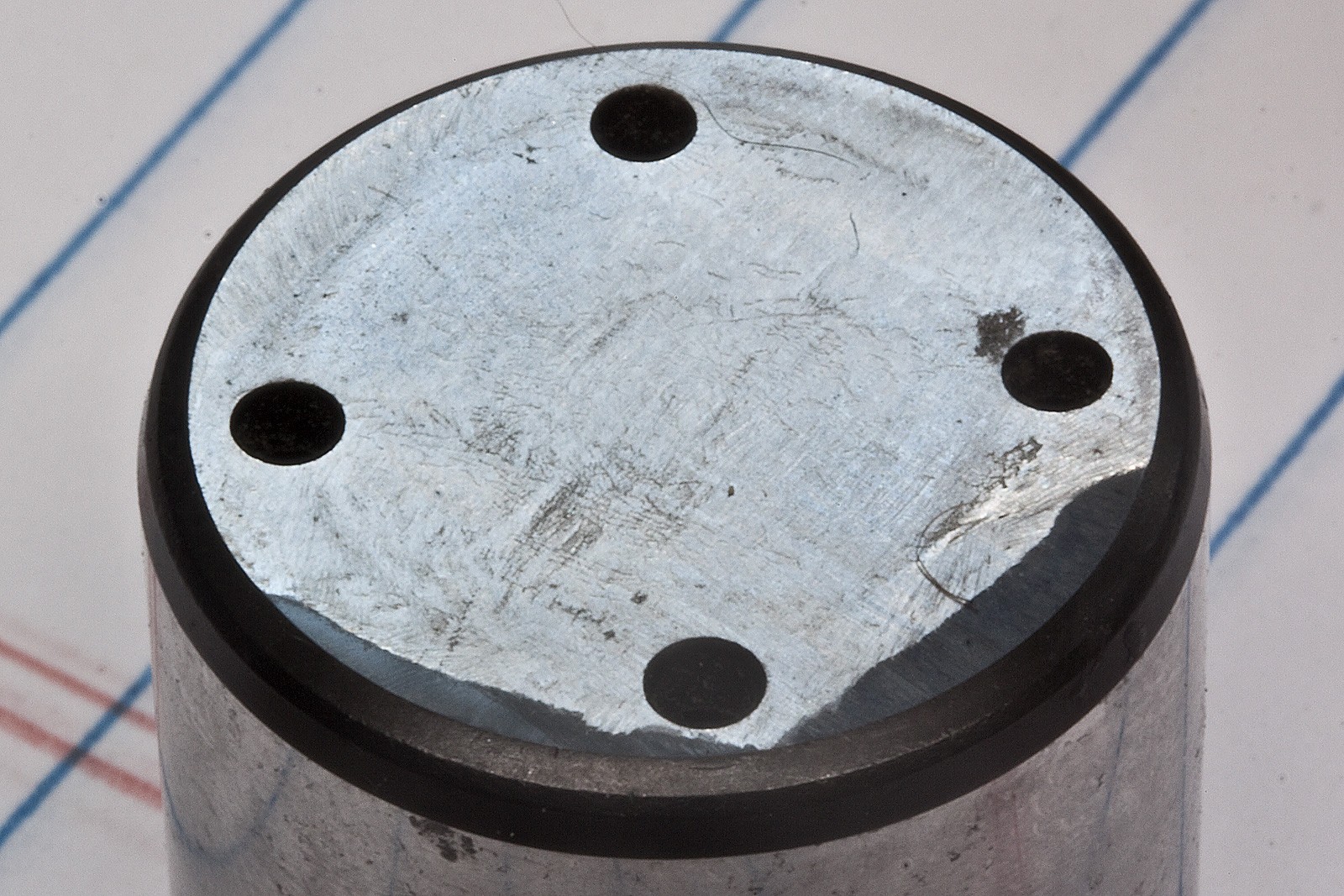

#9 Camshaft Follower - Premature wear
Function:
A cam follower is a specialized type of roller or needle bearing, designed to follow cam lobe profiles while the camshaft rotates inside the engine. The 2.0T FSI engines use a flat faced follower.
The camshaft follower wears prematurely and can cause your car to sound like a diesel. Sometimes you might have no symptoms, and everything operates as usual. The follower is a wear and tear part and should be inspected at least every 10,000km or every oil change.
Also, if excessive wear is noticed, the follower should be replaced immediately to avoid future expenses. If the follower wears completely, it can also damage the camshaft lobes and High-Pressure Fuel Pump (HPFP), leading to not only the replacement of the follower but also the camshafts and the HPFP. Significant ticket expenses are the kind you want to avoid, so keep your eye on these buggers. Total wear of the follower can also cause the car to go into limp mode, due to low fuel pressure.

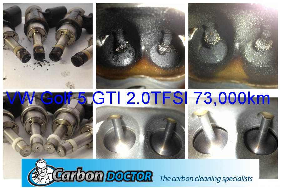

#10 - Carbon buildup - Injectors and other valves
The engine design of the 2.0T FSI uses direct injection to get the fuel inside the combustion chamber. Meaning there are no injectors on the intake manifold. The Mk6’s injectors can become clogged to the point of becoming dysfunctional and, much like a cambelt service where, on any car, the cambelt gets flicked around 100,000km, the Golf Mk6’s injectors and valves need specific, periodic cleaning or even eventual replacing. Meticulous servicing helps delay the inevitable accumulation and remains your best bet to minimize all known mechanical issues on a Golf Mk6.
Symptoms of clogging:
Poor performance from the car and carbon build-up blocking the oil pickup can also be signs. If the “low oil pressure” light goes on, then the oil pickup is a good place to start diagnosing the issue. You can remove the sump and clean it, and also clean the oil pickup and see if this dismisses the “low oil pressure” light.
Poor oil can also cause engine sludge and block the pickup, so always ensure you’re using the recommended 5w40 oil and have enough oil in the engine.
