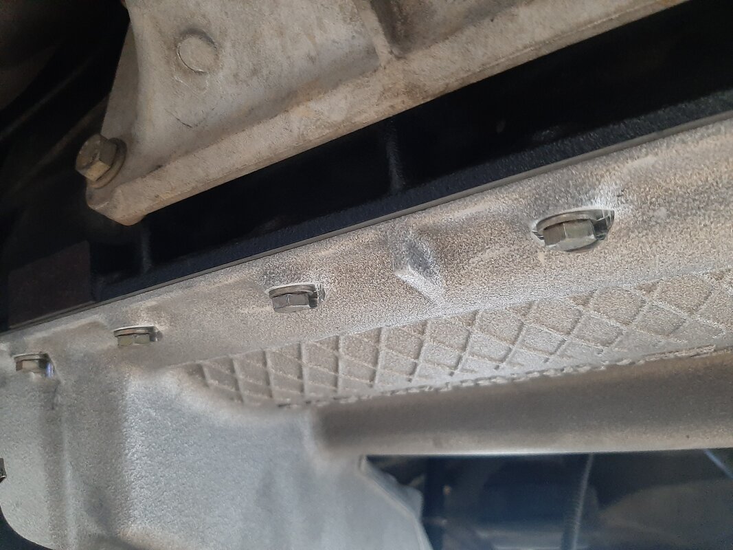

Belly pan cracked which I shall get repaired.

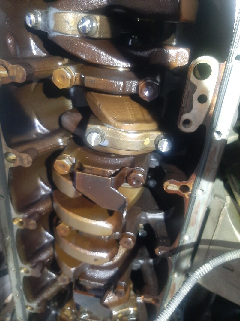

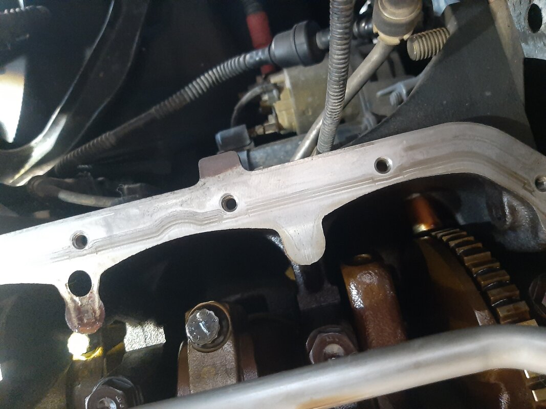

Peter@AEW

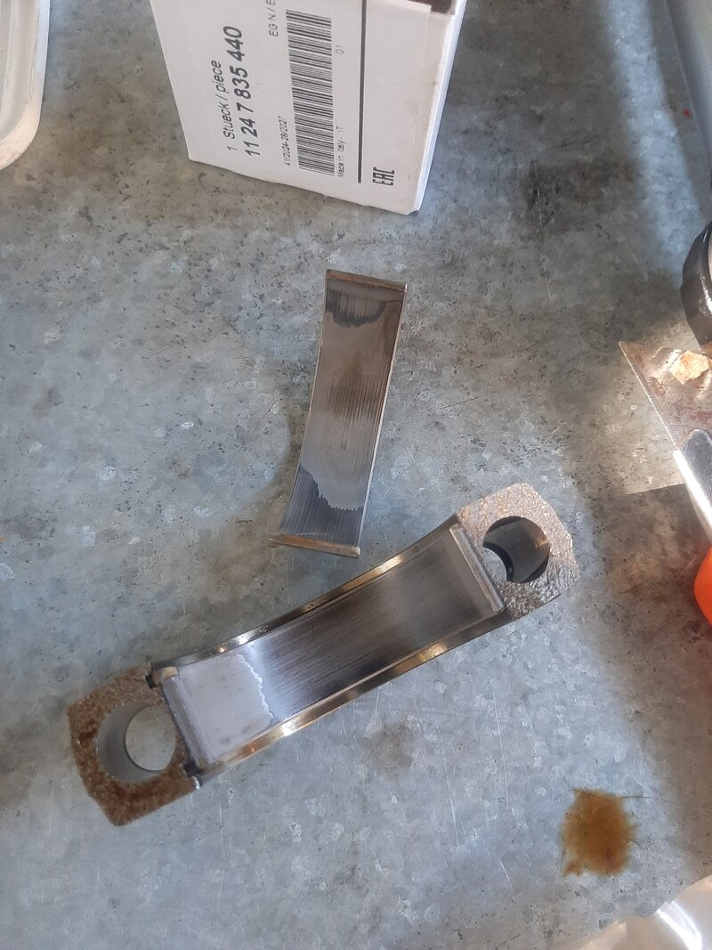

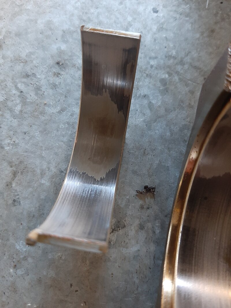

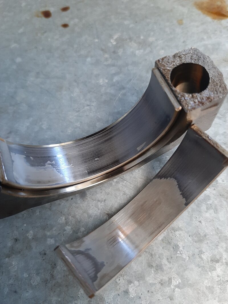

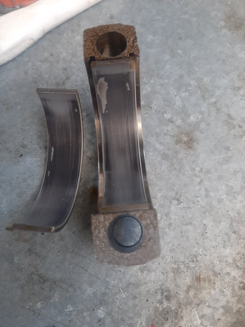

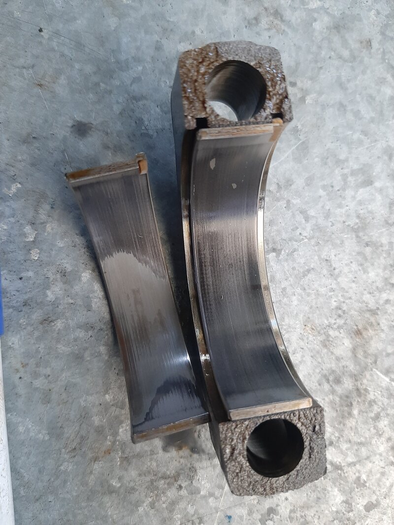

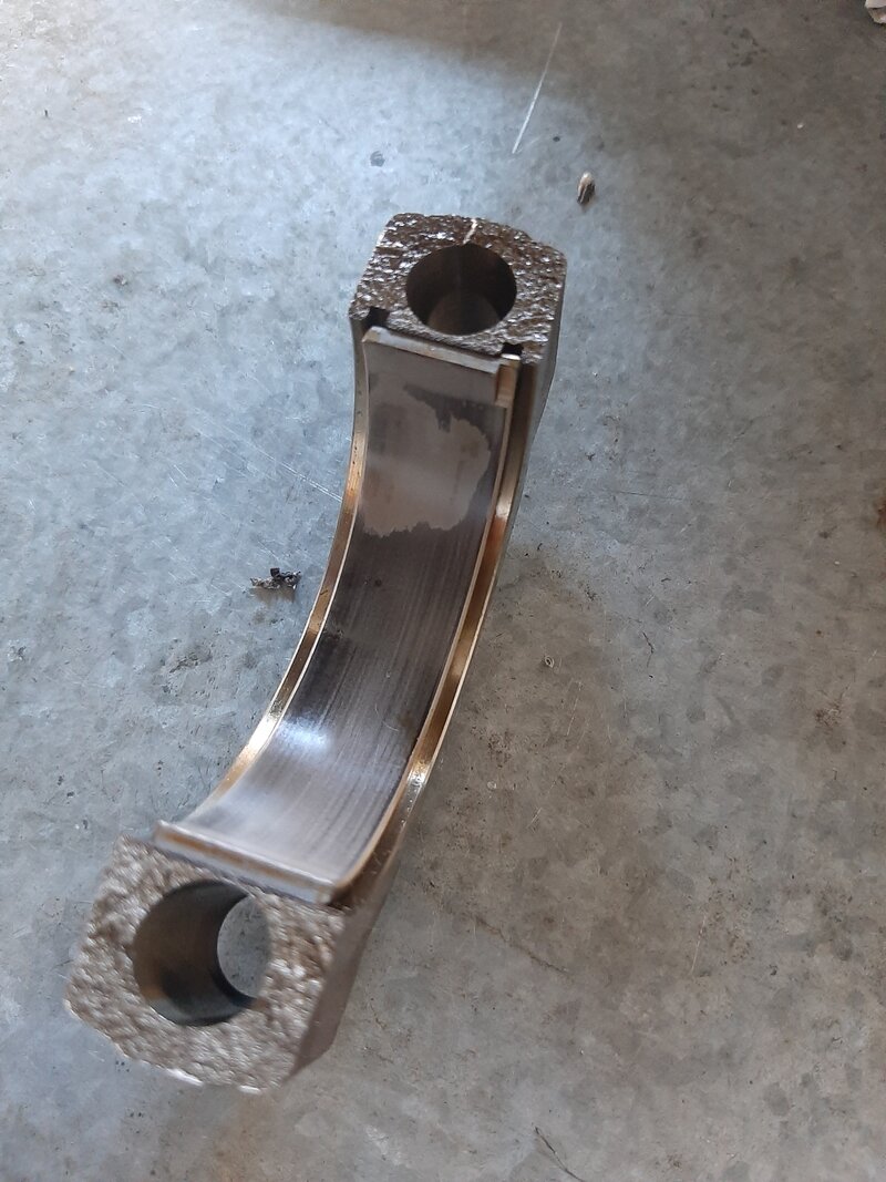

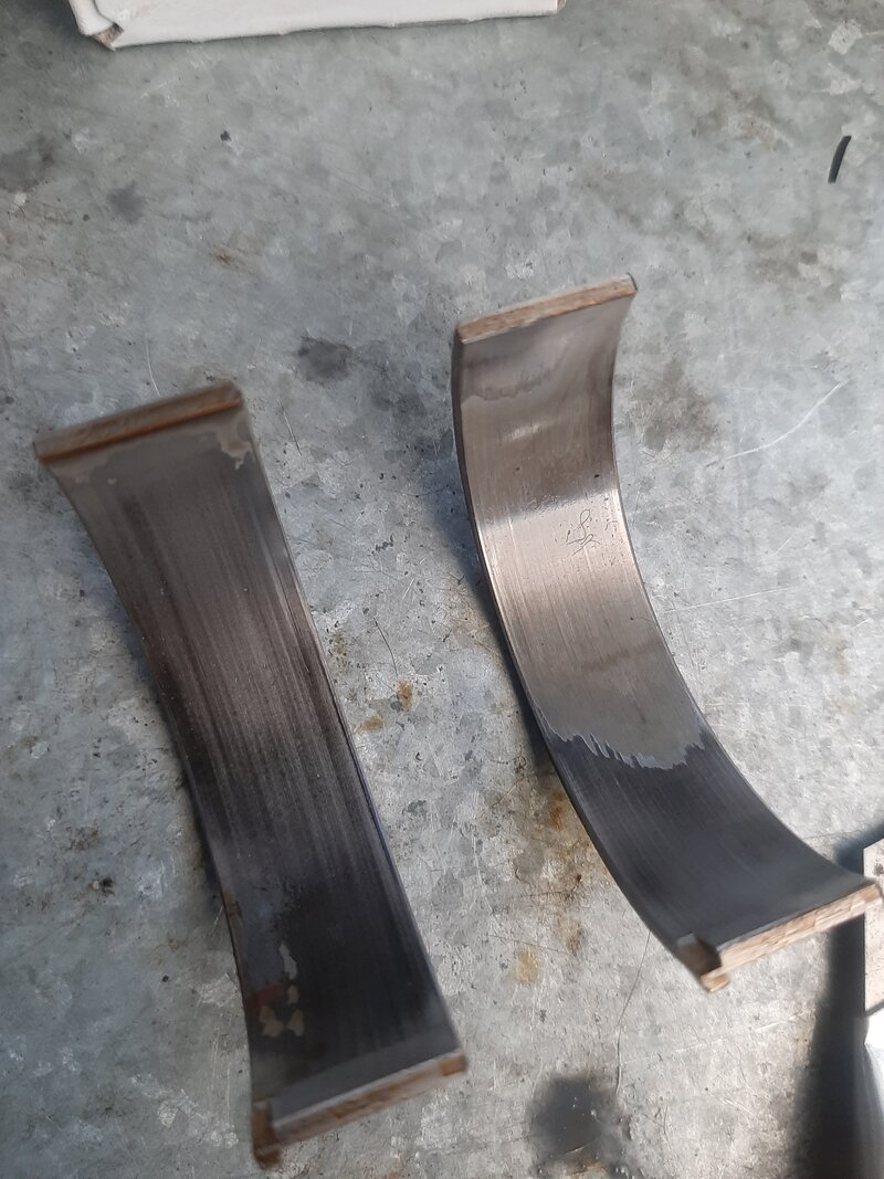

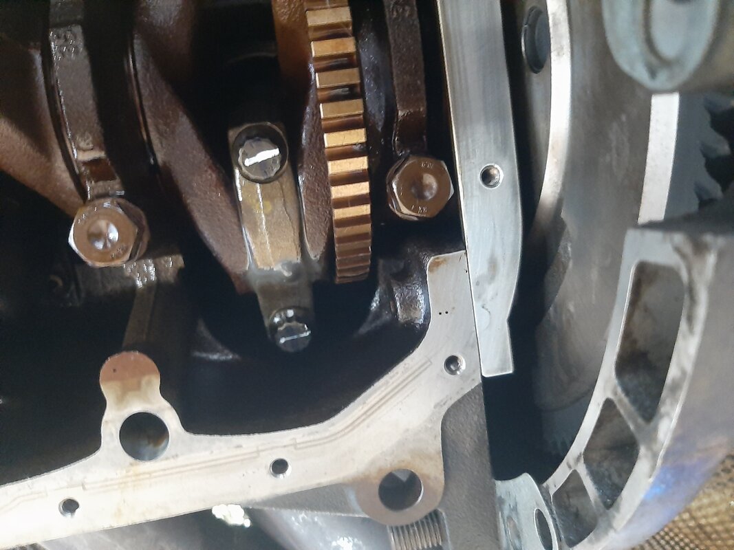

New bearing installed.
As this is an early car the same conrod bolts are used as per BMW TIS.
Important that bolts are relocated from where they were removed.
In addition unlike the new 10mm bolts on face lift cars these are tightened only once.
5Nm 30Nm and then 70 degrees.
The 70 degrees is equivalent to 125Nm whereas the face lifts only reach 90Nm after the third tightening sequence20260615_132645.jpg20260615_140926.jpg
