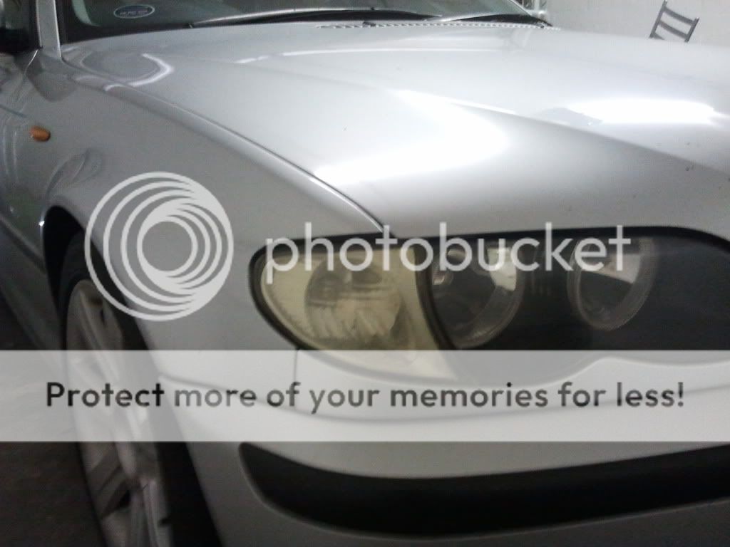

The installation was very simple. I just had to remove 4 bolts on each headlight, and they slid right out. The new headlights fit in perfectly, and all plugs went in without issue.

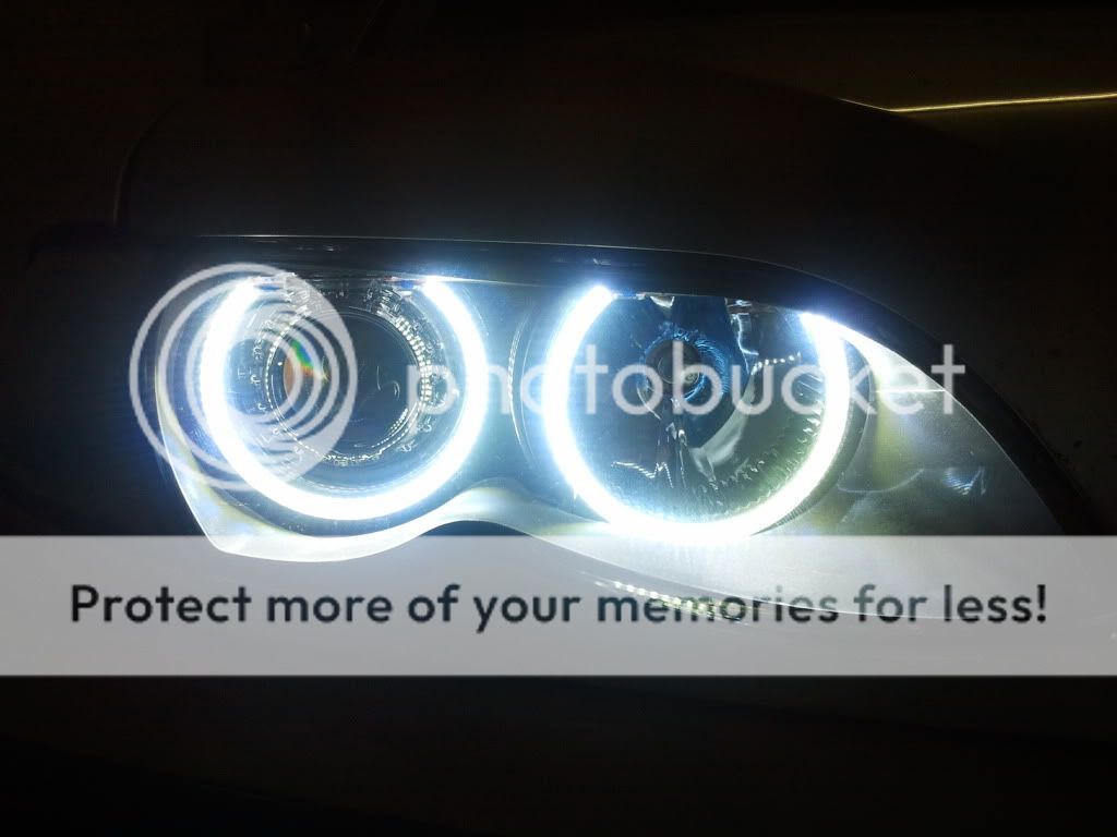

The light output is amazing compared to the halogens. The cutoff is so sharp, that it almost looks pitch black above the cutoff, however the angel eyes are very bright, so that lights up road signs quite nicely.

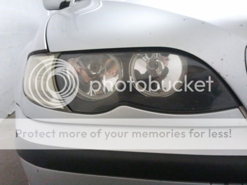

Before front:

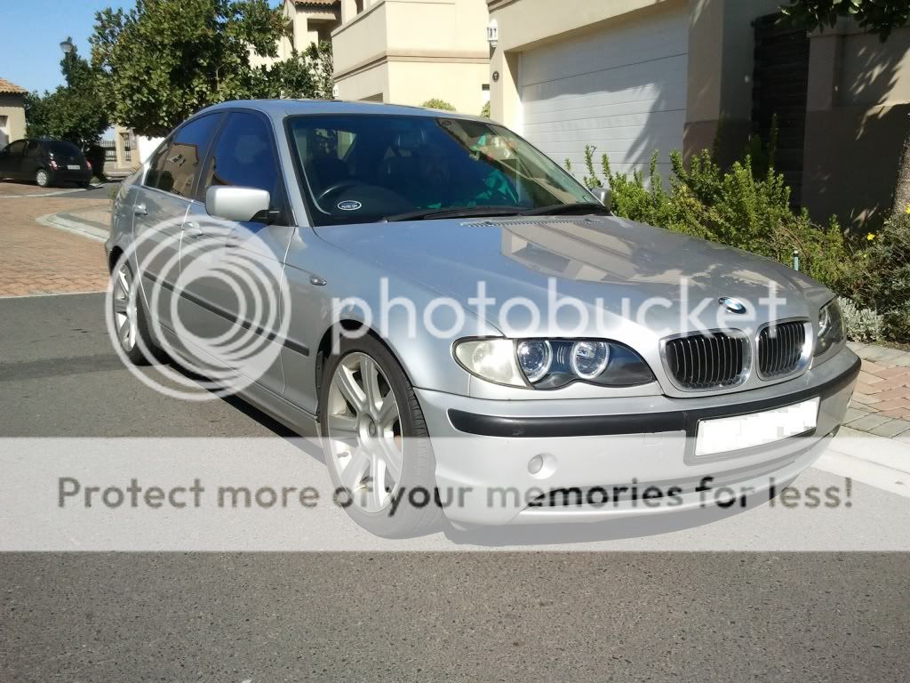

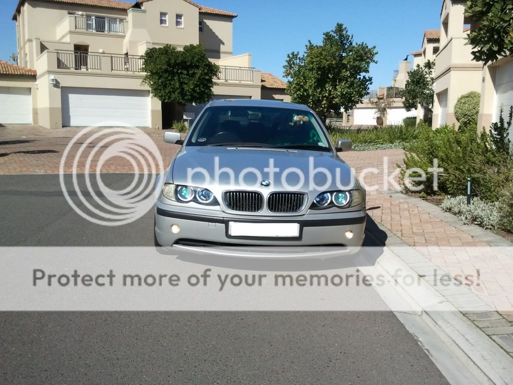

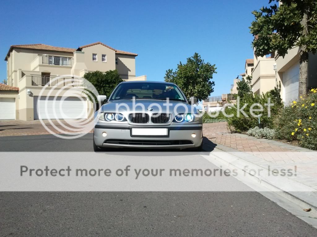

After front: - note the yellowy corner lights, which I'll get rid of soon.

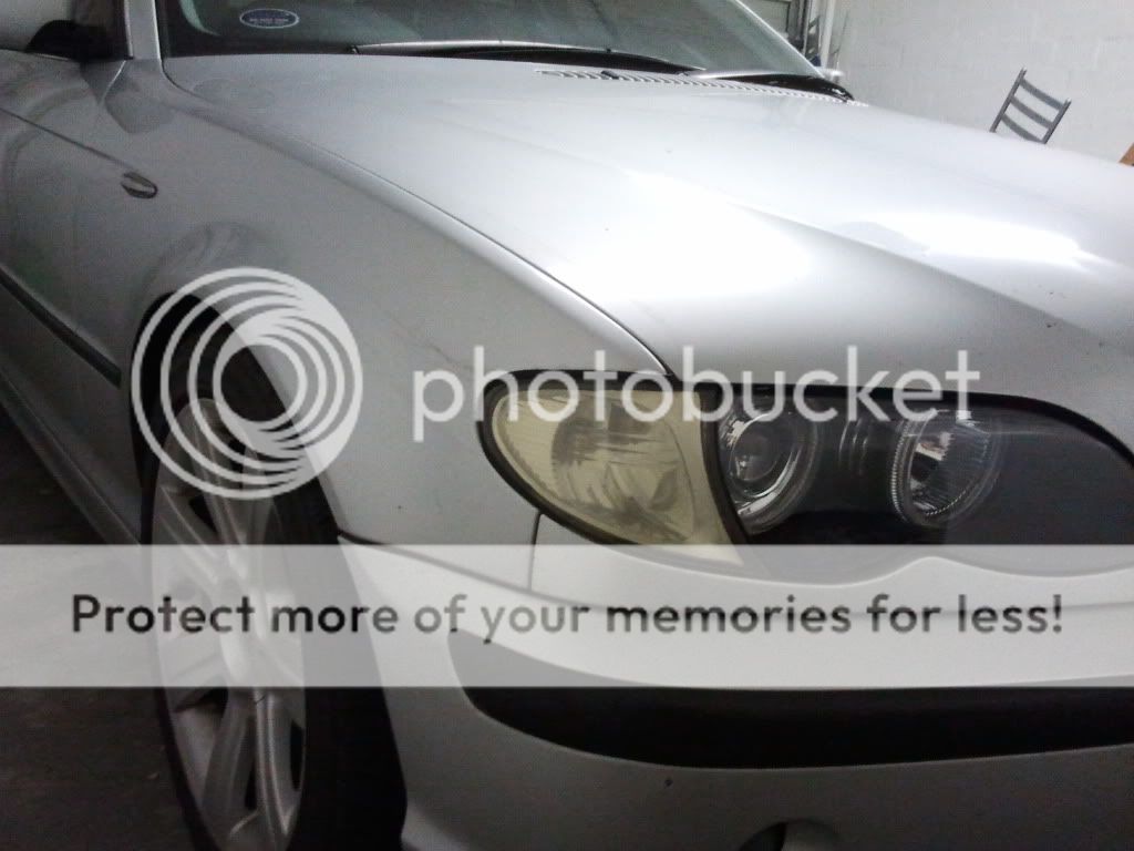

Before side:
After side:
Angel eyes before

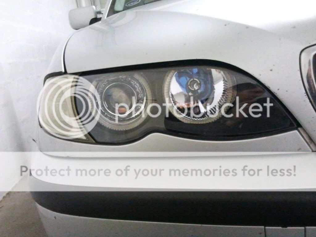

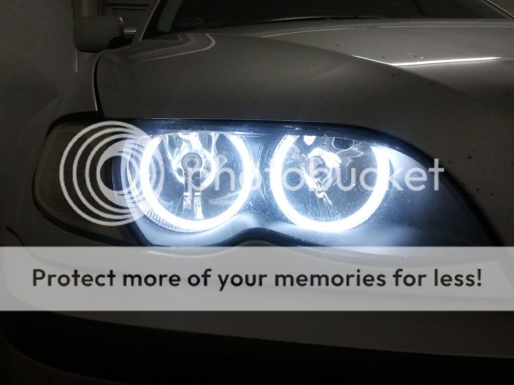

Angel eyes after:
Angel eyes before:
Angel eyes after:

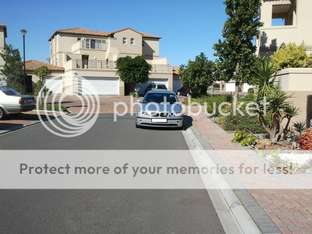

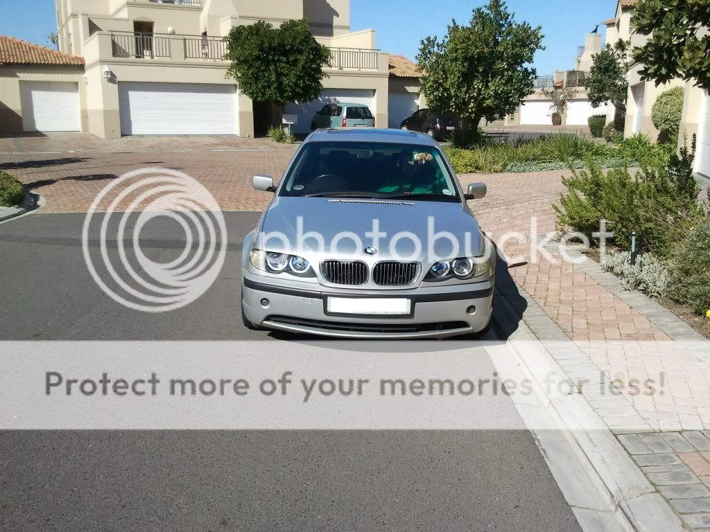

Some outside pics:
Note that when the xenon's turn on, it takes about a minute for them to "heat up". When they're fully heated, then they're pure white.
And a "flicker" shot. Notice the blue, and yellow flicker. You also get some purple flicker depending where you stand.

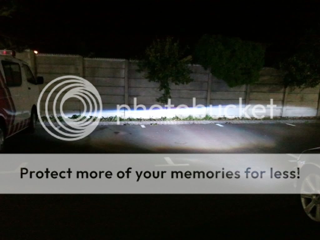

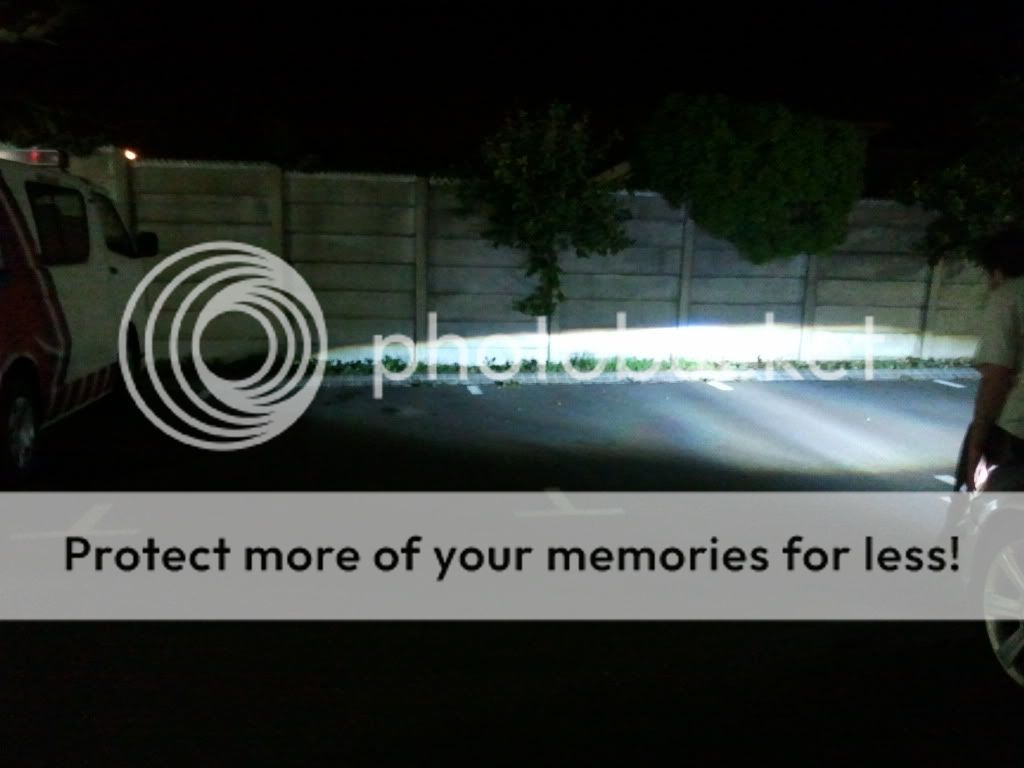

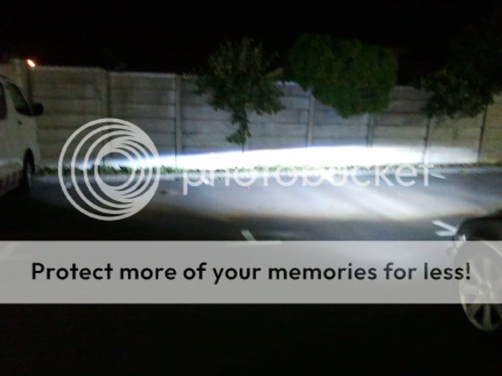

And here's the cutoff:
Right only:
Left only:
I'm not 100% happy with the cutoff. When I ordered the FX-R's, I was thinking I was gonna get this:

I will agree that the cutoff from these FX-R's are MUCH better than most other retrofit projectors, but still, I expected otherwise.

The angel eyes are damn bright; as bright as the Audi LED's, so I'm using them as DRL's.

Looks awesome. Just spray those projector bowls black. Makes the front look much better especially with angel eyes.

That cutoff looks a lot better than the OEM e46 projectors or any other BMW projectors I have seen so far.

are those night wall shots before you adjusted the height? is there something wrong with the cutoff, I cant see it against the wall???

I hooked up the angel eyes to more internal light AND my parking lights with the use of a relay that came with the lights. So the angels come on when I unlock my car.

That is the cutoff against the wall. My camera isn't so high quality (phone).
Note that these aren't the awesome FX-R's, with the insane cutoff. I wrongly assumed this myself when buying this.
