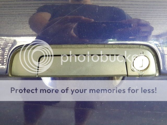

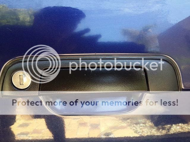

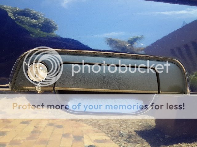

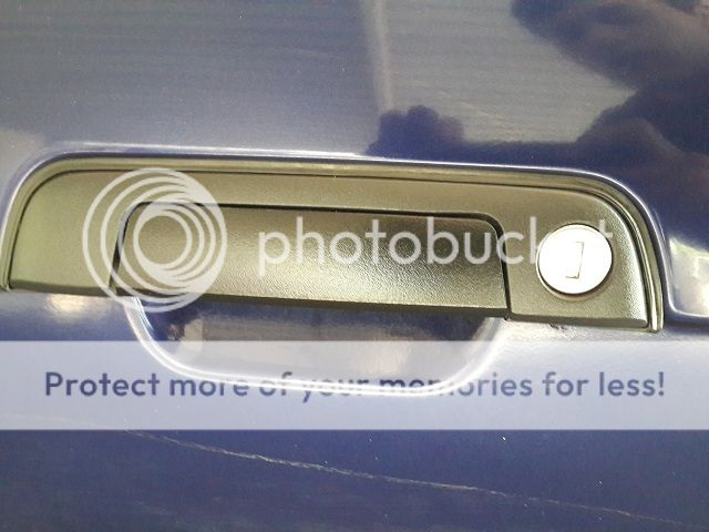

Replaced my worn out and cracked outer door handle trim today.
What a mission for the first time.
The Old:
The New:

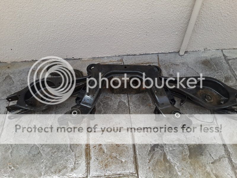

So to minimize downtime, since my car is a daily, I bought an extra rear subframe. Complete with spring and camber arms. Camber arms I will most likely replace as I think you cannot replace the bushing without damaging the arm.
The subframe will get treated to sway bar reinforcement and powerflex bushings, with a strip and respray to protect from future rust.

Instead of refitting those flimsy stock camber arms you should look at the turner motorsport adjustable ones. Also while you at it, fit a LSD as it will completely transform how she drives.:thumbs:

I was looking at the turner arms but they are a bit out of my budget. I will either get OEM style arms or something like the SPC/Eibach ones: link

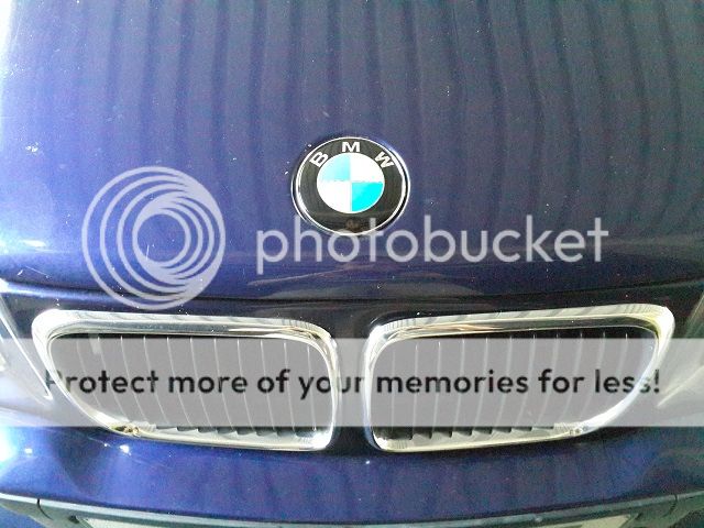

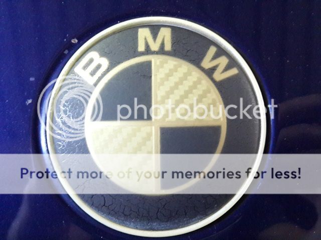

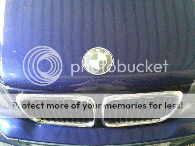

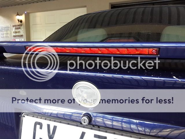

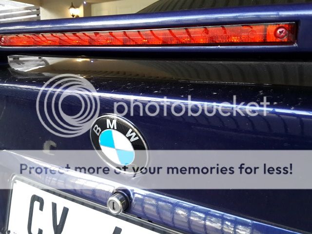

So today I did one of the most important restorations to my car... Her BMW Emblems.
This is what happens to those replica carbon fiber badges after 2.3 years:
Either the adhesive comes off and you loose them.
Or they look like this.
The After. The lighting made the color very light. They are the proper BMW colors in person.

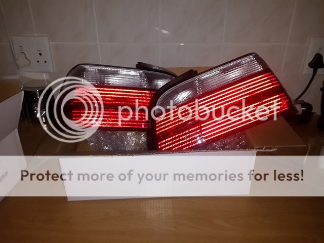

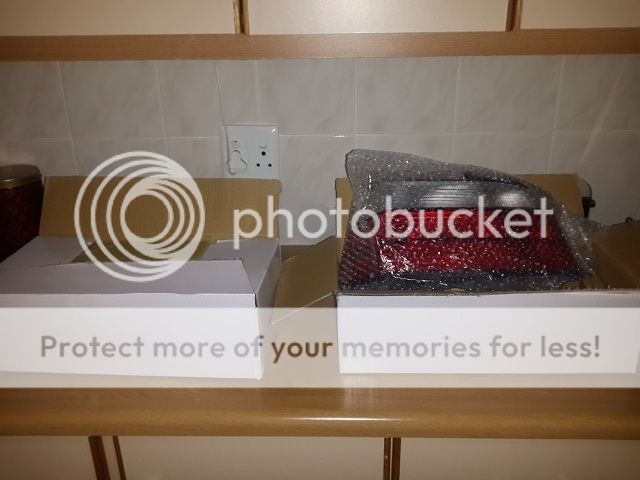

After discovering a cup of water in one of my tail lights and spending hours trying to get it out, only to discover that the now dry light is all murky and horrible, I decided to buy a new set of tails.
I bought them from amazon, the are eagle eyes. Cost was around R1500.
I dont have any pics of them fitted but they fit well and look extremely close to OE.

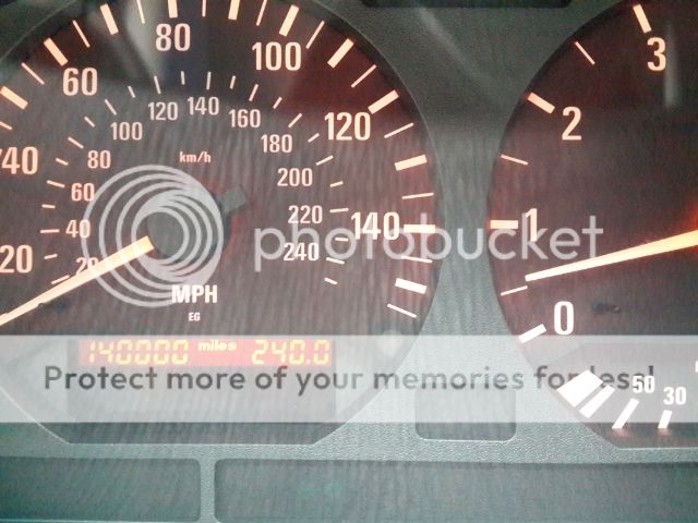

So after a milestone on my M5 2 weeks ago, the 328i hits a milestone.
That is about 225308 km

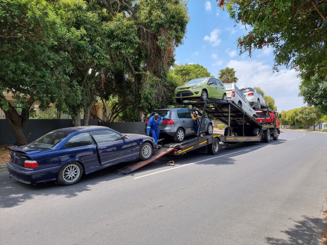

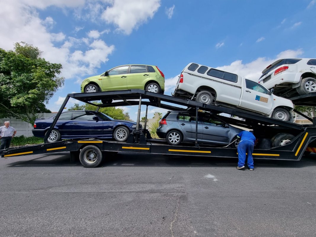

For those that remember this car and the sale thread from the end of last year:- https://www.bmwfanatics.co.za/threads/1997-e36-328i-msport-coupe-project-car-non-runner.98754/
I purchased the car from Gareth and brought the car back to Jhb in November last year. Progress has been slow with time constraints, but I thought I would use this thread to continue the car's journey from the uk to Jhb, then to Cape Town, and now back to Jhb.
When the car arrived, it was non-runner and had been standing for a number of years. The body was rust free, paint was fair, but it will need full respray once the mechanical work is done. Interior is neat but will also require some work.
The block was cracked, but the head was all good. I decided to replace the motor with a complete running M52B28, from an E39 528i. The motors are identical. I just had to change over the engine mounting brackets, branches, a/c pump, power steering pump and the reservoir mounting point from the old motor. I put in a new battery, all the fluids, fuel pump and fuel filter. The car now runs and drives but needs some final mechanical touches before I am happy. We are also investigating a manual swop and whether to do it now or later down the road.
