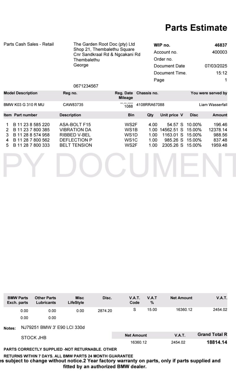

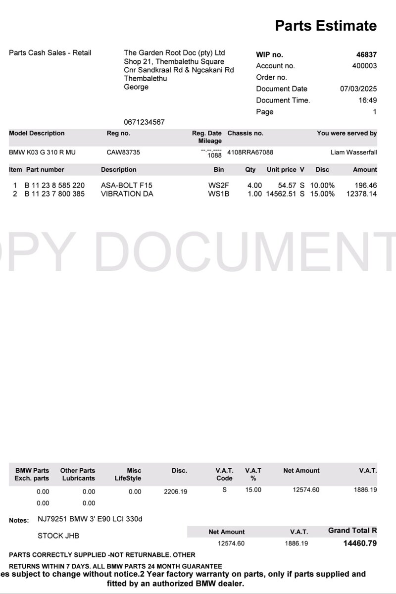

FYI....from my local BMW dealership.

EBZ911
Just a quick update on prices for parts.
Now need to get the qoute for labour.
Thanks to everyone that responded 👍 🙏
