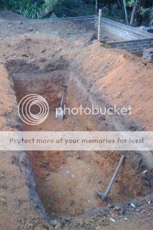

Adi said:thought about placing it under second car, but had a massive boulder in teh way....as it is took two guys hard digging for 3 days to make the 4m x 1.3m hole
McSteel will remember them and phone once I am at that level....

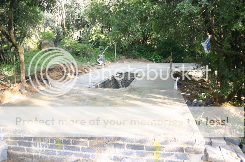

I just updated my garage build thread, in it you can see a few pics of the pit. I measured the length of a car to be 4.4m so that is at 1.9m depth, length of steps is 1.6m, finished size of opening 6m x 0.9m.Adi said:will post pics tomorrow.....so far been digging for three days including today, soil is hard, the size is 4m x 1.3m opening, once it has double brick on either side, opening will be between 90-95cm. Foundations are 35cm above ground at the lowest point, and we dug down 1.8m, so its 2.15m deep now, however concrete will eat around 25cm.....and me 1.94m tall so have around 1.9m to garage floor so can confortably reach stuff
