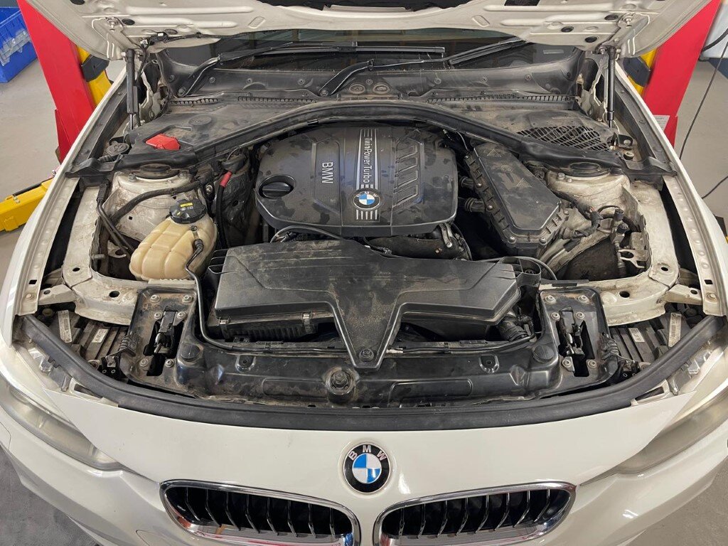

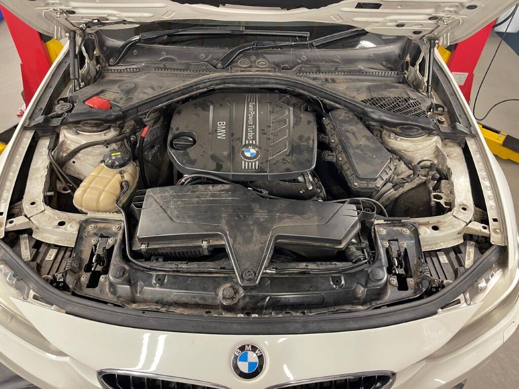

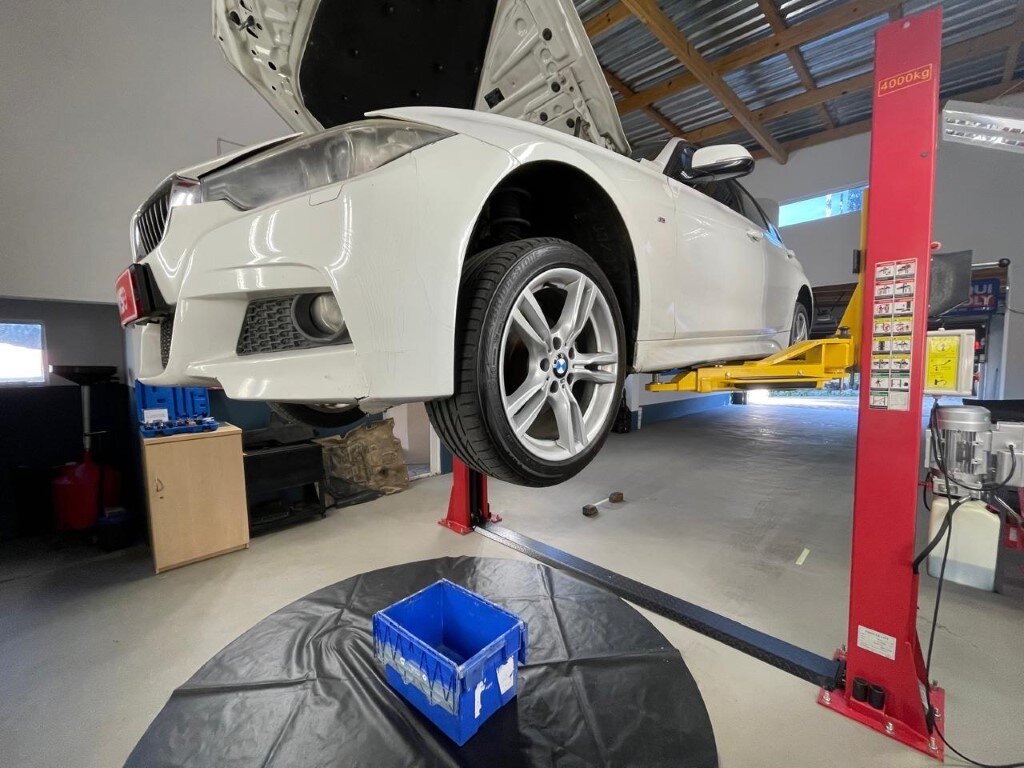

Recently we were contacted by a new customer — a referral from one of our other clients — who needed help diagnosing a mysterious coolant leak on his F30 320d. He couldn’t trace the leak himself, so we advised him to bring the car in for a full inspection.
🧊 Initial Assessment & Shock Discovery

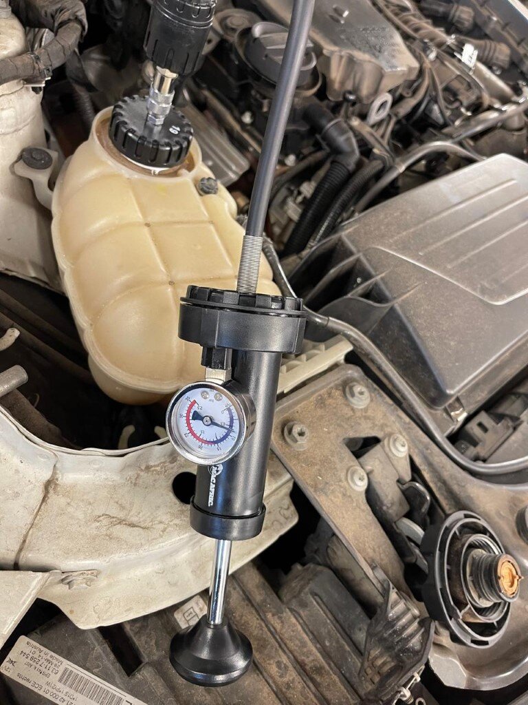

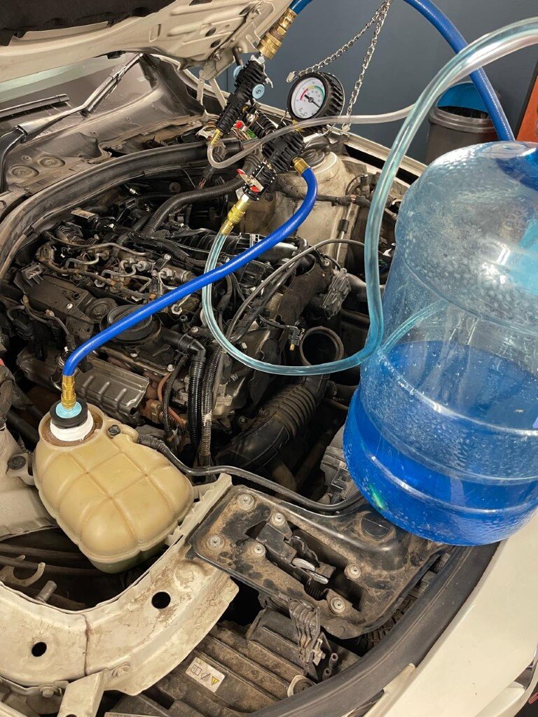

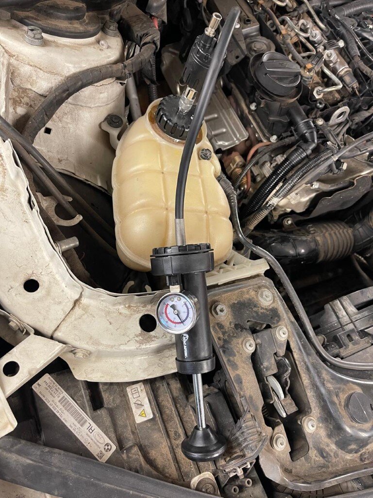

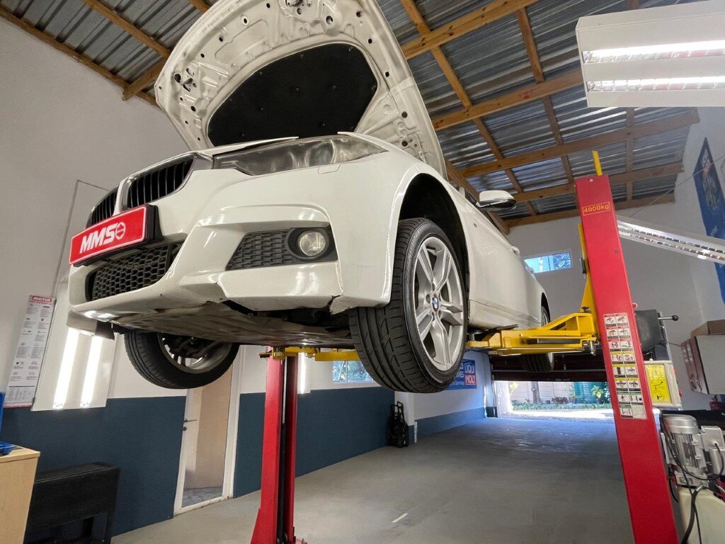

As soon as the vehicle had cooled, we got it up on the lift, pulled off the undertrays, and pressure tested the cooling system. There was zero coolant in the system, just water.
When I called the customer to find out more, he casually mentioned that he’s been running tap water for two years.
😳 and topping up regularly.
Needless to say, this set off some alarms.

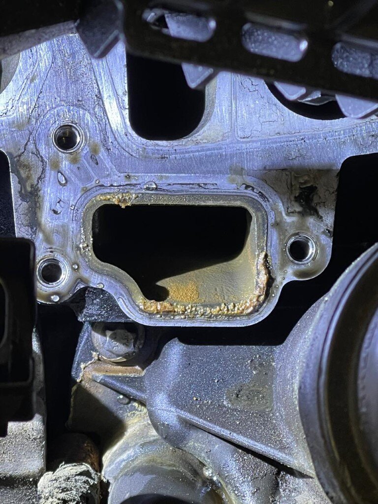

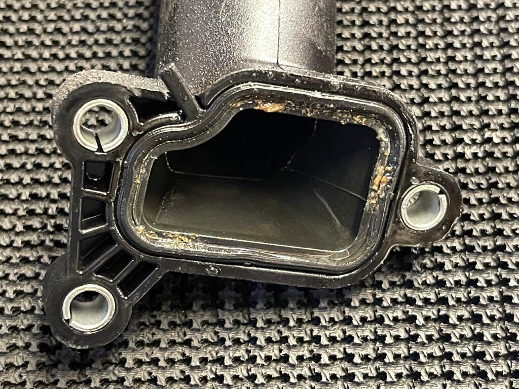

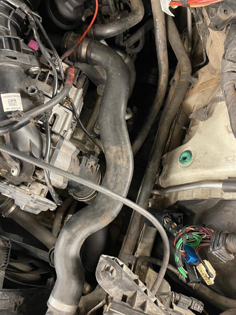

Under pressure test, the leak immediately revealed itself on the left-hand side of the engine. Based on past experience, we suspected either:
  • The coolant flange pipe, or
  • The oil filter housing assembly, or worst case — both.

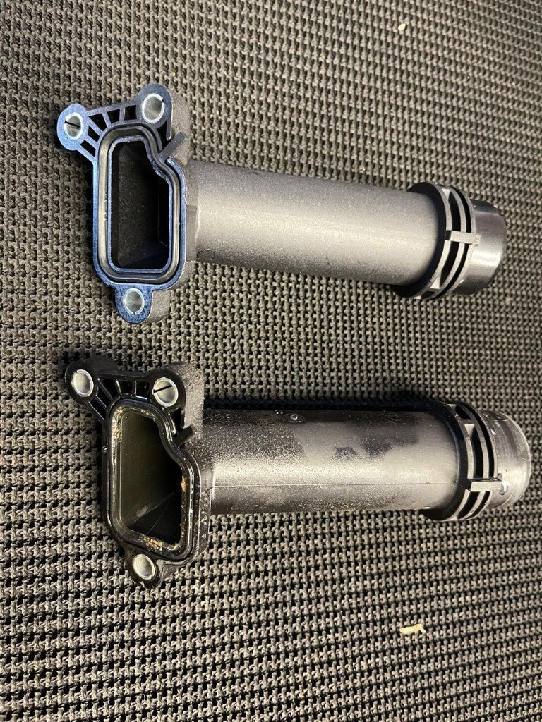

We agreed to start with the coolant flange pipe, since it’s the more affordable part to tackle first.
🔧 Tear-Down & The Real Culprit Revealed

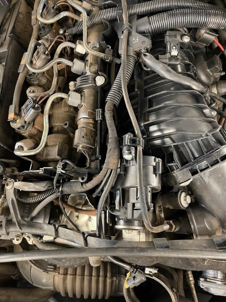

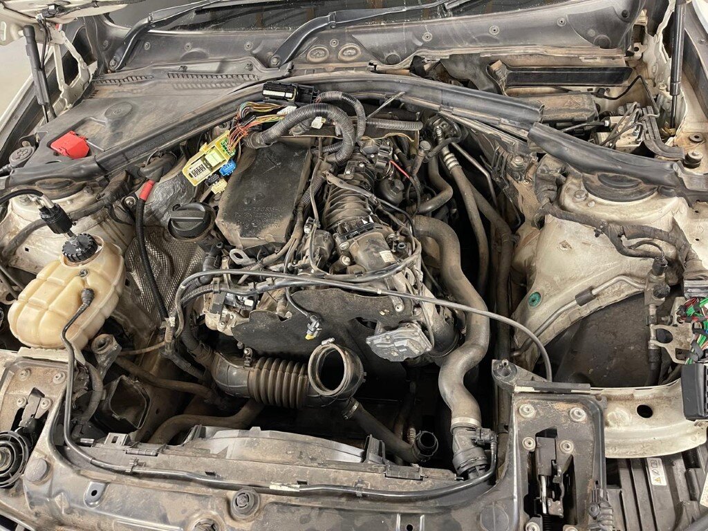

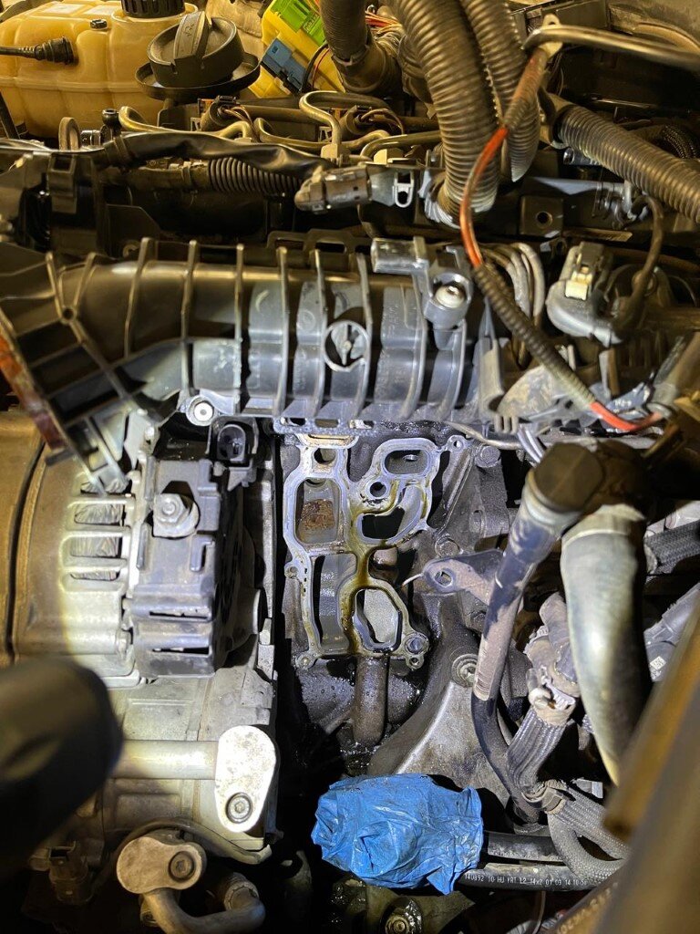

The next morning, we ordered the coolant flange, coolant, and distilled water. Once we began the strip-down and removed the flange pipe, we weren’t satisfied with what we saw.

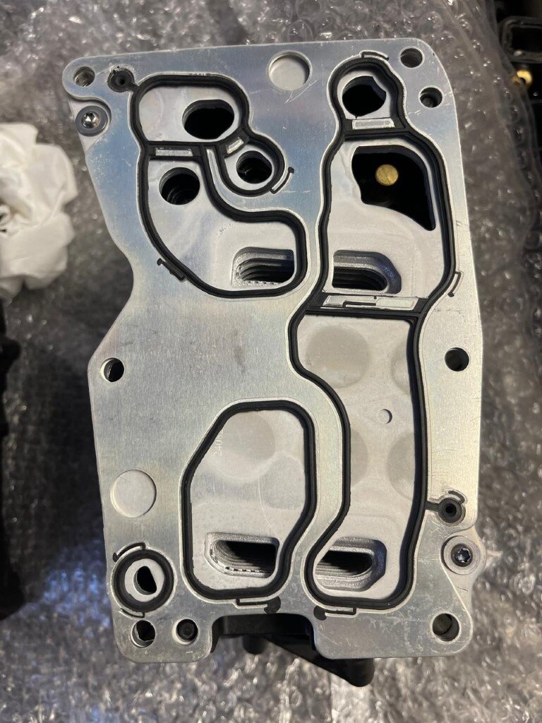

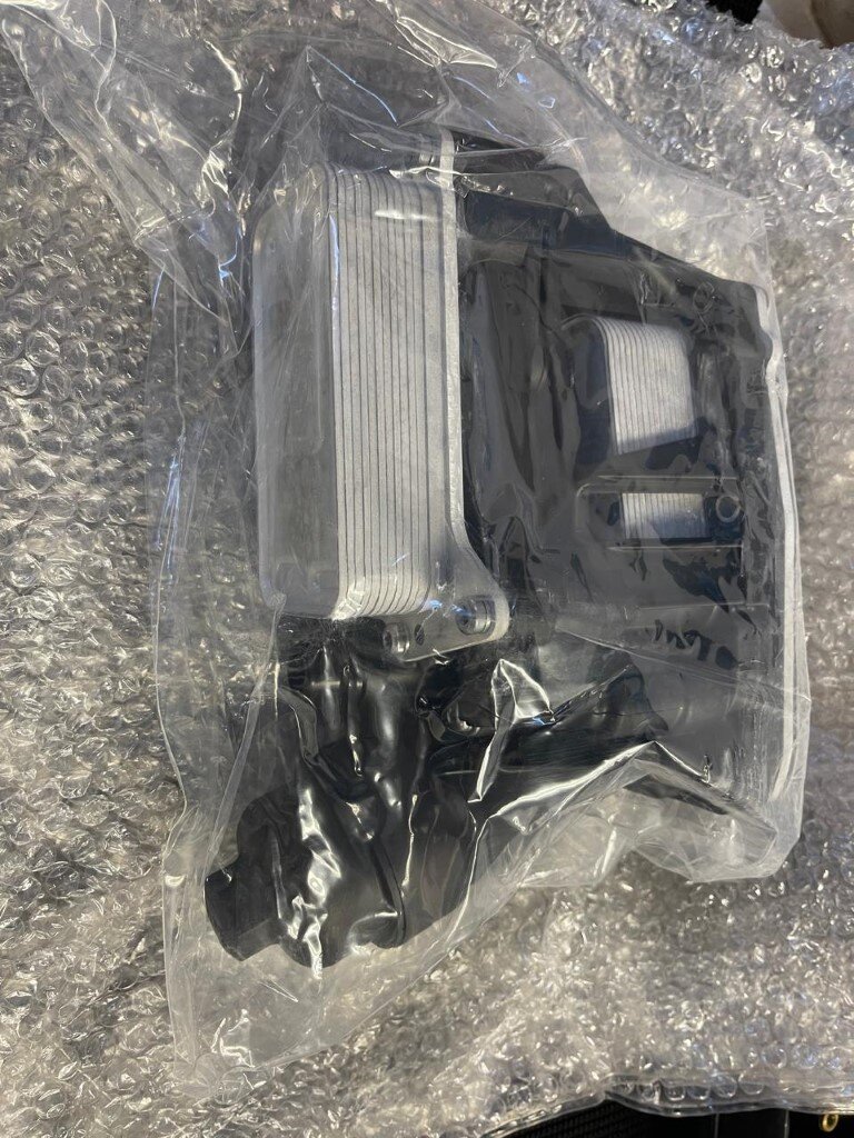

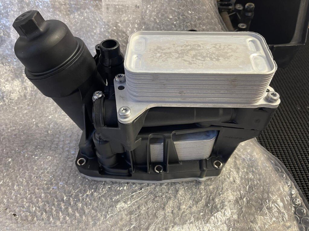

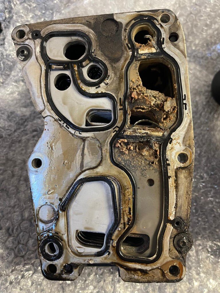

We took a closer look at the oil filter housing assembly (which includes the engine heat exchanger, transmission heat exchanger, and thermostat) — and it didn’t look good.
After getting the customer’s go-ahead, we:

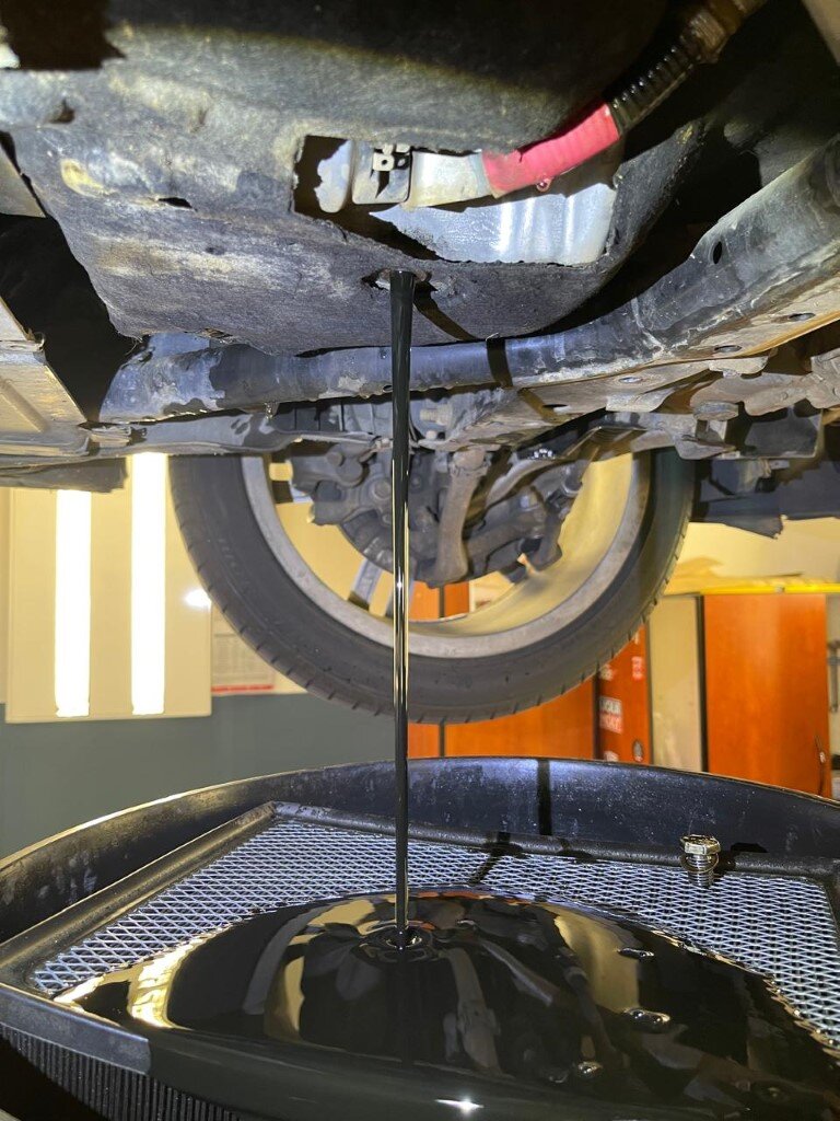

  • Drained the engine oil
  • Removed the entire oil filter housing assembly

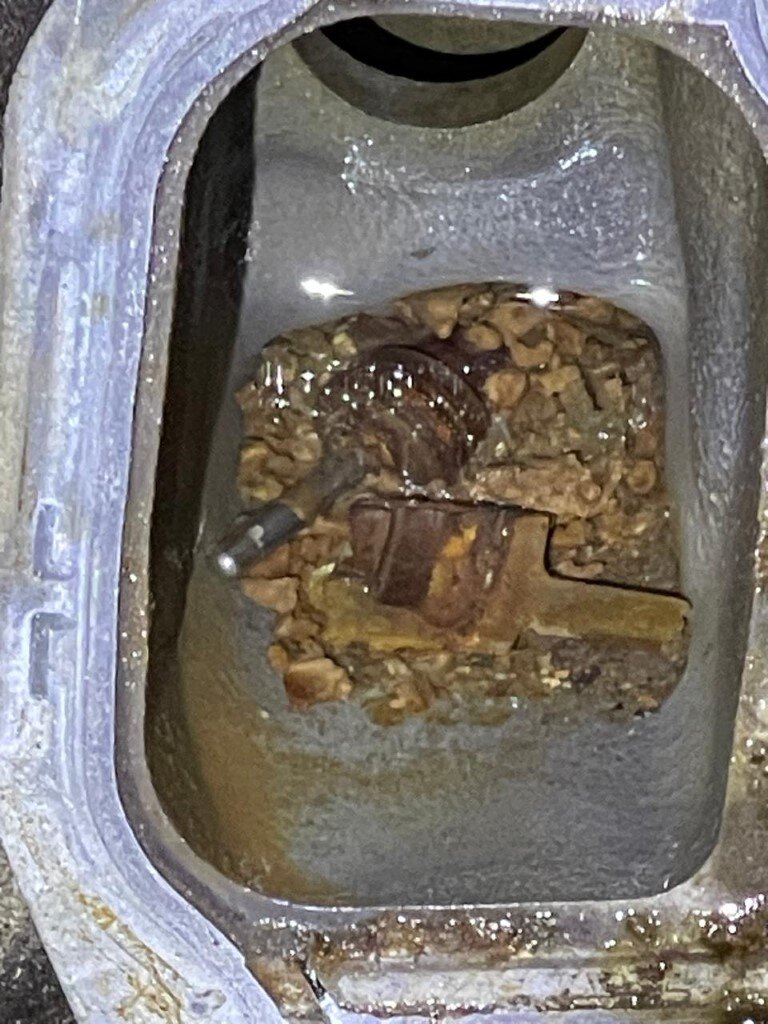

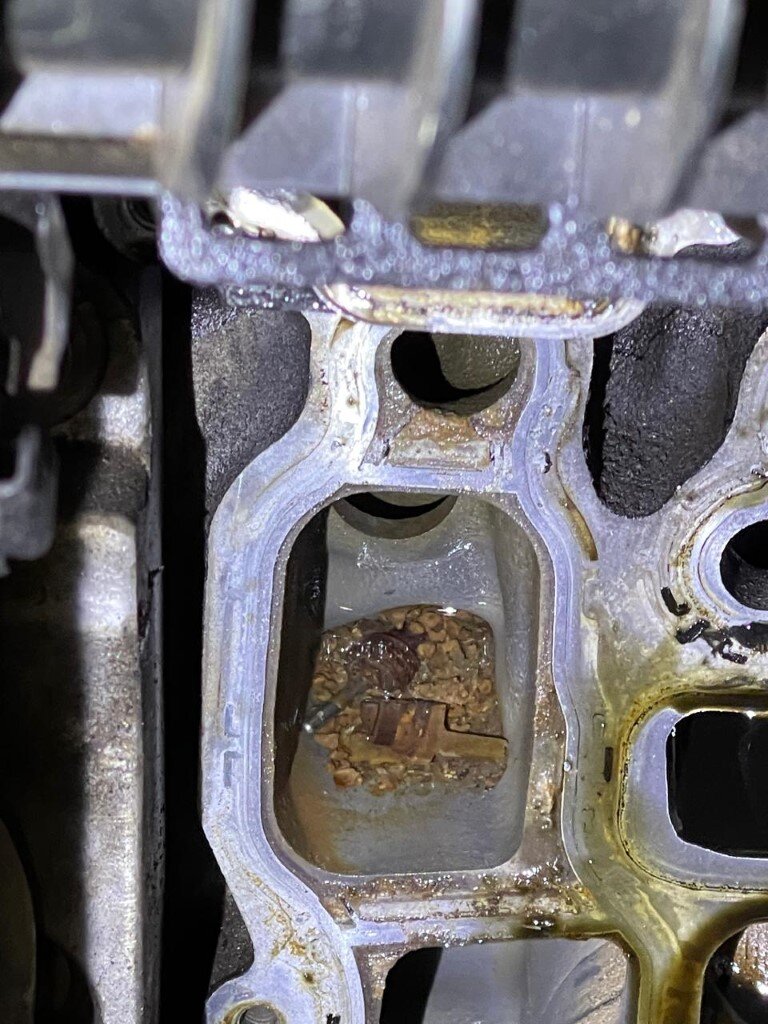

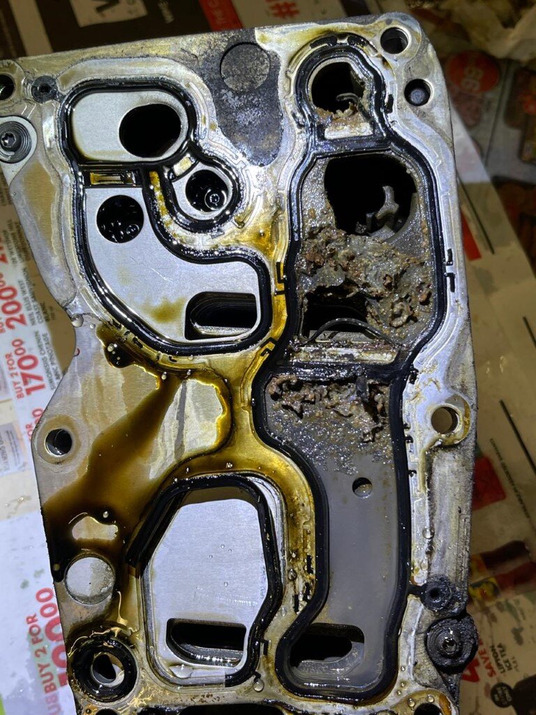

  • And that’s when we found the catastrophic damage:
    • Destroyed gasket rubbers
    • Shattered thermostat pieces scattered through the coolant channels
We sent him photos immediately and explained that the best way forward was a brand-new oil filter housing assembly. He agreed.

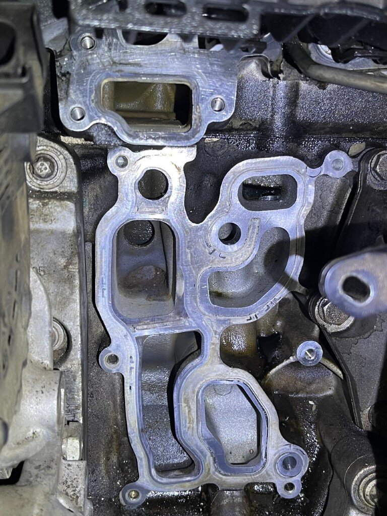

  • Cleaned the coolant flange port and mounting area
  • Fished out broken thermostat debris from the coolant channels
  • Prepared all contact surfaces for the new parts
Once the new oil filter housing assembly arrived, we reassembled everything with care:

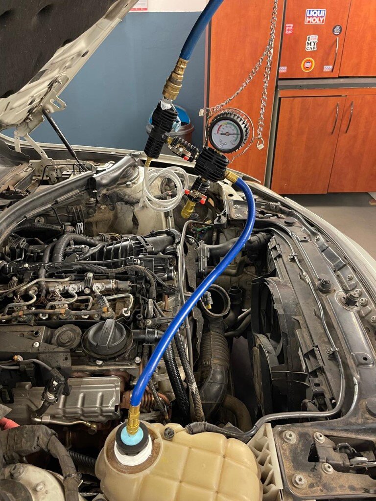

  • Vacuum tested the cooling system — held negative pressure perfectly

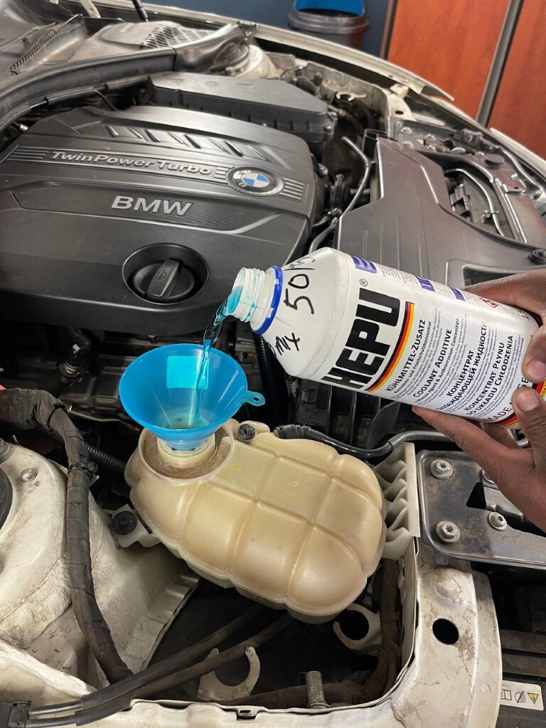

  • Vacuum-filled with new coolant + distilled water
  • Pressure tested again — no leaks found

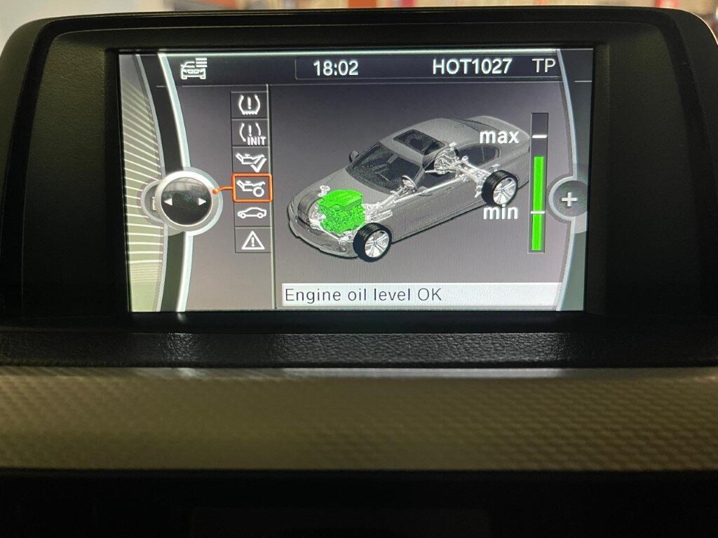

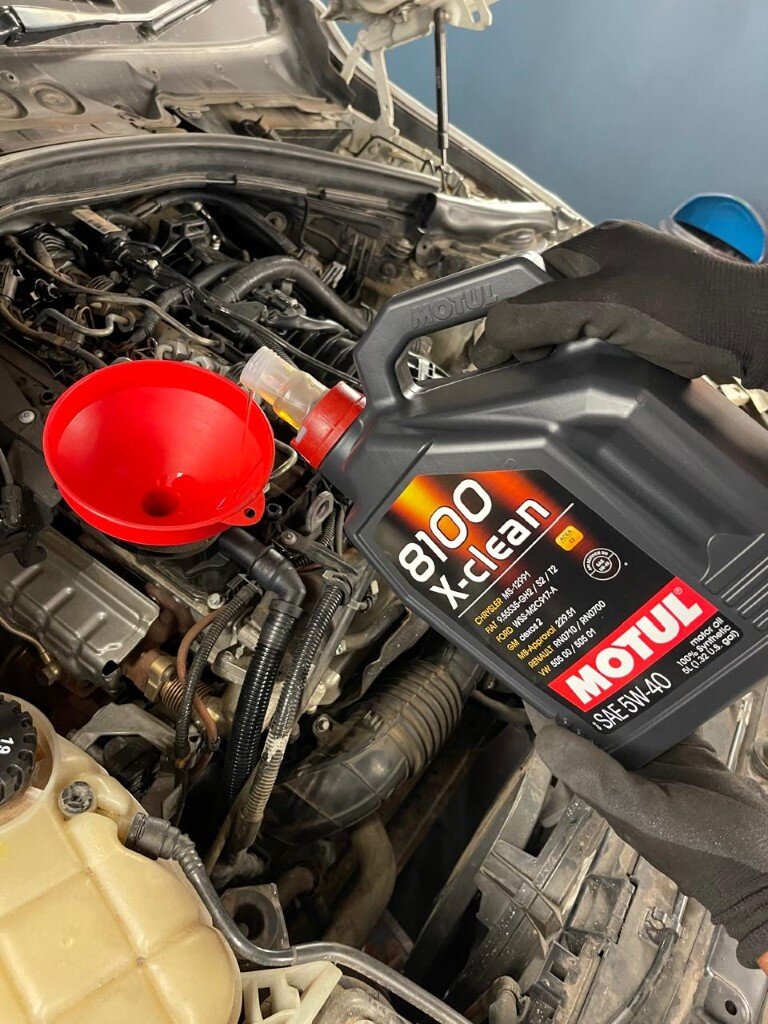

  • Refilling with fresh engine oil

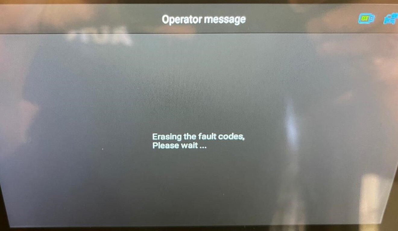

  • Running diagnostics and clearing all stored errors

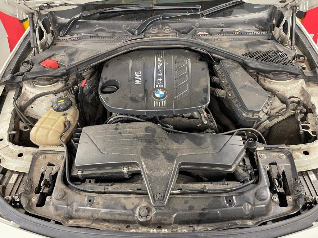

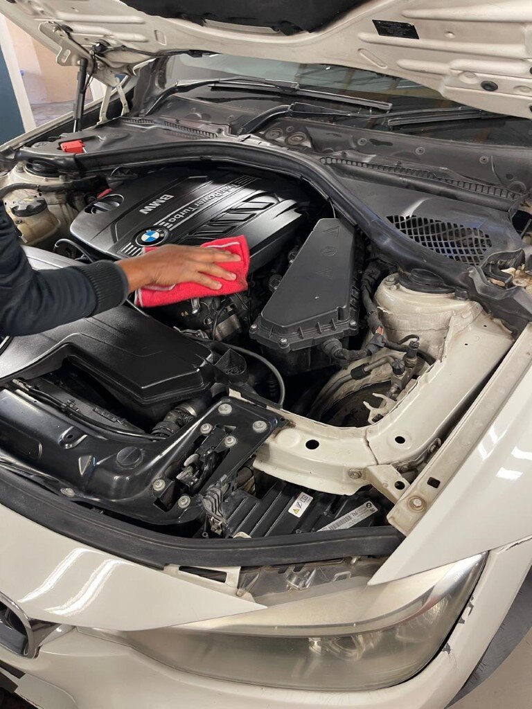

We let the car cool overnight, topped up a small amount of coolant the next morning to reach the proper level and gave the engine bay a proper clean before calling the customer to collect.
