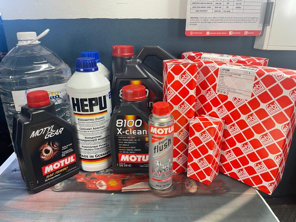

His parts/fluids arrived yesterday, and this morning the car was dropped off and we got cracking. Here’s a breakdown of the service:

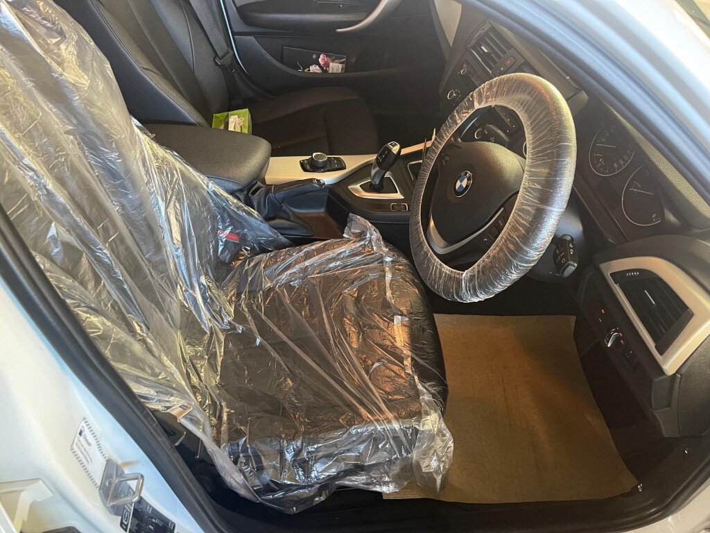

1. Vehicle Prep
  • Protective covers fitted to the driver side seat, steering wheel, and footwell.

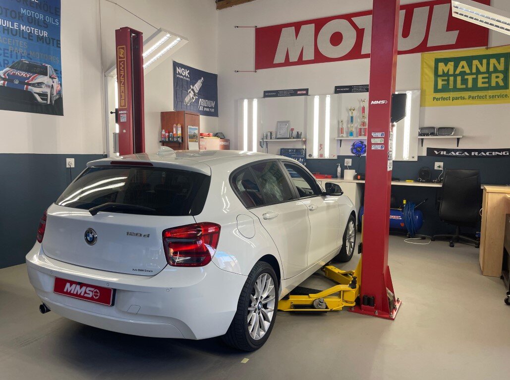

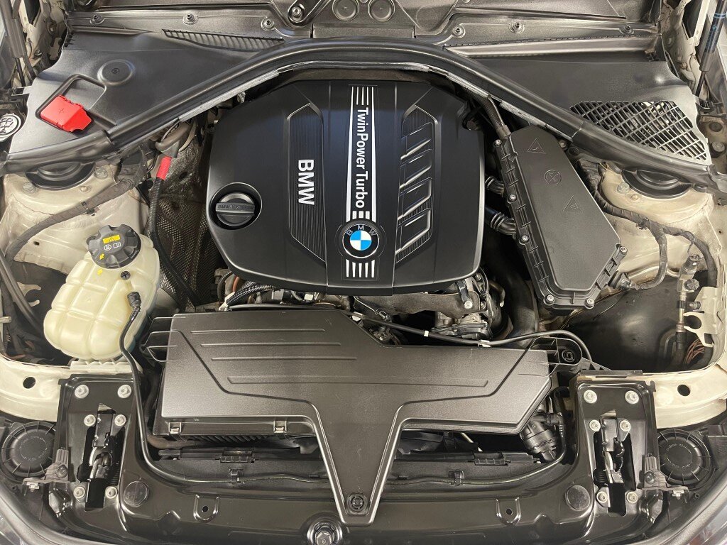

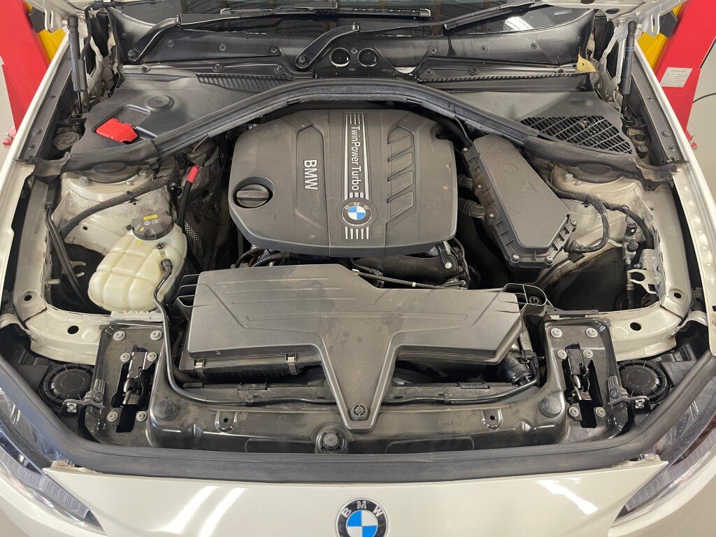

  • Vehicle moved onto the lift and engine bay blown out with compressed air.

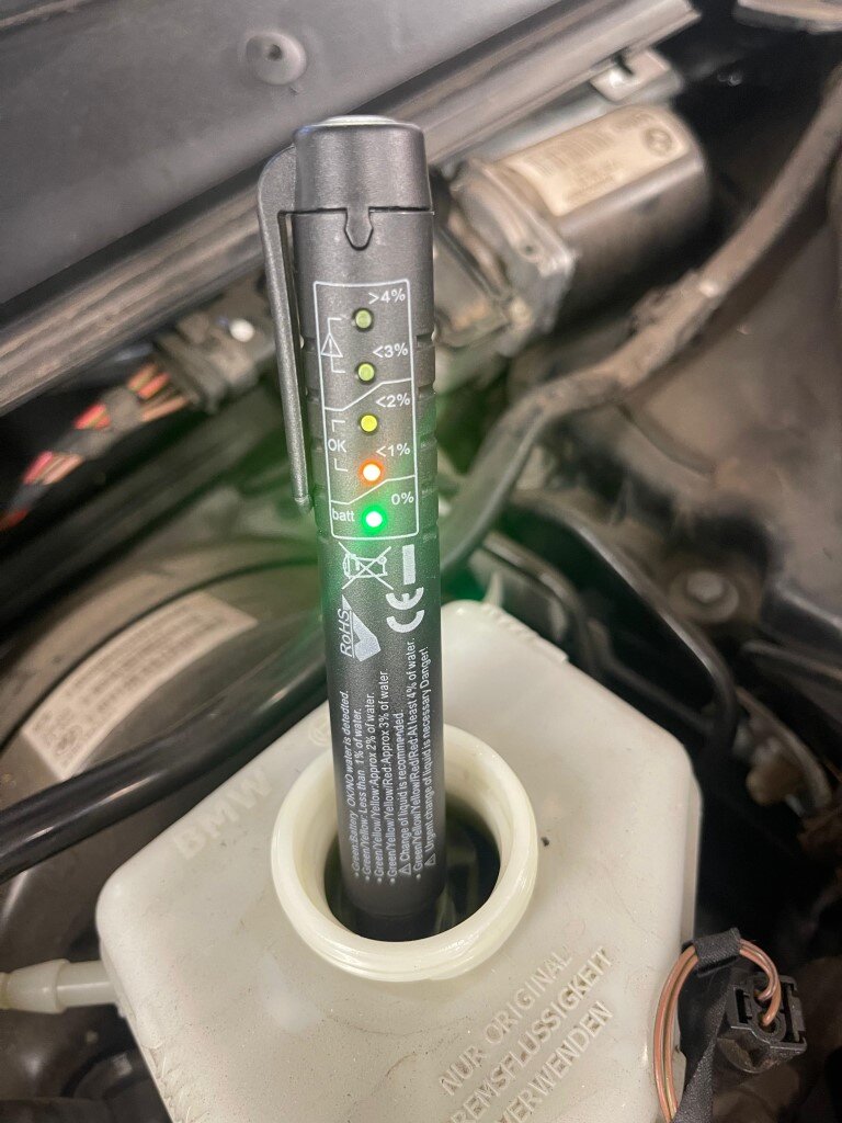

  • Brake fluid tested, Still good and doesn't need to be replaced now.

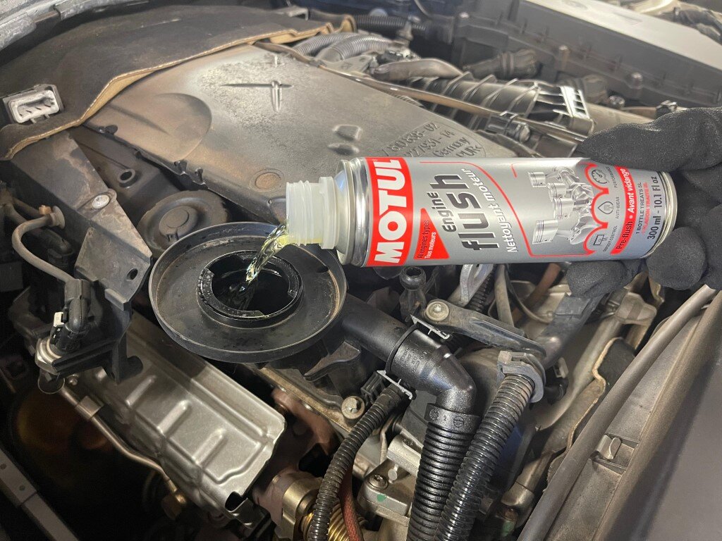

  • Engine flush added, idled to circulate, and then shut off.

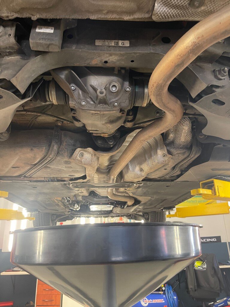

  • Vehicle raised, undertrays removed.

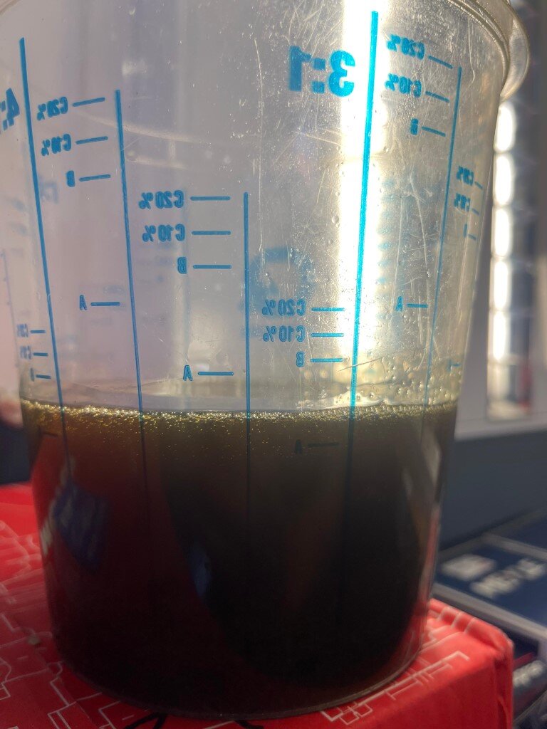

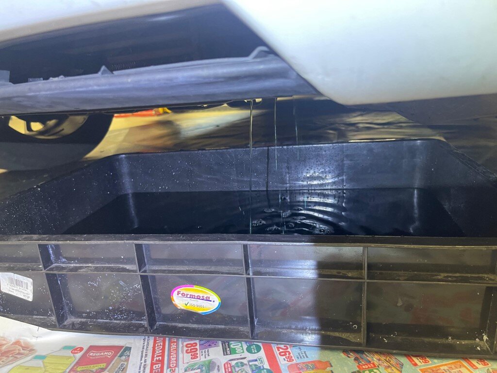

  • Old engine oil drained fully.

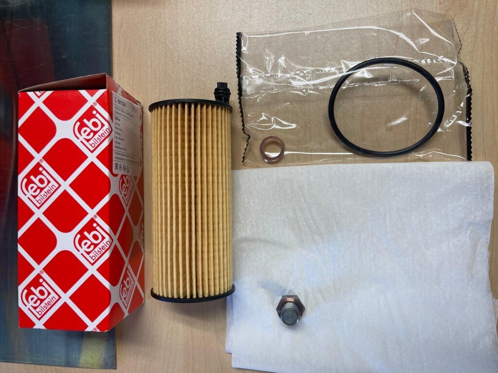

  • New sump plug and crush washer installed.
3. Filters

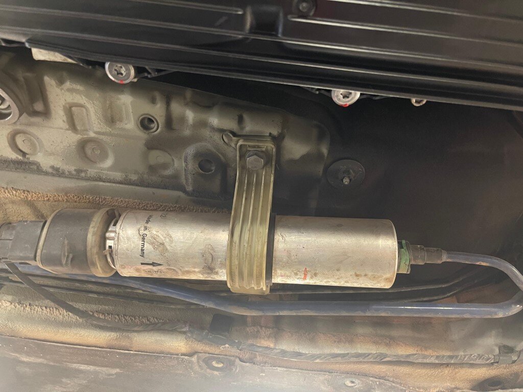

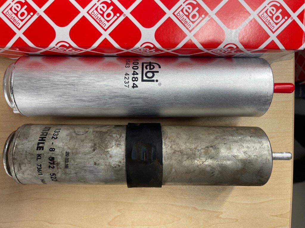

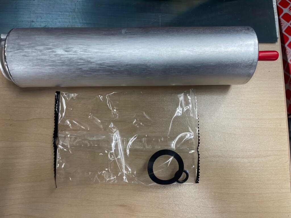

  • Replaced fuel filter.

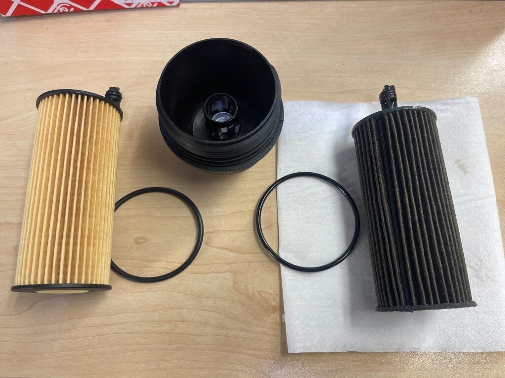

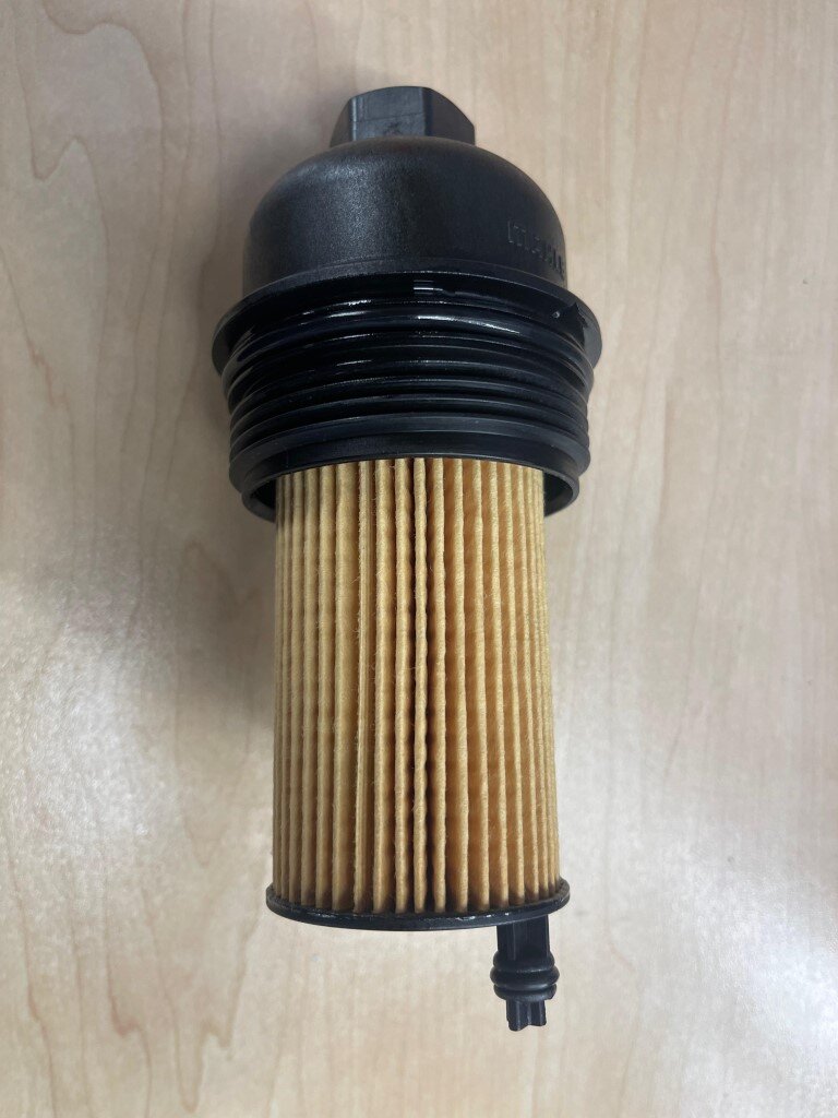

  • Replaced oil filter after cleaning housing + cap, new O-ring installed.

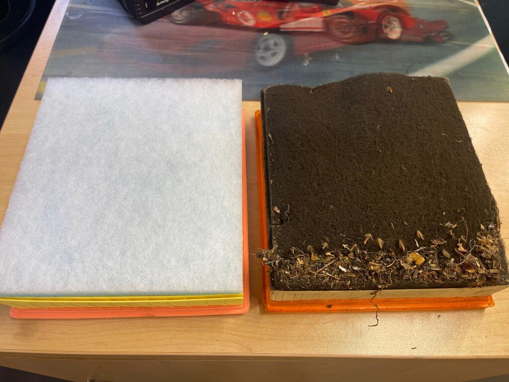

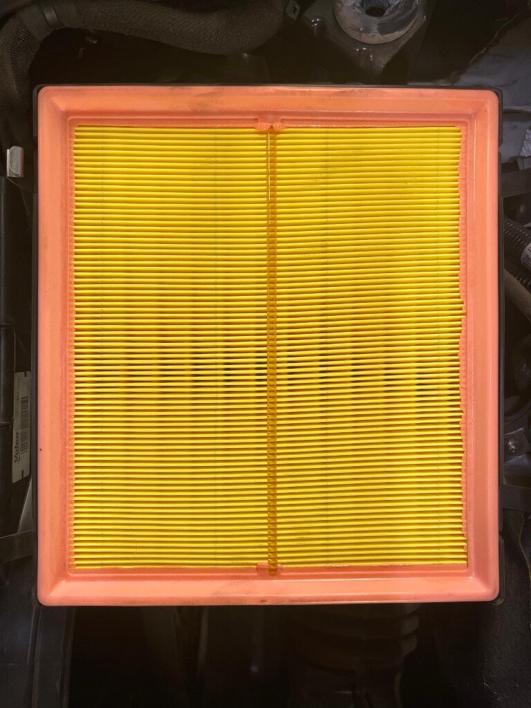

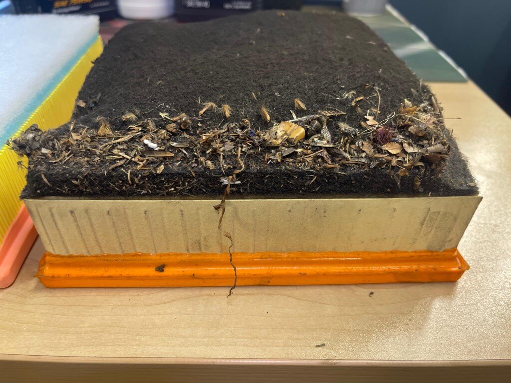

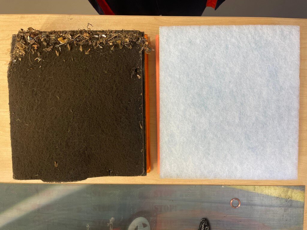

  • Replaced air filter – airbox cleaned with compressed air beforehand.

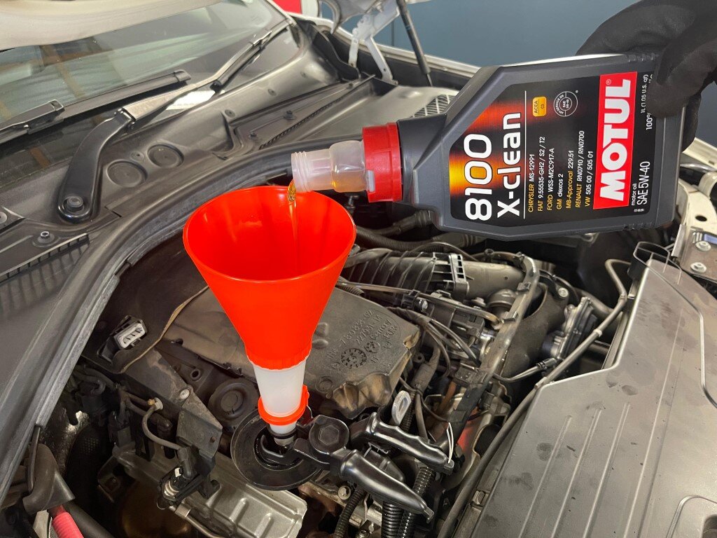

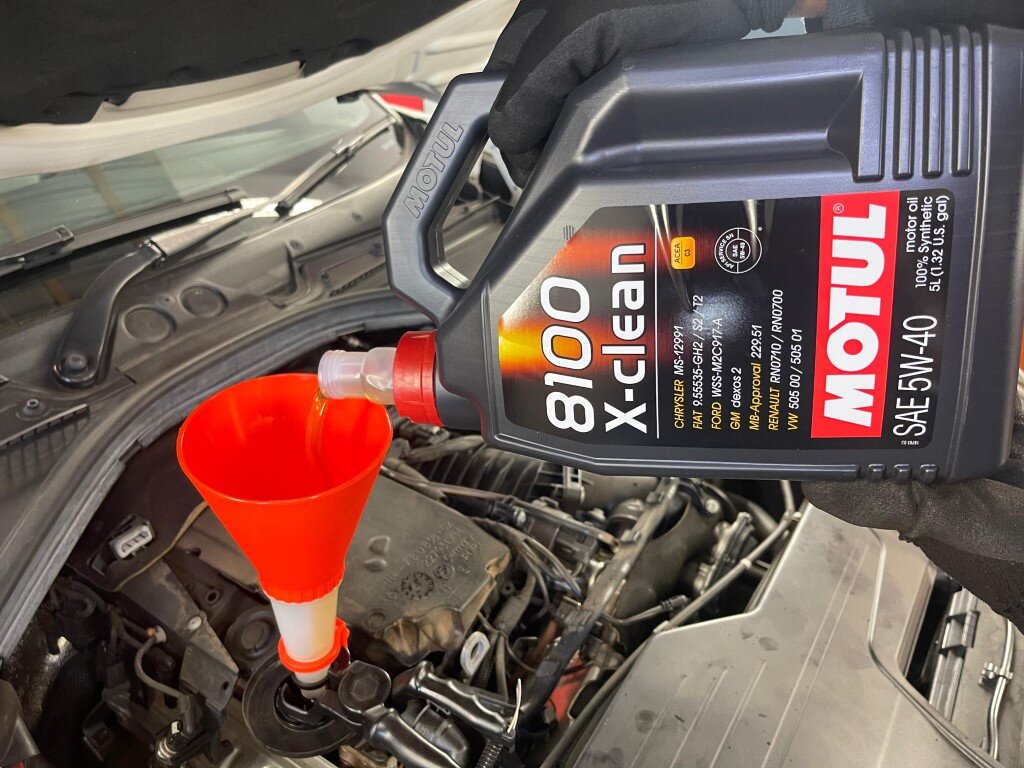

4. Engine Oil Refill
  • Fresh Motul X-Clean 5w40 oil filled up and checked.

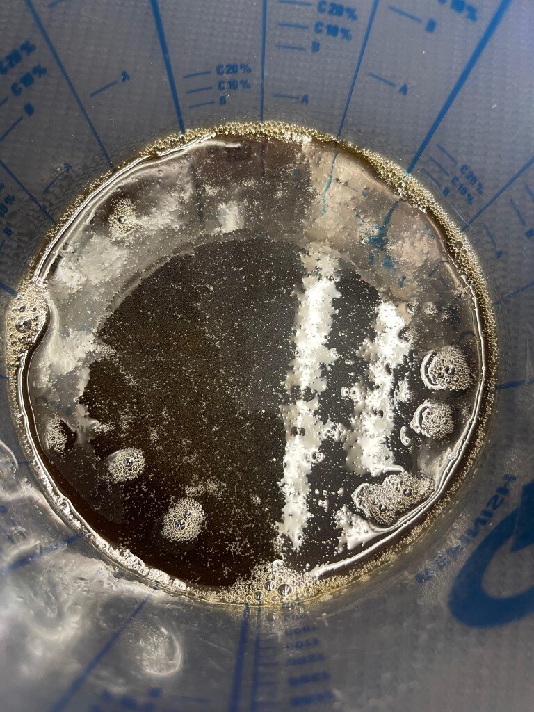

  • Vehicle raised, old coolant drained.

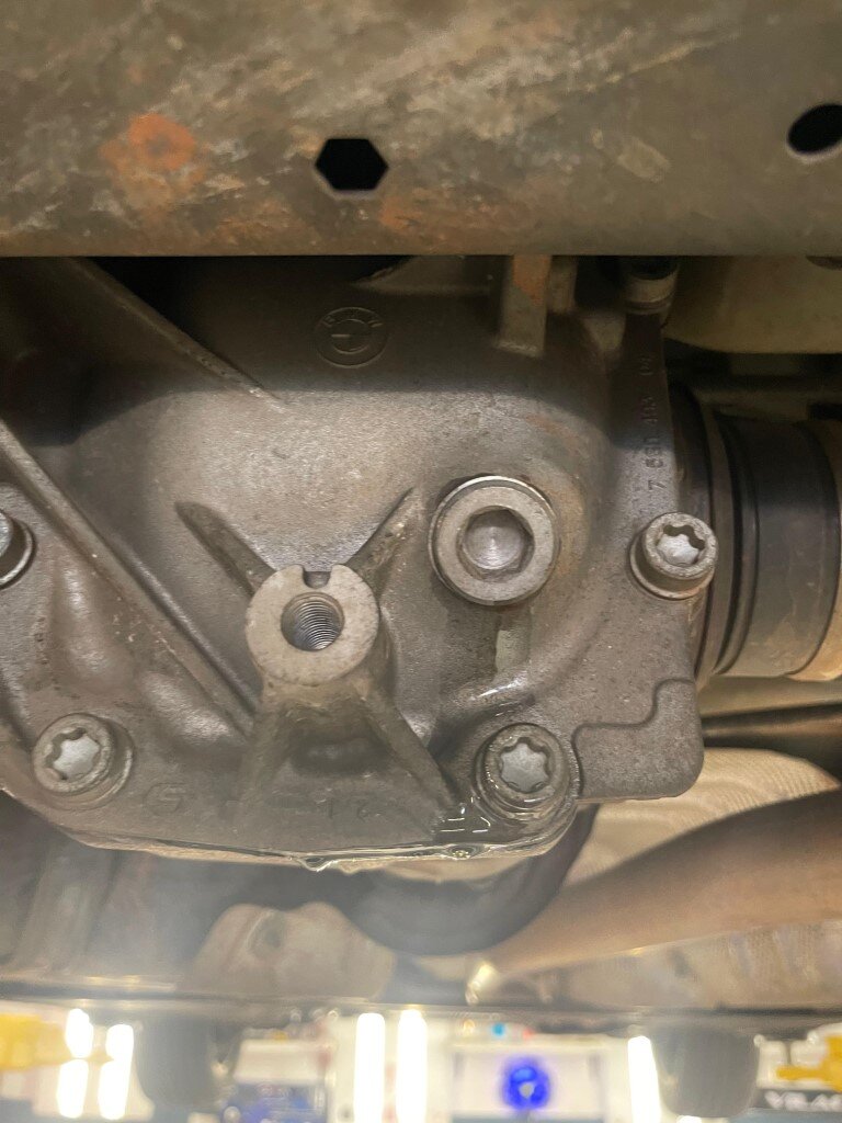

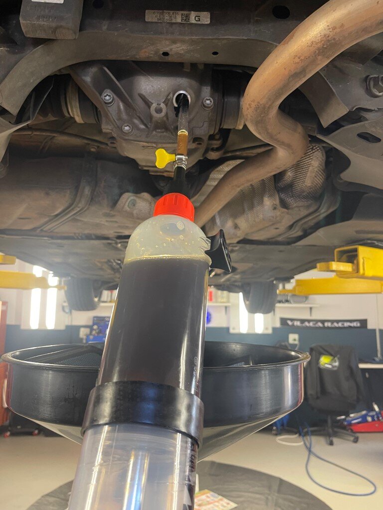

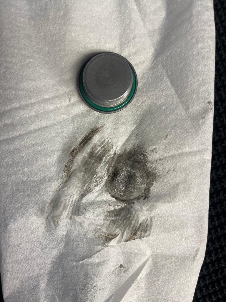

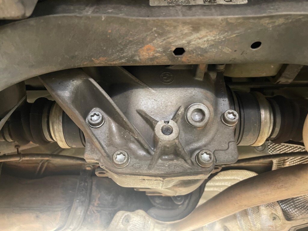

  • Rear differential opened, old oil extracted and refilled with Motul Gear oil.
  • Diff plug and area cleaned up.

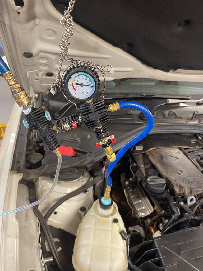

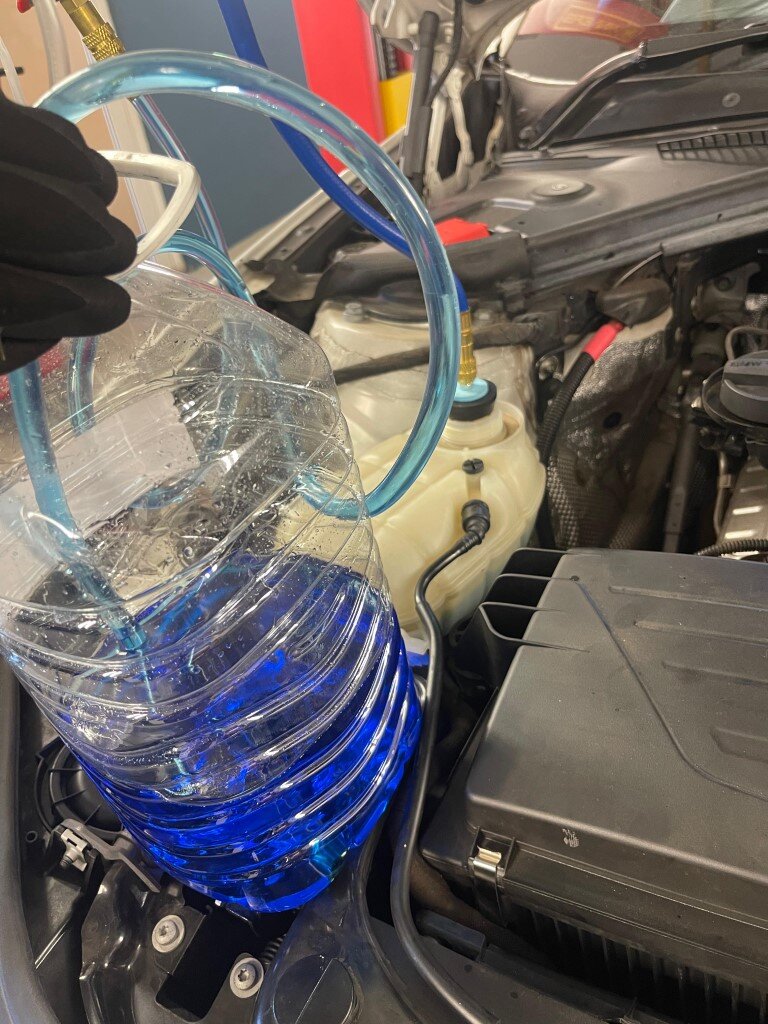

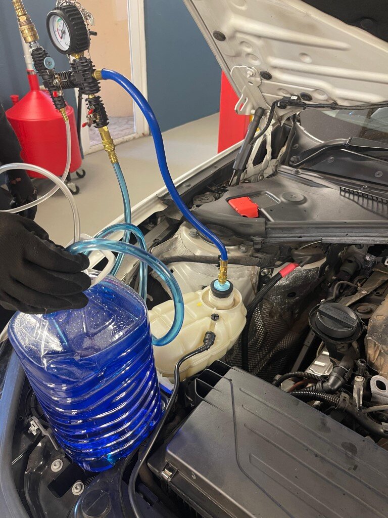

  • Vacuum tested the cooling system.
  • Coolant system vacuum-filled with coolant/distilled water mix.
  • System bled thoroughly.

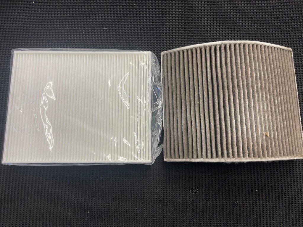

  • Cabin air filter replaced.

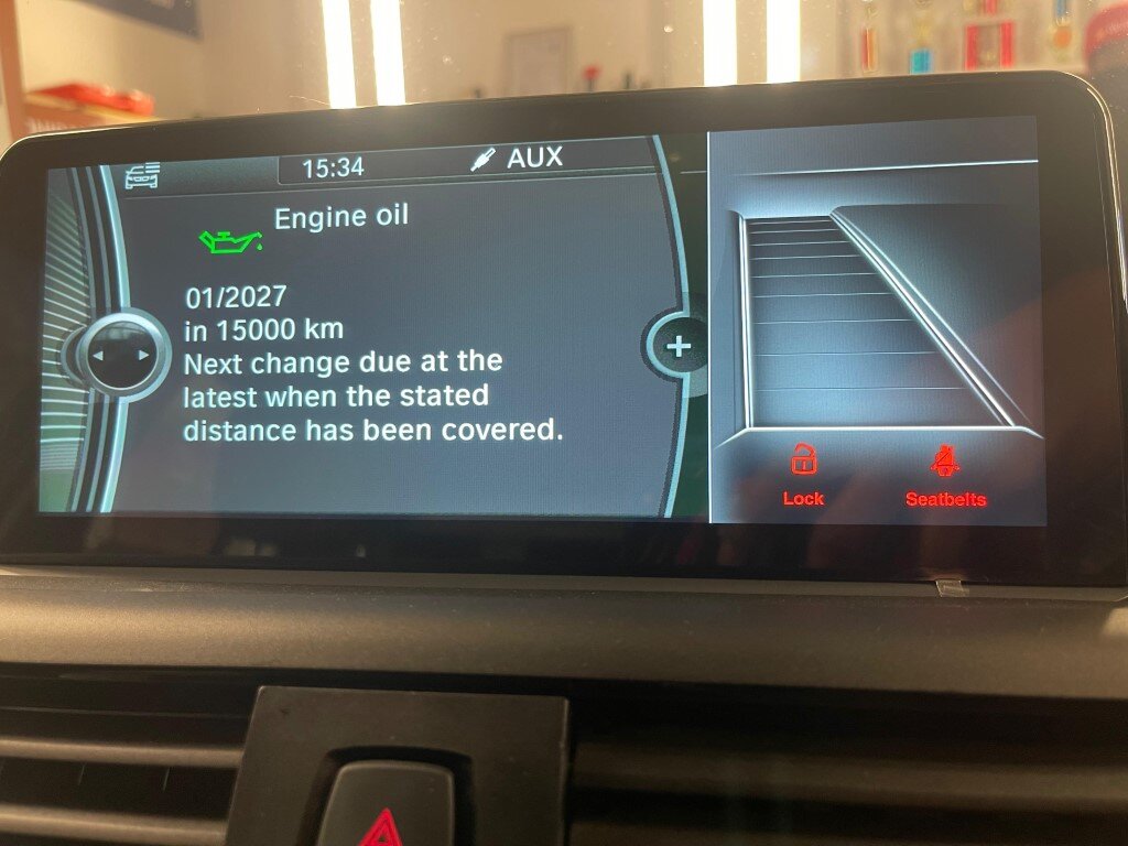

  • Cleared old codes and reset service reminders for:
    • Engine Oil
    • Vehicle Check
