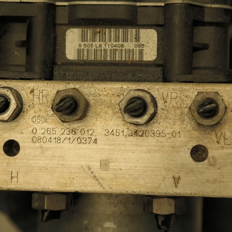

There is 2 braded hoses marked V & H from the Master Cylinder front and rear circuits directly supplying the ABS pump - then from the ABS pump hard lined to each wheel VL VR, HL HR - marked on the ABS pump for every wheel
Tip: it was a hydraulic problem

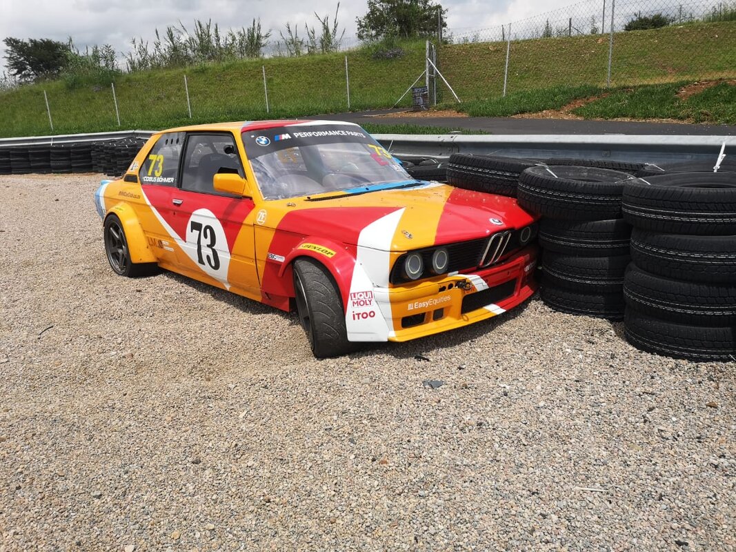

During testing on Sunday, a separate brake issue occurred. Under heavy braking at Turn 5, brake assistance was lost. Fortunately, only cosmetic damage resulted.
Key observations:
  • Brake pedal feel was excellent under normal braking
  • When pushing the braking limits, the pedal became very hard
  • Symptoms point toward insufficient vacuum supply, not hydraulic failure
This issue is not related to the original spongy pedal problem.

Benji
I did a slow lap in grief after seeing you in the wall. What a bummer, but I am thankful that the damage is minor...battle scars...
Navigator_E90
Things can escalate very quickly when something goes wrong on track, which is why thorough testing before a race weekend is critical. The risks increase exponentially once you’re surrounded by other race cars, leaving very little margin for error.
Unfortunately, there are still many competitors who skip proper testing altogether. When issues arise under race conditions, the consequences can be severe — not only for the driver involved, but for everyone else on track. They will pitch up at Friday's practice to test new modifications.... its so wrong!
Proper testing isn’t optional; it’s a fundamental part of responsible race car development.

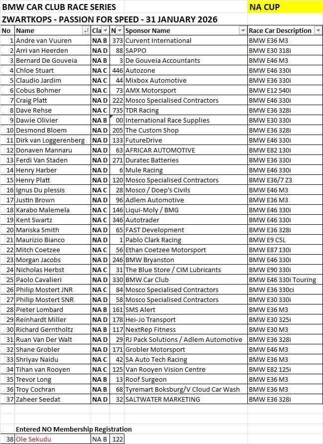

Its Race week - We have Practice on Thursday and then official practice and qualifying on Friday. 2 Races on Saturday, please see below time schedules per day.
Plan is to test the E12 Thursday, still got a few things to sort out, but all good at this time.
There is a total of 37 N/A (Non-Turbo) cars in our race, supper excited for our first race without Turbo cars!

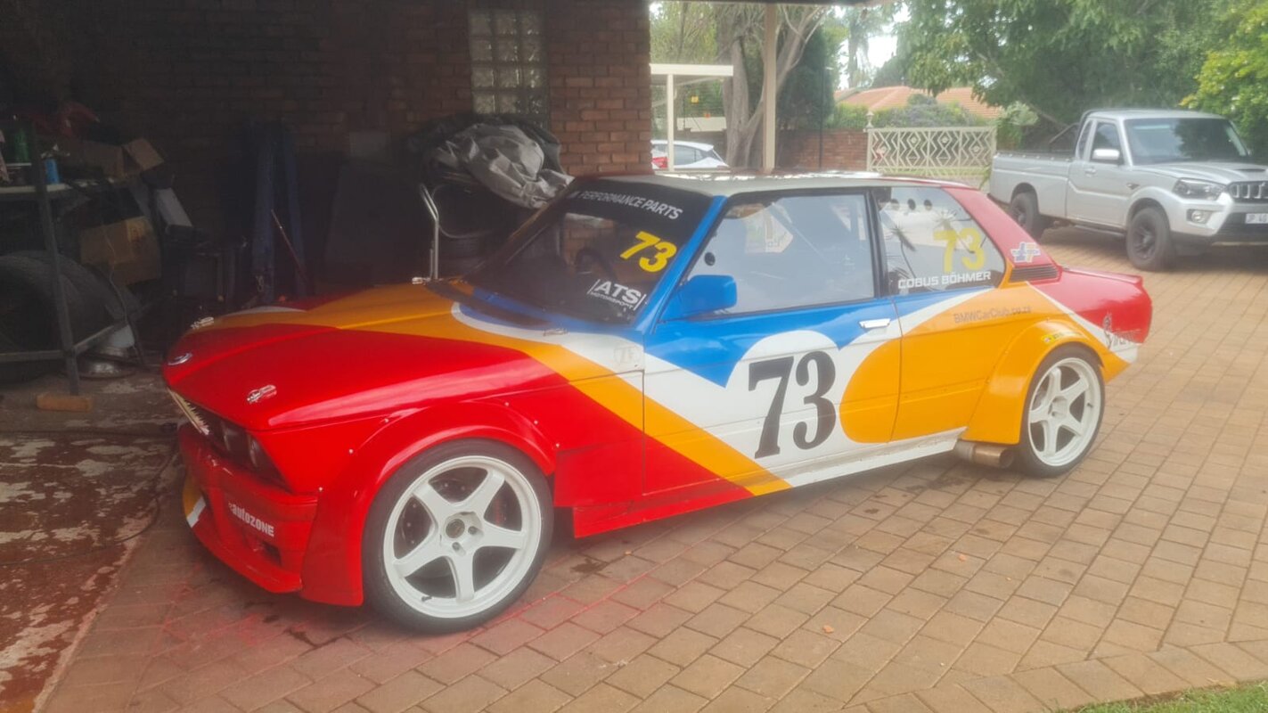

Getting ready for the weekend - while I was busy repairing the damaged bodywork, had to redo the mags as the gravel in the kitty-litter is extremely abrasive and scratched the rims badly. Wanted to change the rim color for a while - thus this was the opportunity.
Wheel alignment tomorrow morning and then 1st practice session at 13h30,
