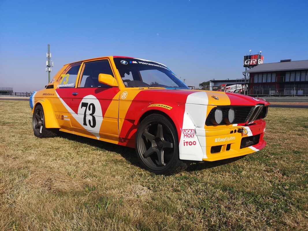

Bodywork Details & Front Bumper Development​
While still working through the bodywork phase, a significant amount of time was spent researching period-inspired modifications that could be adapted without compromising the character of the car.
During this process, I came across an image of a retro-built BMW E21 fitted with an E36 front bumper. The combination worked exceptionally well, blending modern aggression with classic proportions, and it immediately stood out as a viable option for this build.
Based on that reference, the decision was made to test-fit and paint the car with an E36 front bumper installed. The result preserves the classic E12 identity while introducing a more purposeful front-end appearance, better airflow potential, and improved compatibility with modern splitter and ducting options.
Photos below show the car in paint with the E36 front bumper fitted.

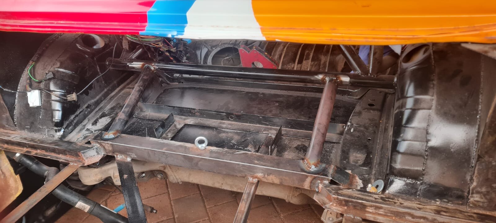

Suspension Development Strategy
At this stage, the plan was still to retain E90 suspension front and rear. As with many decisions in this build, that plan changed.
While the E90 suspension offers good geometry and track width, further research highlighted limitations when paired with increased power, torque, braking capacity, and wider tires.
The decision was made to adopt the rear suspension subframe from a BMW E63. The initial motivation was purely mechanical:
  • Aluminum rear subframe
  • 210 mm differential (significantly stronger than the E90 unit)
  • Larger CV joints and driveshafts
  • Increased brake package compatibility
  • Designed to handle substantially higher torque loads
However, integrating the E63 rear subframe required extensive modification. Nearly half of the original E90 rear chassis structure had to be cut and re-engineered to accept the wider subframe. I also had to manufacture strut towers as the E63 uses strut/coil over shocks vs the E90 suspension based a separate shock / coil combo
The resulting rear track width was substantially wider — both functionally and visually significant.
At that point, symmetry and geometry dictated the next step: the E63 subframe was also adapted to the front, introducing an entirely new set of challenges and requiring further structural and suspension redesign.

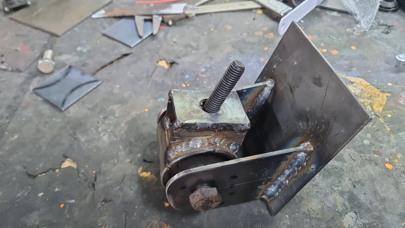

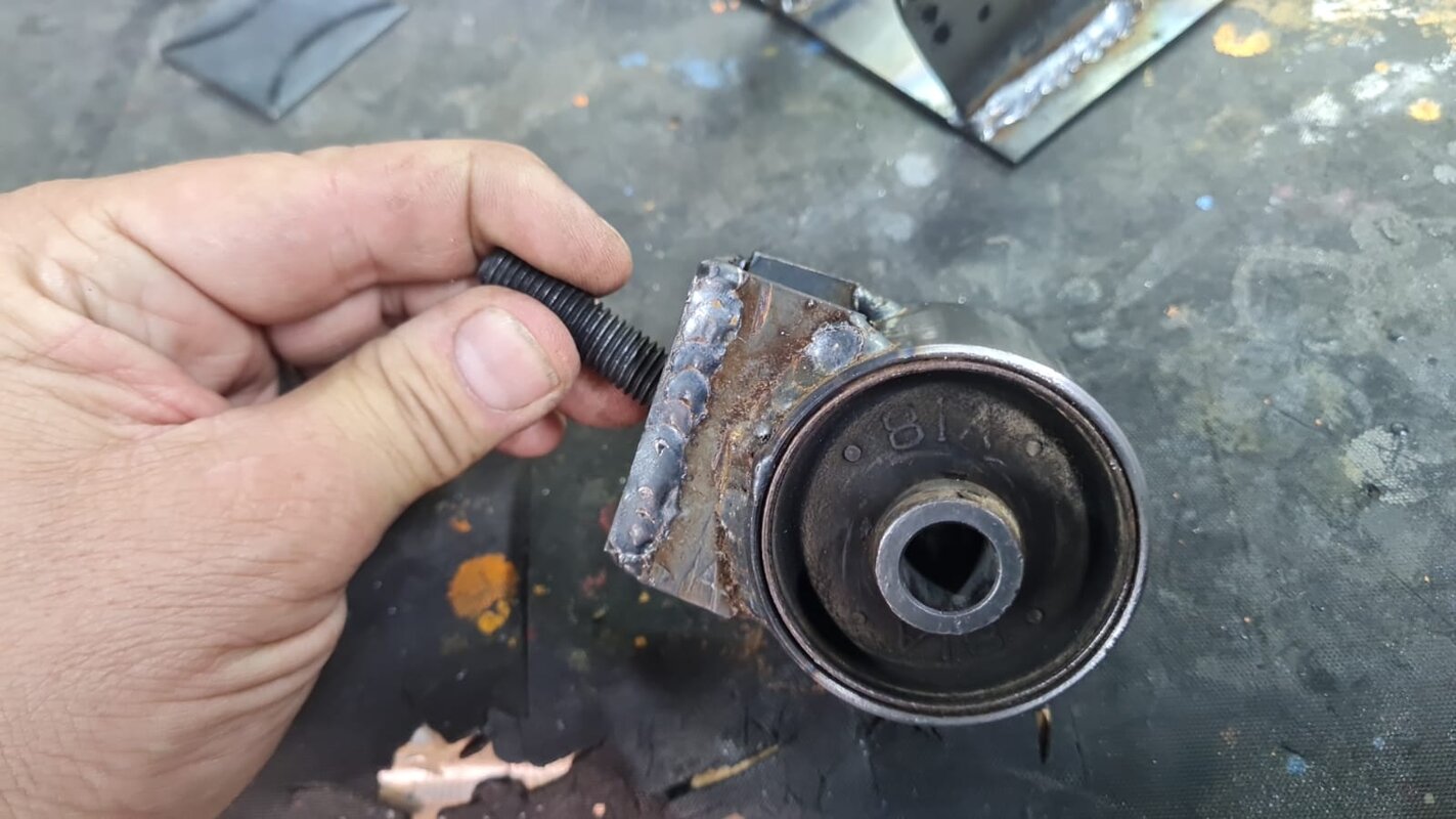

Engine Position & Mounting​

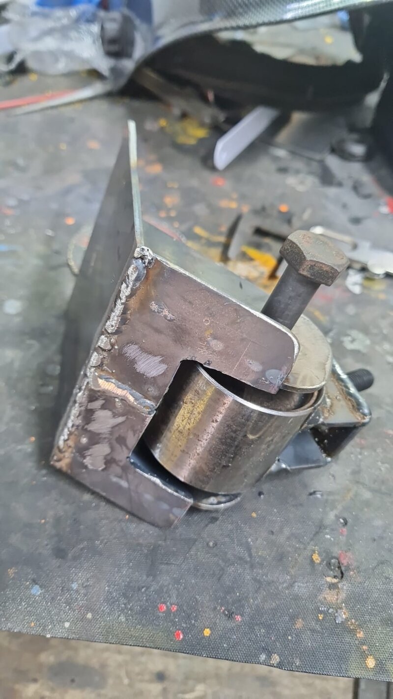

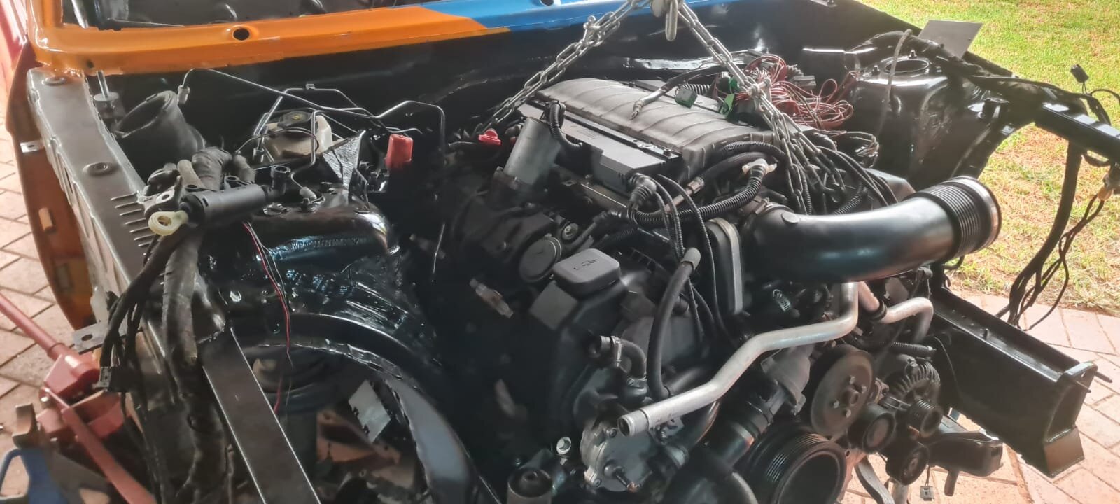

In the E63, the engine is mounted to the front suspension subframe and positioned relatively far forward, which suits the car’s long bonnet but was not ideal for this application.
To achieve improved weight distribution and driveline alignment, the engine was relocated rearward as close to the firewall as possible. This made the use of the original E63 engine mounts impractical.
From a serviceability and race-engineering standpoint, mounting the engine to the suspension subframe was also undesirable, as removal of the subframe or steering rack would require additional engine support.
As a result, custom engine mounts were designed and fabricated to mount the engine directly to the chassis rails, allowing precise engine placement, improved load paths, and easier access for future maintenance in order to drop the subframe independently from the engine

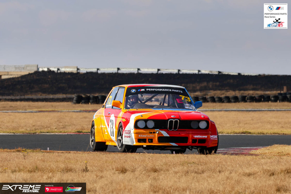

First Race Out – Shakedown Under Pressure​
The video below was taken during the first race event the car entered. Unfortunately, there was no opportunity for proper testing prior to the weekend.
Preparation for the event involved nearly two weeks of continuous work, often late into the night. In hindsight, the remaining workload was significantly underestimated. The car was still being assembled and build issues resolved at the circuit during scrutineering. While this approach was clearly rushed — and arguably reckless — some of the strongest memories are made under pressure.
The primary objective for the weekend was simple: get the car on track and complete laps, regardless of finishing position.
The car ran, which in itself was a major milestone. From the driver’s seat, the V8 had a NASCAR-like sound and presence, while external pit videos captured a more traditional old-school V8 tone. More detail on the exhaust and sound characteristics will follow in a later post.
Several systems were not fully functional. ABS was inoperative, yet the overall driving experience was exceptional and confirmed the concept was sound.
During the third lap of practice, all drive was suddenly lost. Post-event inspection revealed that the propshaft was too short and disengaged from the splined joint. This was due to an error during shortening by the supplier, which went unnoticed during final assembly — a direct result of fatigue and time pressure.
Despite the early failure, the fundamental build proved viable. Even though the car only partially completed its first event, confidence and excitement remained high following the initial outing.

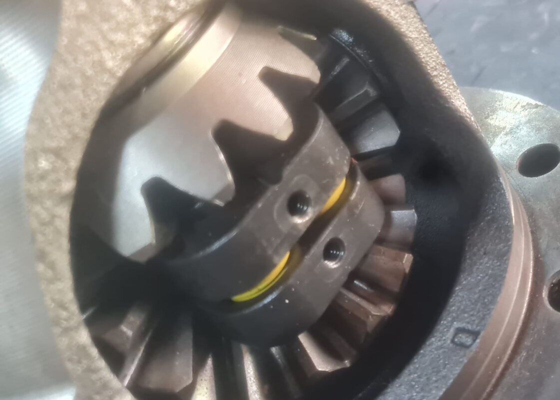

Rear Differential Strategy & Initial Setup​
As with most builds, budget constraints played a role in early component selection. For the initial rear differential setup, a “Racing Diff” limited-slip unit was installed. This was a known quantity, having performed well in the previous E90 build.
The decision was also made to retain the E63 final drive ratio of 3.24, based on the significantly higher torque output of the V8 compared to the E90’s N52 engine. The expectation was that the additional torque would comfortably support taller gearing, unlike the 4.44 ratio previously used in the E90.
Track Feedback & Limitations Identified​
During the second race event at Red Star, it became clear that the Racing Diff unit was operating beyond its intended torque capacity. While acceptable around 300 Nm in the 330i, it struggled to manage approximately 450 Nm in a track environment.
This was most evident in slower corners, where the inside wheel would lose traction almost immediately, compromising corner exit speed and making overall drivability tricky.
Upgrade to Full Limited-Slip Differential​
As a result, the budget was revised and a proper motorsport-grade limited-slip differential was installed toward the end of last year. Although additional unrelated gremlins prevented racing with the new unit, limited testing confirmed a significant improvement in traction and power delivery.
The Racing Diff unit remains a cost-effective solution and would still be recommended for lower-power applications or street-driven cars. However, in a high-torque, track-focused application, its limitations became apparent.
