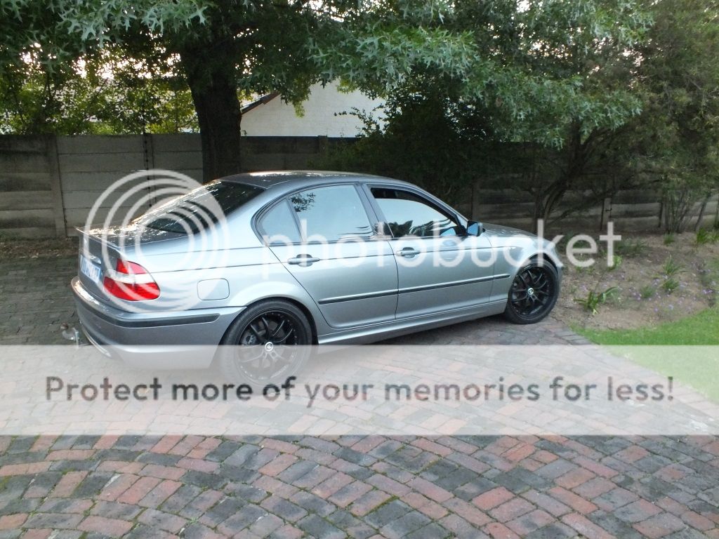

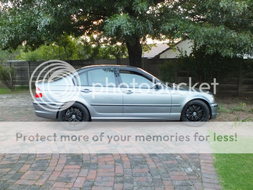

So, a bit of an update on the the car (sooner than I'd thought)
Told a mate of mine on Friday that I was looking for a set of 18/19-inch rims for the 330i, and he made a quick call to a mate - long story short, two hours later, the car was wearing a new sets of wheels, and I was suitably impressed.
While I'm not generally a fan of all-black wheels, I'm somewhat amazed at how well the matte black picks up with the car's colour and black trim.
8.5J's all round, with an ET38 offset - means that they're not too aggressive for the Sedan - the 265/30/19's in the back do however rub up against a section of the rear bumper liner that protrudes slightly when the car's loaded up and the suspension compresses heavily over a bump..
I'm thinking I'll keep the 265's on, roll the arches, tuck in the offending bit of liner (only in the right rear arch, funnily enough), and see how it goes... the rears still have very good life on them, so it'd be a bit of a waste having to pull them off and shell out cash to put on narrower tyres.
When the 265's have cried uncle, I'll replace them with 235/35/19's, same as in the front, so I can do wear-level rotation in future.
As for the rims, I'll touch up the chips on the dishes, but I'm toying with the idea of having the dishes polished, or refurbed in shadow chrome...
Thoughts?

Sorry but they are ugly and cheap looking, rather go back to your stock wheels or get some OEM 18's. Also black wheels don't suit your car at all.:thumbdo:

Im afraid I need to agree with Gizmo.
I would do them in a traditional silver, and they would suit the part much better.

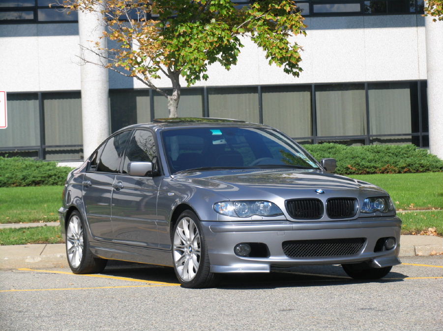

Respectfully, I prefer the originals. The OEM individual 18s are your best option if you want bigger than the standard 17s

Although the black wheel is unusual, the cars color requires a silver wheel.
