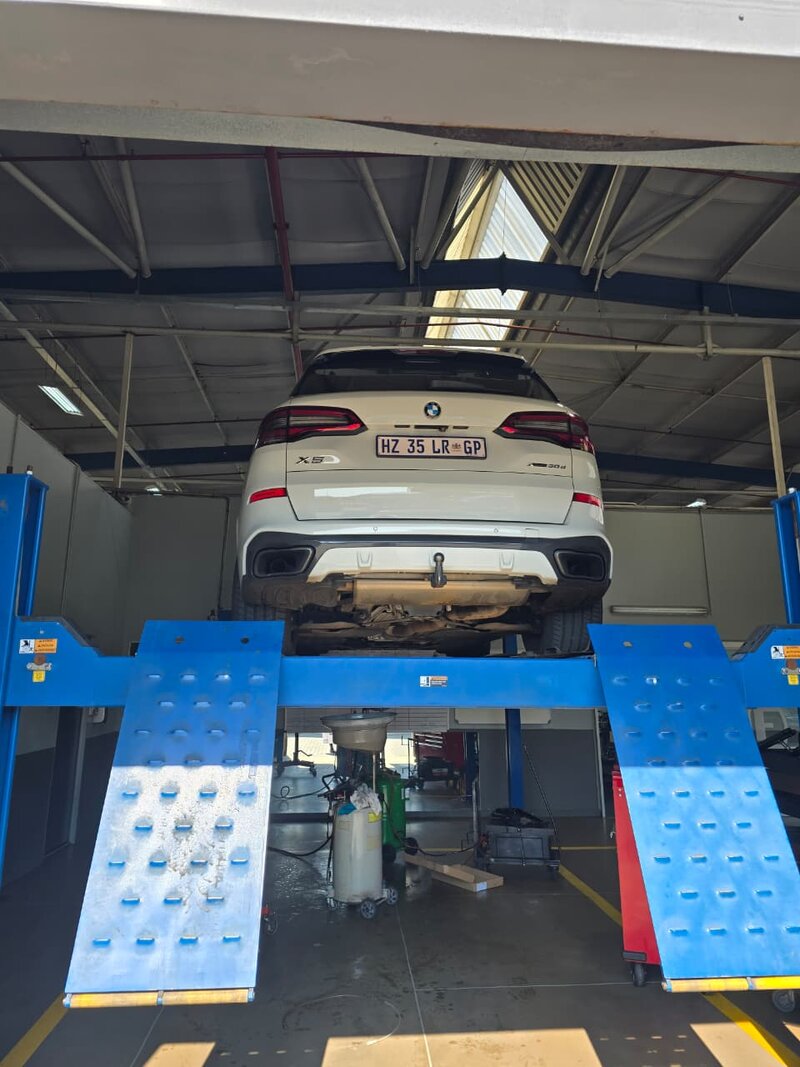

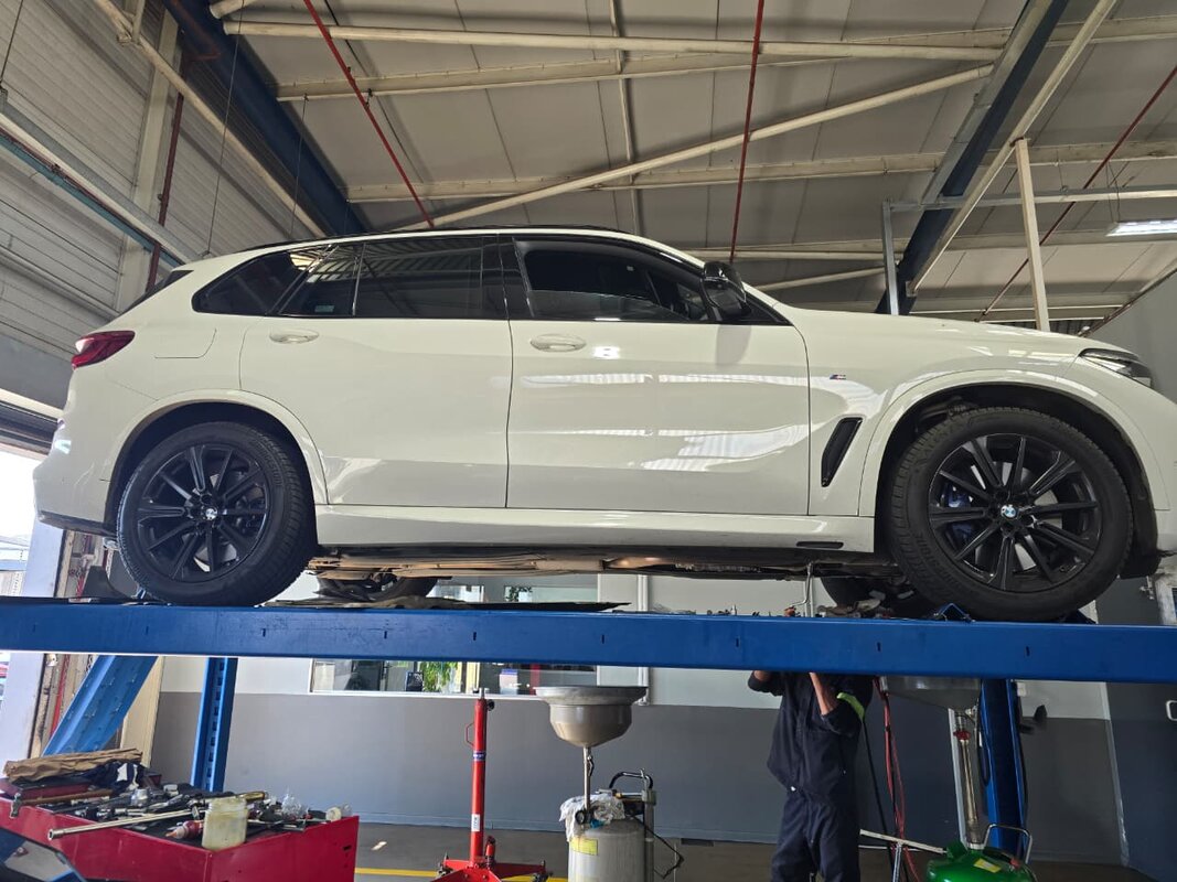

After months of procrastination, I finally did it....
been bugging the receptionist the whole week for an appointment, even though they were fully booked, but she managed to make a plan.
Left this morning at 5:45 and arrived at 6:50; the booking was for 7:30. Finished up at about 10:30.
Did the following:

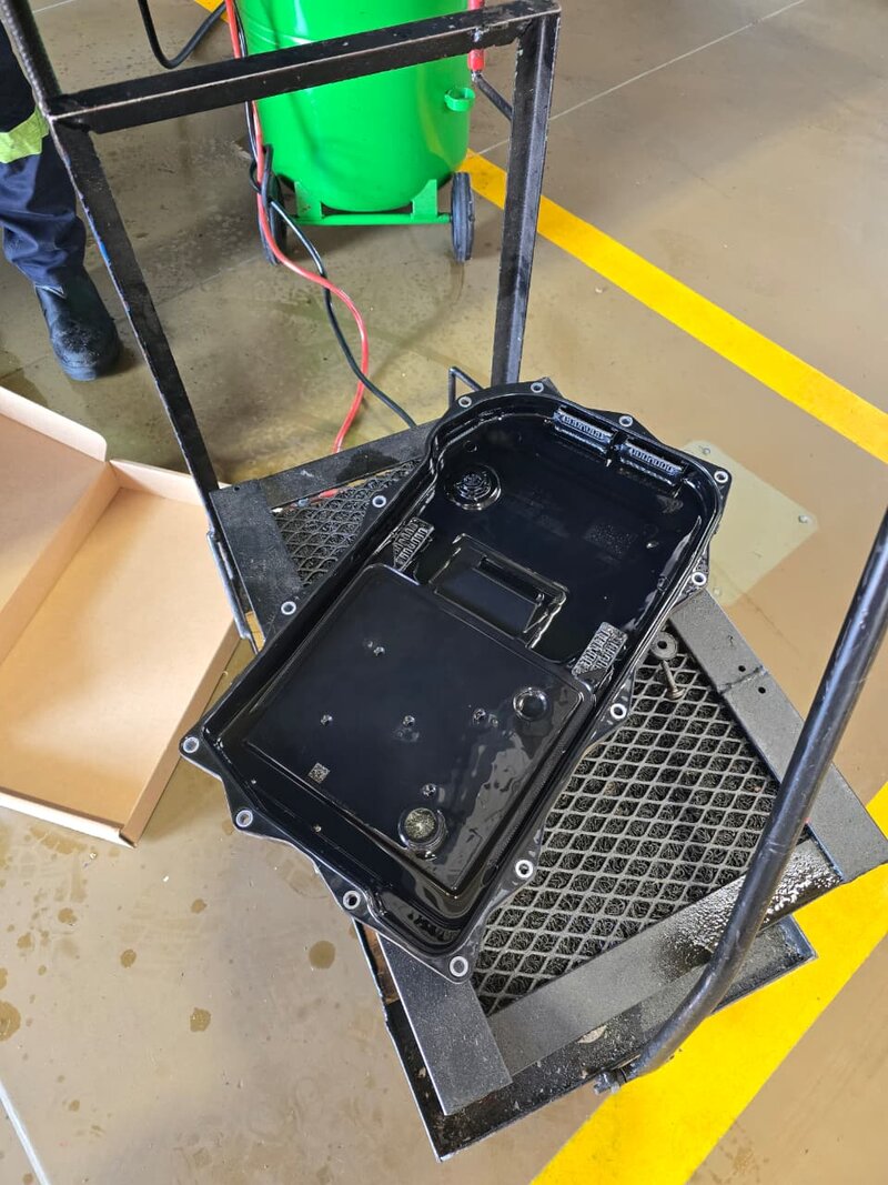

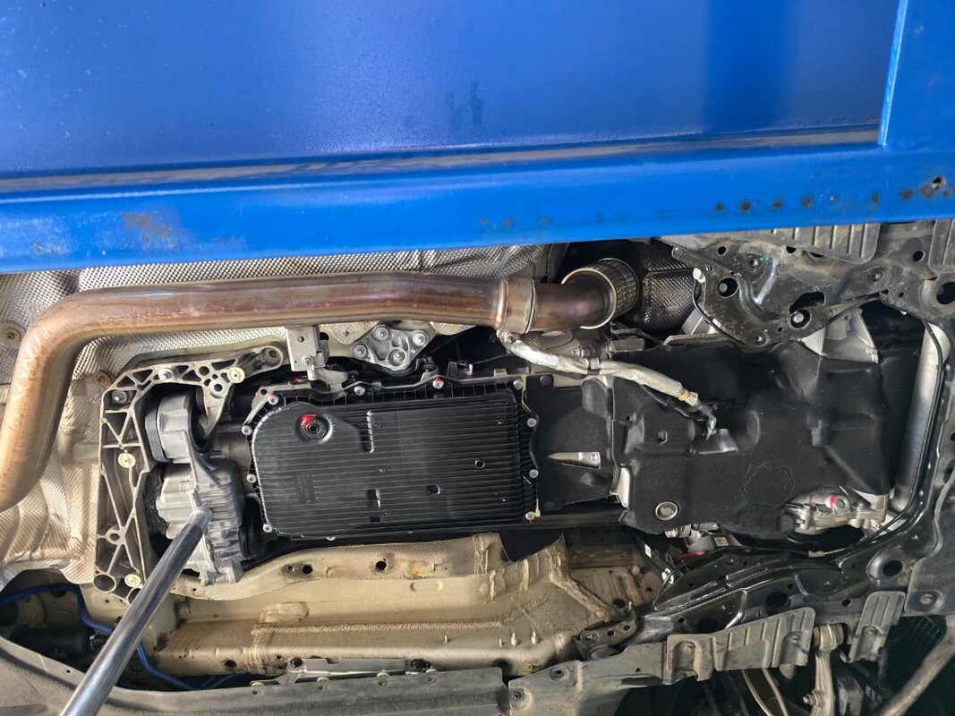

- Gearbox service (new sump, filter, gasket and Oil) + Reset clutches
- New transfer case oil, wasn't able to recalibrate the VTG (tried a few times). The T case is almost out of spec according to the tech (my chain is sitting at like 17 something degrees, and 18 is their max acceptable, around 21 is where you'll feel shuddering)
- Replaced both Front and Back Diff fluid. The back fluid was still perfect, but the front was overdue. (took the BMW part numbers and bought the Ravenol equivalent, as it was like 1/4 the price). The back takes almost a litre, and the front is +/- 600ml. Quite a bit gets wasted when filling, but 1L of each is perfect
I'm OCD, so I stood with the mech the whole time, looked at every detail and asked a lot of questions. Xolani and Moe are both lekker guys.
total worked out to:
5700 excl VAT for the Gearbox
400 excl for the transfer case
Diffs were complementary
Just over R7k. (I still tried to squeeze them for the 10% Forum Discount:ROFLMAO:)
I don't notice any difference whatsoever, but I guess that's not the point. Just happy it's done.
