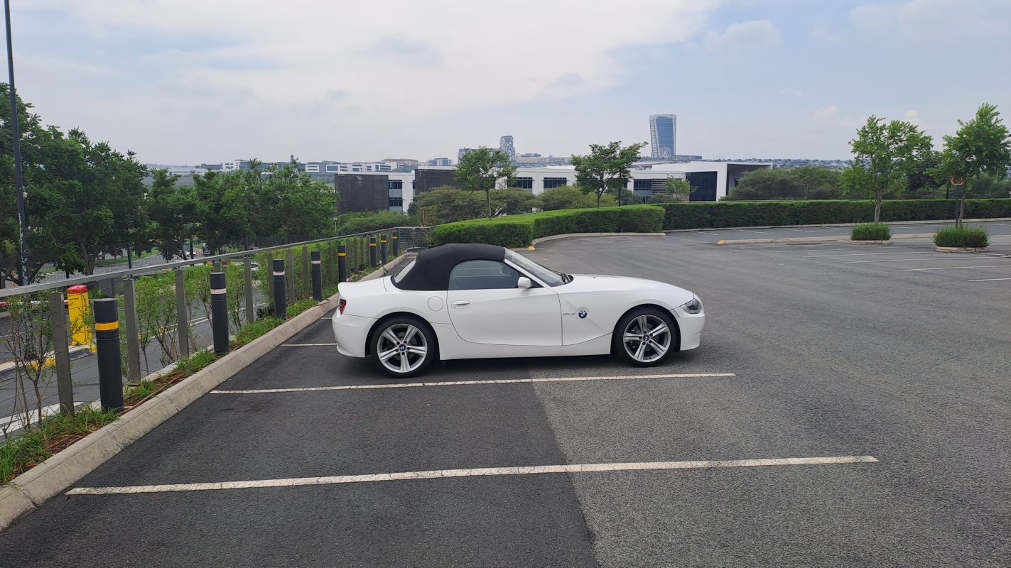

Avoiding car park dings, by parking far away

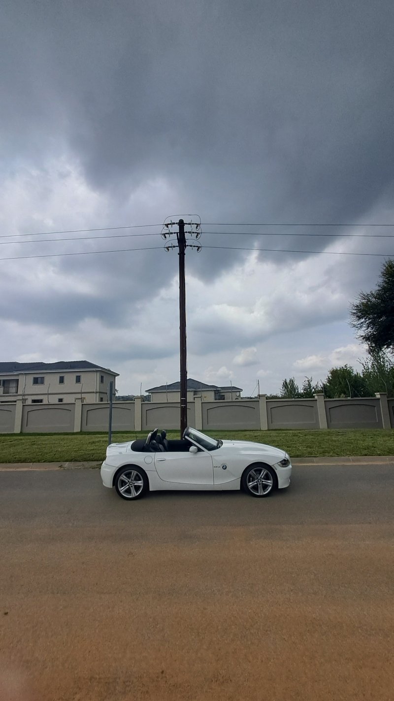

I am not photographer, but this is some sort of juxtaposition, I think 🤔

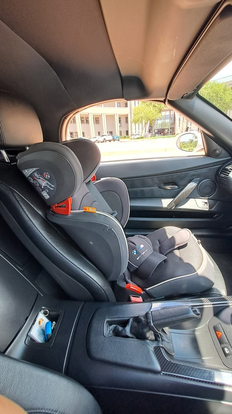

With standard fit ISOFIX and passenger airbag switch, I can also do the school run with no fuss.
Chris Bangle design language has aged well. E85 is classically sexy AF (more Scarlett Johansson than Megan Fox;) )
