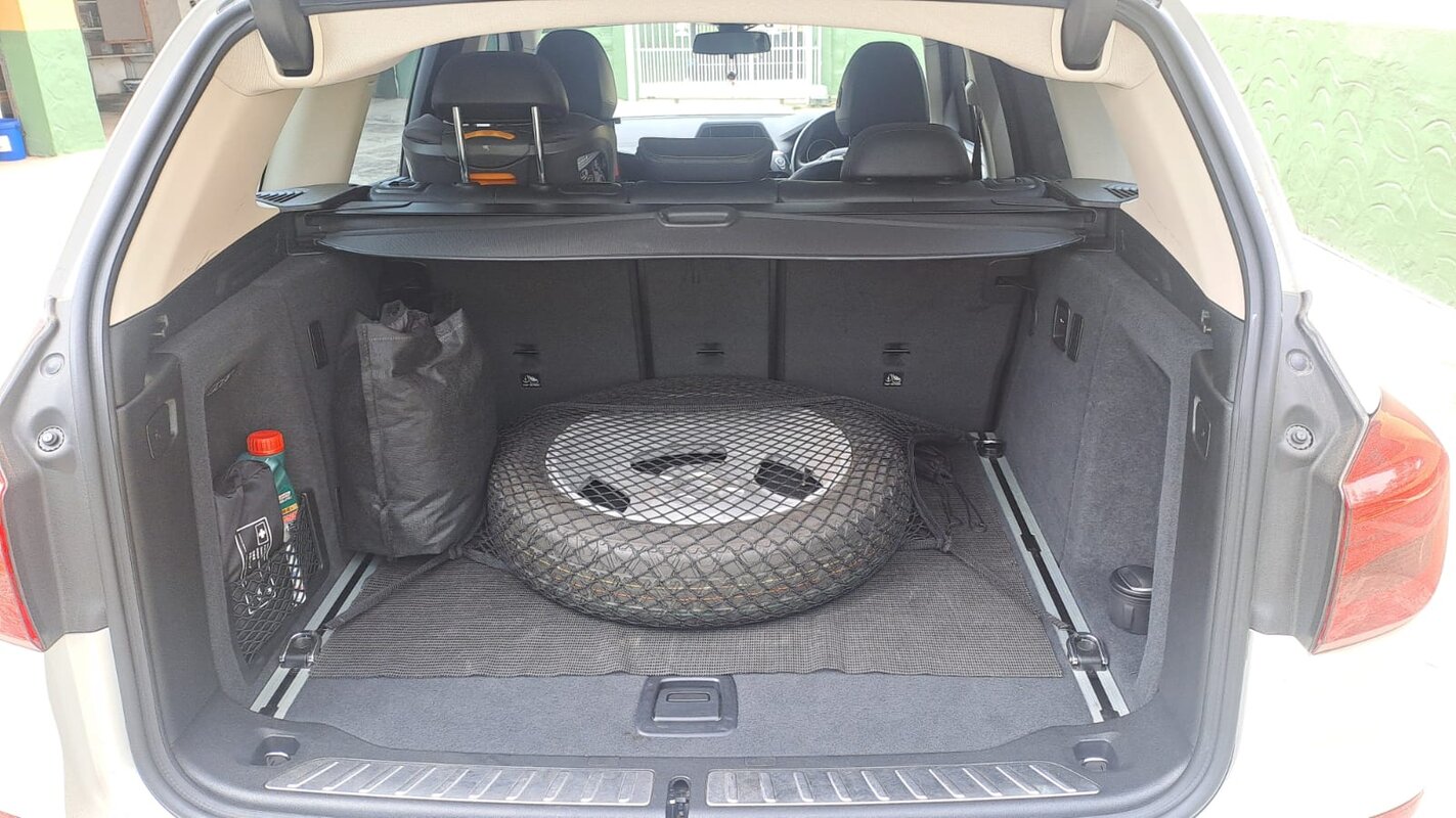

I have the space saver spare wheel on top of my boot board. My car does not have the spare wheel compartment under the boot board. This gives an indication of the space that would be lost.
An alternative is to get a roof rack and mount your spare wheel there.
Important to note that if you fit the spare wheel and place your damaged wheel in the boot, it will eat up a lot more space and you may need to sacrifice some luggage.
For your needs, maybe a roof rack with a full size tyre and rim may make sense (decent used one at least).
