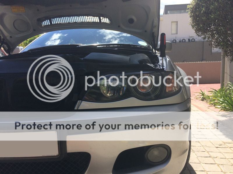

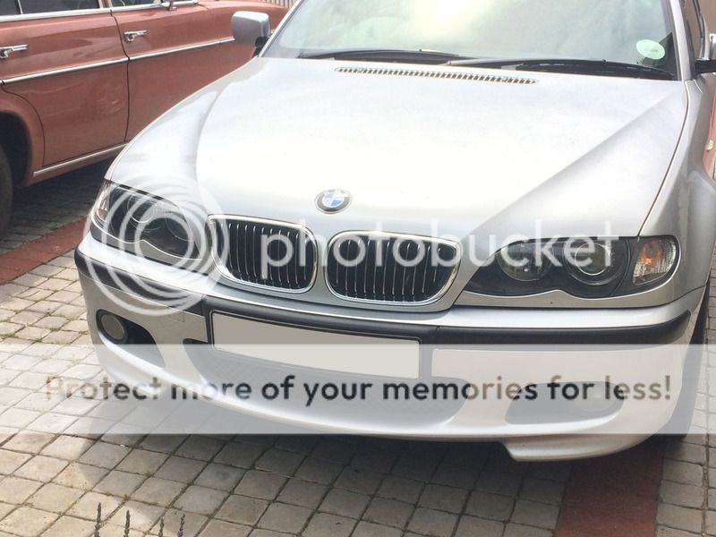

The car had an HID system installed in the halogen headlights. This simply would not do, so I asked the extremely resourceful Gizmo to help me find some OEM xenons. Within a week, Warren had found me a set of headlights and went and verified that they were in working condition. He also wired in the capacitors and boxed them up for shipping down the Cape Town such that I was delivered a turnkey OEM xenon solution.
The car with xenons installed. I just love the look of the OEM projector headlights.

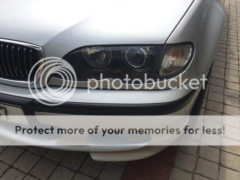

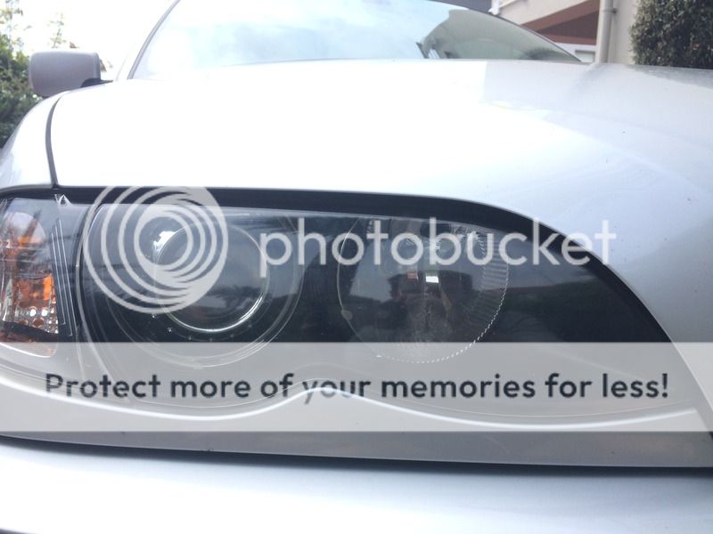

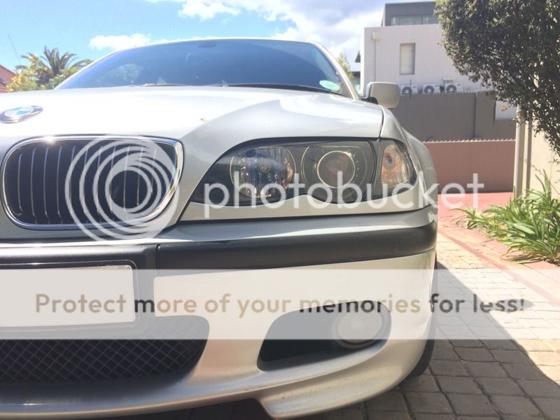

The only issue I had with xenons is that the mounting tabs on the housings were broken. I knew this when purchasing them, and fitted them anyway. My OCD however starting getting the better of me when I noticed that the passenger side headlight wasnt sitting quite right, resulting in an uneven panel gap between the headlight and the bumper:
So I used Sankekur's ever so helpful tutorial on headlight disassembly and internals transfer to figure out what I needed to do in order to transfer the xenon components into my halogen housings with intact mounting tabs. It turns out that its very easy, the only tedious bit is teh drilling - one 22mm hole is all that is required in each halogen housing, and the rest is very easy.
Now with the internals transferred, the headlights sit better:
