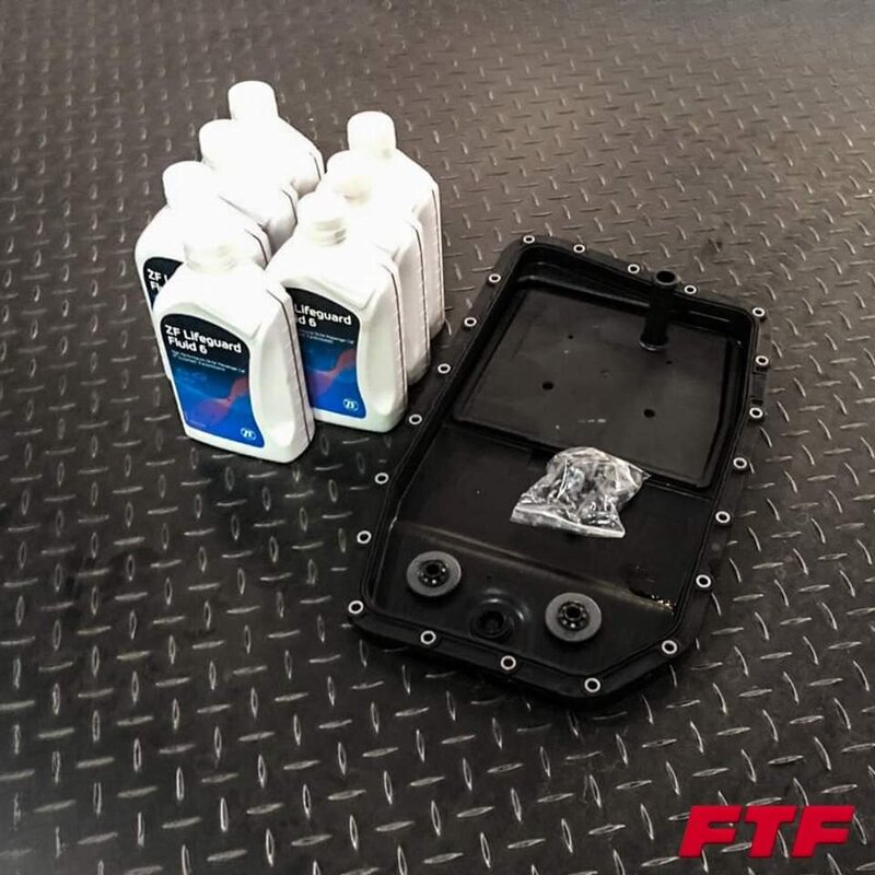

Took about two hours to complete. Car is booked this week for a Gearbox service at FTF in vereeniging, backed by ZF parts and lube.20240802_125333.jpg20240802_125327.jpg

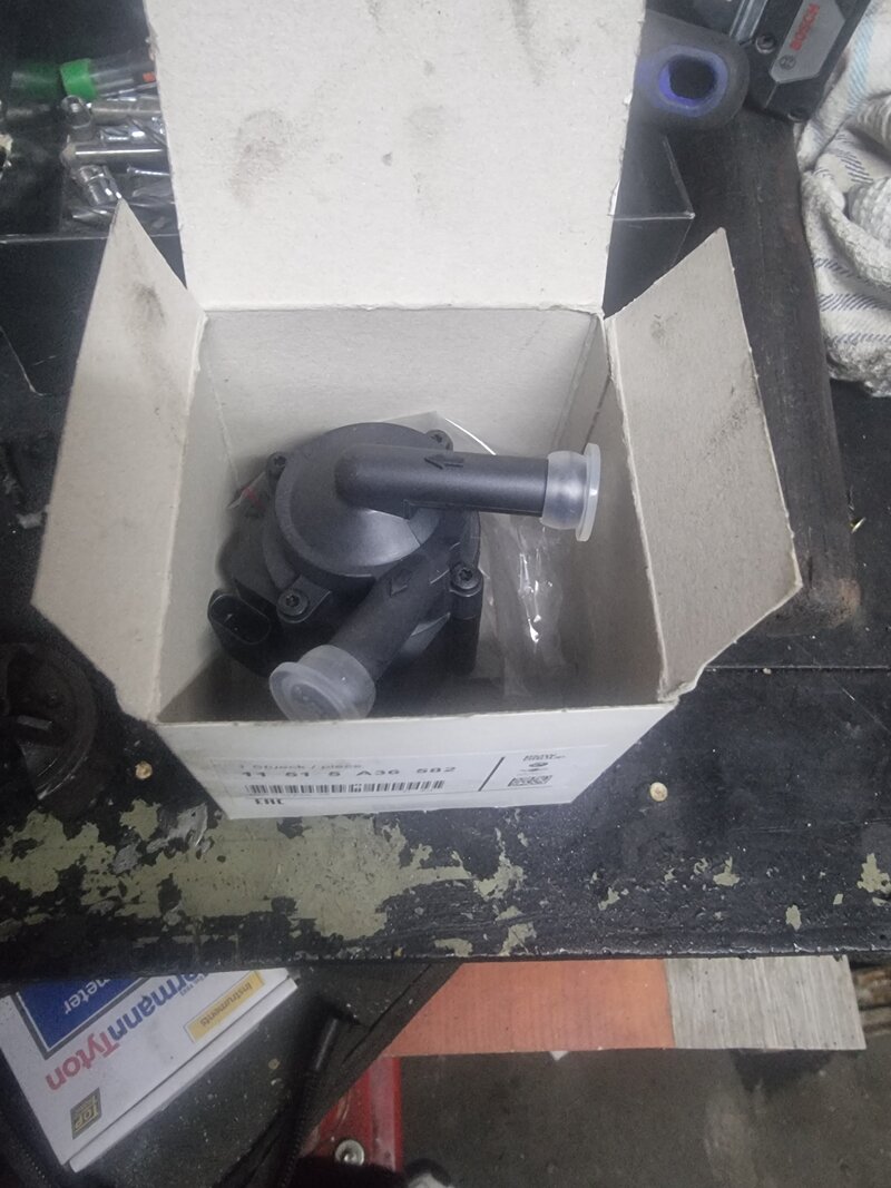

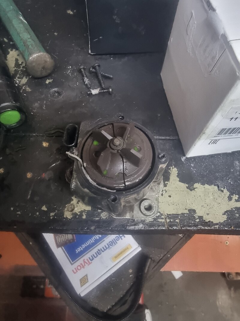

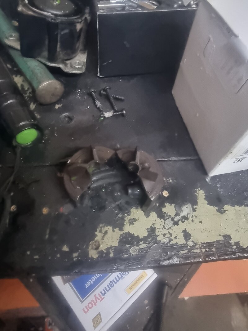

In Feb last year, the auxilary pump for turbo's failed, bought a new pump at GW, and replaced it. After replacing radiator and transmission cooler, i developed a coolant leak, stipped down to search for the leak and found that the leak came from the auxilary pump. Opened it up to re seal the pump, found the impeller split in half. Upside is i prevented a possible future problem( hopefully not too late ), bigger problem is the snails ran for almost 20 k without20240815_151033.jpg20240815_151022.jpg20240815_151001.jpg that coolant pump. This pump was broken from the begining. Just did not know it. The auxilary pump first time round was noisy and had shaft play, after switching off the car you could hear the pump still running. After replacing it with a new unit ( From GW ) this was silent, thought this was because it is new. Bought a new OEM unit from agents and replaced. You can hear the pump running after switching off, so lets hope the snails did not get damaged, time will tell.
TurboLlew
What was the brand of pump from Goldwagen that you fitted? (more for me to avoid in future!).
I don't think you will have suffered too much as there is SOME ambient circulation if it is anything like the F10 M5 system. It would be on cooldown that the pumps wouldn't have continued to circulate but provided you aren't coming off a track session and switching off immediately I wouldn't worry thaaaaaat much. The belt driven pump does create pressure and circulation even though there are auxilliary pumps for the heater core, turbos and engine... not at the ideal pressure and there was likely the siezed impeller acting as a resistance of sorts... but I don't think it was zero flow/cooling. The oil circulating also has a cooling function on top of lubrication (these IIRC are oil and water cooled turbos)
Gordvisr
Cannot remember what brand it was, what i do remember there was two option's, OEM or non OEM, in which the price was also a diffrence. I have paid and ordered the OEM one. Still searching for the box of the one i bought from them. I think through the courier, they might have dropped the pump which caused the impeller to split in half, it is abrasive material. Somewhat good news on the snails side. And yes if i did push the car i did give the car some time to " cool off " before stopping or switching off.
